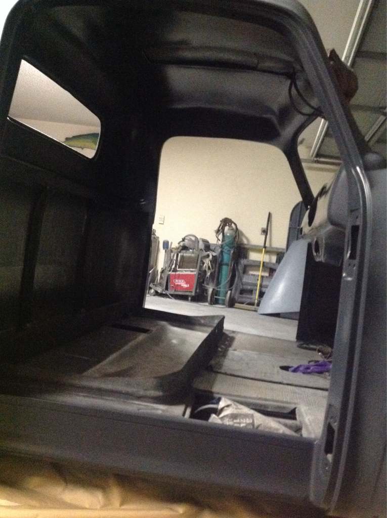

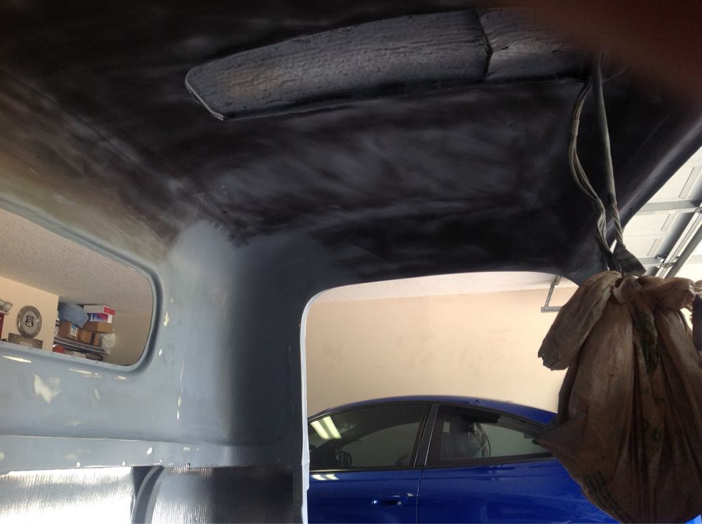

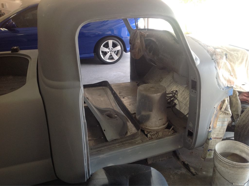

    Lemme start and say....I hate this effen inner roof....it sure will look good when it's done but dang....I started out the day wet sanding the inner roof.... ImageUploadedByH.A.M.B.1410937499.744858.jpg
    Now it's 0300 eastern....and in sealer!!!!! AKA the next time I have to touch this hell of roof and dash is to put gloss paint on it! Wish I hadda crystal ball to see into the future and tell what a PIA this idea was going to be...shoulda used a normal headliner instead of making a fibergl*** one...9 hours of **** dripping in my face!
    I truly hate this inner roof....one of the best and worst ideas I ever had....I couldn't just leave well enough alone could I....the dash is lookin mighty svelte though....
    ImageUploadedByH.A.M.B.1410937637.926149.jpg ImageUploadedByH.A.M.B.1410937653.695827.jpg
    Cut the door jambs in as well....screw those things as well....
    307 hours into paint prep...hopefully nearing the end...

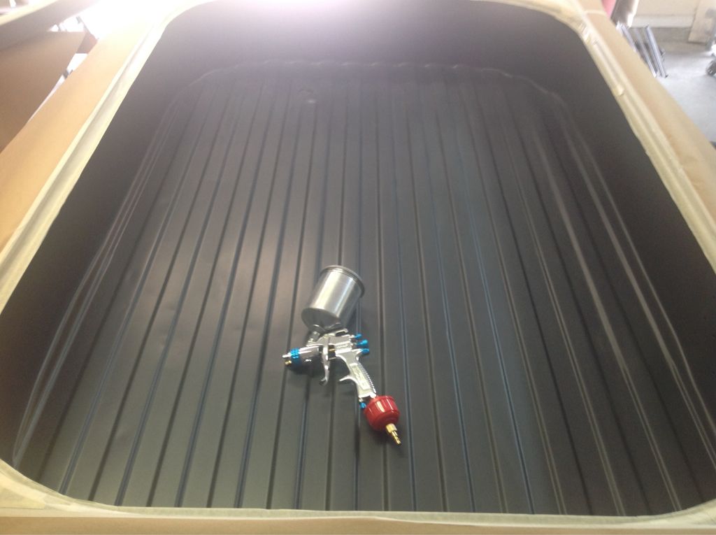

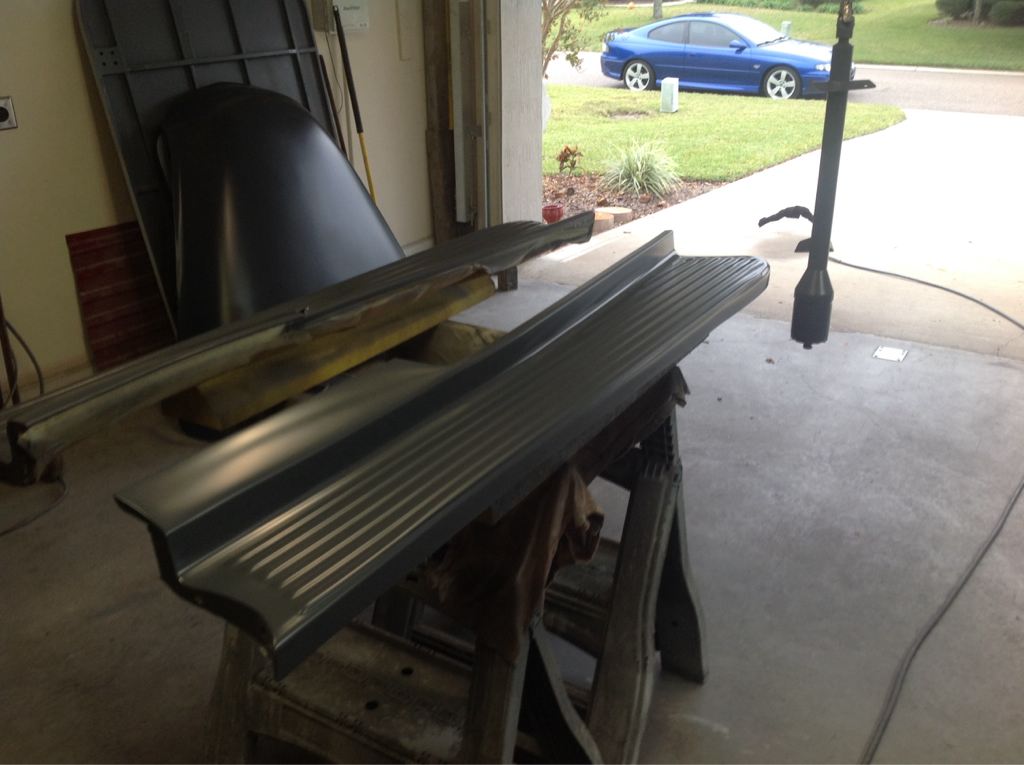

    ImageUploadedByH.A.M.B.1415917202.687821.jpg ImageUploadedByH.A.M.B.1415917217.473898.jpg ImageUploadedByH.A.M.B.1415917230.454672.jpg ImageUploadedByH.A.M.B.1415917262.211952.jpg
    Alright, just shot the sealer on the bed, I sealed the hood a few days ago....running boards, a few small parts (steering column, etc), and tonnoe cover and doors left still (waiting to seal them until I set up the door/window guts).
    Doors and tonnoe cover are prepped and ready....so as of now 80ish percent of the truck is sealed n ready for paint!
    Sidebar....the inner bed....if I had it to do over again I would have bought a clean, new bed floor from some random truck to use...that thing was an epic pain!
    367 hours into paint prep!

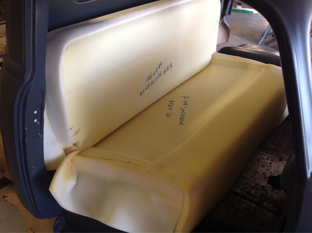

    So after procrastinating for months I finally got off my dead *** and ordered a custom bench seat so I have something comfy to sit on...Glide Engineering was awesome to work with...they customized one of their bench seats for my chopped and sectioned truck for no additional charge (they took 2.5 inches out of the seat back) what I had waiting for me....
    ImageUploadedByH.A.M.B.1417644159.979101.jpg ImageUploadedByH.A.M.B.1417644176.916611.jpg
    Super impressed with their work!
    ImageUploadedByH.A.M.B.1417644441.802996.jpg ImageUploadedByH.A.M.B.1417644471.111668.jpg
    The biggest reason I went with em is the fact that their seat bottom flips up....seeing as I don't have lots of space due to the section I am installing the fuse panel and all the other relays and control boxes under the seat...I wanted easy access to the gear under there...
    ImageUploadedByH.A.M.B.1417644578.465366.jpg ImageUploadedByH.A.M.B.1417644590.768671.jpg
    Foam kit mocked up....it's super comfy...I sat in the drivers seat and made vroom vroom noises for bout a half hour....it had to be done...

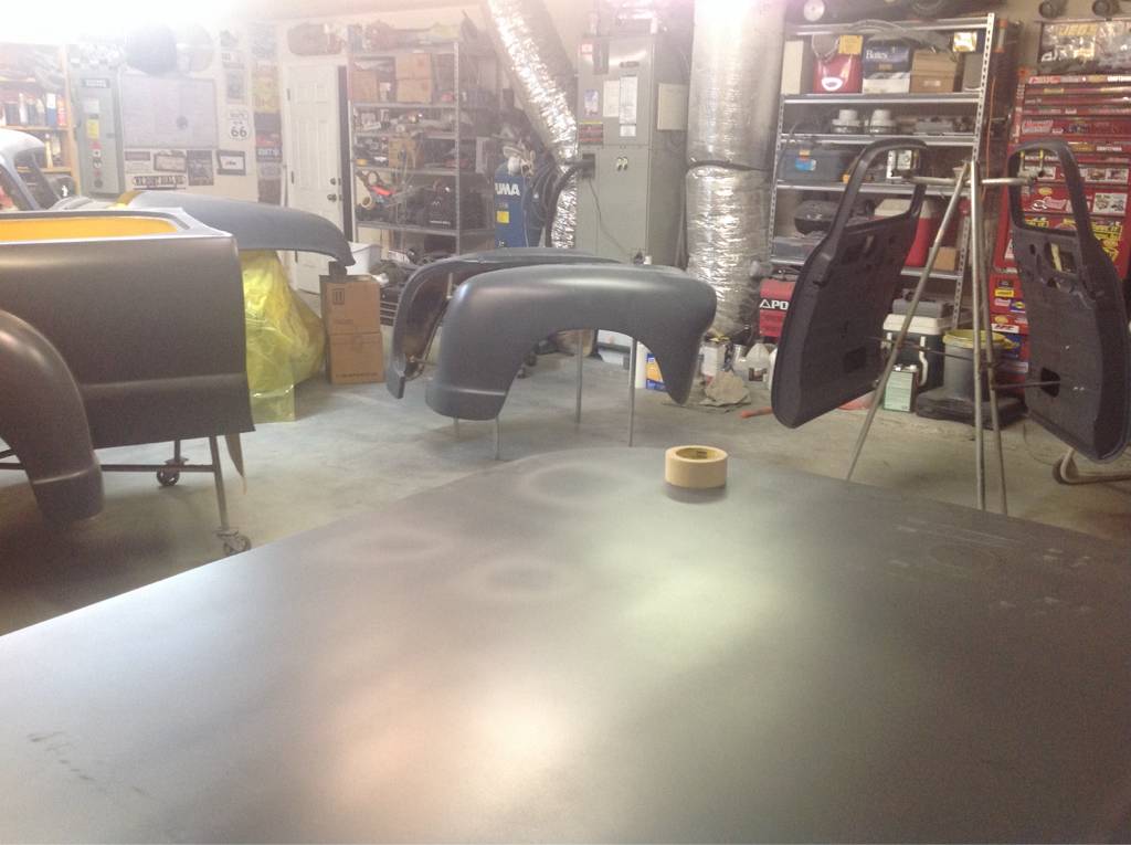

    Official truck update: power window mechanisms are now installed....since they are I was able to seal the doors and the four pieces of moulding retainer that I found...
    What does this mean? It means that gloss is going on next!!!! The entire truck is sealed!!!! Dis bout to get good!!!

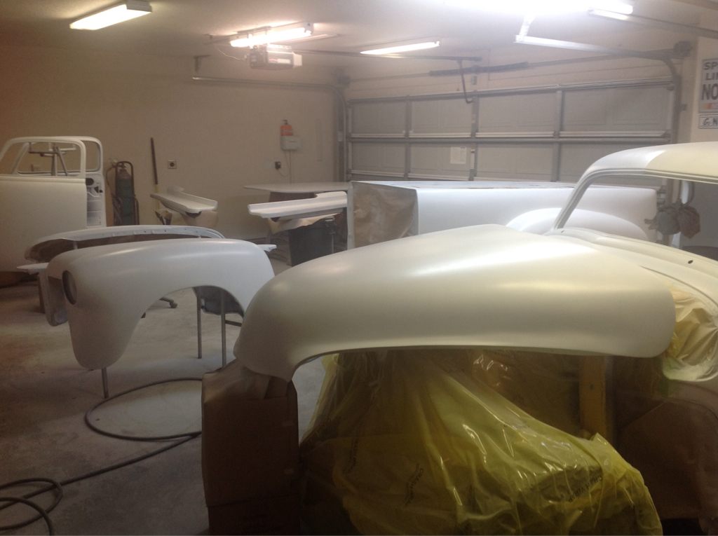

    White auto air colors base laid...right now I'm just doing all of the insides of stuff that I can easily blend the line when I put the top coat on...once all these pieces are done I'll mask them off and do the exterior (and subsiquent door jams and inner cab) all at once...

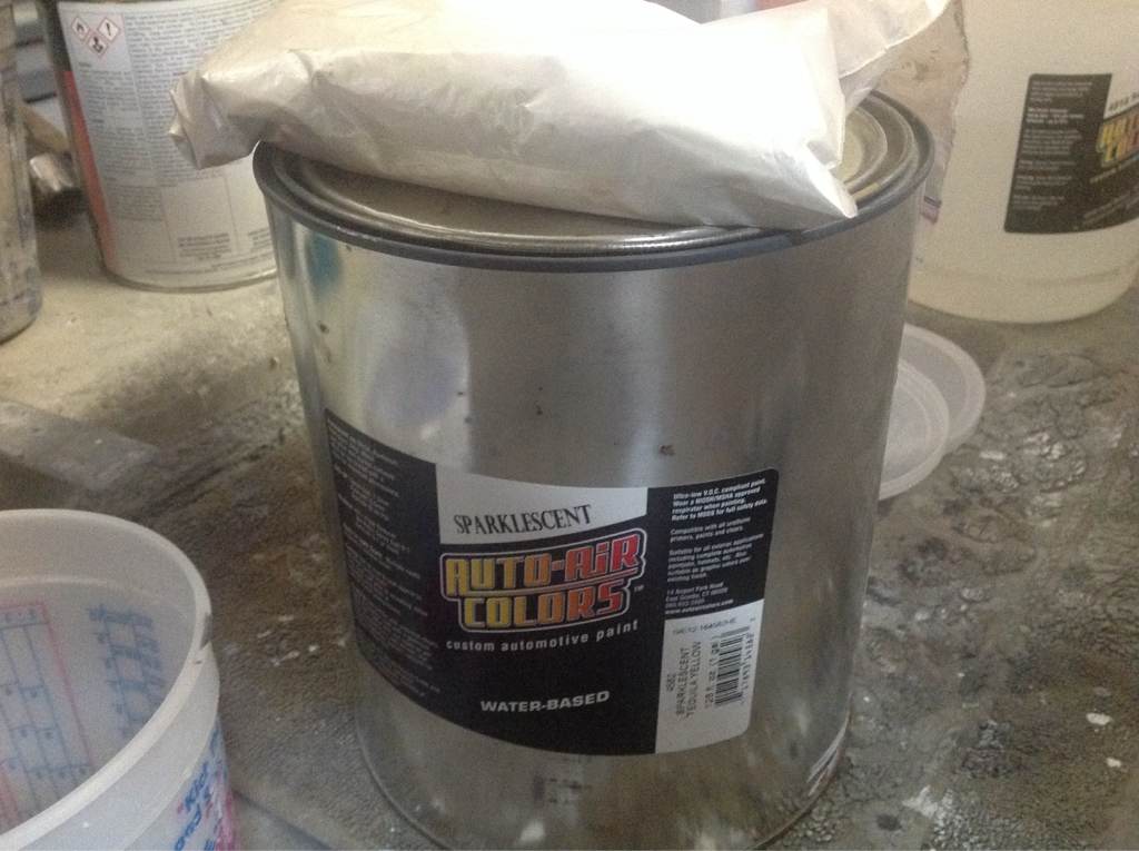

    Preface...this has taken place over a few days..here is a log of what I have done so far....
    I wet sanded first...then pre-paint activities (took way longer than I thought).....here's the litany of **** I did....swept the floor....a lot....then scrubbed it....de dusted the walls...cleaned the inside of the garage doors...hung paper on all the various shelves, benches, welders etc...cleaned the shop lights, cleaned the drop light, cleaned all the air hoses, cleaned the extension cord, cleaned the paint guns again..
    THEN I wiped the entire thing down with pre-paint solvent....tac ragged it....got a new tac rag and did it again...
    BEHOLD! We byp***ed "The Shocker" and went to "THE SHOW STOPPER"
    It was time to start slinging....
    Base white on (waterbase takes three coats) BORING!!!! No runs though!
    Next up....turning it into a heavy metal rock star....heavy flake intermediate base applied (getting fun! Looks like Elton John was up in here!)
    There's where we are right now....color is up next....it's gonna involve a transparent base so I can mask the roof....it should be a pain in the **** to do.....standby!
