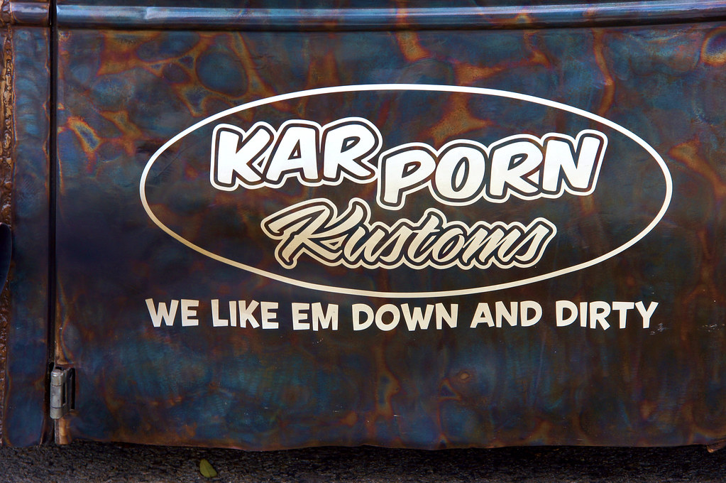

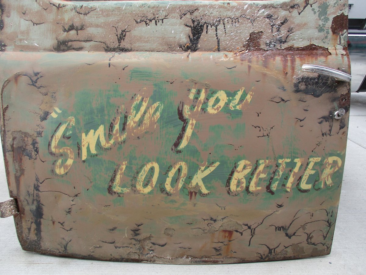

  2. eds6.jpg Did this last week, made the Logo, did the rust and Patina :)

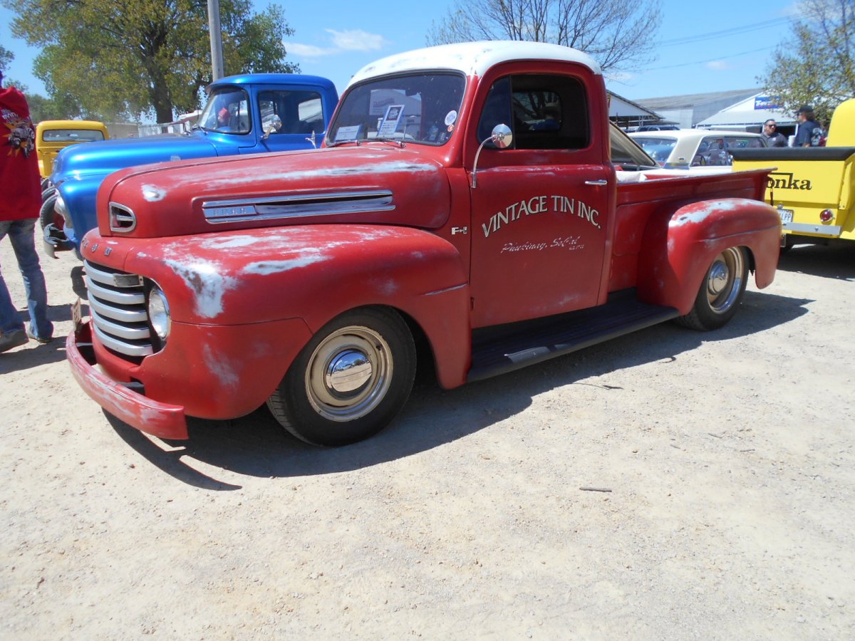

    ...here's a couple I got a chuckle out of at this year's Torquefest show in Dubuque, Iowa...
    2017 t-fest 062.jpg 2017 t-fest 063.jpg 2017 t-fest 104.jpg 2017 t-fest 103.jpg

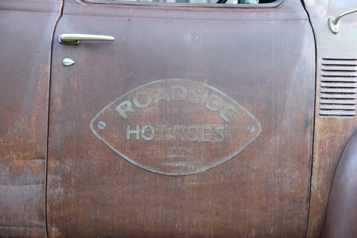

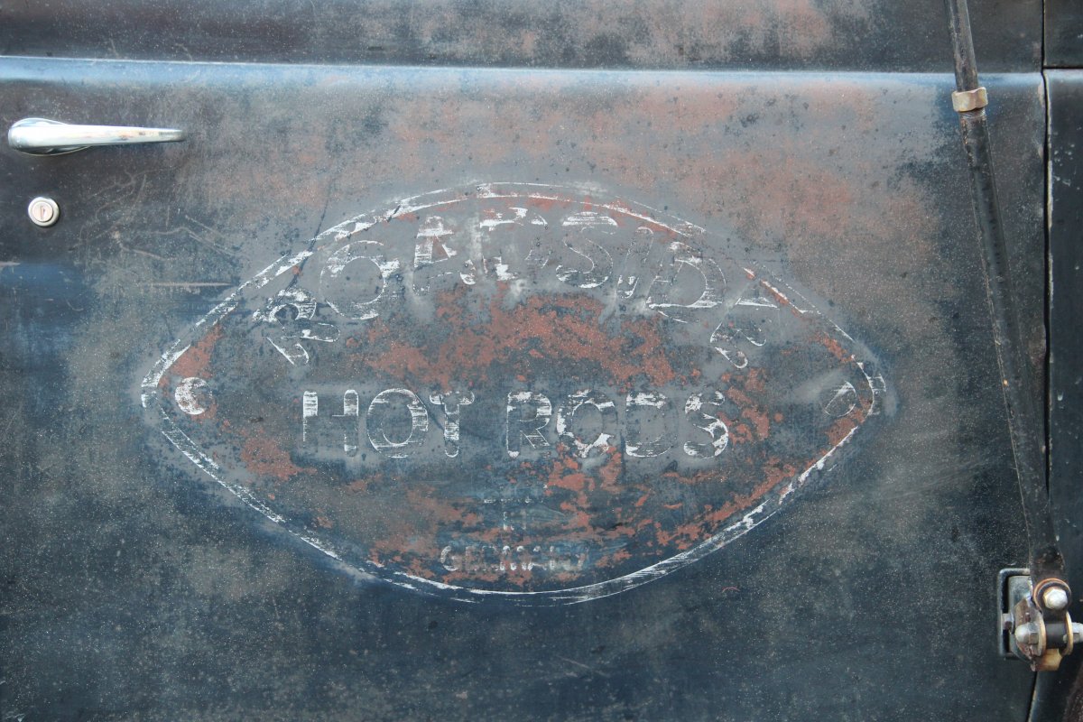

    Here some door lettering from Germany

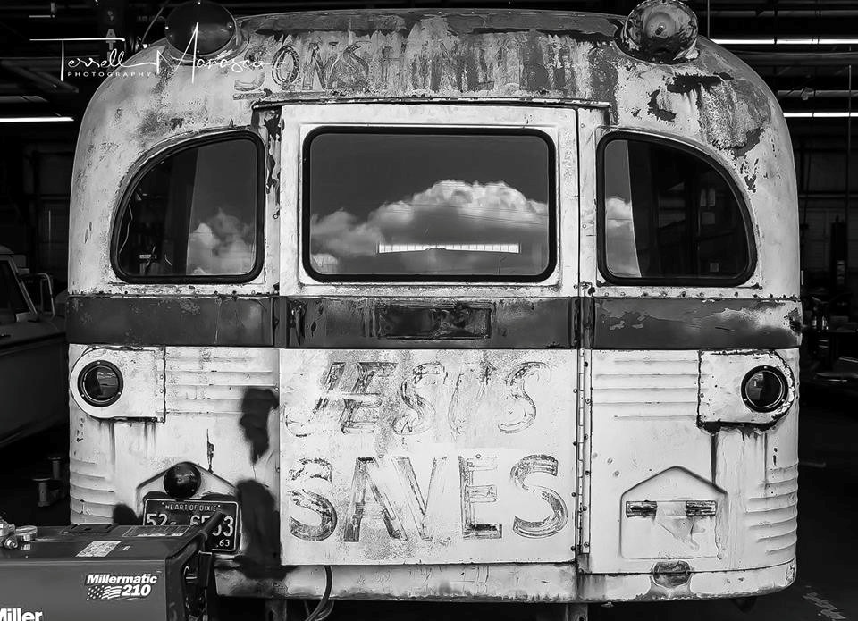

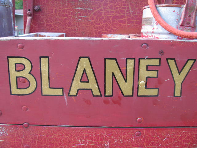

  16. This was a quickie project last week. The vehicle(a 1933 Chevrolet fire truck)had seriously deteriorated painted(cracking and crazing everywhere)and the lettering on the side boards had been painted over many years ago but was still barely visible.
    The owner wanted me to trace over the original lettering and paint it with 1-Shot metallic gold paint rather than gold leaf.He then wanted it "antiqued" to match the original finish but not have it appear that it had been recently done.
    Didn't know whether my usual technique would work but figured to give it a try. Had to do it outside as the truck wouldn't fit in my shop and leave me room to work on it. There was a pretty stiff breeze blowing for most of the time I was working on it and it even started to rain about half way through. I just kept painting;figuring it might add to the realism.
    Traced over as much of the letters I could see with a Stabilo and broke out the gold metallic and a French gray quill.Had to stir the gold quite a bit but the coverage was great and it even seeped into the little divots in the base paint.
    As the gold dries fairly rapidly I immediately started the black outlines as soon as I finished the gold.I deliberately didn't try to be super precise as the original lettering wasn't perfect.
    The next day I came out and started scrubbing the letters using a brown scuff pad with some windshield washer solvent sprayed on;wiping it down with a dry cloth periodically to check how much material was being removed.
    When I was satisfied,I gave the entire surface of the boards a light scrubbing to equalize the finish. Notice how much the gold paint resembles actual gold leaf before the scrubbing. 1933ChevroletFireTruckBlaneyParkNo.2 003.jpg 1933ChevroletFireTruckBlaneyParkNo.2 004.jpg 1933ChevroletFireTruckBlaneyParkNo.2 005.jpg 1933ChevroletFireTruckBlaneyParkNo.2 006.jpg 1933ChevroletFireTruckBlaneyParkNo.2 007.jpg 1933ChevroletFireTruckBlaneyParkNo.2 008.jpg 1933ChevroletFireTruckBlaneyParkNo.2 013.jpg 1933ChevroletFireTruckBlaneyParkNo.2 014.jpg 1933ChevroletFireTruckBlaneyParkNo.2 015.jpg 1933ChevroletFireTruckBlaneyParkNo.2 016.jpg 1933ChevroletFireTruckBlaneyParkNo.2 001.jpg

    I Like That ^^^^^

    Good to see you're still pushing paint around with dead squirrel parts tied to a stick. Hadn't seen any posts from you lately. That made a great looking "rainy day" project. :cool:
    As far as deliberately trying to not be super precise... Hell, all my lettering tends to look that way! :rolleyes:

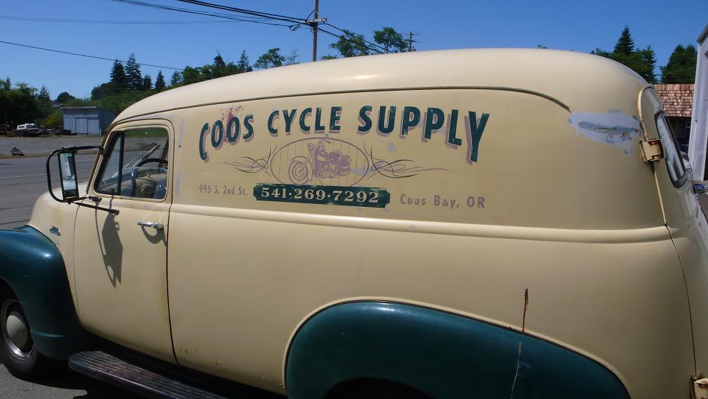

    Haven't posted on here in awhile
    Really busy at the shop this year, and even got to knock out a few more retro lettering jobs. (really Love doing these!!) :) Koontz Truck 2.jpg Koontz Truck Door.jpg Leslie 1.jpg Leslie 2.jpg coos cycle1.JPG coos cycle4.JPG
