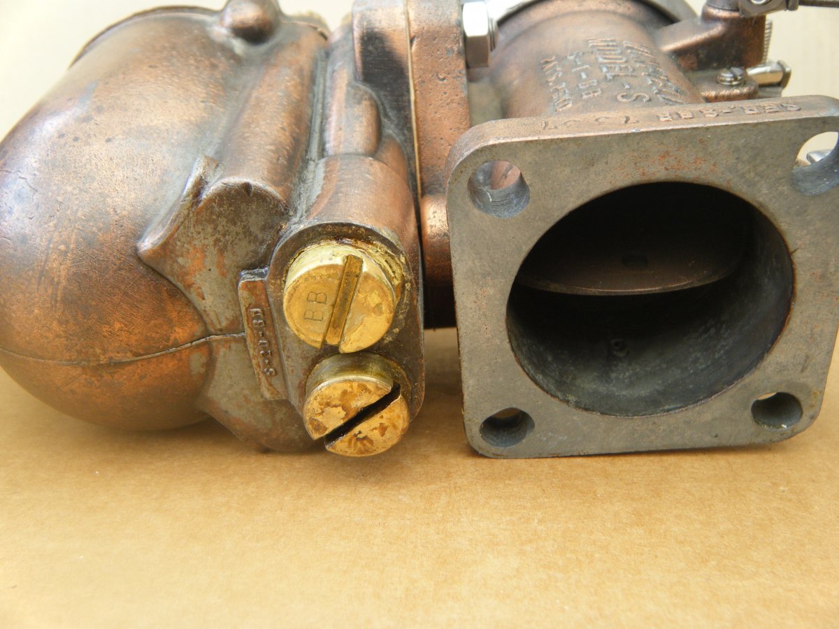

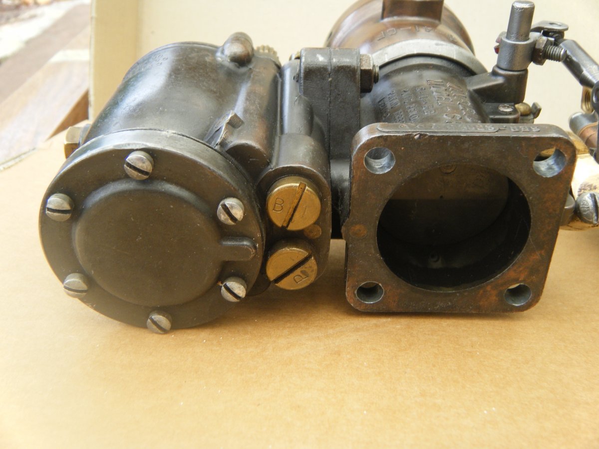

    Check the plugs on the bottom of the float bowls to make sure they match the bowl. Even though the bowl is marked B you could have BB tubes in the accelerating wells. I run BB tubes in my B float bowl. The plugs should be stamped on the bottom.

    62pan Thanks for the fast response. The SR carb B float is stamped with a B. The S-BB carb float is stamped BB. I pulled them and the SR and S tubes are different and can't be swapped, but you probably already knew this.
    SR B carb tube
    S-BB carb tube

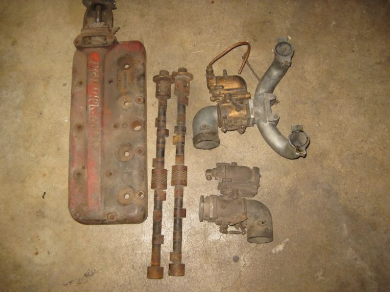

    I finally joined the carb club last month...
    I've got the RayDay head, Winfield intake, and Cyclone Winfield-to-Stromberg Adaptor that all came off of a hot-rod Roadster Pickup back in '56. So the question is, do I run the what I've got now with the Stromberg as it all was in the '50s? Or do I just go all elitist and throw the SR up on there?

    not really enough carb for that ray day head.... imo

    I've seen Winfield ads where you got a 6-1 head, intake and a B carb as a package deal. I'm sure it will work just fine. You can always add BB tubes to upgrade.

    There's the rub, my Ray Day head is an 8.3:1 compression ratio. Might be looking for some BB stuff...

    @Rainier****** I have a BB updraft we could hang that downdraft bowl on.

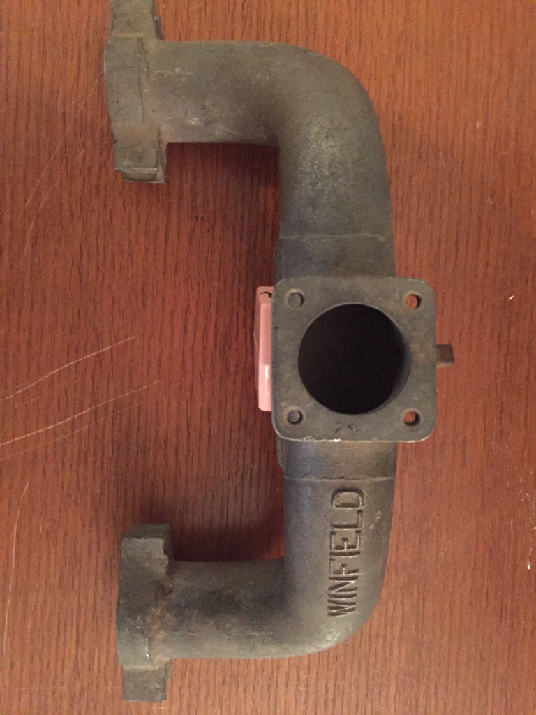

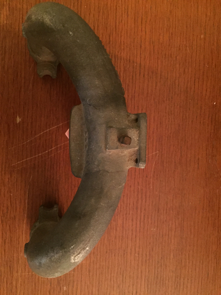

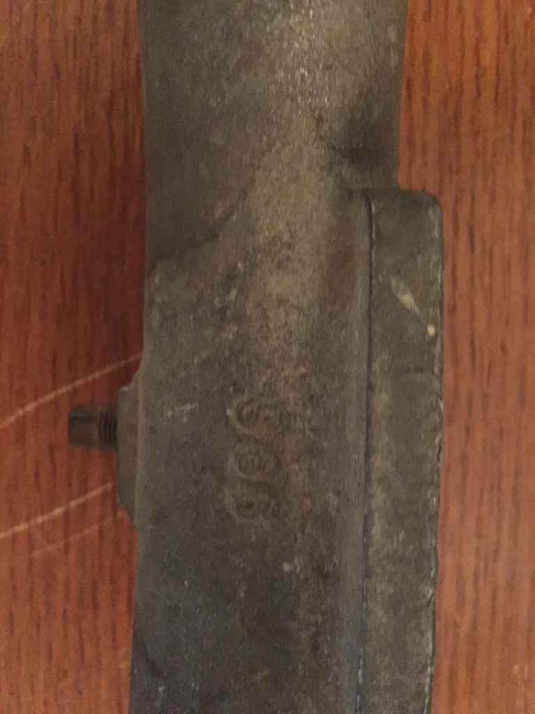

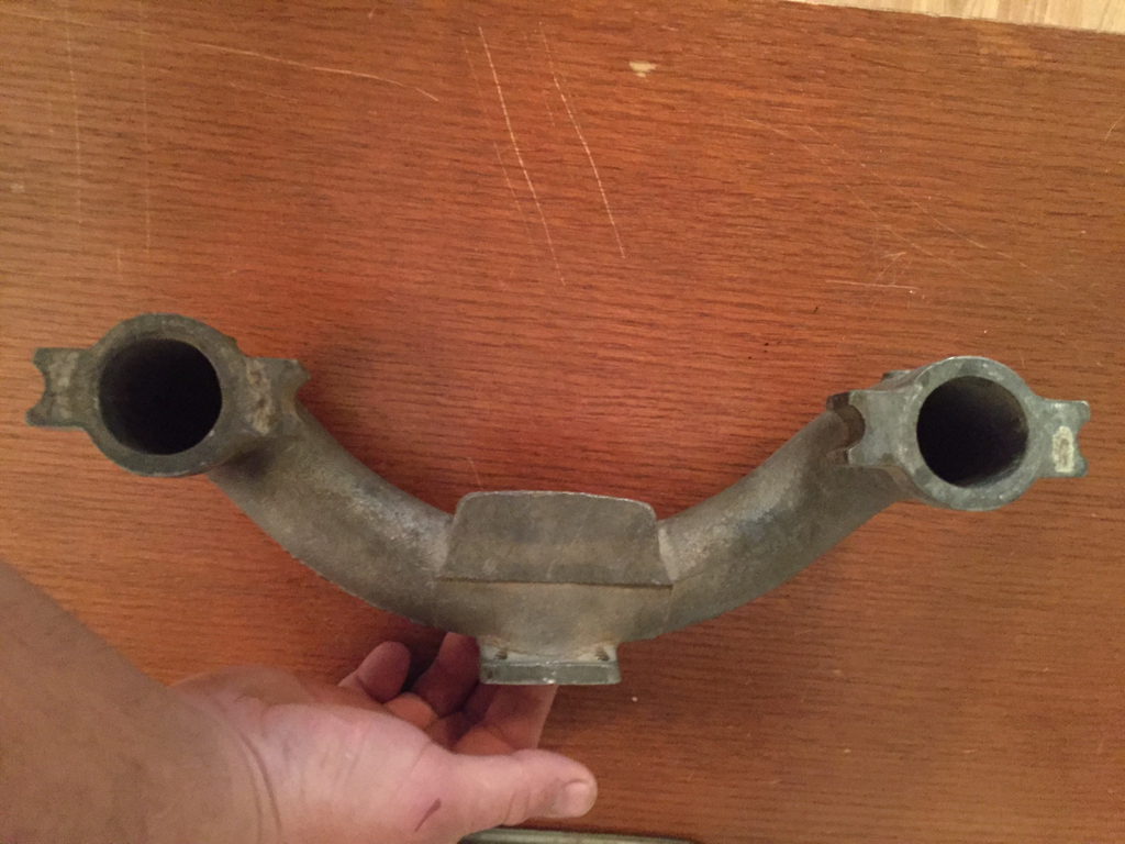

    I found this intake at a swap meet today. It has me a little puzzled though as it doesn't look like all the other Winfield A/B intakes I have seen. It doesn't have the linkage bosses cast into the bottom and no size stamped into it. The carburetor opening measures 1 3/8" whichI have read is a BB. Any help is greatly appreciated.
    ImageUploadedByH.A.M.B.1462657988.062045.jpg ImageUploadedByH.A.M.B.1462658014.771773.jpg ImageUploadedByH.A.M.B.1462658029.979428.jpg ImageUploadedByH.A.M.B.1462658044.186138.jpg
  20. waxhead
    Joined: May 11, 2013
    Posts: 1,172
    waxhead
    from West Oz
    Looks like my A/B Winfield BB intake except for the flat plate, instead of the threaded holes. I am not at home to confirm intake opening size, but as you have stated, should be 1 3/8" for a BB carb. I have attached a couple of pics of my BB intake. Yours is the first intake I have seen without the bosses. I had always ***umed the bosses were for bolting to the stock exhaust manifold. Nice find by the way.

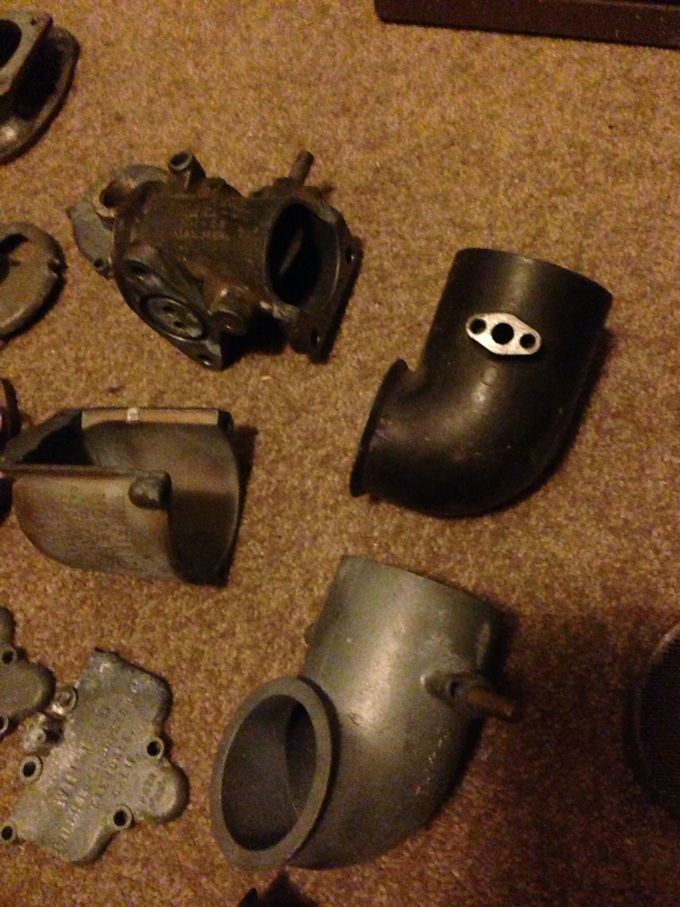

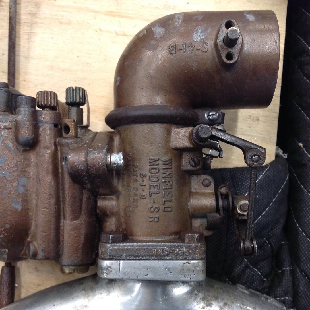

    Here's my collection of Winfield parts, I'm still on the lookout for a complete down draught S or SR carburetor in either B or BB in size! For the moment I'm going to run a Stromberg 97 on an adapter to to the Winfield intake on my 4 banger. Hopefully I'll find one soon!
    ImageUploadedByH.A.M.B.1462712022.896556.jpg ImageUploadedByH.A.M.B.1462712046.228188.jpg ImageUploadedByH.A.M.B.1462712069.062889.jpg ImageUploadedByH.A.M.B.1462712089.392938.jpg

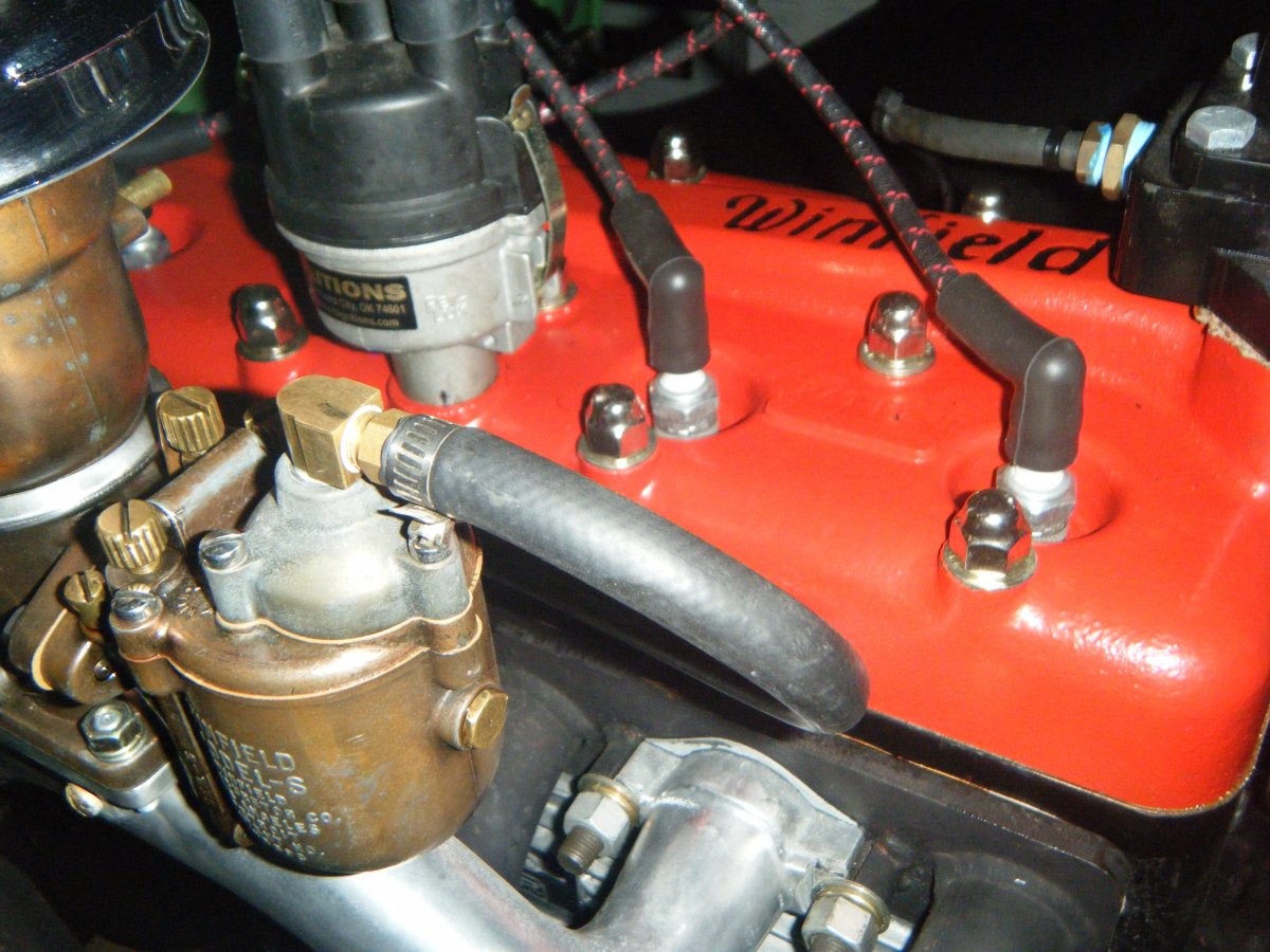

    Finally got all of my Winfield goodies bolted to my banger, and it is now running.
  28. rtsidejohnny
    Joined: Sep 29, 2006
    Posts: 250

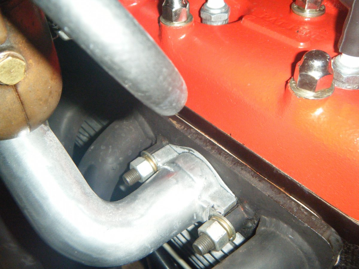

    rtsidejohnny
    Beautiful waxhead! I have almost the same setup I'm hopeing to have on the road soon.
    I notice you're not using small blocks on the other side of the manifold mounting bolts...I thought those were needed. Not so?
    Johnny
  29. waxhead
    Posts: 1,172
    waxhead
    from West Oz
    Thanks mate. I am using blocks on the other side of the manifold mounting bolts. They are hard to see as they are black. You might be able to see them better in these pics.
    1928Fordman and dana barlow like this.
  30. rtsidejohnny
    Posts: 250
    rtsidejohnny
    I see them now. Welded to the flange, good idea. Thanks for the follow up, and PLEASE let us (me) know how she drives with that great looking setup!
    Thanks, Johnny
