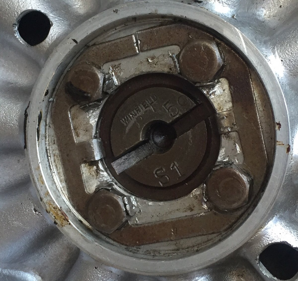

    Perhaps this thread can help me out. I purchased a pretty built 41mercury flatty, 3x2 strombergs, block is ported and relived,4 inch crank, .040 over etc turns out to be about a 293 CID. The cam is a winfield S1 with no lobe towards the rear to push a push Rod up and down for the fuel pump. Will this cam suffice or is it too much ?? ImageUploadedByH.A.M.B.1465397908.931998.jpg ImageUploadedByH.A.M.B.1465397926.324620.jpg
    It is going in a 29 roadster on 32 rails, t5, banjo rear 3:78 gears, big and littles tire combo. A friend is stating that the cam is too much and will not run good around the streets???

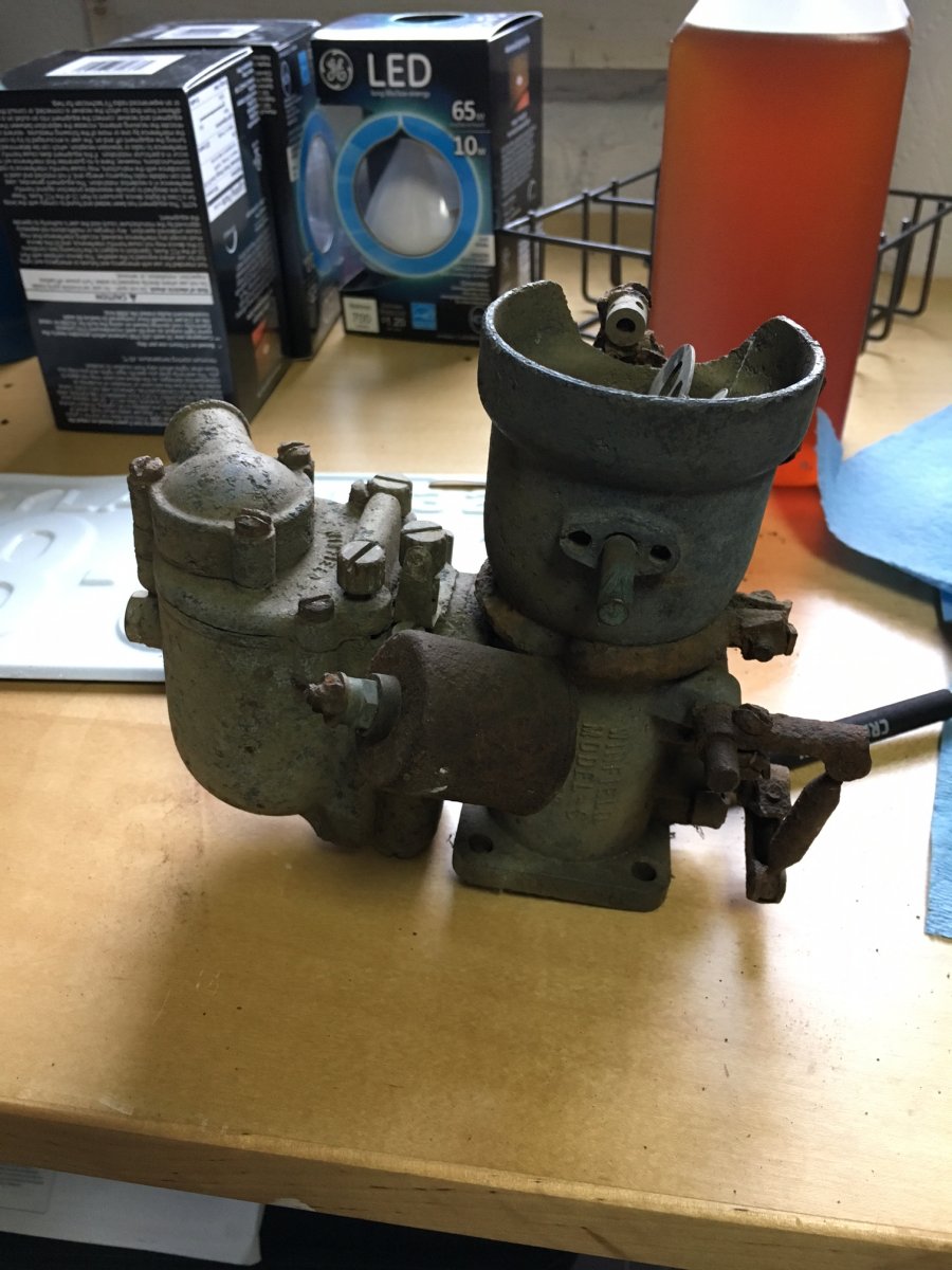

    Am I missing a Jet or something on this carb I picked up (see empty hole).

    No, Winfield carbs are drilled for either updraft or downdraft, the difference is where the holes are drilled. Look on your fuel bowl, it will be marked with the size and a U or a D to indicate which one you have. Bowls are not interchangeable.

    The marking of early Winfield cams is unknown to me but in a roadster you may like to have a hot cam? You need the duration and lift to determine drive-ability. If your engine is only +.040", and a 1/4 stroke, it is not 293 cu. inches. 3/8 X 3/8 is only 296".

    Ah.. So if it was an updraft the empty hole would be on the other side? Thanks.

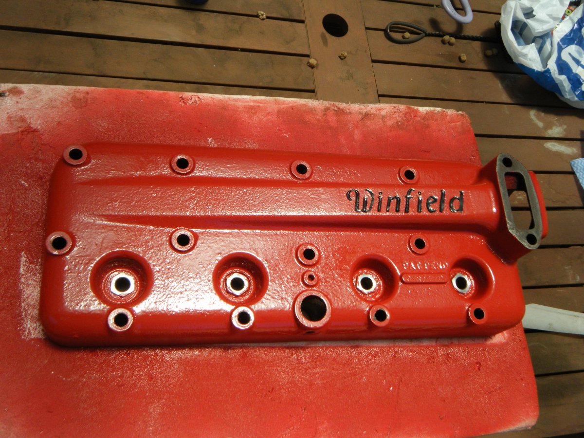

    This Winfield OHV, pictured in my garage, was my most prized automotive treasure years ago, until financial pressures made selling it to Don Ferguson Sr. the right thing to do. It's currently in the Smith family Speedway Motors museum.
    It has 4 intake ports on the left side, and 4 exhaust ports on the right. It was designed to use 4 side draft special Winfield carbs which used 3 mounting bolts. Only 2 sets of those carbs were produced. It is shown equipped with a custom made chrome plated intake manifold with 1 5/8" chrome plated SR carbs.
    This head is 1 of 2 that were used on the car driven by Rex Mays to the 1934 west coast AAA Championship.

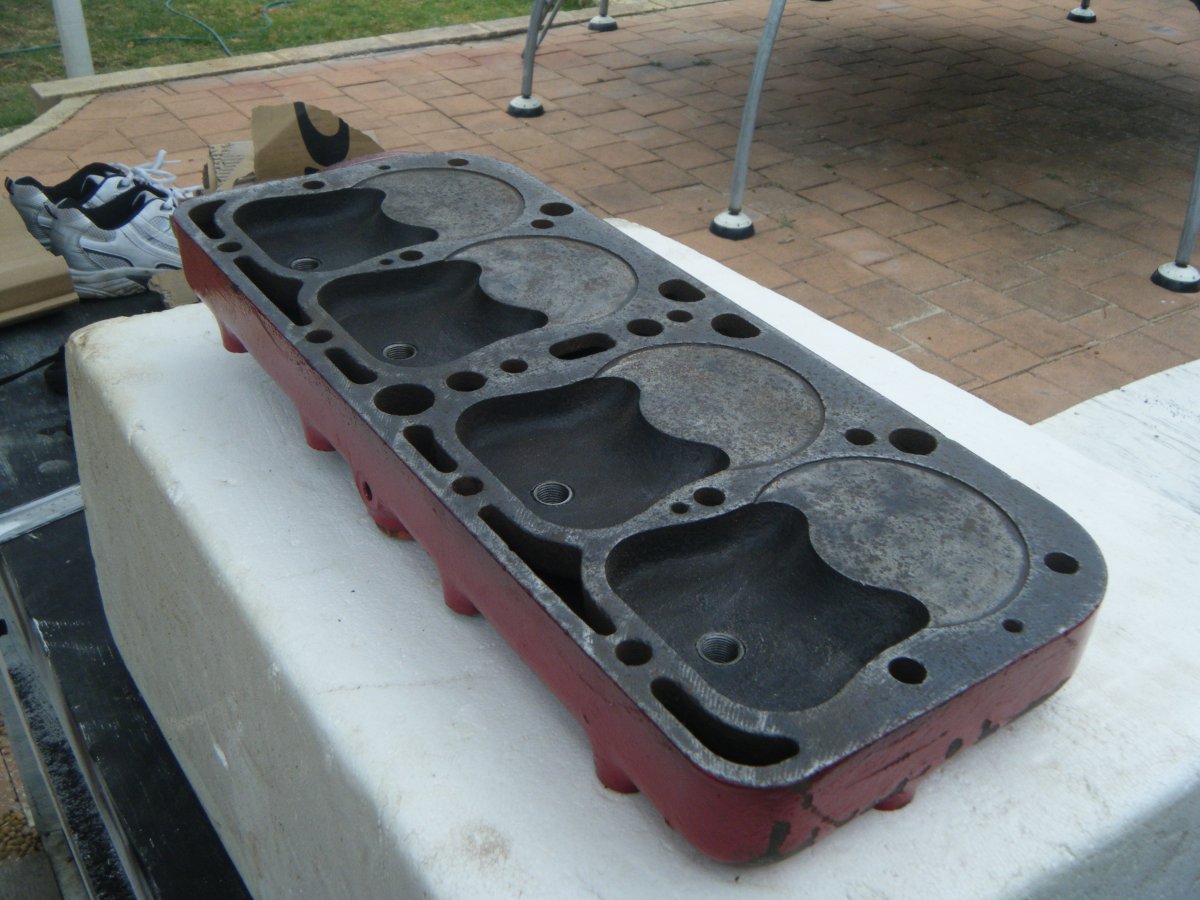

    This is a 7:1 "Yellow" head correct? Not date or anything on it. IMG_3182.JPG IMG_3183.JPG

    Winfield heads were stamped on the boss between #1 and #3 plug, yours is not stamped. The first number indicated the compression ratio, the rest was the serial number. I have no idea what those other stampings are. To find out for sure, measure the volume of the chamber and do the math.

    The chamber was shown to be a "Late Winfield". Are you saying it might be a repop? Or just that it is odd it doesn't have the stamping?

    Jim, I do not know if it is a repop or not. If it is original, it is weird that the serial number is not stamped into the head. I have not heard of a repop cast iron Winfield head, except for Tod Buttermore's recently produced heads. There are only a few of them out there at the moment. Jim Brierley would know more than I would about the possibility of older cast iron reproductions.
    My 7:1 crows-foot has the serial number stamped into it.

    serial number may show after it is blasted. has silver paint on it now.

    jim1932, I've never seen any re-pop iron heads until very recently, by Tod. Yours might have gone out the back door of Winfirld's shop???

    After blasting.... no numbers. Maybe it's an uber rare prototype..... or not...

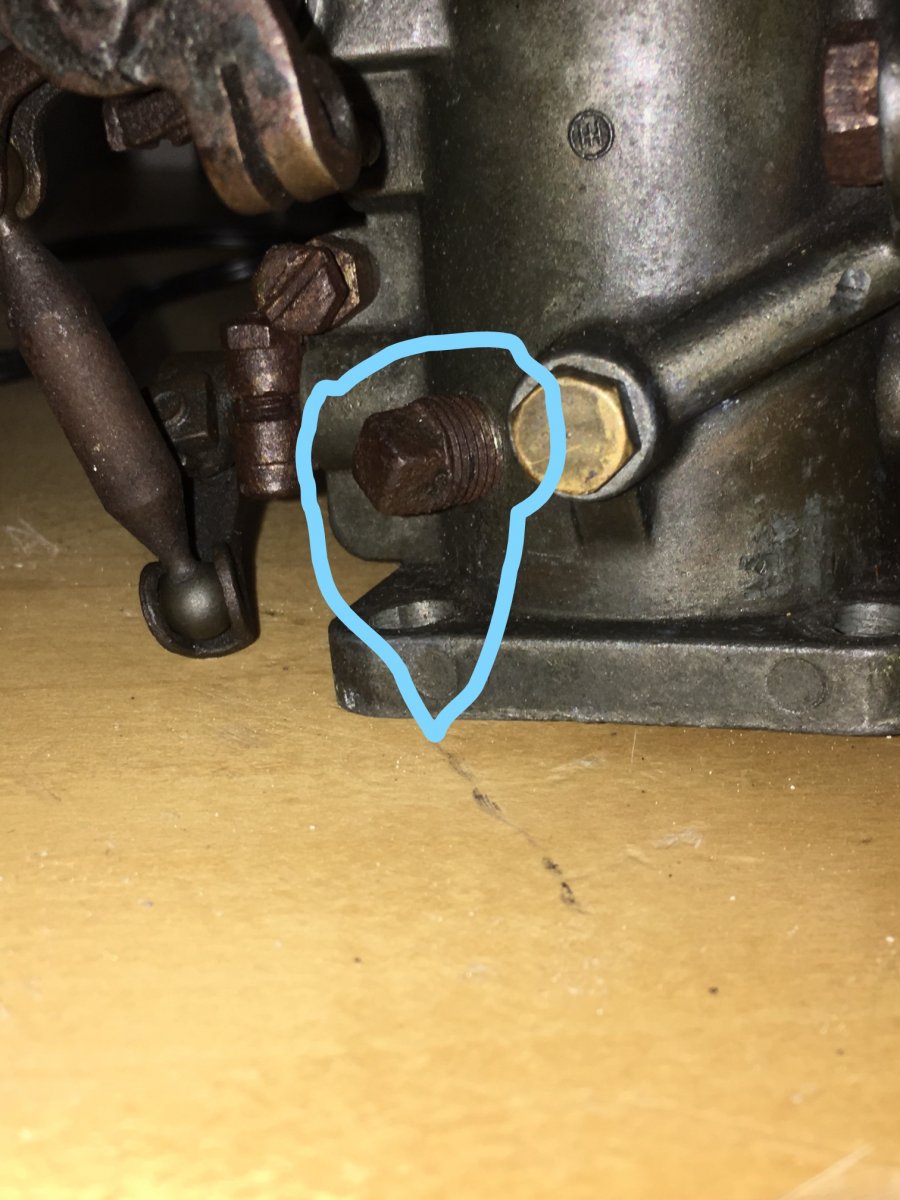

    So what's this? looks like a vacuum port or someone was injecting something into the carb? InkedIMG_3554_LI.jpg

    Checked my other carb and it is clearly som sort of add on. Guess I need to swap out the barrels.
