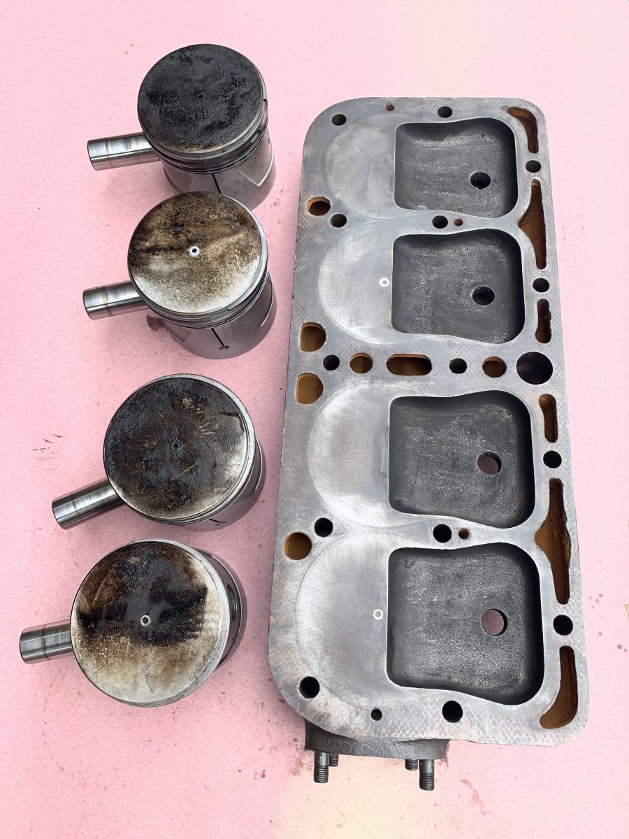

    Interesting. I wonder if perhaps it was "re stamped" when it was resurfaced? The underside looks real clean as if it was resurfaced and then never run again.
    Thanks for the pictures Binger.
    Thanks for the photos! I am wondering if maybe the serial number was sanded down and then re stamped after its last resurfacing.

    Interesting that my cast head had no stamping on it. Hard to say what the deal is with them. its my understanding that the cast iron head were made before 1949 or so. I cant confirm this fact. Mine ended up with some cracks and I had my buddy @winduptoy repair them. I am still planning on running it but havent got to putting it on my coupe yet.

    I thought all original Winfield heads had flycuts above the pistons, the 2 reds and 1 yellow I had did.

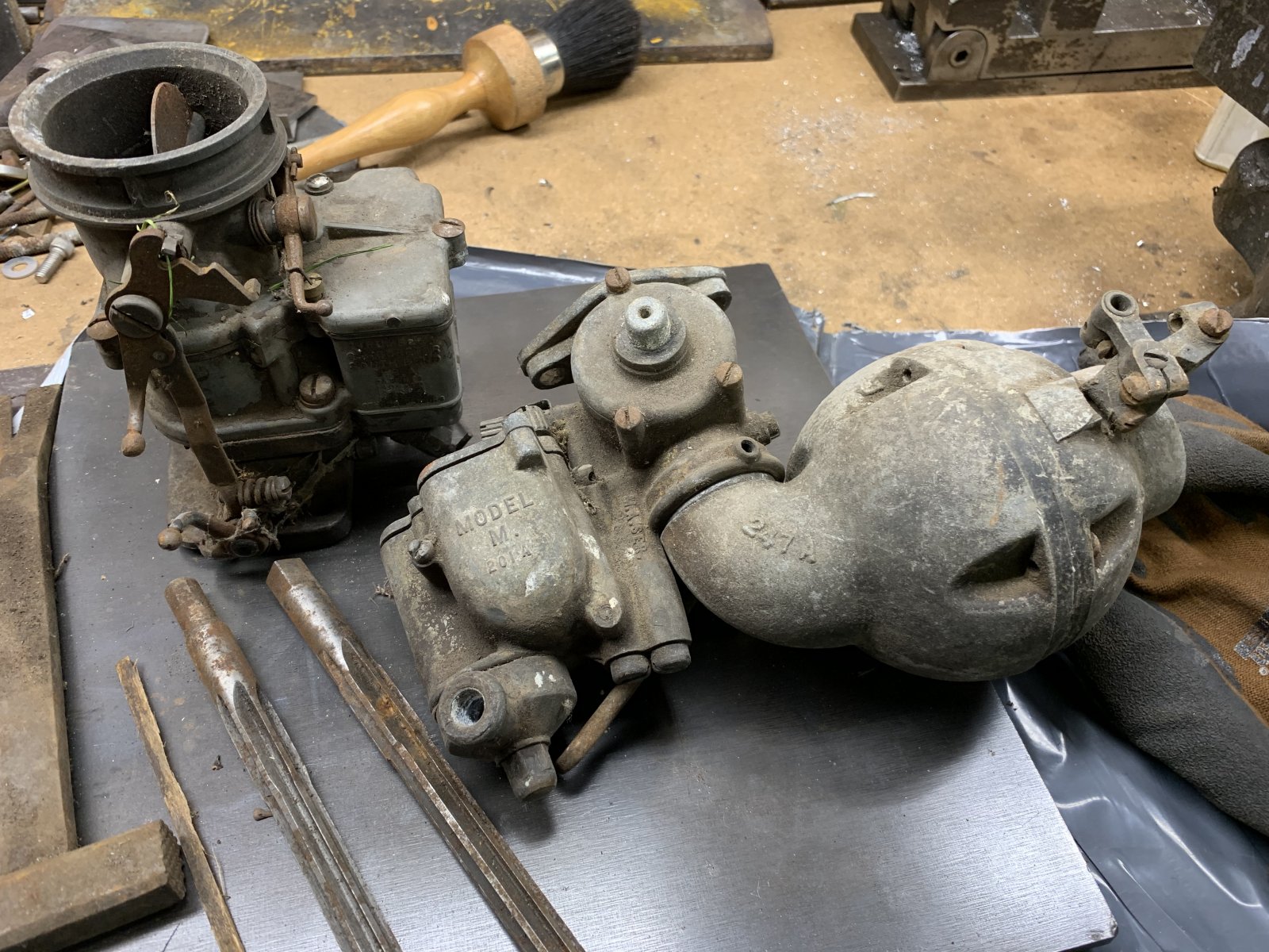

    Picked up this Winfield Model M carb today at a barn sale, it’s missing the screws on the float bowl, haven’t opened it up to see if the float is there. It was in a pile of old carbs, the choke chamber was off luckily I thought that part looked familiar so I took it. Realized afterwards they went together. The farm had so homebuilt machinery and lathe, along with miscellaneous parts. Got this, the Stromberg 48, a couple reamers, other misc stuff in two vintage Kraft cheese boxes for $10. What were these typically used on, Model T’s? 9395C79E-A8C5-4227-8D55-FF11A8E7AE77.jpeg

    TEN BUCKS ! Congratulations you really did well. Lets see the cheese boxes, cardboard or wood? Lube the barrel throttle real well in the Winfield, they were a great T item before the S & SR came out.

    That looks like a Two Port RILEY item to me.

    @31Apickup you did great like Bob said. Trying to not be too jealous on that deal.

    That was a great score! I have the same carb. on a Dodge Brothers Fast Four I found that had been shortened like a Doodlebug. I was excited to get mine. I've got my engine in shape and just about ready for a first start once my starter comes back from being rebuilt. I'll let you know how it works. There isn't a lot of literature out there about the model M. It was one of the early Winfield models. I do have digital copies and pictures of some do***entation on the carbs. One is the set up procedure for fitting one on a Dodge six cylinder. I'd be happy to share if you're interested in them.

    I'm just circling back on this as I see I never answered. The running of one step down in size on the throat bowl to help with stumbling issues was a technic recommended by Winfield himself and even has a published technical service bulletin in it. That is where I read it.

    Jaril12, I’ll pm you my email address, I be interested in whatever digital do***entation you have. Don’t have anything I can currently run this on, but am interested in how it works. The barrel valve is free, everything moves. The float bowl screws are missing haven’t opened it up to see if the float is there. The bowl like fitting on the bottom where the fuel line goes in has some cracks in it. The farm sale I got it from had some homemade equipment, several steering columns from 20’s era cars and several other carbs. The other carbs were Carters, 20-30’s.

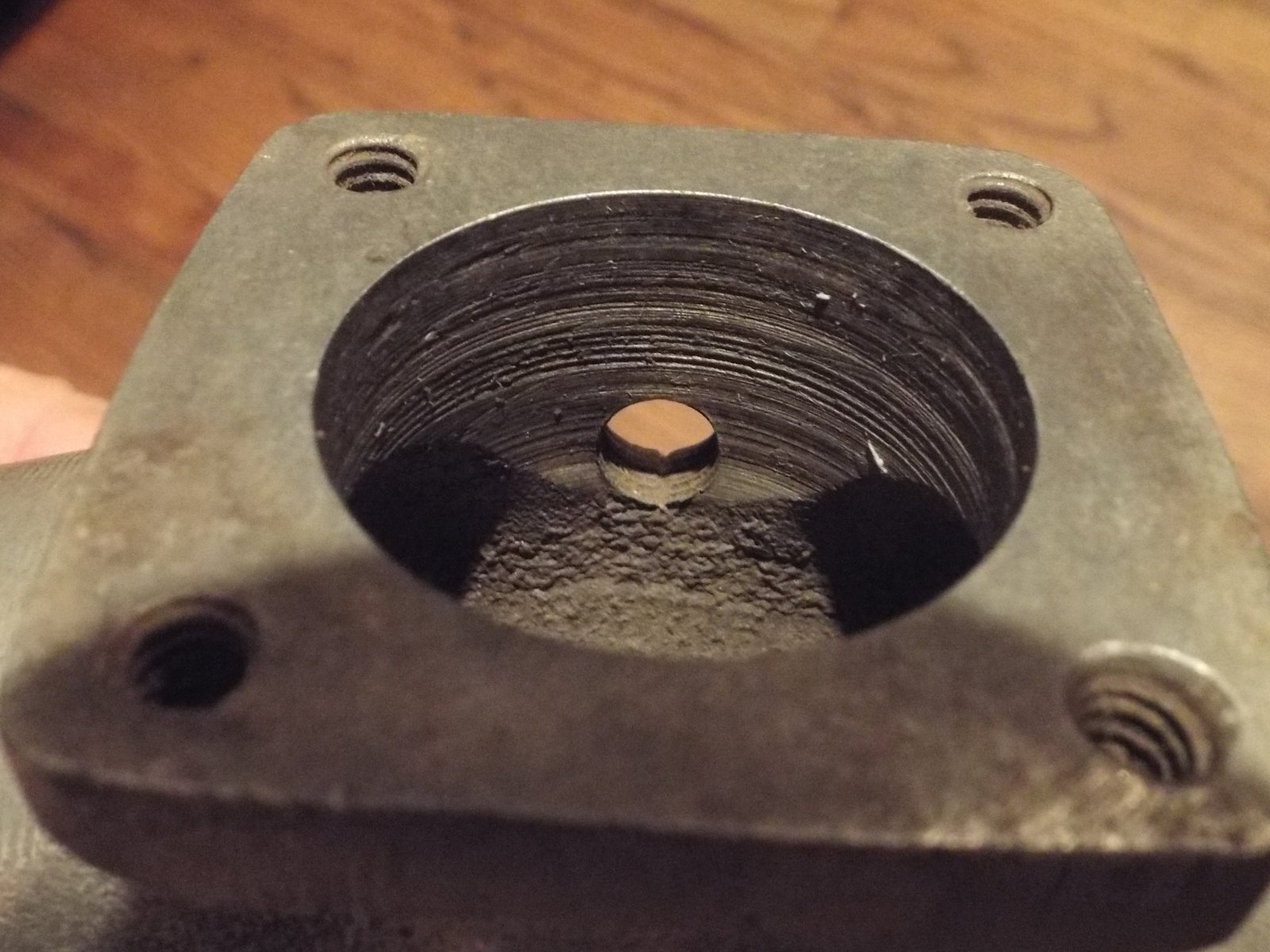

    Looking to learn more about Winfield S66 manifolds and port and carb sizes. Most of the Model A manifolds I've seen so far have a throat sized to 1-5/8" fit a BB Winfield and the port sizes where the manifold meets the block are 1-3/8."
    On the manifold pictured here the intake runners are visibly flared out more on the outside (the left side has been welded) than 1-3/8" runner manifolds do. Does this mean it has larger runner ID diameters where it mets the block and also takes a larger carb?
    Would like to use one of these manifolds if one was made, and can be found with with 1-5/8" ID intake runners and a throat size of 1-3/4" to match a SR - S-1-C Winfield carb.
    Has a chart or brochure survived which give this info?

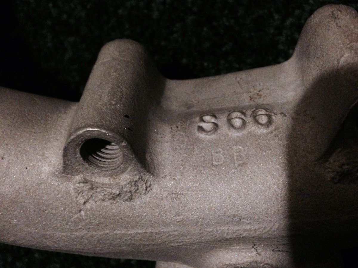

    I've never seen any paper work on the manifolds. Most common ones I seen were B or BB with one AA. They are usually stamped on the underside what size there for. Dual manifolds like for Cragars or Rileys usually are for CC or D size carbs. Never saw a dual manifold with Winfields name on it.

    Doesn't mean they are not out there, but I've only seen those Winfield Manifolds for AA, B, BB carbs. There's not alot of meat there to modify . Probably better to modify another intake. Alot of OHV intakes were custom made with tube steel.

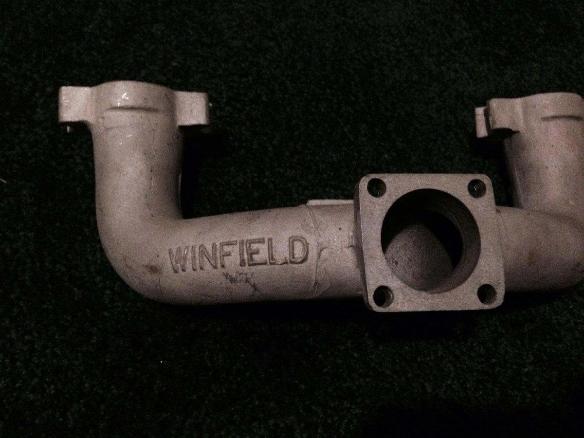

    David, I don't recall ever seeing a Winfield intake with core marks, mine hasn't been filed or polished. Intake still has the original machine marks and is 1 1/2 block side holes are 1 3/8
    All my parts have a story, back in 1970 I bought two Winfields with the intakes for $15.00 each from a fellow that would become a lifelong friend. He didn't show up for work on the first day of a job. Shop owner called to see what was the matter and he had something else going on and he recommended the shop owner to call me. I stayed there for 13 years, and worked on some turely World Cl*** cars. Bob

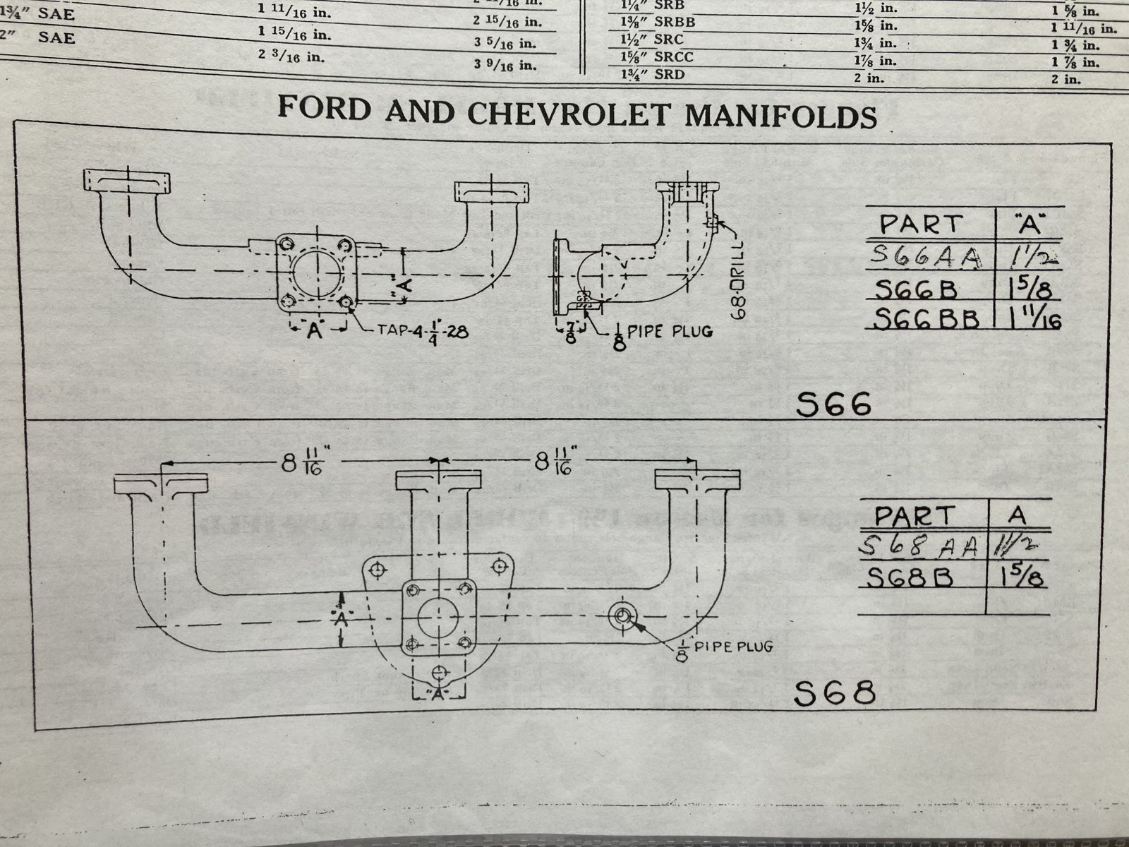

    This might be why many of the known manifolds were AA/B/BB...

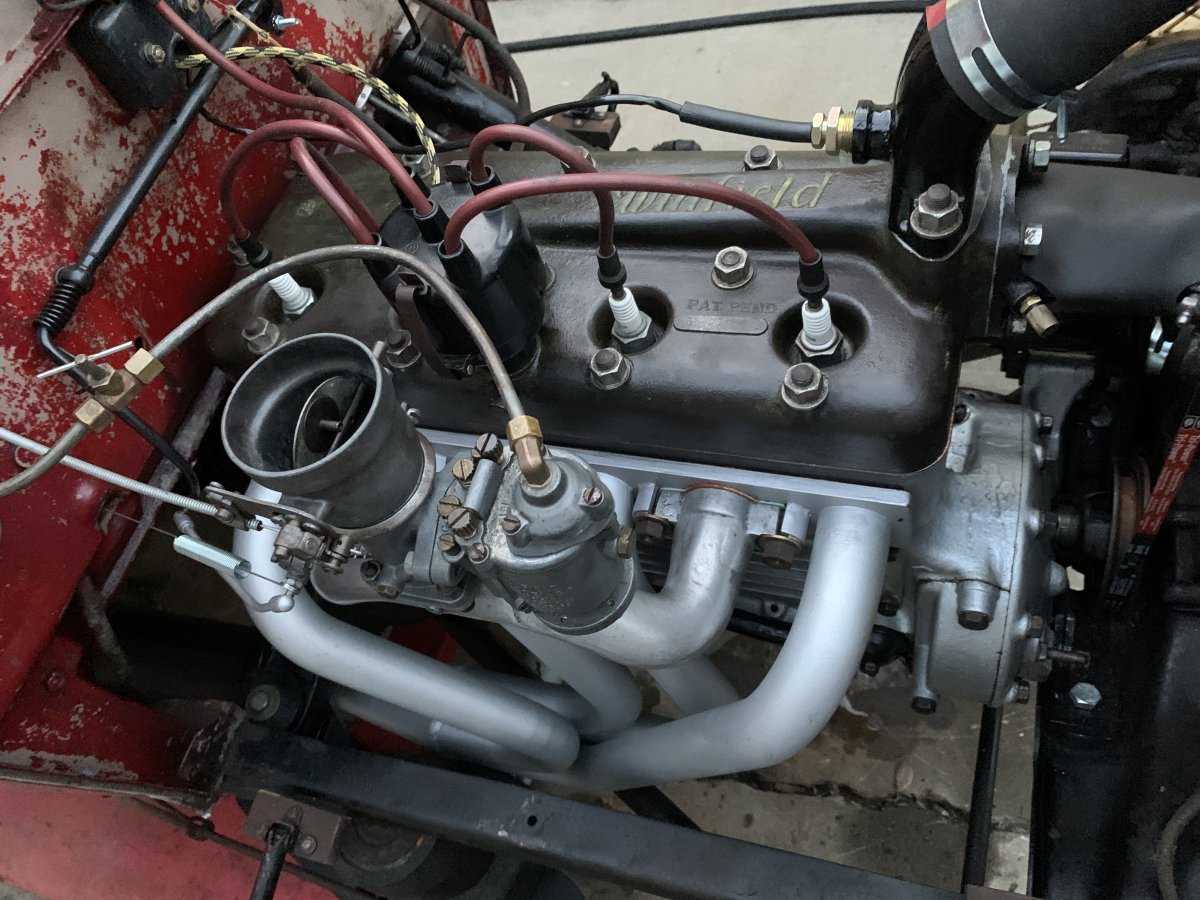

    Thanks to all of you for the information and photos covering the S 66 manifolds.
    The top manifold has a 1-5/8" throat for a "BB" Winfield and the port sizes where the manifold meets the block are 1-3/8."
    When you compare the top manifold to the lower one which is also for a BB there is a visible difference were the OD size of the runners (the left has been welded) flare out more to were they meet the flanges. This is what lead me to the question if other versions were made for "C" and larger carbs.
    The manifold below also required different molds and core boxes for casting than the top manifold. Perhaps this was a later change so the runner walls could be thicker where they meet the flanges for increased strength since quite a few of them have broken including one of these.

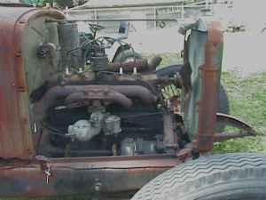

    These S 66 manifolds will also bolt onto Model T Rajo BB or BBR (racing) OHV heads without much work because the T block and the Rago and Fronty heads have the same port centers as A and B blocks have. To use one on a Fronty SR racing head, new flanges need to be welded on to the Winfield manifold to adapt it to use the Fronty vertical stud pattern.
    A Rajo BB head above with a S 66 and a BB carb.
