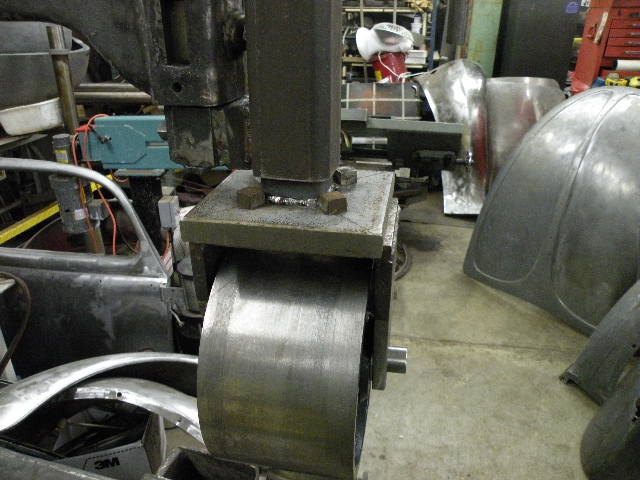

    Some updated pics of the machine
  28. scootermcrad
    Joined: Sep 20, 2005
    Posts: 12,383
    scootermcrad
    Wow! The upper wheel on that guy is m***ive! Has that created any issues for you when wheeling small panels? Pretty cool setup!

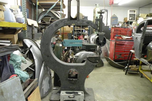

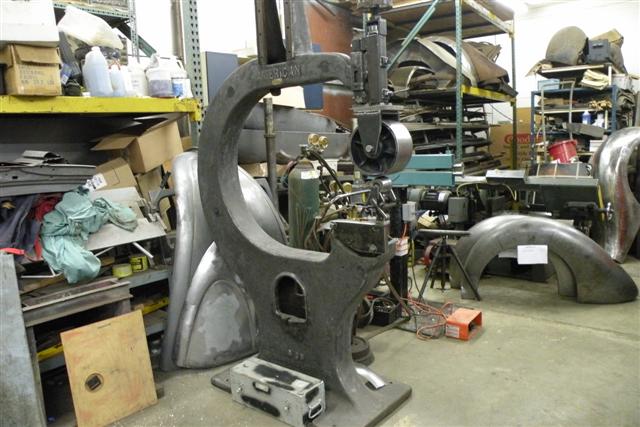

    Now just to make this clear first I did not cast or have the frame cast it is an old non working band saw I traded for, I wanted the frame for what you see here. I was also told by one of the ewheel gurus:rolleyes: that the frame would be a flexy noodle & would not work. One other piece of insight I have been building Ewheels for over 20 years & have built over 350 have them in 8 countries around the world. I dont claim to be a guru & 99.99 percent of my machines were & are box tubing frames but they are stout & work well.
    Not all band saw frames will work yes some will flex to much just like the Harbour Freight machine. This wheel is my favorite of all the large machines I have built it wheels great panels & the upper head & lower anvil cradle is rotatable so I can do long panels.It also has a great nostalga look to it. When I have my sheet metal cl***es they all want to use the cast machine (big Sally). Is it for sale sure if some one has enough cash 7K no I dont want to sell it but for that you could perswade me. I do like the looks of the new Baileigh Wheel and I do like Baileigh equipment as I am one of there distributors. Thats my 2 cents on this subject not being an ewheel guru just an old guy pounding on old rusty sheet metal wheeling new parts.
