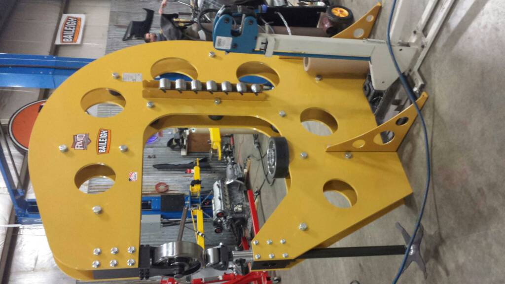

    Some more of our students tearing it up on the English wheels in our demo area :cool::cool::cool:

    English Wheel and Power Hammer heaven
    BAM!

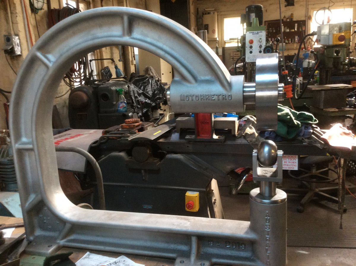

    I made the patterns for a bench Ewheel here in Sydney in 2012.
    I was attending a resto course at the local College and one of the teachers Vaughan asked me about making a pattern for himself and his mate Georgio to make a wheel each.
    As I had a machinist mate I said I’ll make the pattern Hugh can Machine them and you pay for 4 castings.
    Short story ......There has now been about 40 cast locally in Iron. Look up Motorretro.
    I modded the pattern and had mine cast in Al.....just because you could.
    It weighs half of a cast iron wheel, the boys got another done to take to car shows etc.
    First post here and I’m a bit of a Luddite but if there’s interest I’ve photos of the pattern in construction somewhere.

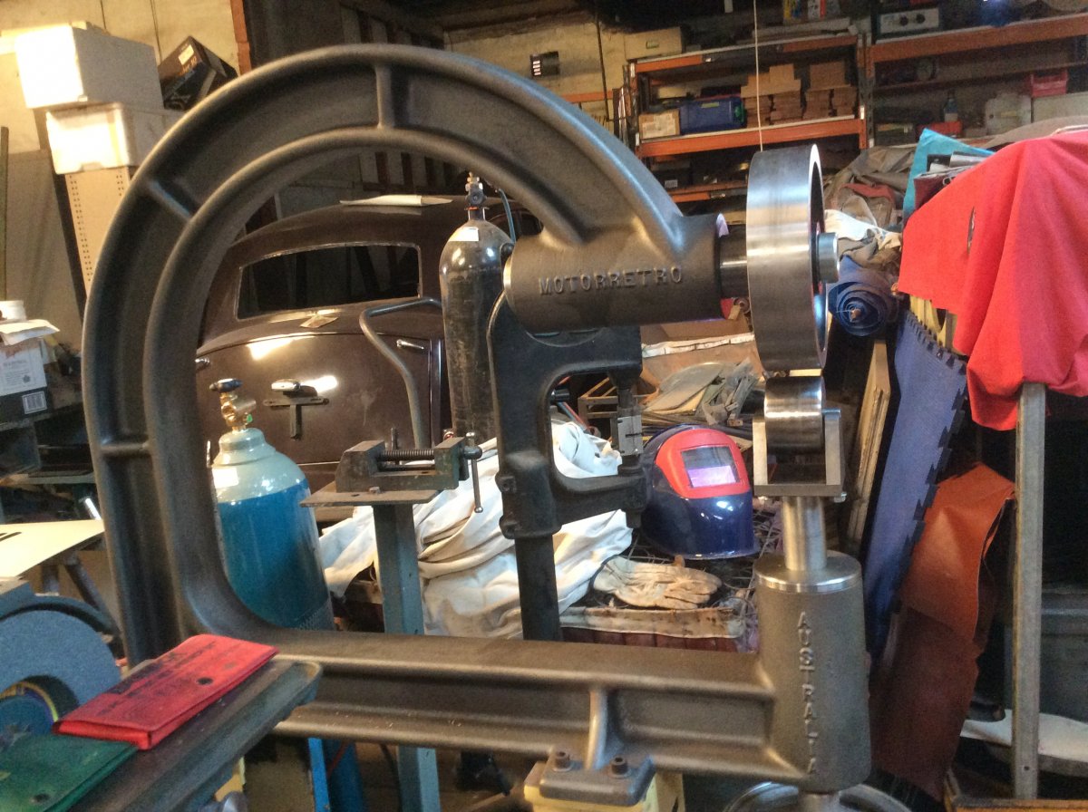

    1009C258-3248-4E6C-B97B-E18202F850C8.jpeg 329CA4D8-E921-4C52-9DDB-C9D72B5F5BE7.jpeg A049102E-E04D-41B2-A38C-679A34C68957.jpeg E47B7AA6-1BC7-4A9C-AA99-7D660DF0640C.png 01DA9F2F-06D5-4CC7-9CAE-2DA6CE01C781.jpeg B242BED4-0639-44A6-B5C4-F38D2E2861E0.jpeg A3914EBB-8B30-4769-A3F8-26330311DA52.jpeg Here’s a photo of the pattern, using the jointer as a surface plate to marl out with the height gauge. Lots of bog for the fillets.
    When I had the Aluminium ones cast I modded the centre spine from 1” to 1 1/2” by adding some 1/4” ply to both sides. The fillets were redone in plasticine as it was only meant to be a one off.
    Also a better photo of the Al wheel, I had the casting heat treated so whilst not as stiff as the iron it’s ok for an amateur like myself.
    A few iron casting ready for machining.
    Plus a photo of the Al casting just out of the sand, runners still attached.
