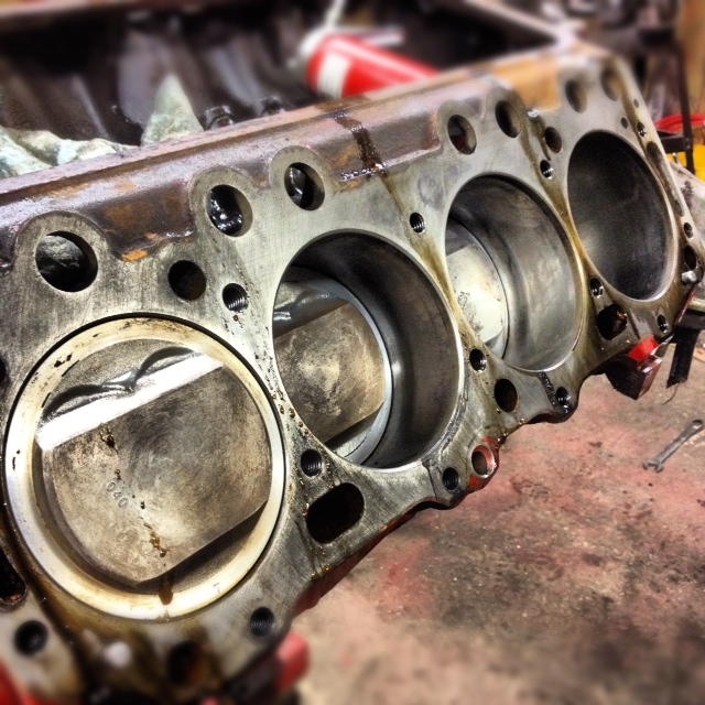

    I don't have any great pics of our 425 Nailhead right now because the heads are currently out getting the run-through. So these will have to do:
    425 nailhead, 40 over going in a '30 A coupe. It was saved from the s****per. I will share pictures when it's painted and fully dressed :)

    Whatever you do, DO NOT let them try and put hardened seats in those heads. The odds are they will ruin the heads, and they don't need them.

    Thanks for the heads-up. the guy who built it before us actually did the ruining :). The guy who is doing the work actually has done 5 nailheads so far this month so we trust him. Someone already had the heads ***-backwards so hopefully it'll run much better now. Will double check with him on the hardened seats.

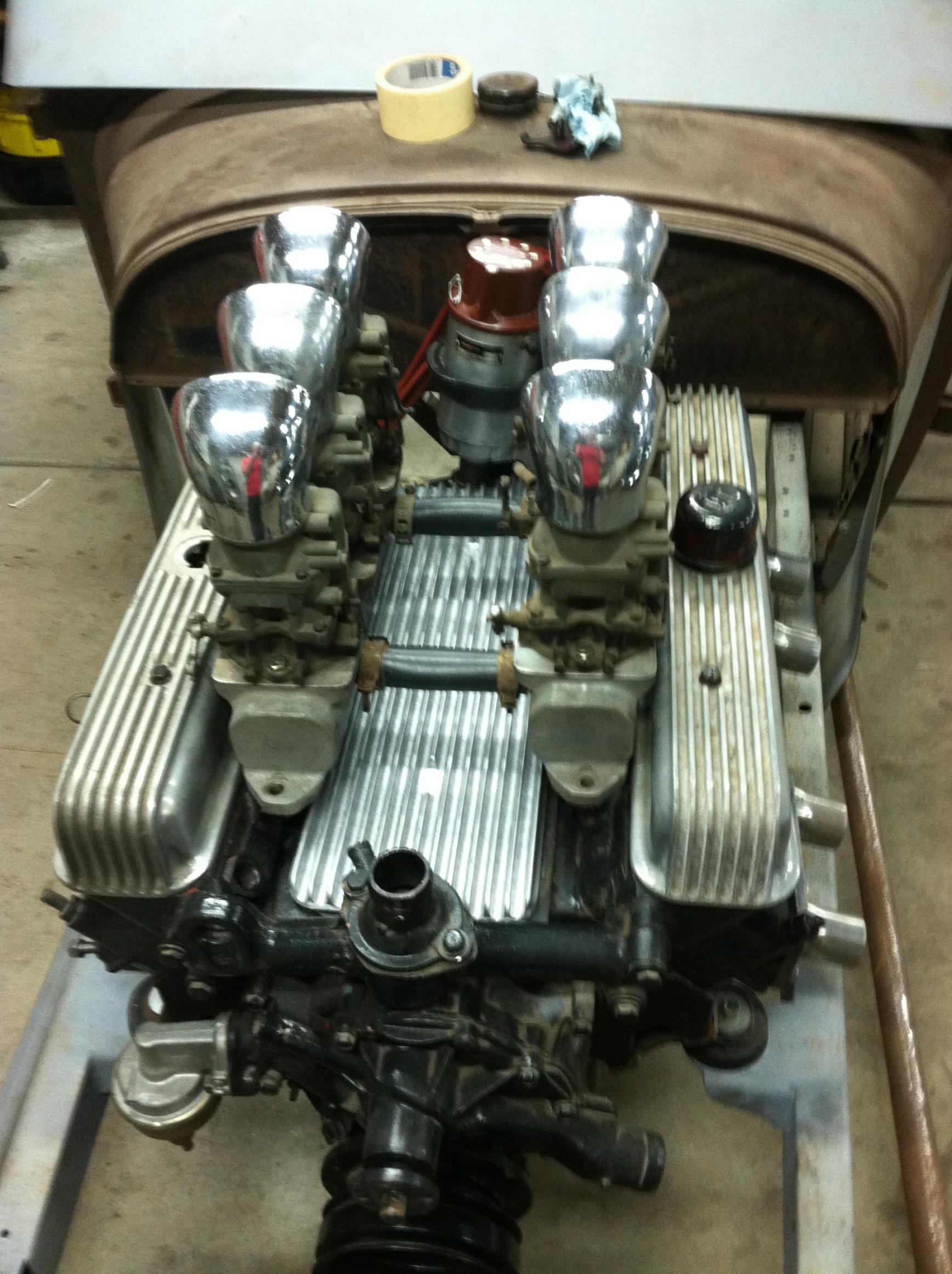

    So what's this intake?! Where did this come from?
    Haven't seen cast 2x2 nailhead intake before this...

    Both Golden and Edmunds made 2x2's for the 264/322, that one looks like an Edmunds.

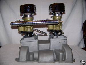

    Heres and edmunds

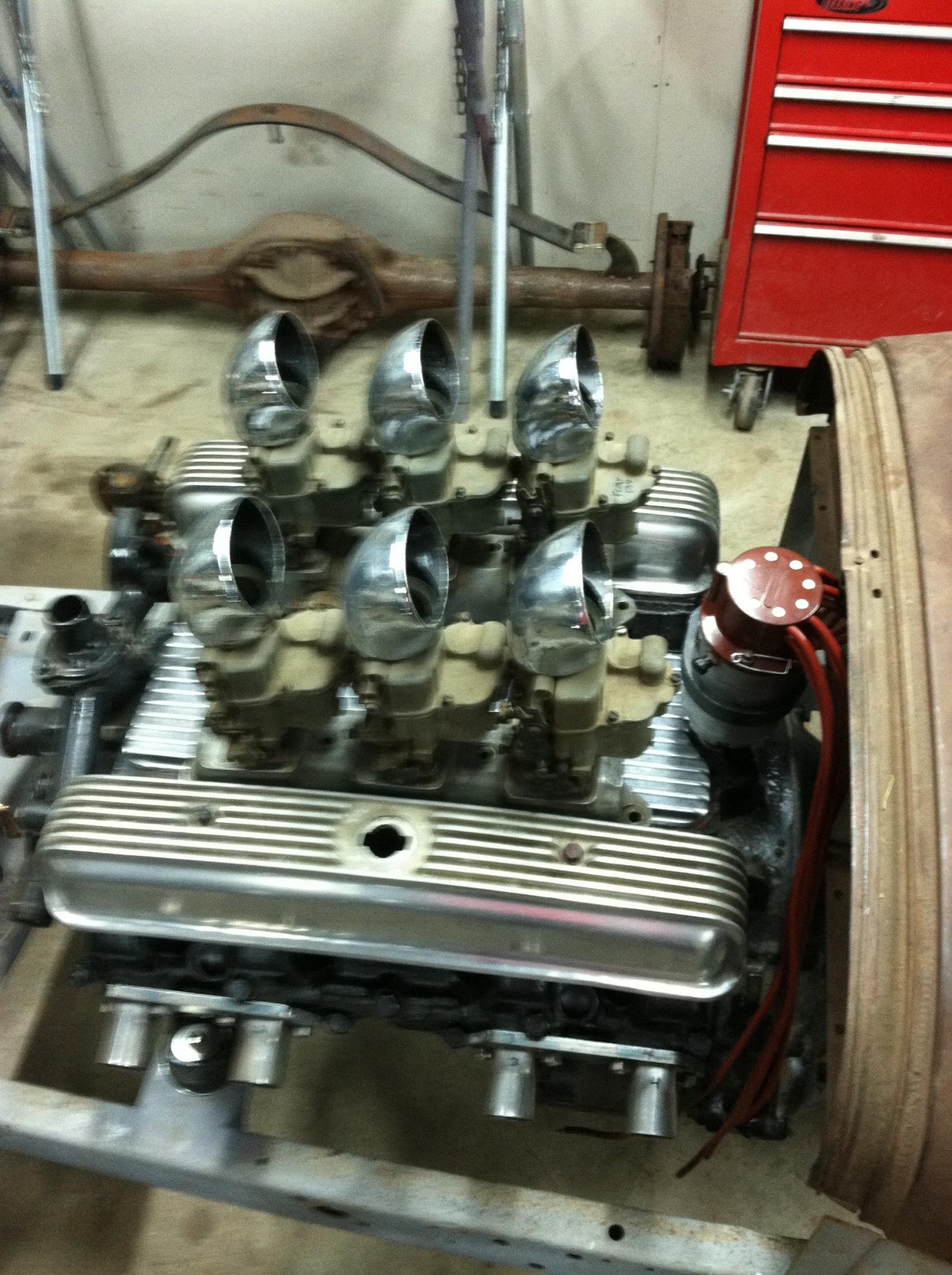

    Yes, I took, and it was installed back to '57 couple months ago. Here's what it looks now:
    It is '57 364 cid nailhead with Offenhauser 3x2 intake (cast in 2002) ,good ol' Rochesters carbs rebuilt by me. They're set up progressively using Eelco linkage. Fuel is being fed with mechanical fuel pump and distributed through Offy fuel block. Fuel pressure gauge is unknown brand. There's vintage Mallory Rev-Pol flat-top distributor... well, ok it is originally Mallory Double-Life that originally started it's life as a sb Chevy unit, we converted it to work on a nailhead. Thanks to JouniK and his brother Jake for work on a lathe! Now it is disguised as Rev-Pol with polished br*** parts. Valve covers were designed by me and cast in Finland Also valley pan is designed by me, cast in Finland. Polished all aluminum and br*** myself, including intake and distributor... Colour is mixed between two colours with bigger metal flakes.

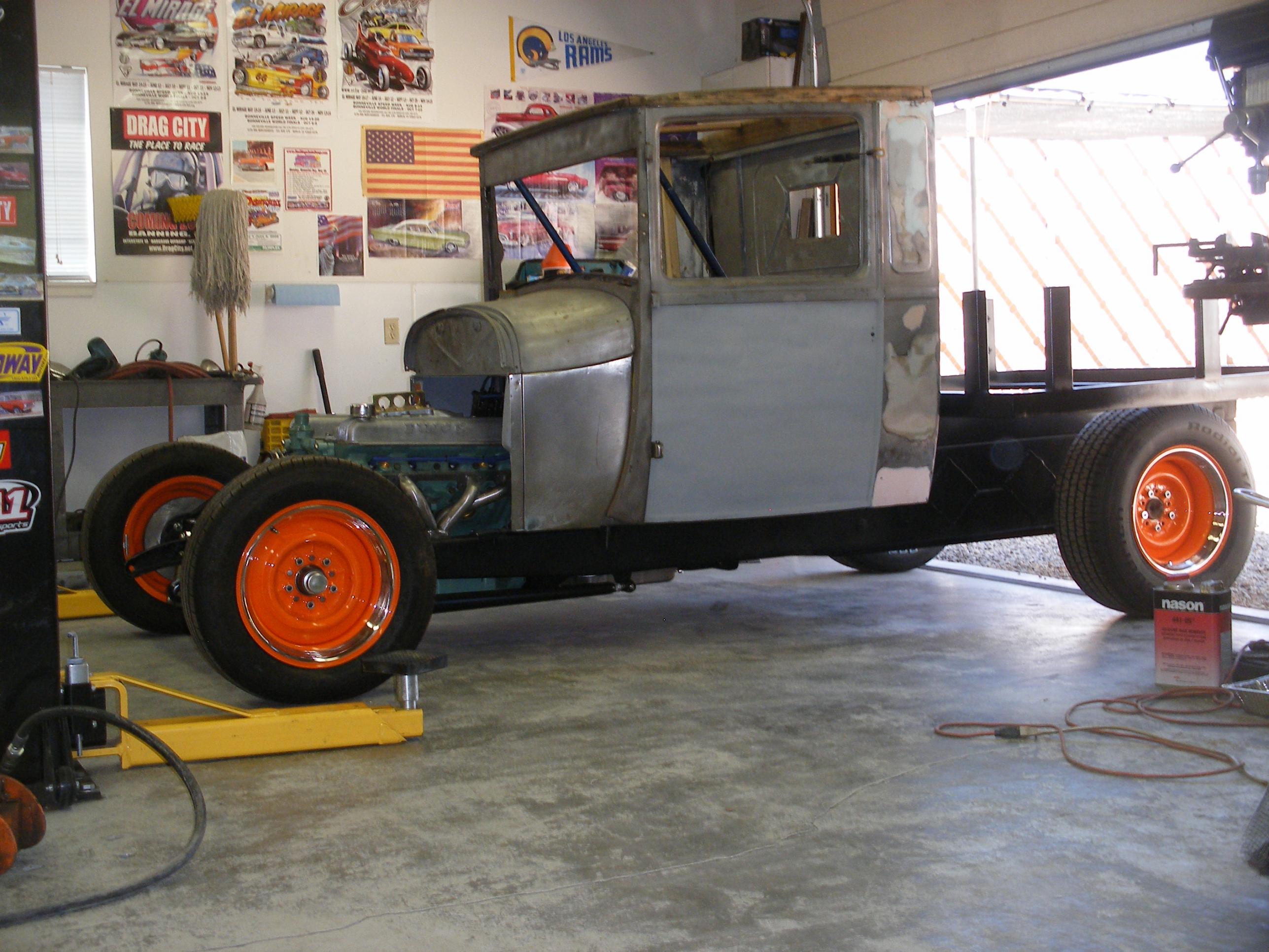

    under conscrution, 28 flat bed
