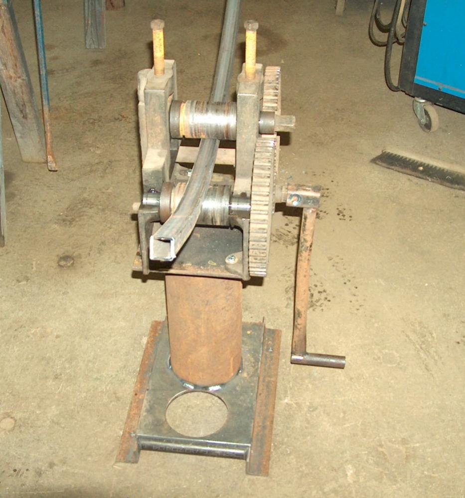

    Hey everyone, I just wanted to share this real quick...
    ...Another generous HAMBer let me use his roll bender to make some hoops for a project I'm just finishing up. It's an HF unit, and for what they go for, with a few modifications it could be decent for hobby use. They can be mounted to a bunch, or what not, but I decided to make a stand for it since long tubes need a little man-handling to keep from twisting as they get rolled through....
    Rolling 1.5" x .120" wall tubing. Not bad. Just time consuming. In 10-foot lengths it took about 20 minutes to roll each length into a full half-circle with a radius of approximately 36".
    If you invest in one of these, consider making some longer side plates to set the lower dies further apart, shim the dies so they are perfectly aligned (thus helping to prevent that twist), consider using a motor drive unit of some kind, and there are people making additional dies for these.
    Just wanted to share.
