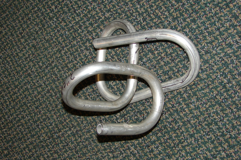

    it may sound nutty but it worked for us. To do exhaust stuffs we tack welded the 1.3/4" exhaust tubing to the die and obtained very nice bends. There is mild deformation but if a customer needs exhaust tubing bent and you have the correct size die- it is possible. Our use was for zoomie headers for a FED.

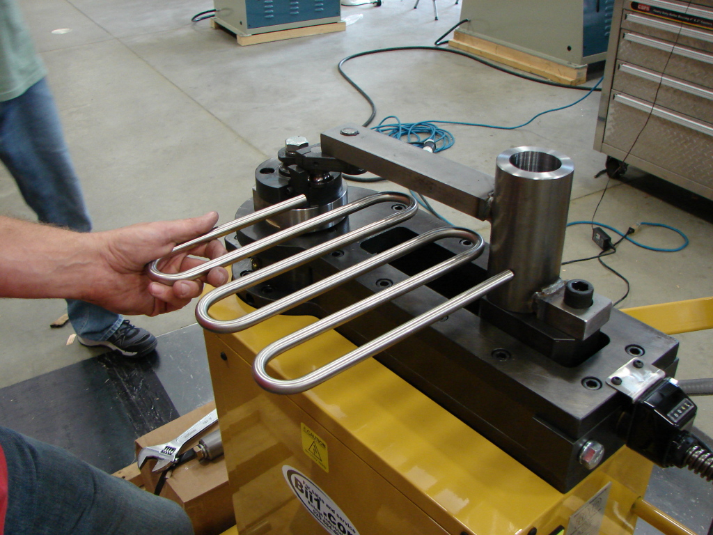

    your the man, so i have been asked about bending polished stainless tube, 1-1/2" with a 1/16" wall, i'm pretty sure its going to need a little repolish afterwards, i've heard that other shops just will not do it? thanks
  24. BAILEIGH INC
    Joined: Aug 8, 2008
    Posts: 3,629
    BAILEIGH INC
    Alliance Vendor
    If your stainless tube or pipe has a #3 finish, it will bend up nice with standard tooling, like this.
    If your stainless has a mirror # 8 finish, special tooling might be required.
    With the correct tooling, a true radius die and a nylon or plastic counter bend die or plastic rollers, you can bend stainless with virtually no marks.

    We've talked about using plastic strips for lube, but never heard of nylon tooling...could you tell us a little about it?
  28. BAILEIGH INC
    Joined: Aug 8, 2008
    Posts: 3,629
    BAILEIGH INC
    Alliance Vendor
    Notice there is not a counter bend die on this bender. They are actually nylon rollers. Bends up stainless real nice!
