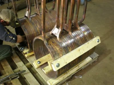

    Alright, Ill throw a curveball. The material is T-110 Copper tubing 1.13" x 1.13" square x .63" round ID tubing. It comes in 40' lengths from Finland.
    I anneal the tubing with a natural gas torch as its pulled around a buck. Basically there is a 22" diameter drum supported horizontally by two a-frames bolted to the floor. (I wish I had a picture of the fixture) On the right side of the a-frame is a pulley, attatched to the pulley is a cable to an electric hoist.
    As I anneal the tubing i bump UP on the crane to wrap the tube around the drum about 40 degrees at a time. 160' of tube and hours of silver soldering later I have super secret cooling coils. You dont see these everyday.

  23. Square tube with a round ID... You're right, you don't see that every day. Neat stuff!
  24. SniffnPaint
    Joined: May 22, 2008
    Posts: 434
    SniffnPaint
    Yes super secret.
