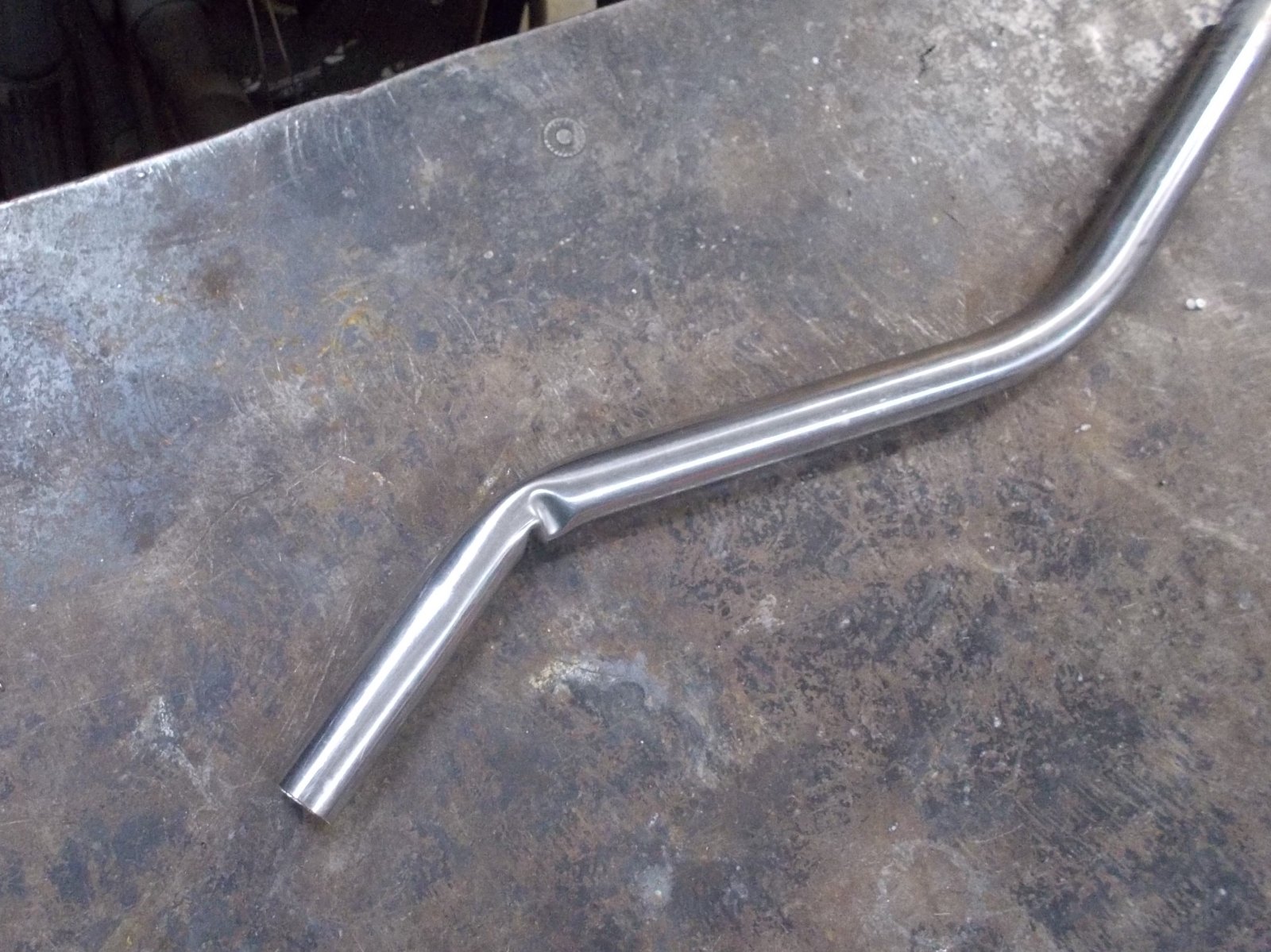

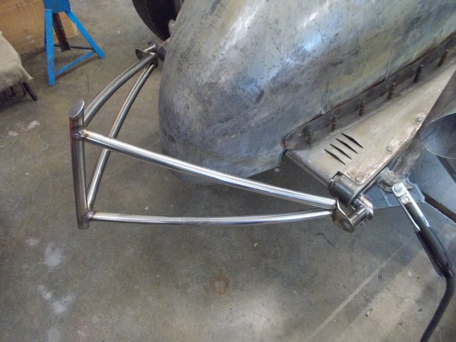

    This brings to mind a question I have about bending up some stainless steel crash bars for my champ car replica. There is a boat salvage yard close by that has piles of stailness boat railings. I would like to use it for crash bars and side nerf bars. I can buy the stuff for cheap. I made up a rear crash bar using the existing gentle boat sweeps. For the rest of the bars it will require tighter bends than the pieces of boat railings currently have. The wall thickness is thin - maybe .050", and my efforts to bend it in a Diacro bender were not successful. It buckled. Since the stainless is already polished I am reluctant to fill it with sand, cap it and use heat. That will ruin the surface finish.
    Any other ideas on how to bend thinwall polished stainless while maintaining the polished surface?
    INVISIBLEKID likes this.

    A shop that builds hydraulic power units will have tube bending equipment but you will only have one choice of radius, if that matters. You can coat it with grease to cut down on the scuffing but will still likely have to repolish it.
    THE FRENCHTOWN FLYER likes this.
