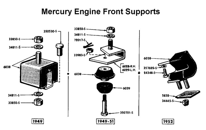

  15. Randy P
    Joined: Oct 3, 2006
    Posts: 437
    Randy P
    from Austin, TX
    Those are stock '49-'51 Mercury flathead motor mount spacers! The mount on the Merc water pumps sat on top of these spacers. The 3 holes on top are not stock, it should have had a stud sticking up. They could have very well sat a SBC on top of those mounts using the early 283 style brackets or something else or homemade, might account for the removal of the studs and addition of the extra holes.
    The same spacer is often used to put a 59AB flathead in 1933-34 Fords, had them in my '34 with a 59AB, and it's very similar to the u-shaped spacer that Ford sold for the job.
    Here's a picture, courtesy of google and Van Pelt Sales:

  18. INVISIBLEKID
    Joined: Jun 19, 2006
    Posts: 2,647
    INVISIBLEKID
    from Gilroy,CA
    ^^^^^^ For sure Merc Stuff! Pics are mounts from my 50. The stud has been removed,and a few holes added.
  19. Lono
    Joined: May 10, 2007
    Posts: 1,656
    Lono
    I suspect they were adapted to accommodate a SBC set up... hot rodding at its best.
