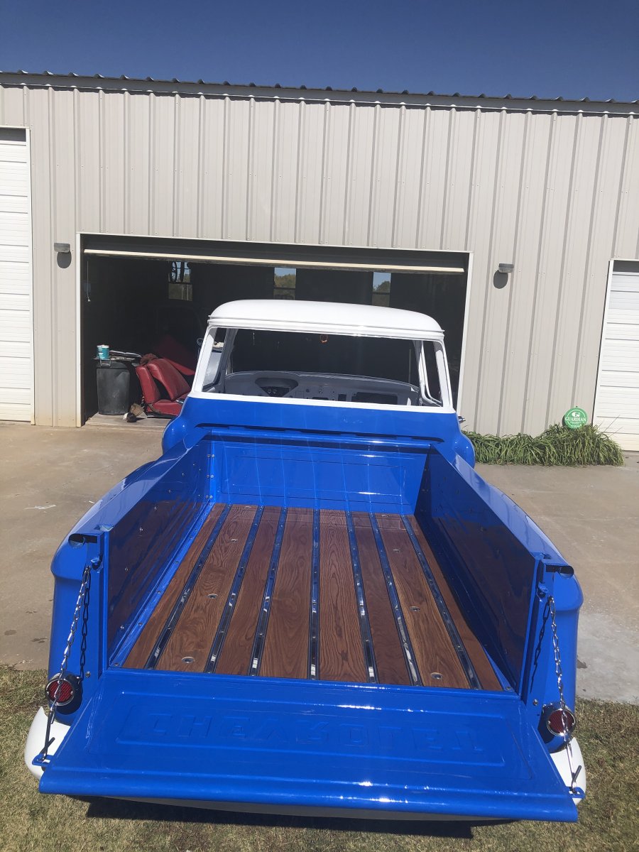

    Pushed the Okie Apache outside for a few photos. Still have a few things to finish up. He wanted to post some update pics. I like the way it sits. No blocks or bags.

  24. rgdavid
    Joined: Feb 3, 2014
    Posts: 346
    rgdavid
    Idea... put some cut up bicycle inner tubes on the tailgate chains to stop scratching the nice paint job.
    Roothawg and loudbang like this.

  30. Dan in Pasadena
    Joined: Sep 11, 2009
    Posts: 867
    Dan in Pasadena
    Your local bike shop will usually have "roadie" inner tubes in their trash they'll give you if you ask nicely. It's what I use because they fit tightly, look better than the larger ones from mountain bikes. The UV eats them up so plan to replace often but they fit tight and work great.
