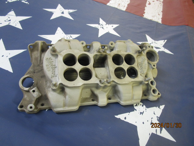

    These manifolds aren't worth much anymore to sell so thought I would build a high revving 301-302 SBC around it. What's the best old school cabs to use? Yes, I am aware that a modern single 4 and manifold will produce more power/torque, boring! Thanks! IMG_4512.JPG IMG_4513.JPG

    I dual quads on my early Olds powered roadster. If you are looking for the late 50's to mid 60's look find a couple of Carter 3720 or 3721 AFB'S they will bolt right on. Holley's will not fit this manifold as they are too long to fit end to end. Edelbrocks will work but they are not near as good a carb as the genuine Carters are.

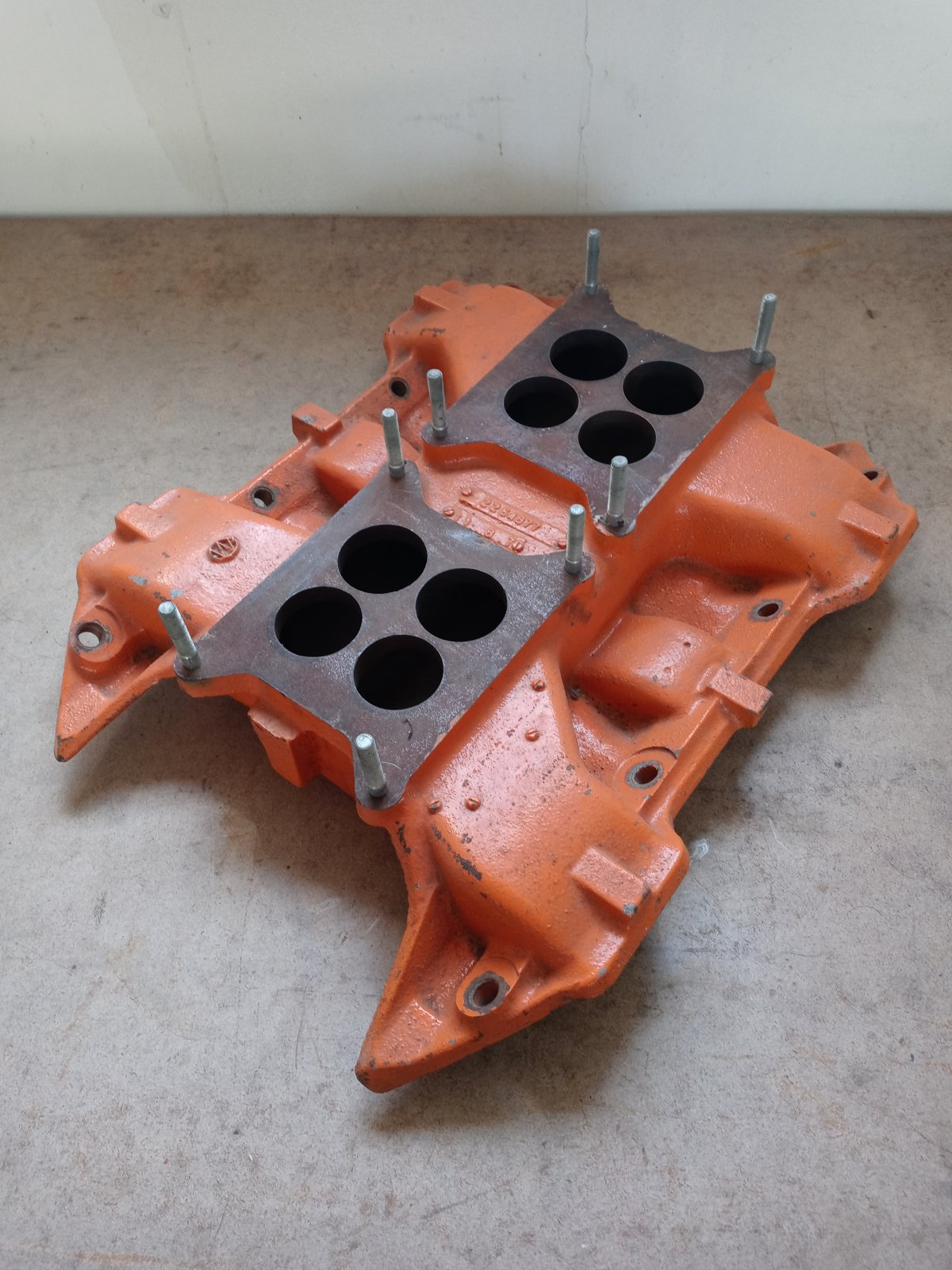

    Nothing like the feel and sound of that second carburetor opening up.
    Bought this early cast iron OEM for my RB440 just to have the option.
    Don't tell my mother. LOL

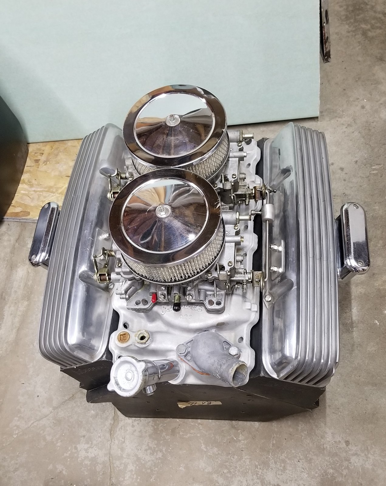

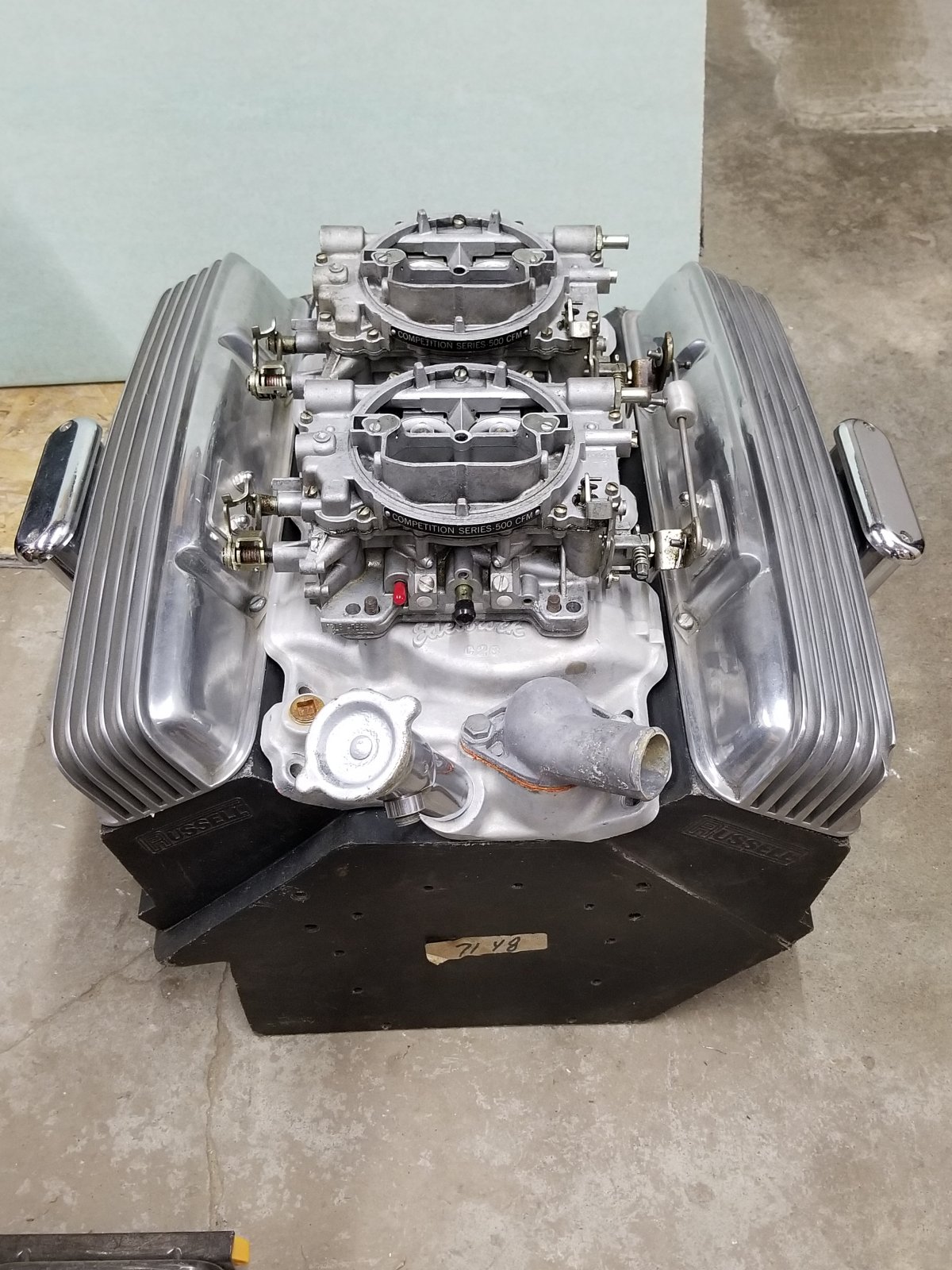

    Mocking this up for my 327 (331). Going with modified Eddy 500’s because I’m familiar with them.

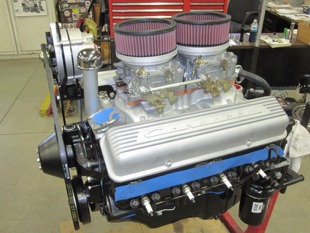

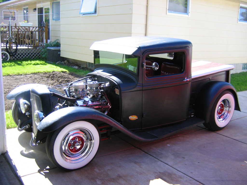

    The 1956 Packard Caribbean in my '55 Studebaker 3/4-ton pickup.

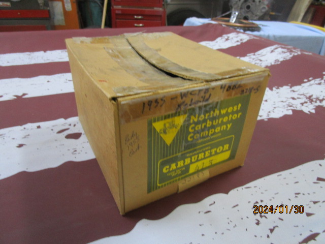

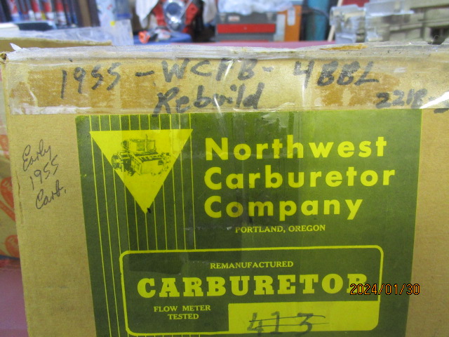

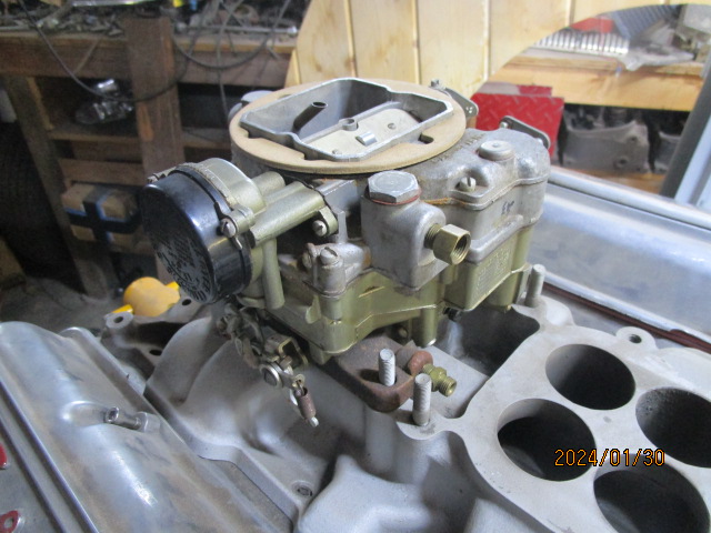

    I did find this carb that has been on the shelf for decades, box says early WCFB 2218-S, would this work and if so where to get another? IMG_4524.JPG IMG_4525.JPG IMG_4526.JPG

    This is how your intake will look with a pair of Carters, like was mentioned Holleys will not fit.

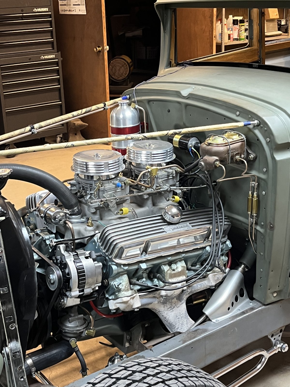

    Love dual fours, scored this complete set up at a swap meet for a steal a month ago[​IMG]
    have another set in the background that I am still trying to put together correctly.
    Then have dual quads on my 33. Running old Edelbrock's from the late 80s and been a really good set.
