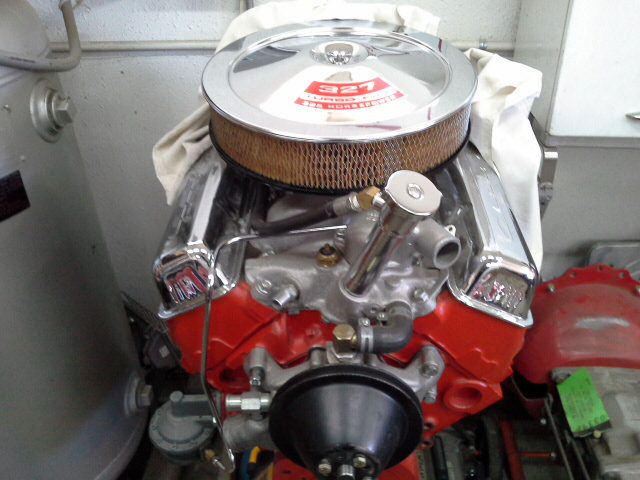

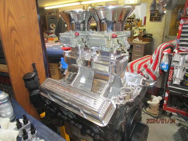

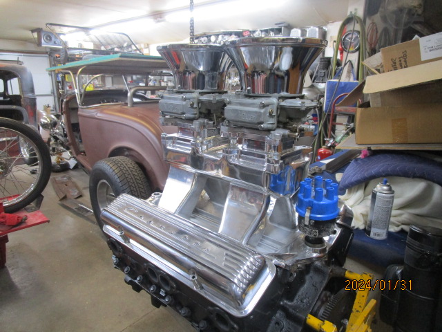

    '63 or '64 Corvette ran a set up like that with a Horizontal PCV valve inline to carb from the factory. Their fill cap was not vented but can't remember where the air inlet was from. If you have the rite block you can run a catch can under manifold than a PCV & grommet from hole next to dizzy. I know I need pics it would explain it better! I will be doing something like that with my tunnel ram & Vet covers. IMG_4533.JPG IMG_4534.JPG

    They were vented at the road draft tube at the back of the block.
    I ordered a corvette kit from Eklers, the pcv that screwed into the oil fill tube was backwards flowing for what was needed, so be careful what you buy if you go for something like that.
    I ended up just going back to a vented oil fill

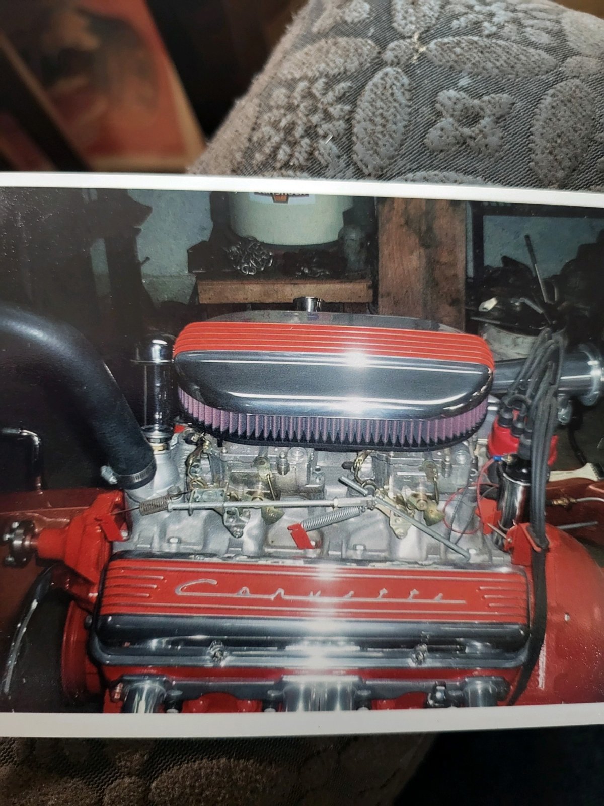

    31657.jpeg Here's my roadster...Mark gets upset when I show my other 2x4 intake:p

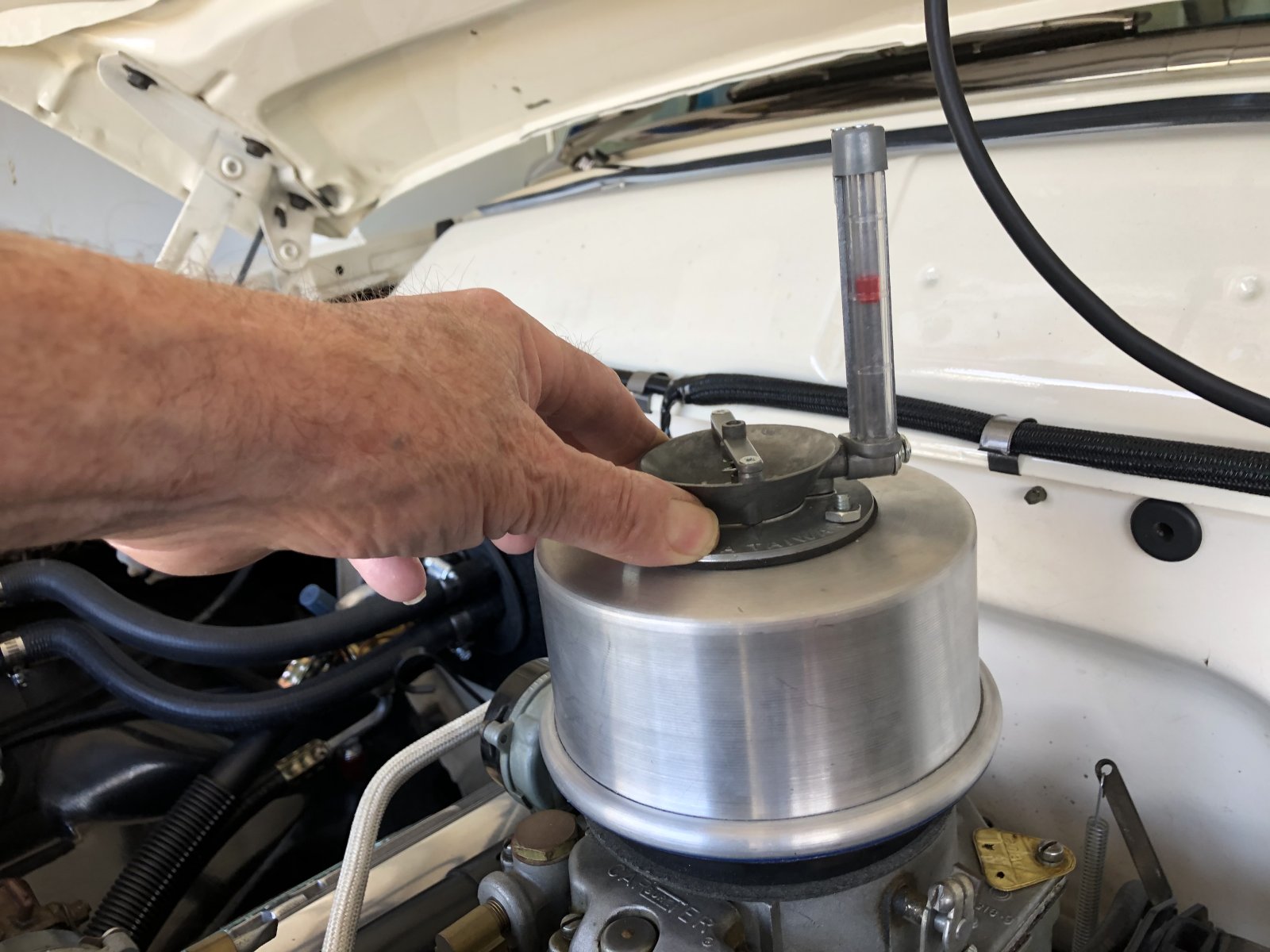

    From experience, if one wants to add a PCV to early 2x4 carbs and intakes, plan on having a direct reading O2 sensor at hand. It's almost impossible to get the idle air-fuel ratio right by ear, since the PCV is a controlled air leak beneath the ****erflies. Sometimes, there's sufficient adjustment in the carb idle circuit, sometimes, there's not.
    Most early 4-bbls have a secondary idle circuit and the OEM 2x4 carbs closed that off, as having eight idle circuits was too much and very wasteful of fuel on decelleration.
    Cadillac posted a Service Letter to dealer service departments detailing how to set up and tune the then-new 2x4 setups. It's still the bible today.

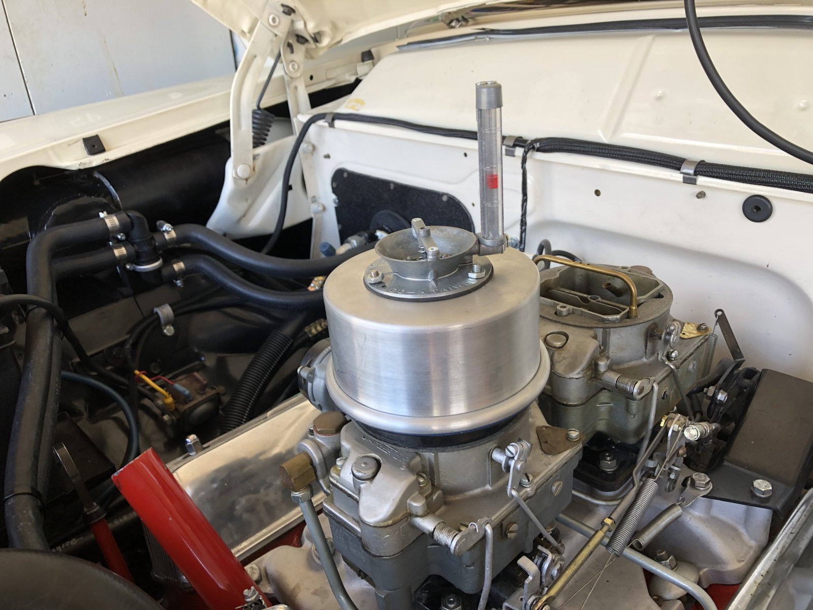

    ^^^^^^ This has always worked for me. There is only an idle circuit on the front barrels on early WCFB’s. I idle on both and run on the rear carburetor. The exhaust is always clean along with the factory tips that are thru the bumper. You will notice at idle both carbs are very close to the same air flow. After 5 years they are still the same. IMG_3732.jpeg IMG_3728.jpeg

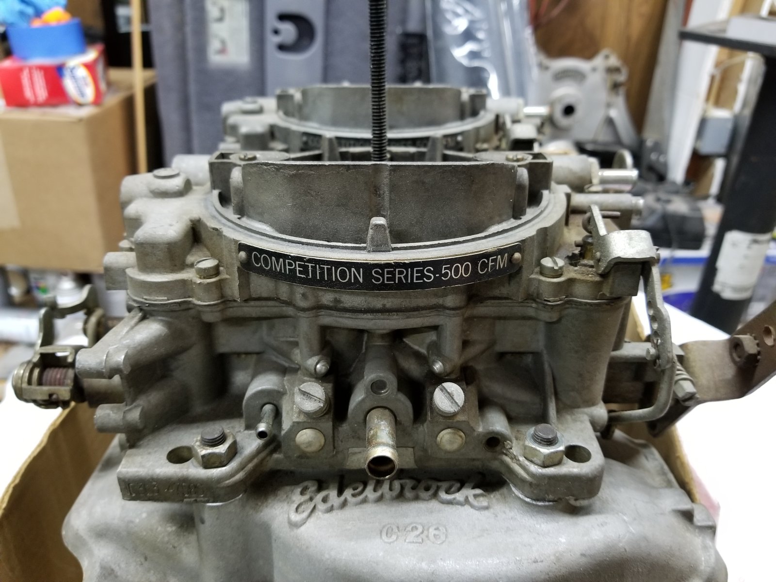

    I have dual quads on an Edelbrock C26 like the OP posted. Two new-ish Edelbrock AVS2 500 cfm, rear is electric choke, manual choke on the front. Both needed some work out of the box to run right, along with some adjustments to the ignition system. Engine is a Chevy 350 ci, 290 hp crate engine. The idea that dual quads have to get poor fuel milage is a fallacy. The last 250 mile trip I took with this car I averaged 21 mpg.

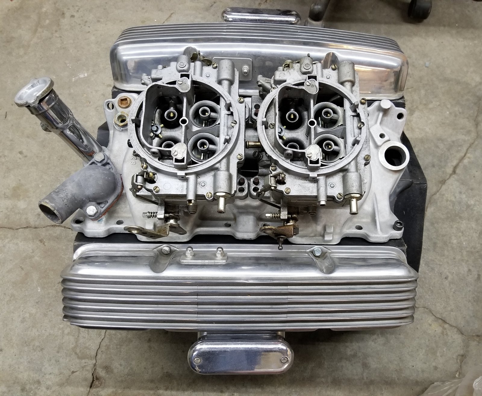

    I picked this up to get a carburetor for another project car, the front is a 500 cfm that looks to have never been used, the "other" carburetor is a "junk" parts carburetor. It was an impulse buy, something I've dreamed about for almost sixty years, not sure what I will put it on. IMG_5581.JPG
