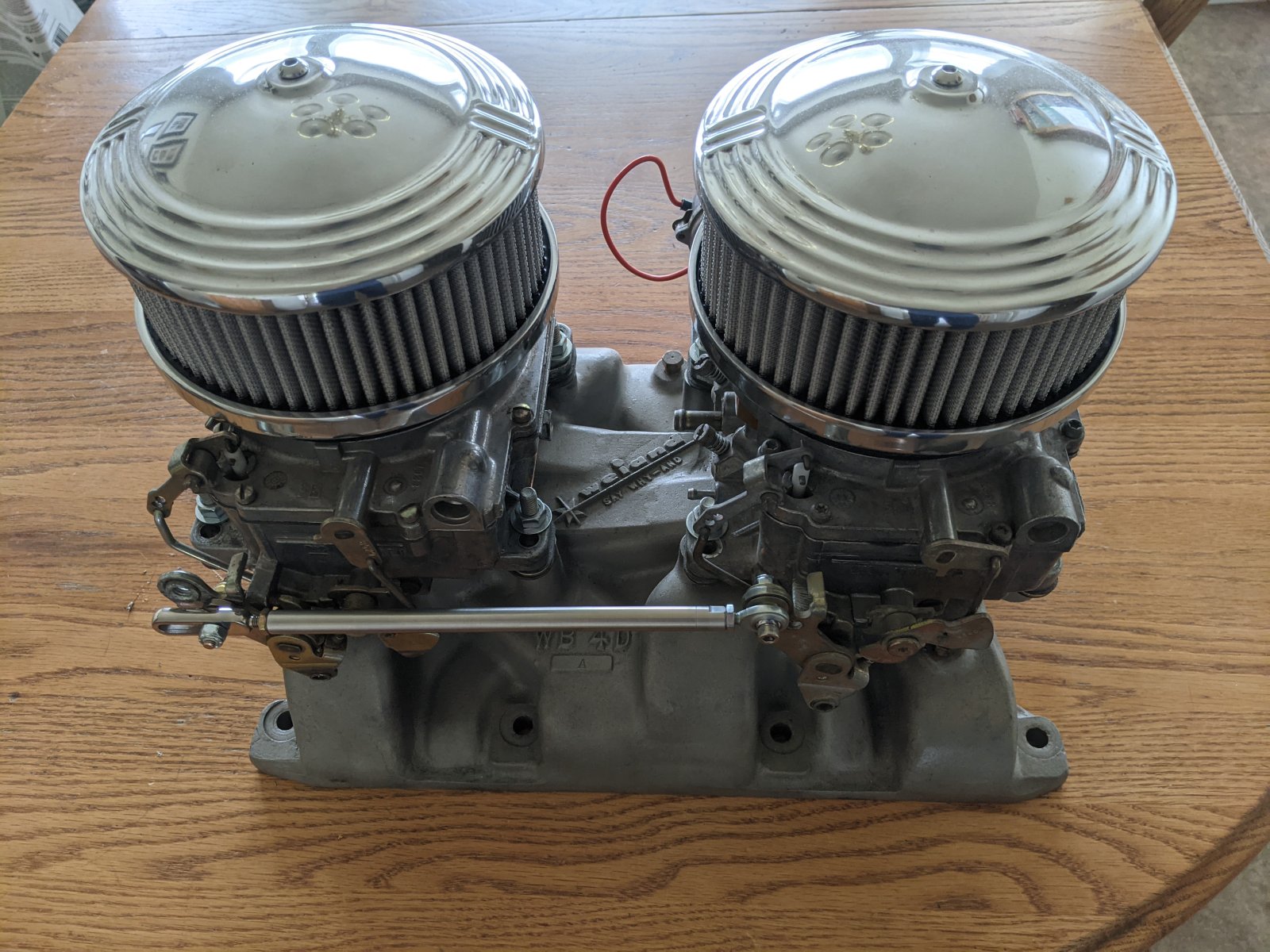

  4. jimmy six
    Joined: Mar 21, 2006
    Posts: 17,073

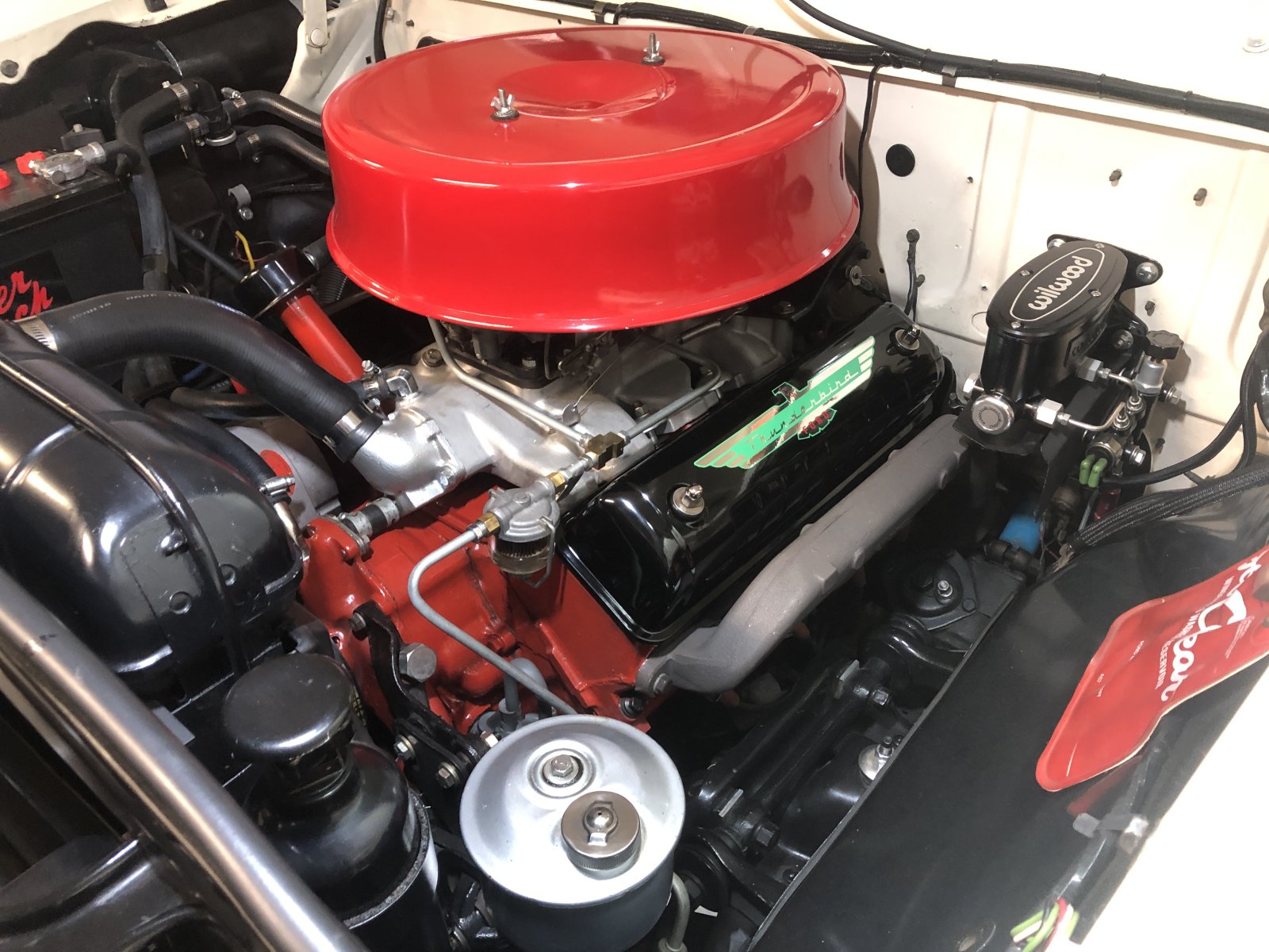

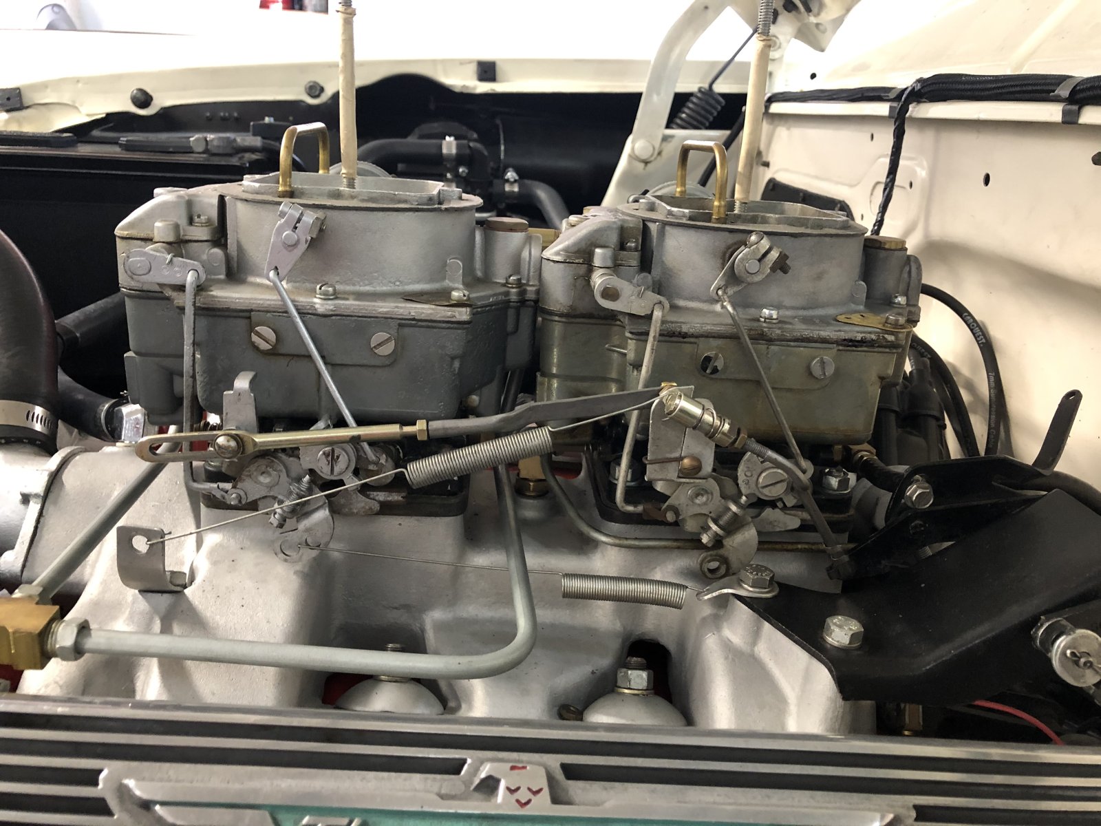

    jimmy six
    Since I run them and have for years it’s the “look” factor especially on a YBlock Ford. I’m not taking bling because the only part that’s aluminum is the intake manifold and there are no chrome parts on the originals. IMG_5806.jpeg IMG_5805.jpeg

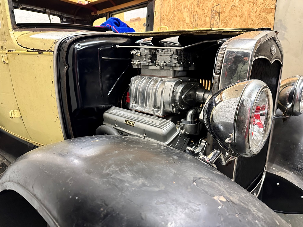

    resized.JPG i've got a pair of carter compe***ion 500's here. I'm struggling with fuel lines and getting the throttle cable to work with them. I'm sure i will figure it out eventually... Not a lot of room under the hood of a Model A with all this in it though.
  9. Taboo56Chevy
    Joined: May 21, 2018
    Posts: 2,048
    Taboo56Chevy
    Do you have a picture of your front belt setup for that? Ive always wanted to stick a 4-71 on the small block in my 33 pickup, but that was always the hangup was the front belts pushing to forward causing alot of firewall recessing I don't want to do.

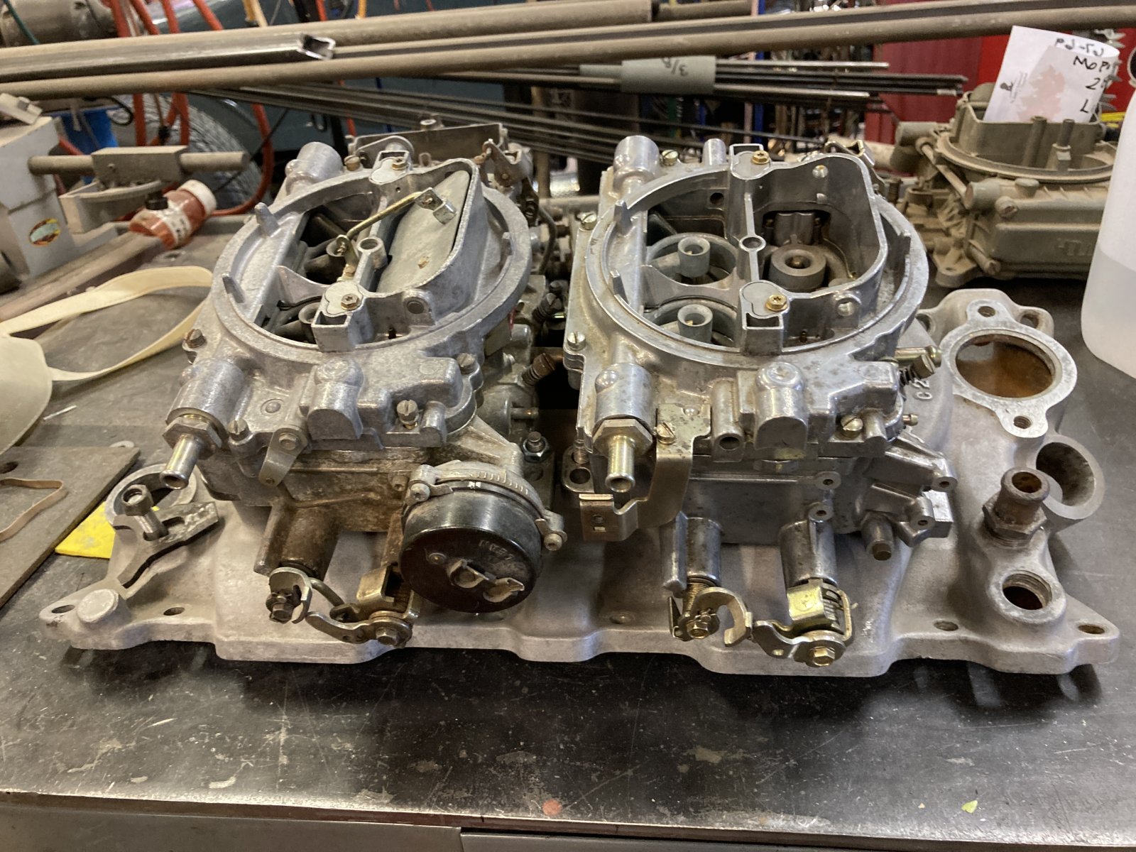

  13. flynbrian48
    Joined: Mar 10, 2008
    Posts: 8,699

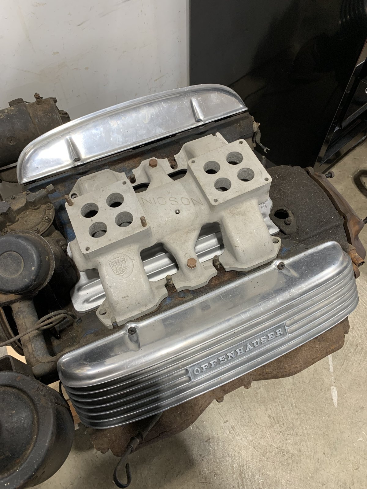

    flynbrian48
    This is the Offy dual quad intake with Edelbrock 1405's in my '34. The carb bases on this intake are much further apart than on your E intake, so I had lots of room, but it put the rear carb very close to the distributor. It also ran way to lean at idle so the front (secondary) carb had to have the idle jets opened up in order to run right. The progressive linkage worked very well, the engine was a screamer. I didn't get inside it, it was alleged to have a 327/350 horse cam, it had double hump heads and had, again allegedly, 10.5/1 compression. Great little engine.
    Outback, enloe, Deuces and 5 others like this.

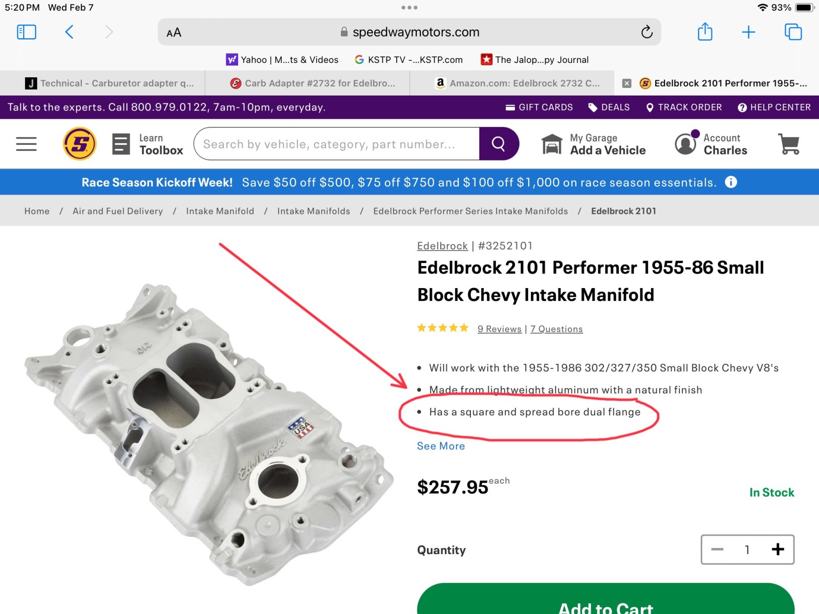

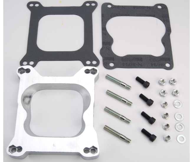

    @carbking or anybody with knowledge…
    Thoughts on the spread bore (manifold / Offenhauser) to square bore (Edelbrock) carb adapters? Are they needed?
    Edit: Since posting this I have determined that the dual bolt flange on most aftermarket manifolds is a hybrid flange and designed for either square or spread bore carbs. Also, the ****erflies on my Eddy 500 are not “square”. Primaries are 1&7/16” and secondaries are 1&11/16”. I’d agree that spacers are not ideal, but won’t completely discount them as they do add to the plenum volume and that might make a difference. Only testing would answer if they help or hurt. They certainly don’t look good and introduce twice the amount of leak potential. I will not be using spacers and will pay close attention to the “fit” or “seal” of the carburetors.
  20. carbking
    Joined: Dec 20, 2008
    Posts: 3,963
    carbking
    Since you asked, I am NOT a fan of square bore/spread bore conversions. Period!
    Either pick the intake you like OR the carb you like and then acquire a carb to match the intake or an intake to match your carb.
    Jon

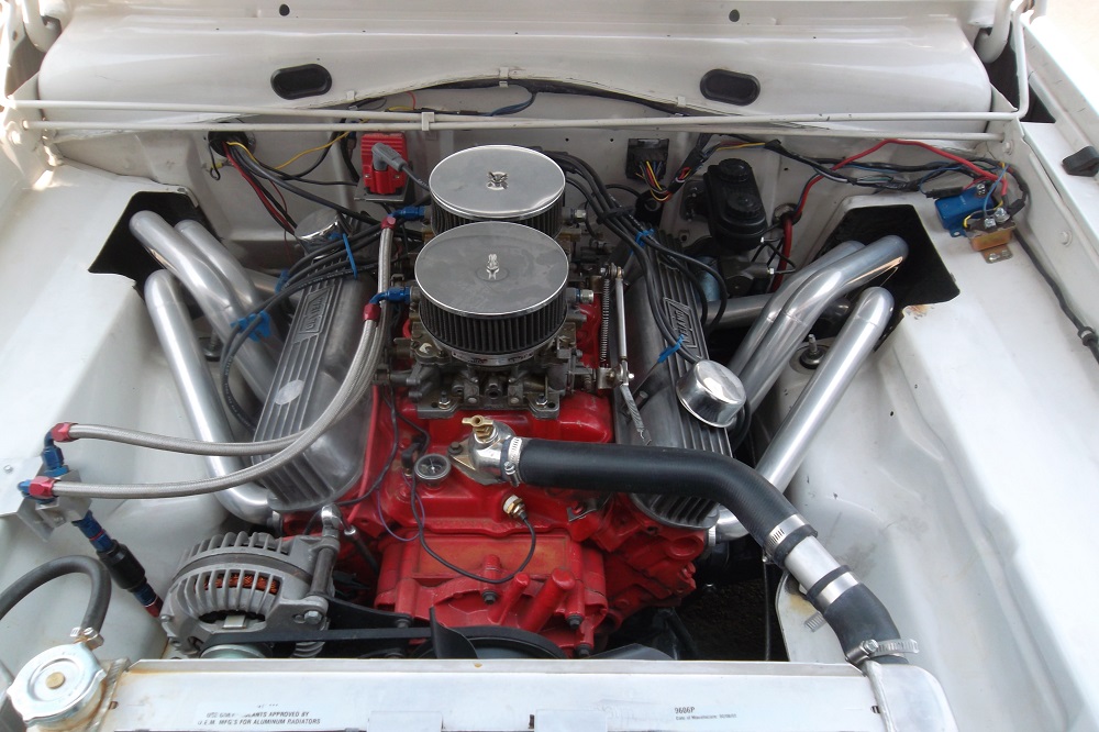

    My 64 Dodge Dart
    The firewall has been recessed and modified quite a bit but i wanted it to look stock
