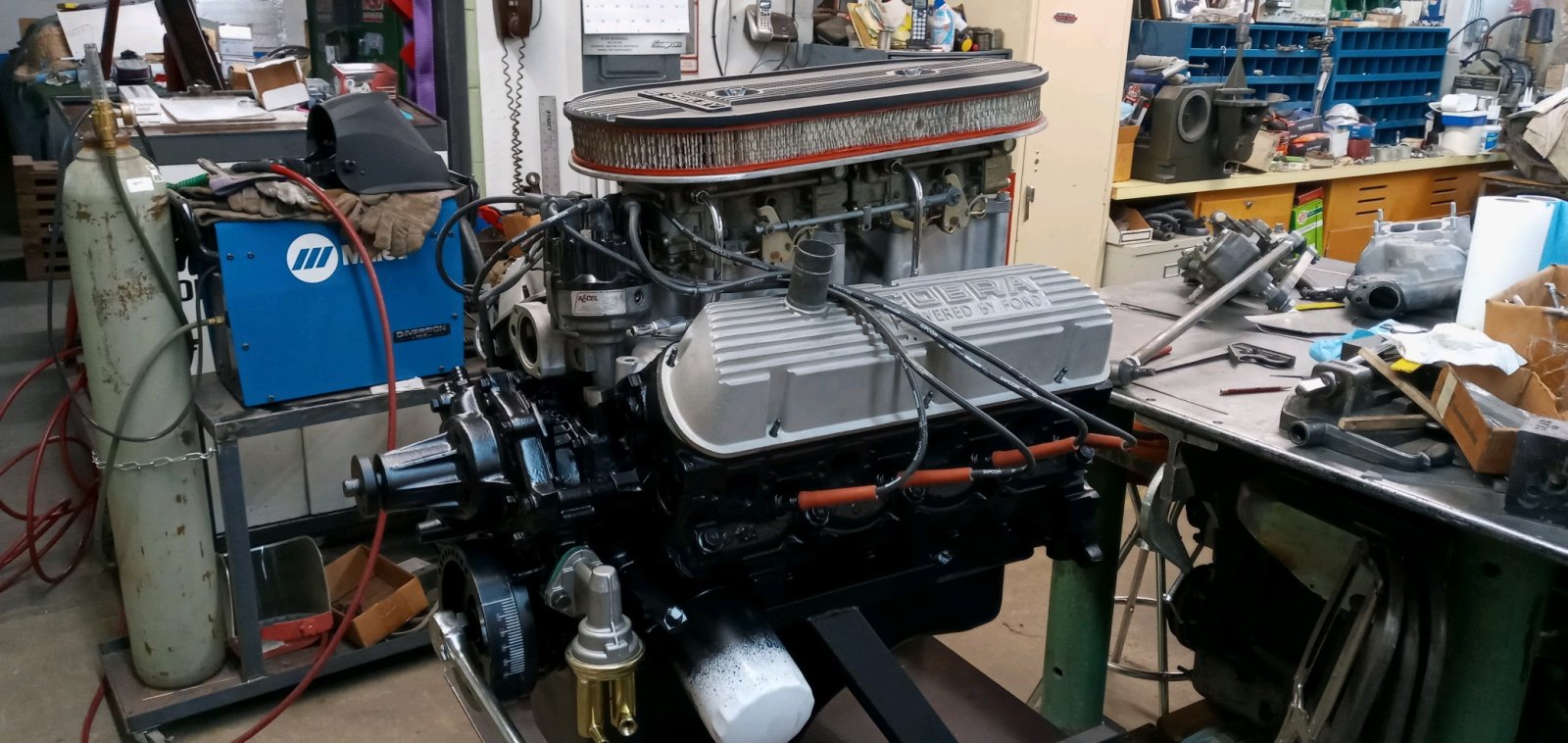

    The term "old days" in the ***le of this thread is somewhat incorrect.
    The following had been in use for 19 years with no issues, prior to the truck setting for 18 months while a restoration shop added factory air conditioning.
    And before you guys with engines you could use for plates at a Sunday dinner start giving me grief for the underhood condition, this is a work truck, not a show truck!
    625 CFM genuine Carters running solid linkage on a Ford 390.
    One huge difference between the Carters and the Holleys is that the Carters do not have the fickle romantic disposition of the Holleys. The Holleys fall in love with every new filling station they meet. :p The Carters simply p*** on by! :D

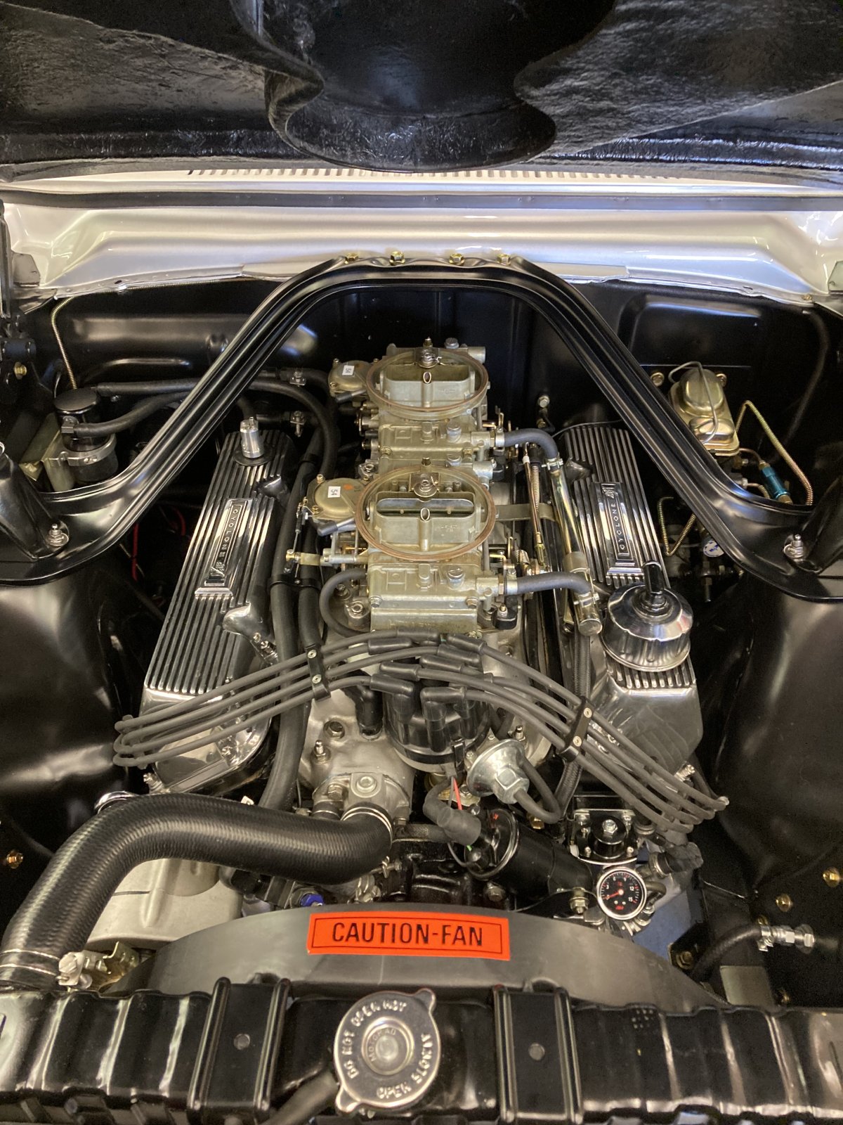

    My 302 has a fairly rare Shelby dual quad intake, I run two Holley 390cfm with progressive linkage and vacuum secondary’s. Single four is too boring. The air cleaners are older Helling Stelling.

    Wantabe?? It’s real, four bolt mains, screw in freeze plugs, nodular crank, etc. Original aluminum covers for that engine. I have owned the engine since 1972.

    Shouldn't it be a steel crank? It is a Boss 302 right?

    Yes, a Boss, you are correct, Forged Steel not nodular. Thanks for catching that.

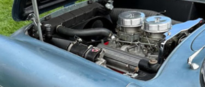

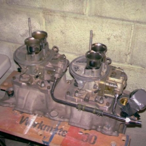

    A couple more to consider....my choice is old school AFB's...

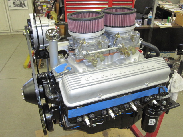

    I have a few 2x4 setups, this is what I have been working on of late. 331 2x4.jpg

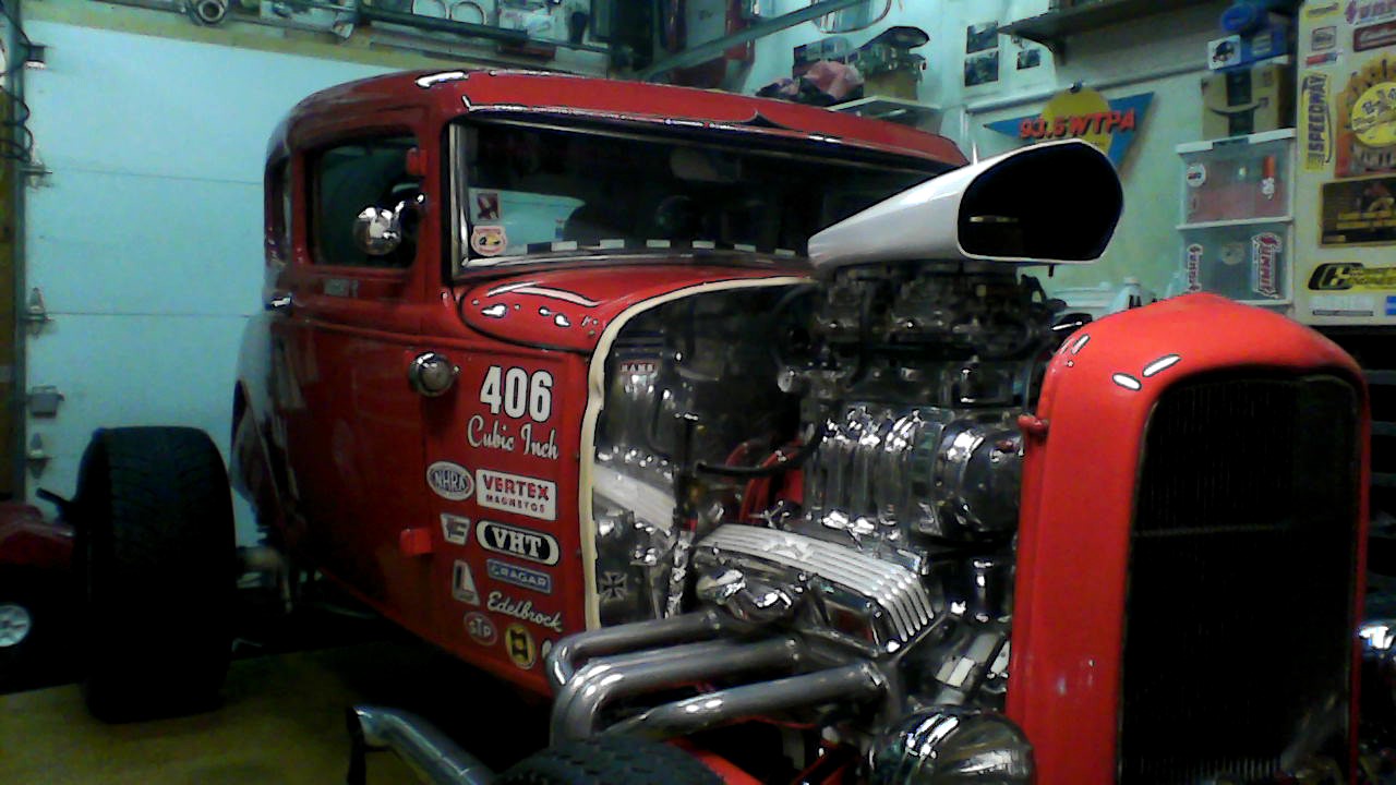

    Yea I know, 2 Eddy's on a vintage W adapter and 471 blower. But, properly tuned and some mods, they work great. Much better then the monster QF set up I had on. WIN_20221126_15_26_32_Pro.jpg WIN_20230212_13_29_16_Pro.jpg

    What kinda' mod's did you have to do to the carb's @mad mikey?

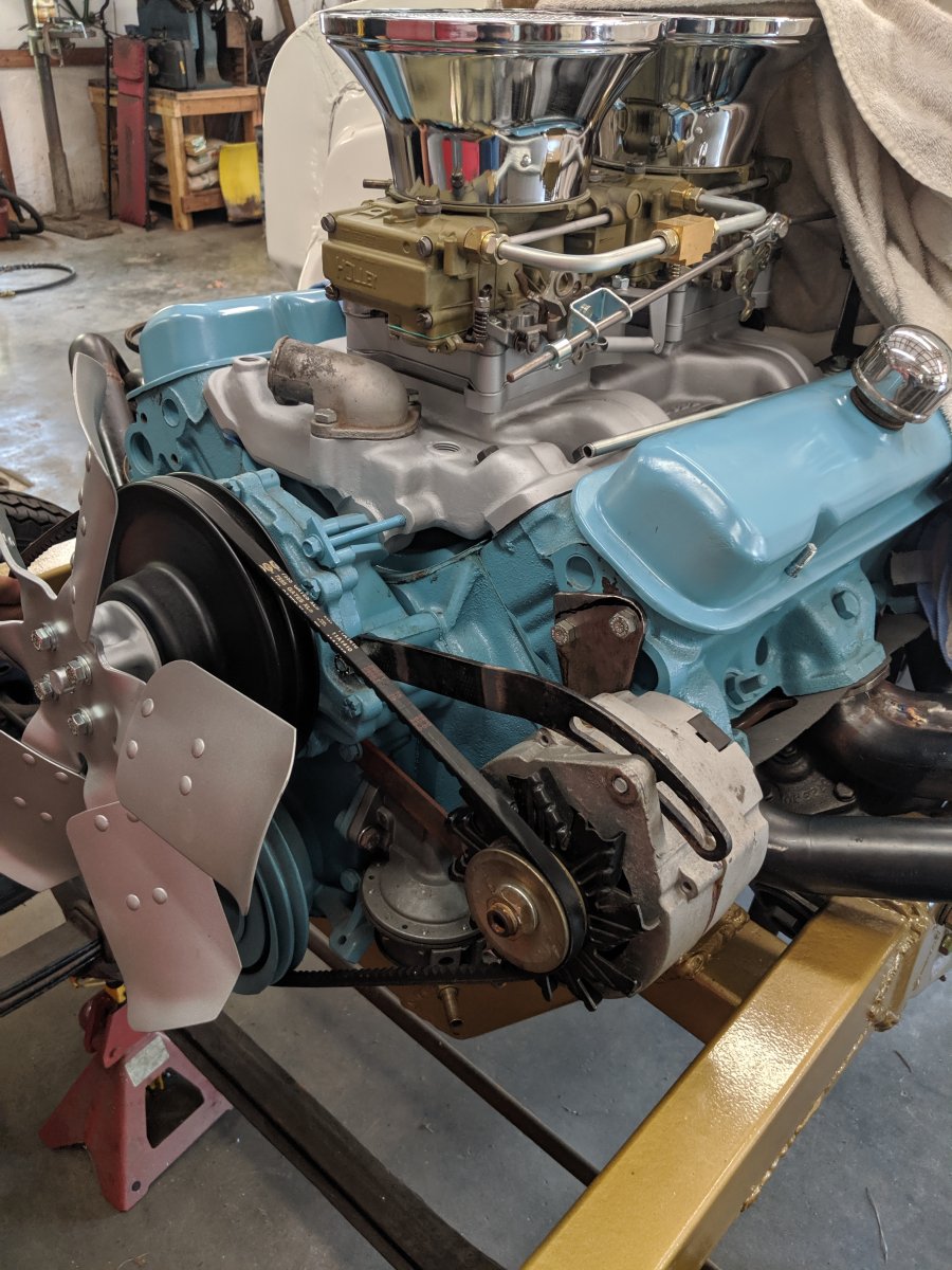

    1958 392, matched pair of AFB's from Pontiac SD

    Boost referenced, Lightened the secondary's weights, and of course tuning, jets, springs, rods, squitter's etc.

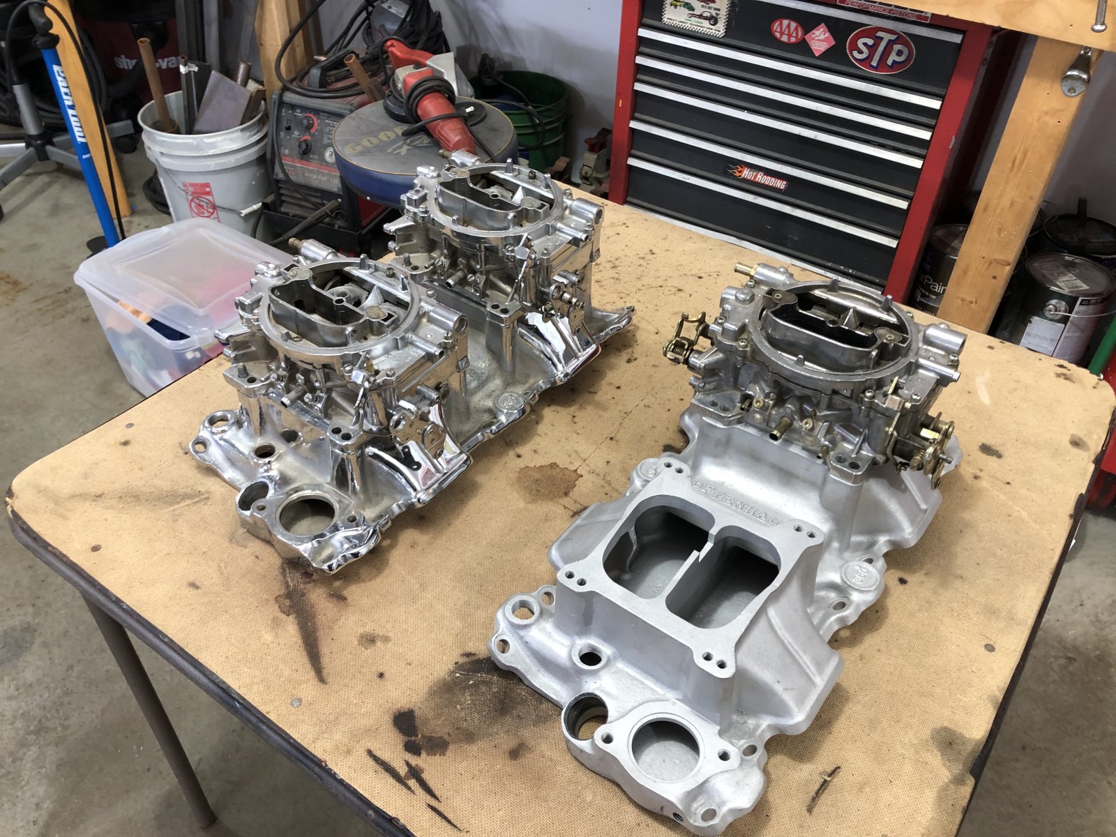

    I bought the chrome version of the manifold I already owned today. It came with the desirable Carter 400’s, also in chrome! Another bonus is the carb mounting flange(s) is not the hybrid version, but set up for square bore carbs. Did I mention it was super cheap?:):):)

  26. Is the manifold on the right set up for two Quadrajets? That would be a very interesting carburetor pair.

    I've seen a video of a guy running twin q-jets , car is very quick ( southern g***ers) ????

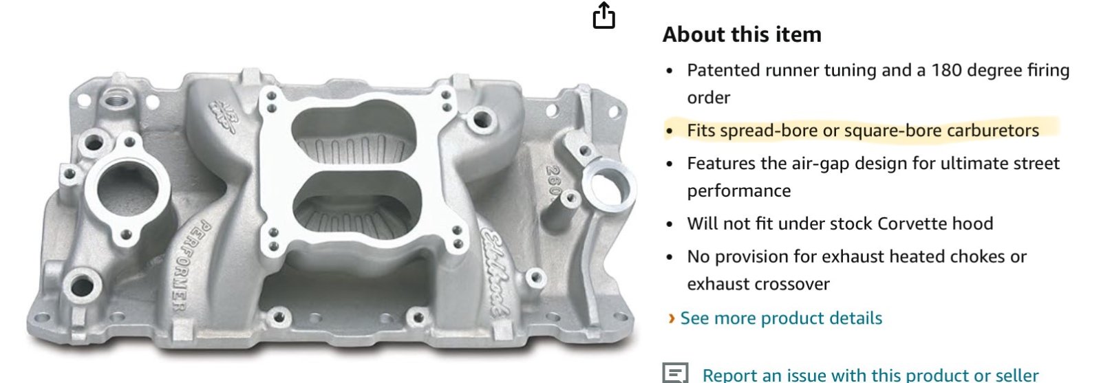

    I call it a hybrid because of what I’ve seen Edelbrock say in some of their adverti*****ts. I don’t know if I’m correct and of course they make adapters to convert from square to spread bore, or the other way around. I was planning to run the Eddy 500’s directly, without any adapters (until I scored the chrome one). Dual quadrajets would be interesting, with the m***ive difference between the primaries and secondaries. I measured the 400 Carter vs. the 500 Eddy and the primaries are the same. The secondaries are smaller on the Carters.
