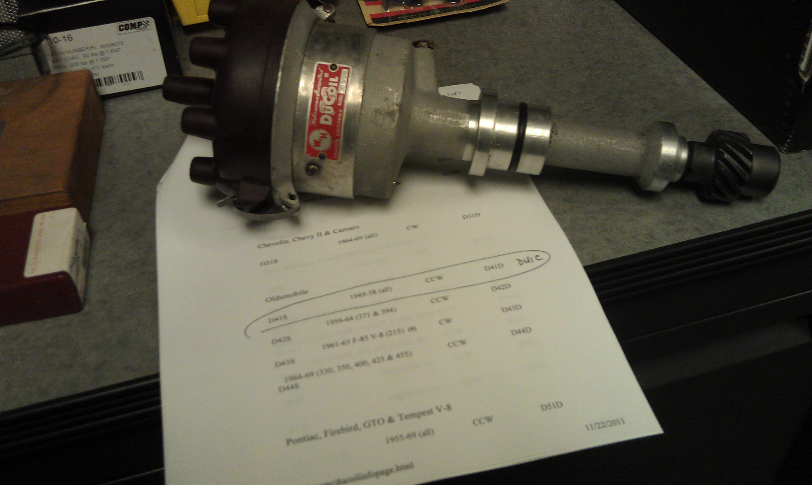

  3. I have a W&H Ducoil distributor for all 49-58 Olds engines. Rebuilt and tested to 8,000 rpm on my dads distributor machine. Anyone interested please PM me. IMAG0375.jpg
