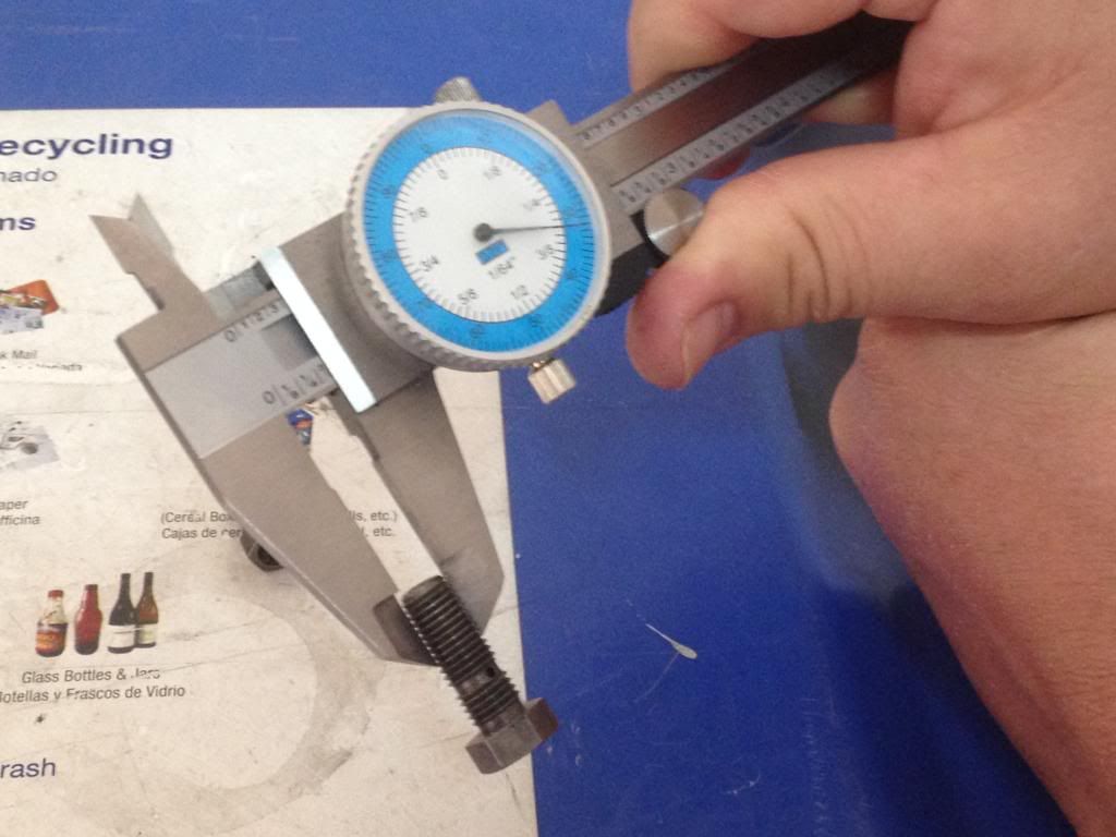

    It seems there are several different sizes that were produced. Here's two examples:
    The first, an outside diameter of 3/8" x 1 1/8"
    And the second... closer to 5/16" x 1 1/16"

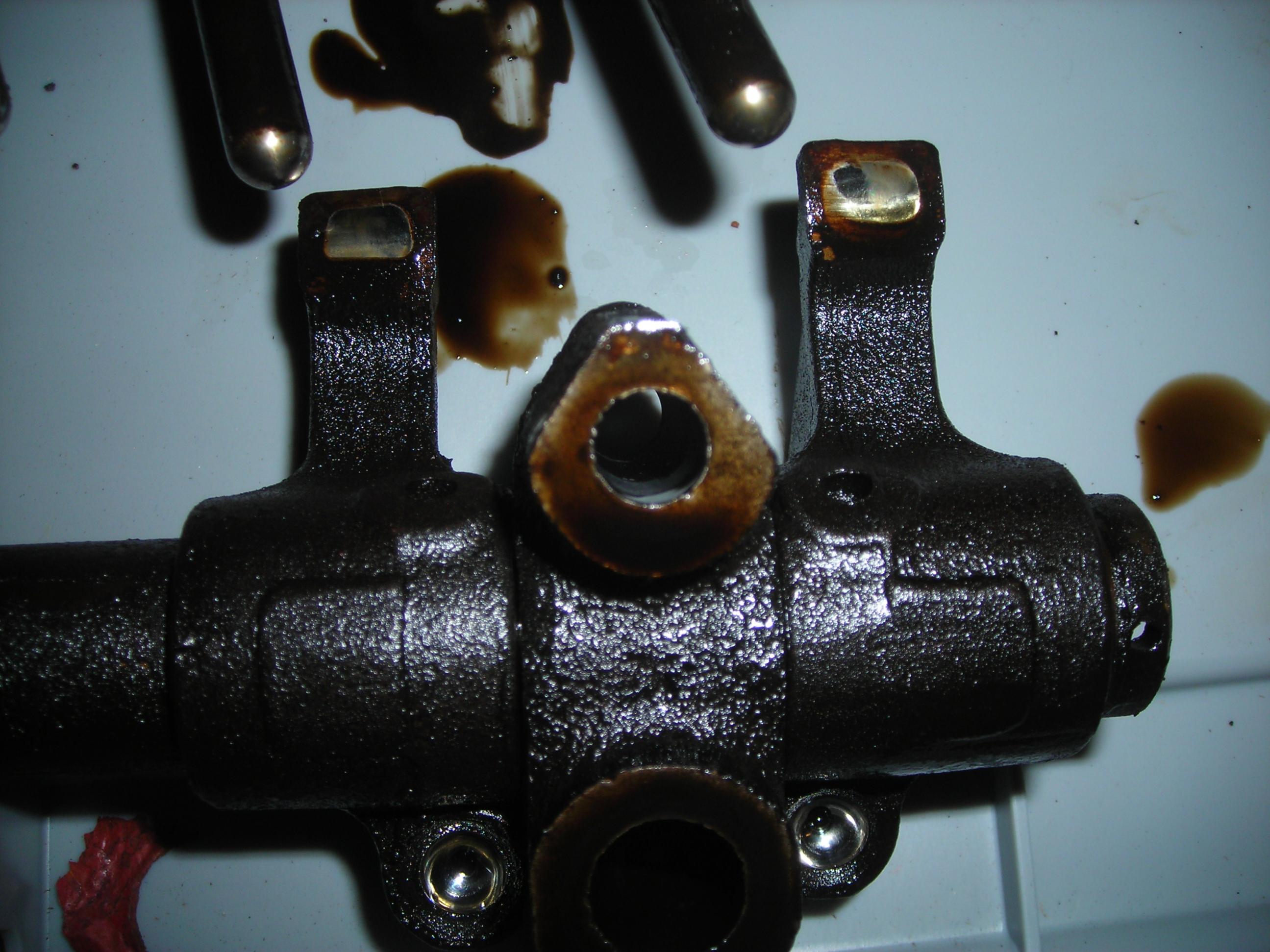

    hmm, I pulled the screw from a spare McGurk 394 rocker ***uming it was the same..
    I see now of course it is not.
    here is a 371 set (crusty) next to a 394 set (clean)
    these also show the 371 set with 3/8 thread and 394 with 5/16
    also for comparison an Isky set, 3/8 thread but with allen adjuster and no through hole
