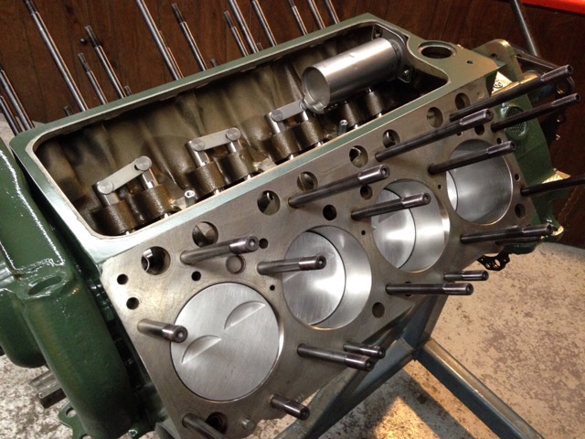

    there is actually one in the green block, that looks fair and another one, that seems worn beyond repair. Keep in mind, that I need to build a complete engine, for a customer's Super 88. Although, would most likely buy a new cam and lifter package. I can inspect it, for you.

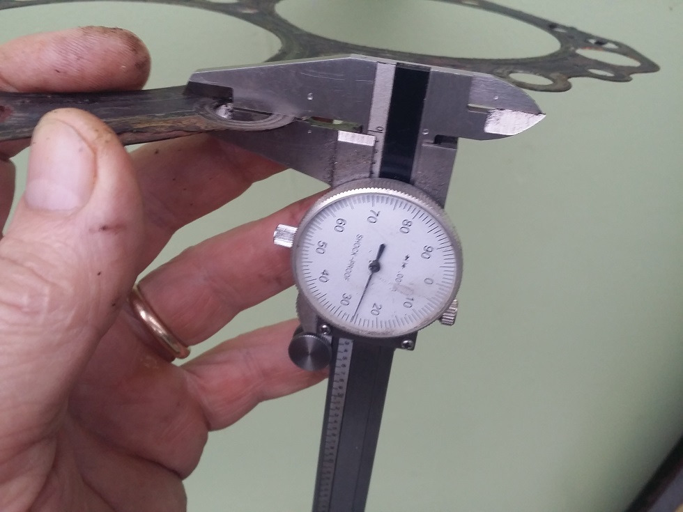

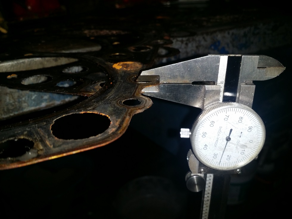

    'pulled a virgin '58 371 apart Friday and was a bit surprised to find the head gaskets were a single layer thin steel shim style gasket, measuring about .025 thick
    used by the factory to bump compression, first ones I've found
    anybody have a pair? or singles?

    My memory is that the 57- 58 J-2 had him steel head gaskets. Also had 3x2 intake.

    yes but,

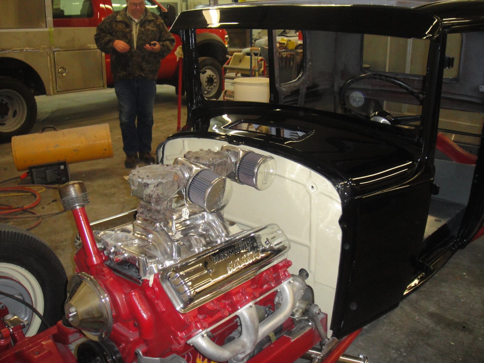

    this engine had a single 2bbl but will be getting the J2 manifold and carbs
    here's a couple pictures of it in all it's crusty glory

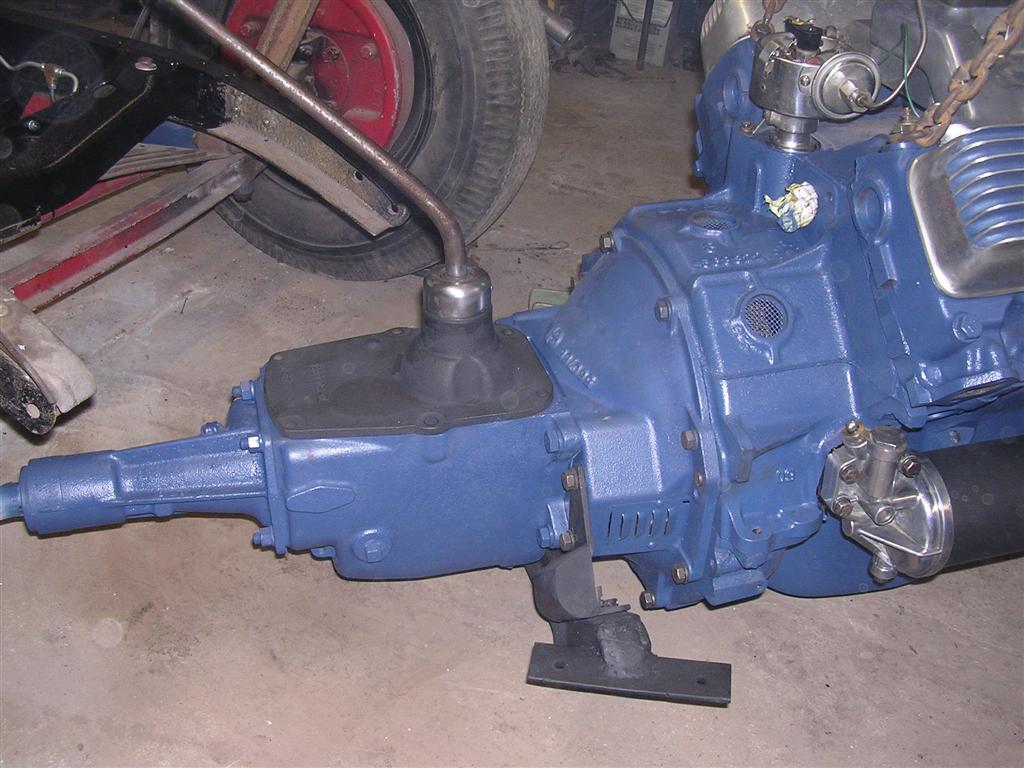

    mocked up with J2 carbs and manifold, generator moved up top, dimpled valve covers, it's a stick motor from the factory now with the guts and tail of the stock selector transmission transplanted into a '37 Buick top shift case

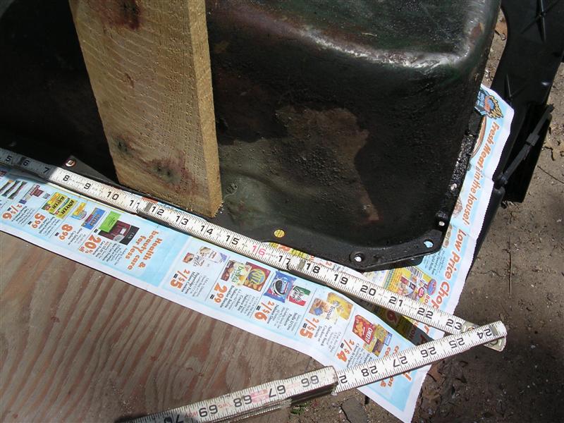

    from BC
    I need to build a transport cradle for a 324 short block by next weekend. I usually use 2x8 on edge, spaced so that the pan rails rest on the top edge of the 2x8, and the body of the pan just drops between the 2x8s. Then I just nail 2x4s across the open ends of the 2x8 across the bottom.
    Then when I get it home, I add casters so I can roll it around easy.
    So what I need to know is the width and length of the pan minus the width of the pan rails. Can anyone measure one for me?
  14. Martin_F
    Joined: Mar 3, 2008
    Posts: 2,527
    Martin_F
    9x21.5
    That's without any clearance.
    Don't forget to put a notch in there for the dipstick!

    F&J
    I get 9.25 on a 55 324 pan.
    Yes 21 long or so
    15 inches from the front of the 2 x 8, is the center of the "bump". Just gouge it with circular saw or whatever..
    The 2 x 8 is not quite tall enough near the front of the sump/drain plug. So either run a strip of 1 x 2 along each 2 x 8, or Maybe two "cross-ways" 2 x 4's at the front and very back, screwed to the 2 x 8's, would also keep the motor from flopping over, while getting the front of sump off the floor?

    KingShift
    The Oldsmobile pan width dimension is 10 15/16" from outside to outside the frame rails. The frame rails are 15/16" wide and you have 17" that you can pickup on the frame rail length. On the right side pan rail you have the notch for the dip stick.. Good Luck. Tom King

    from BC
    Built it yesterday.:D 9.25 inside to inside, so your dimensions verify that it should fit anyway. Thanks Tom. Usually when I build one of these, I have the engine in hand, makes things easier.

    Good ideas, I need to safely transport my shiny rebuilt 394, from my garage to the shop, where I will be dropping it in the 98. Actually thought of making a little test stand to fire it up, beforehand.
