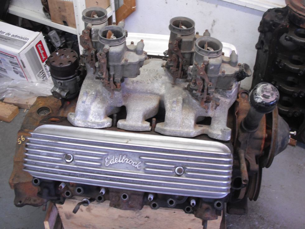

    It came on an engine I picked up a while ago, don't know who made it

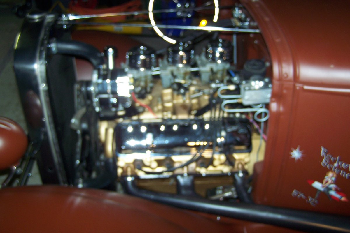

    I don't have any finished stuff to post.. but here is what was a 1959/60 build from Boston area. It is a 30 Chevy roadster pickup, chop/channeled, 49/50 Olds trailing arm/coil rear, was originally a 303 (the recessed pocket area for the front mount in the crossmember only fits the smaller 303 mount), but no idea on what type trans.
    The youngest son of the builder gave me two 35mm color slides from during the build back then, but does not show what radiator/ shell was on it. Maybe 32-ish Ford
    I do have a 303 from my former 40 Ford, but this motor is a old full race 1957 std shift with pop-ups, big solid cam, adj rockers. I had the motor from a prior Olds estate, but don't know what intake it ran, so I placed a J2 on for now.
    Bought the Chevy off ebay 1.5 years ago; seller had no clue it was once Olds powered, as the kids don't speak with the Dad now?? I sure did not want another car. I always said I'd never get another rod unless it was: " 1-an old build, 2-Olds powered, 3-spring ahead front end, 4-chop/channeled. Well, ****, dam, and F'me, that one popped up :) ...and I even got one with hairpins, and a side mount antenna, dropped/drilled axle, belly burner pickup bed exhaust,.... that were not on the "must" list.
    What a shame it sat all apart on a dirt floor. Was all chromed; entire front end, dash, column, roll bar, exhaust incl mufflers at the top of bed rails. It was white with copper color frame and firewall

    Man how cool is that?!
    Love it, 'be awesome to see it put back like it was

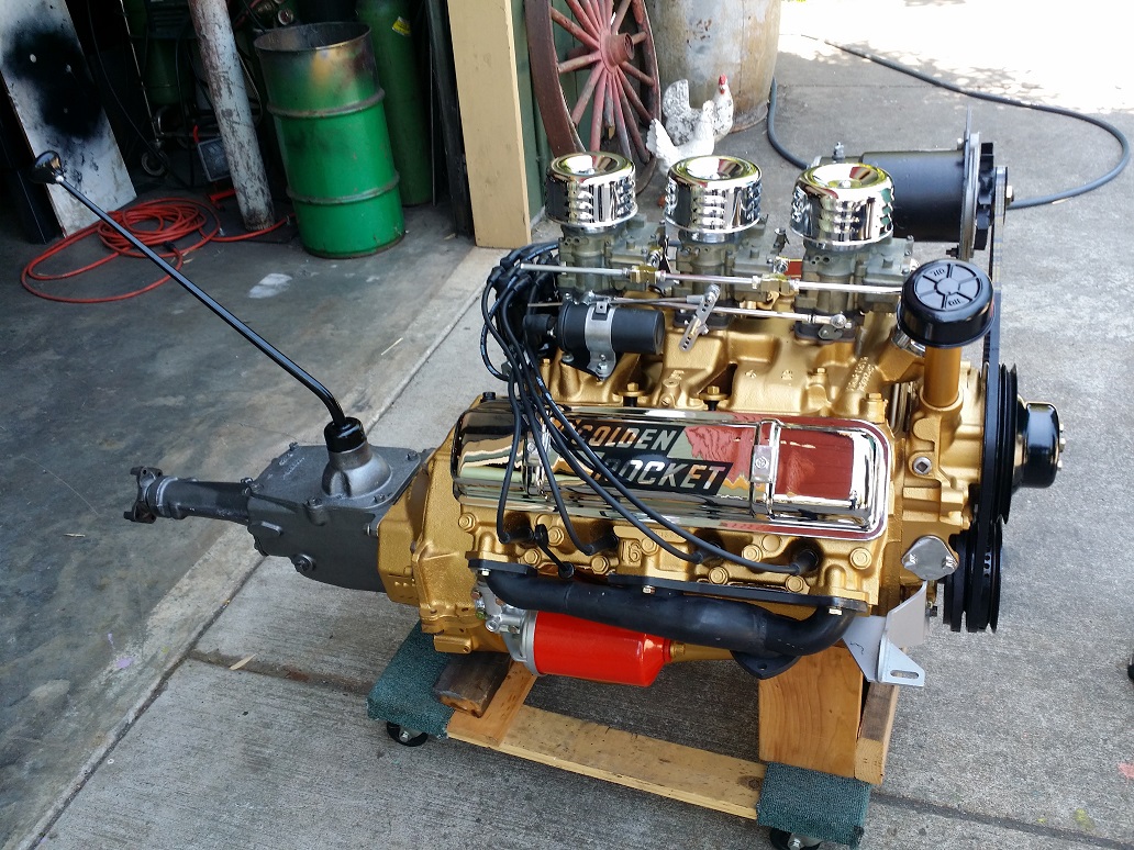

    Too excited not to chime into this thread. Finished painting engine tonight. Only problem, is some of the paint lifted, when I pulled the stripe tape off valve covers.:mad: Stopped halfway through and used an Exact-o knife to trace around the ridges and cut through the hardened paint.
    Trans is my Ross Racing modified TH400.
    Color is Ford Torch Red, engine paint(thanks Tony), trans is Argent Silver, GM rallye wheel paint. PM me for the PPG color codes.

    '58 371 J2 done and ready for fluids and fire-up

    Paul, you are a one man GM production line!! That looks awesome, great job.
