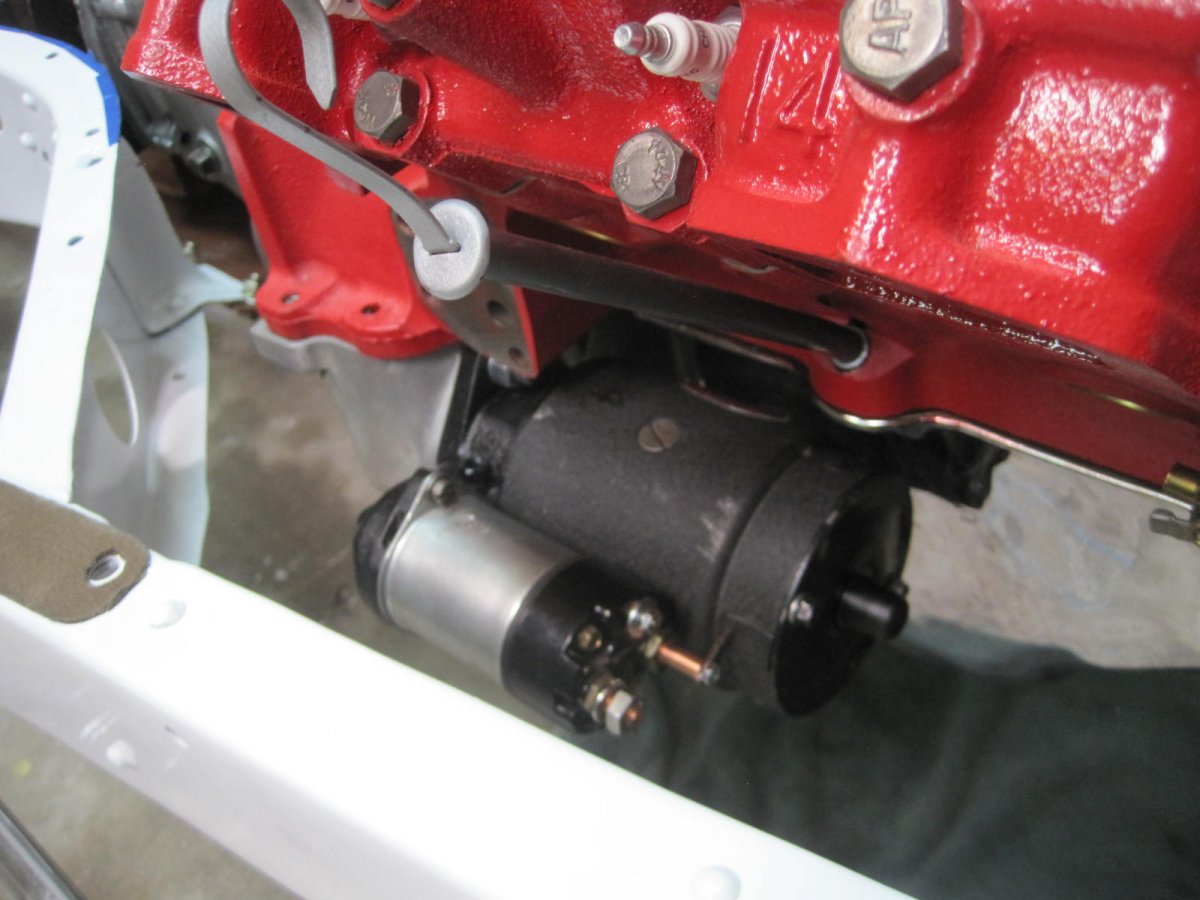

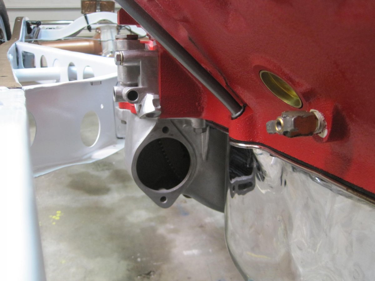

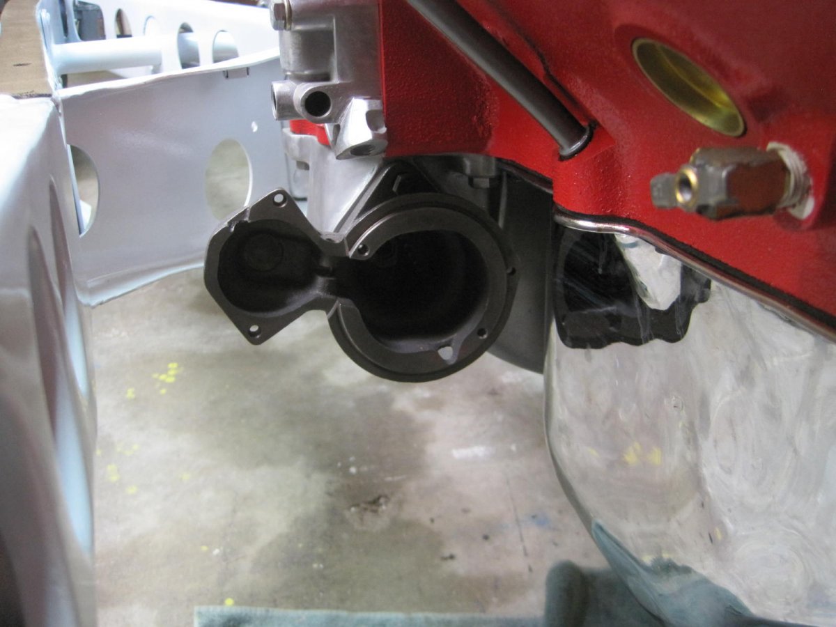

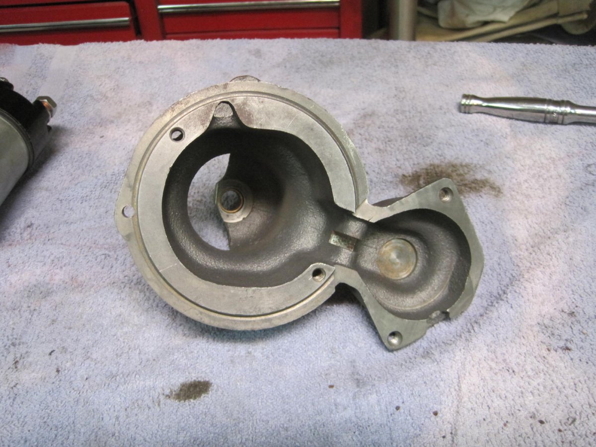

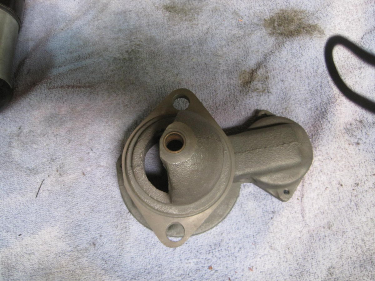

    I found a cure for using a regular 57-58 type starter on the aftermarket crossover today. This may have been covered in a previous post but I have not seen it. I went to a local starter shop today with my crossover piece and my NOS starter and asked if they had a solution to put the bolt hole in the right place and the solenoid in a better location away from the pan without modifying it. The guy walked in the back and in two minutes he came out with the answer. It worked out slick with no alterations. It is a Direct End Delco Remy Transfer Motor.(Snout) Part number LC1743. Here are some pics. This is sure to help out someone with this problem I had with out buying a HT Mini Starter for stupid money. This part was 70 bucks and I changed out my starter snout with it. It works out perfect. Look at the orientation of the solenoid now. Much better. IMG_3693.JPG IMG_3693.JPG IMG_3694.JPG IMG_3695.JPG IMG_3697.JPG IMG_3698.JPG IMG_3691.JPG IMG_3691.JPG

  5. curbspeed
    Joined: Feb 7, 2002
    Posts: 4,917
    curbspeed
    I would have mounted it but need to pickup some threaded studs instead of bolts to use. Much easier to install that way. I also want to paint the new part.

    Great info. I did a whole bunch of digging, it also LOOKS like a 6 volt'41-'48 cad v-8 starter would work if you swap the gear, but man, try to find one. This is a great solution, and one thing I still need is a starter.

    great solution. maybe you better post the rebuilders name as many of us do not have rebuilders in our local area:):)

    The starter rebuilder is Luna Starter and Alternator Service in Tucson, Az. I looked at a Mini starter on Ebay for 205 bucks. I knew Ross would probably have been more so I wanted to use the part I had bought if it could work. They looked up the numbers on my starter and it was the correct one for a 57-58 Olds. I couldn't be happier right now. It also get the solenoid up out of the way for my headers that need to go under there too. Bonus.

    Somebody on hamb years ago, mentioned a Cadillac snout on a Olds starter for the crossover. I don't recall if they posted years of the Cad piece or not.
  11. That is the year range for the Cad V8 starter that I have been told will fit. Apparently the whole starter will fit just fine with the solenoid up and out of the way of the oil pan.
    But as you mentioned, try finding one.
  12. Looks like an awesome solution! I wonder if that one will fit, or if they have a similar one for an Olds 303/324.
    Tried to look up the part # you listed on Delco Remy's website, but no dice. And their application search only goes back to 63...
    Must be nice having a knowledgable guy who can look stuff up.

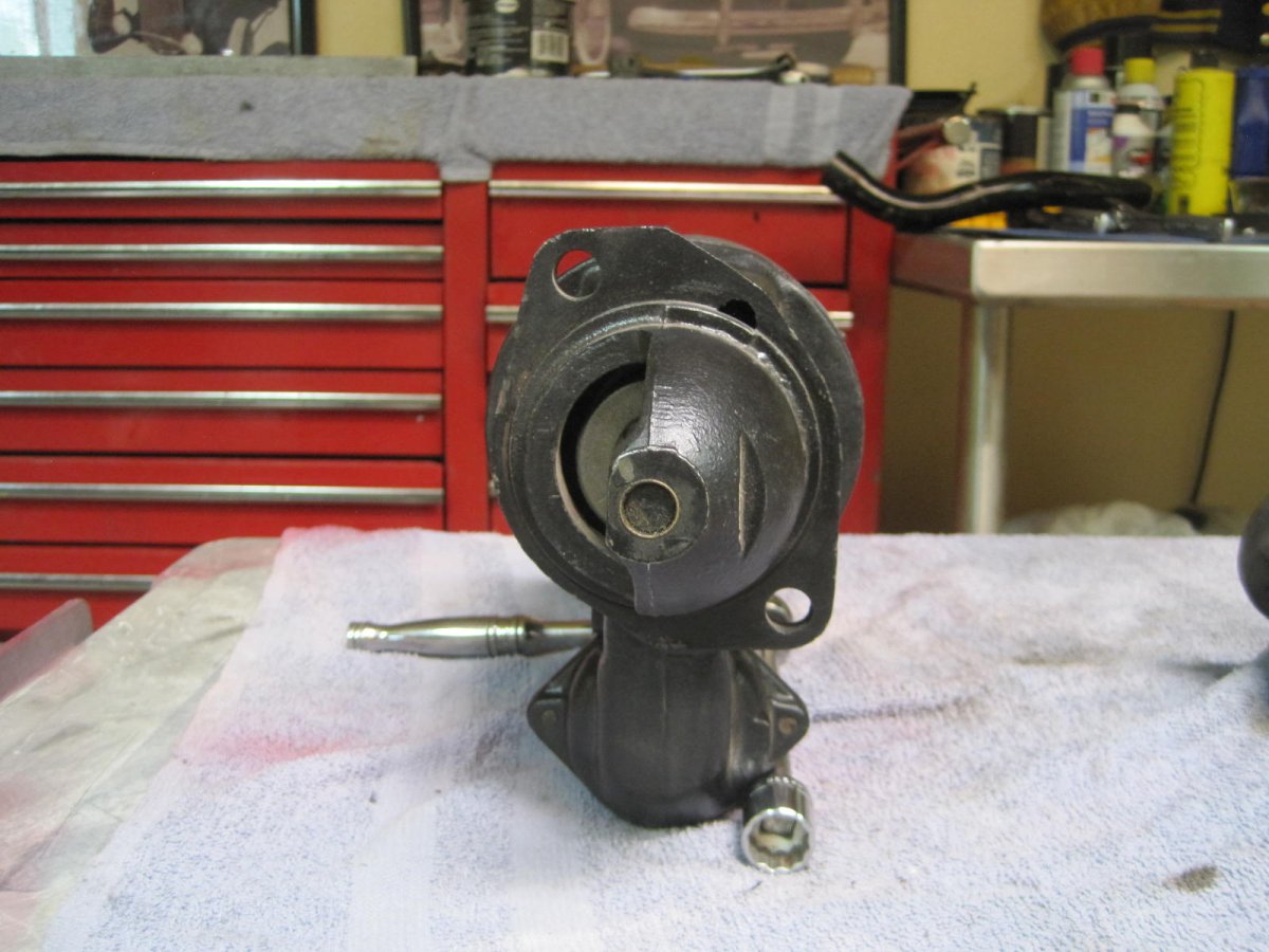

    There were three starters for the early Olds V8 engines,
    The early one as said is recognized by the sheet metal dust cover over the brushes
    The mid version looks similar with exposed selenoid lever but solid body and no sheet metal cover
    The last one has the selenoid lever inside the cast end piece.
    All starters need to be matched to their corresponding flywheels.

    On my current car I didn't want to modify the pan so I modified the selenoid belcrank and rotated the selenoid to clear the pan.

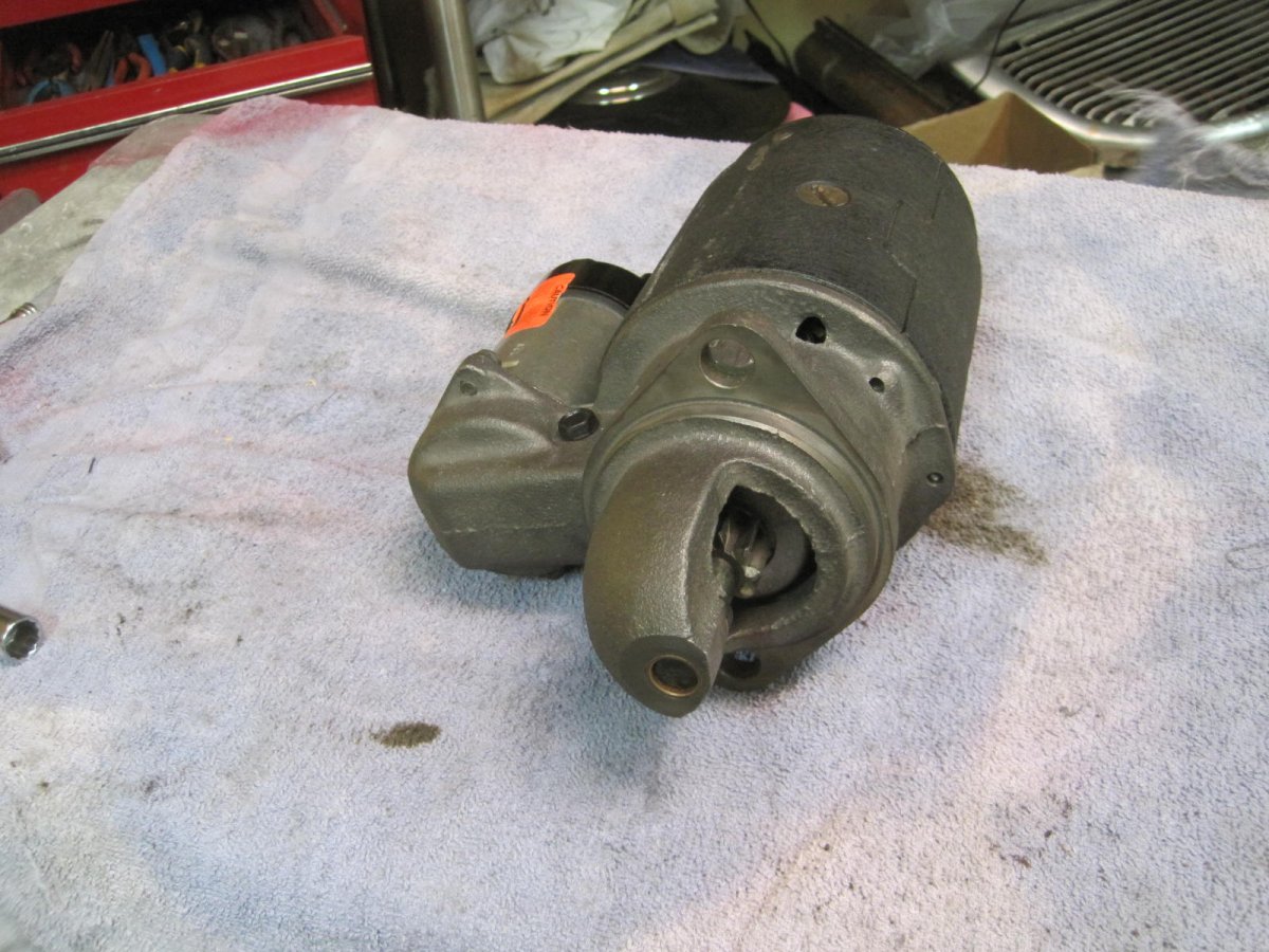

    I got my automotive studs tonight after work. Gonna stick in the starter and will show pics later tonight after I get it in. Hope this helps. I've already been contacted by one guy to get the new part. Ask for Bill when you call. He'll remember me and what I bought.

    Dale,
    thanks for the link,
    the modification I did would not work for you,
    you need the later starter,
    no way to offset the solenoid without that casting you found!
    please let us know how it works when you turn the key

    IMG_3700.JPG IMG_3704.JPG IMG_3705.JPG Here is picture of the starter in position like it was meant to be. Getting that top nut on the stud tight is a real stinker. I hope I never have to do it on the side of the road. Also I have a question for anyone that wants to answer. The other pictures are of my remote oil filter block. I need to know which is in and out? Not sure of the brand but it has no markings. I have a manual that shows engine block oil flow but it is too small to see and not very detailed.Which port do I use to go into the remote beehive oil filter I have? Thanks ahead of time. Help a dummy out today?

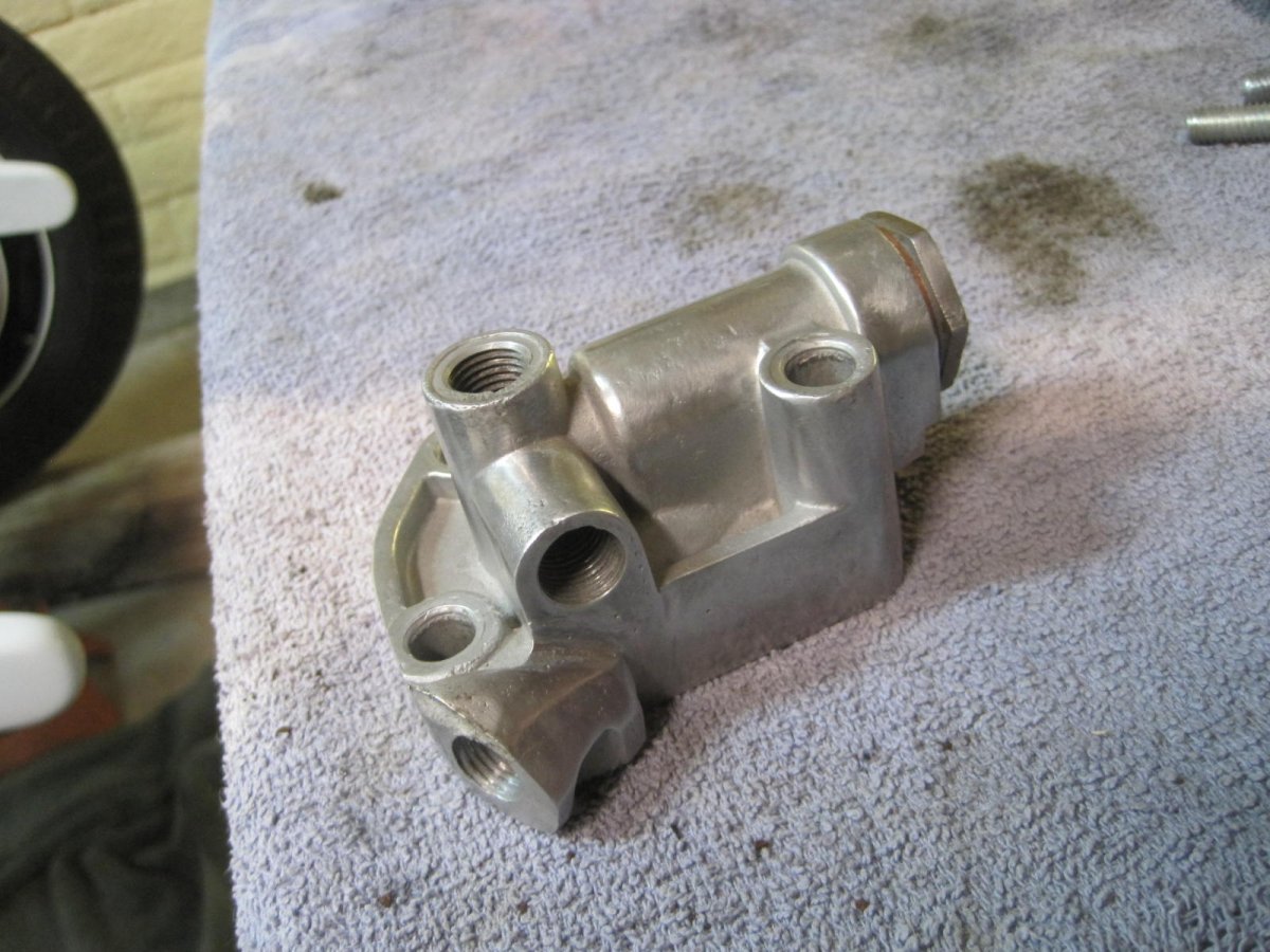

    Two clues
    Oil flows from outside filter in.
    Excess pressure from pump due to clogged filter will lift the ball off its seat and byp*** filter.
    Speedy Canuck likes this.
  23. vtwhead
    Joined: Oct 20, 2008
    Posts: 5,307
    vtwhead
    FWIW...Tony usually pulls out the byp*** valve, drills and taps the unit for a plug eliminating the byp*** completely. I did that to my 324. So now I have a 5 way byp*** internally and my engine has only one but we are bonding ever closer each dayo_Oo_O

    As to the starter changeover, I used the method described in Speedy's quoted '56 HRM article. I cut out a 1/2"
    relief, (if memory serves correctly), from the (bottom?) side of the snout, flipped the starter over to mount on
    the right side, and if fit perfectly; no dent in the pan required on my '50 block. Since these old ******s are very heavy, I would also recommend using mounting studs and a strap on the front end of the starter, connecting the
    strap to a pan bolt. (As I recall, the mid-fifties 6 cyl. Chevys also could be used for subs***utes, along w/ the '40s
    Cad starters.)
