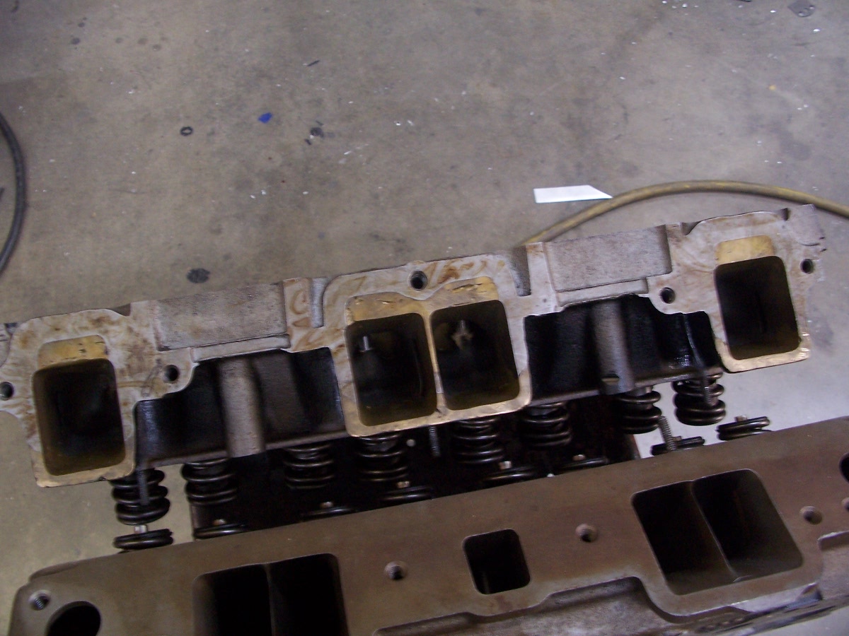

    Hi, just a short question.
    I have a set of #3 303 heads and the Original heads of my early 303 (not numbered).
    Are there any gains in swapping the #3 heads or are all 303 heads the same?
    Thanks

    Good question,
    I see valve numbers did not change from '49-'53
    Valve springs did change in '52
    But there were at least four different head casting numbers;
    '49-'50, 561415
    '51-'53 exc. 98 Fiesta, 561370
    '51-'53 Export, 561415
    '53 Fiesta Conv. 563372
    kidcampbell71 likes this.

    Not quite. I have 1956 #10 heads on my 303. The lump on the underside of the 1956 4-barrel manifold will not clear the 303 valley cover. The '56 valley cover has a depression to accommodate the manifold lump.
    Dago 88 and j-jock like this.
  6. That brings back a memory. Back in 1959, I put 56 heads on my 303, and it almost drove me nuts trying to get the manifold on. I went back to the wrecker and picked up the 56 valley cover.

    At the moment I am rebuilding my 303. Got the #3 heads from another 303 I stole the 4bbl intake and rocker arms of. Just trying to make up my mind if the #3 heads would be worth the effort. Otherwise I would just use my old heads as they are in pretty good shape already.
    Sent from my SM-G930F using The H.A.M.B. mobile app
  8. deeppurple52
    Joined: Apr 29, 2014
    Posts: 48
    deeppurple52
    from Mesa, AZ
    If you have to recondition the heads, I would go with the #3's. If not, stick with the originals. You will not see a big performance gain unless you go with 324 7-10 heads. There are plenty of Rocket 303's running stock heads so it is just a matter of cost and preference. Win-win either way.

    Thanks, I'll save myself the work and put them in the spare parts shelf :D

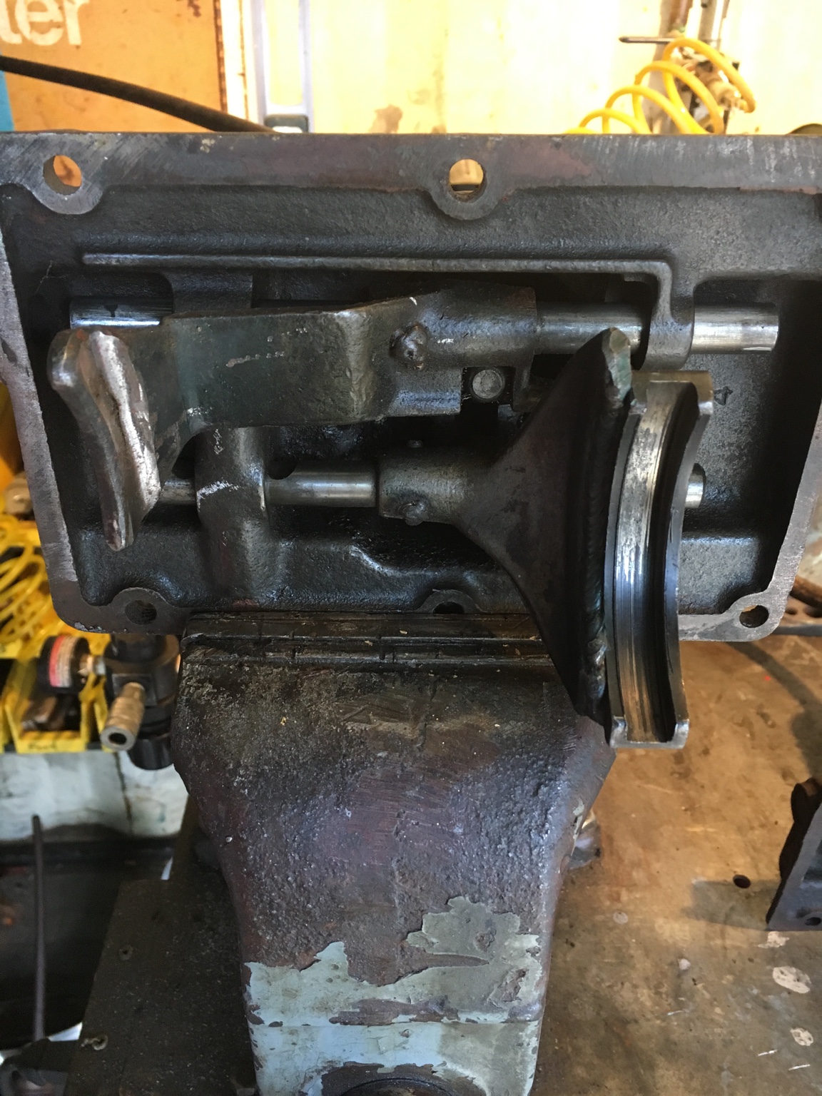

    Does anyone have any information on converting a olds transmission to a top shift with what appears to be a ford top shift cover, cover adapter, shift rail and fork modifications.[​IMG][​IMG]
    don colaps likes this.

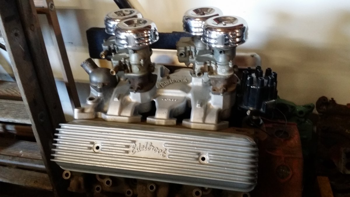

    Picked up a pair of Edelbrock covers at the Monroe swap meet today,
    to go with the 4x2 intake..
    Anyone have a secret trick for removing powder coat? :rolleyes:

    might be able to bead blast it. I would try a test spot to see if it moves. Most PC companies will tell you to use a paint stripper like Jasco but it is very nasty stuff and messy. Depending on thickness might take multiple coats and then there are those fins to get down into. Small copper brush might get down into the fins.

    Bead blasting would take a very long time. Chemical stripping would be better. Put it in a bucket or tray and keep it wet with stripper. Don't let the stripper dry out. You can use a plastic brush, Scotchbrite pads or s****er to help it along. Wear thick gloves and use eye protection. If you get stripper on your skin, immediately rinse with cool water. Stripper works best in hot weather. Do it outside or in a well ventilated area.

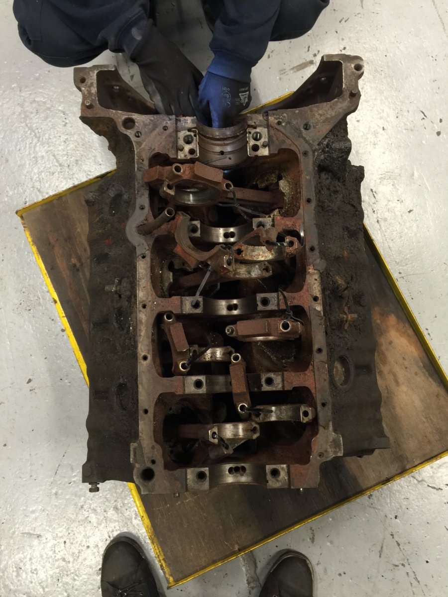

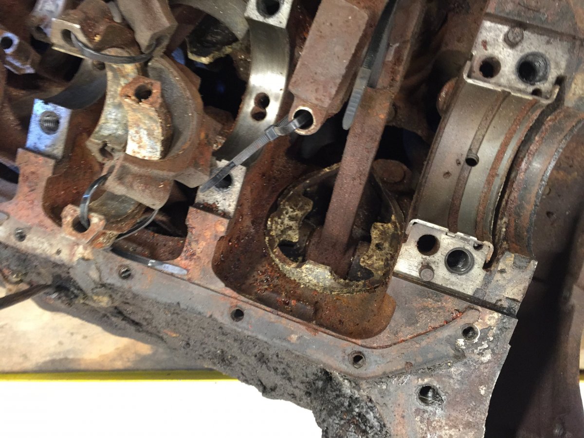

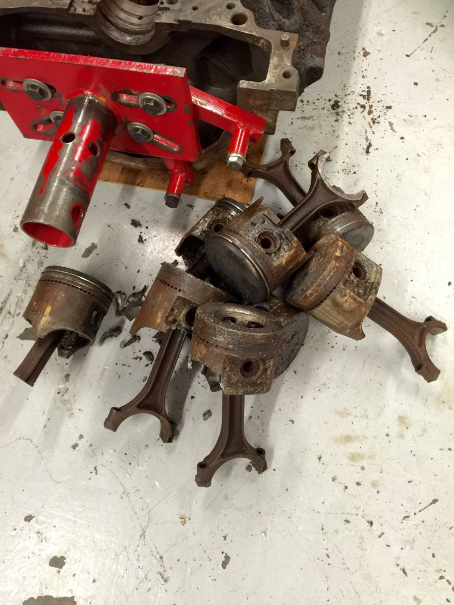

    image.jpg image.jpg image.jpg After some pointers please guys, I picked up this '62 394 high compression motor the other week. As you can see she wasn't in mint shape! Someone left t outside with no plugs in, soaked the bores and got the Pistons out. I'm having trouble finding define answers on piston sizes or a spec sheet/tuning Manual with stock and aftermarket sizes to bore to. I'm in the UK so can't afford to order the wrong manual, or parts. Would be great to have a measure up of all the parts I have (motor was purchased in boxes) and see if this can be used, the bores are surprisingly nice but won't clean up with a simple hone. Thanks in advance
    Joe
