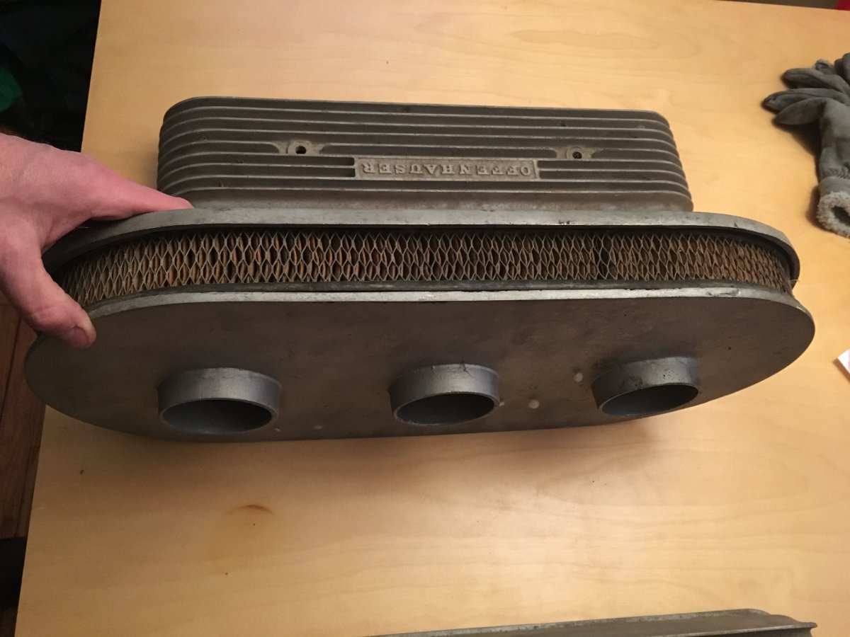

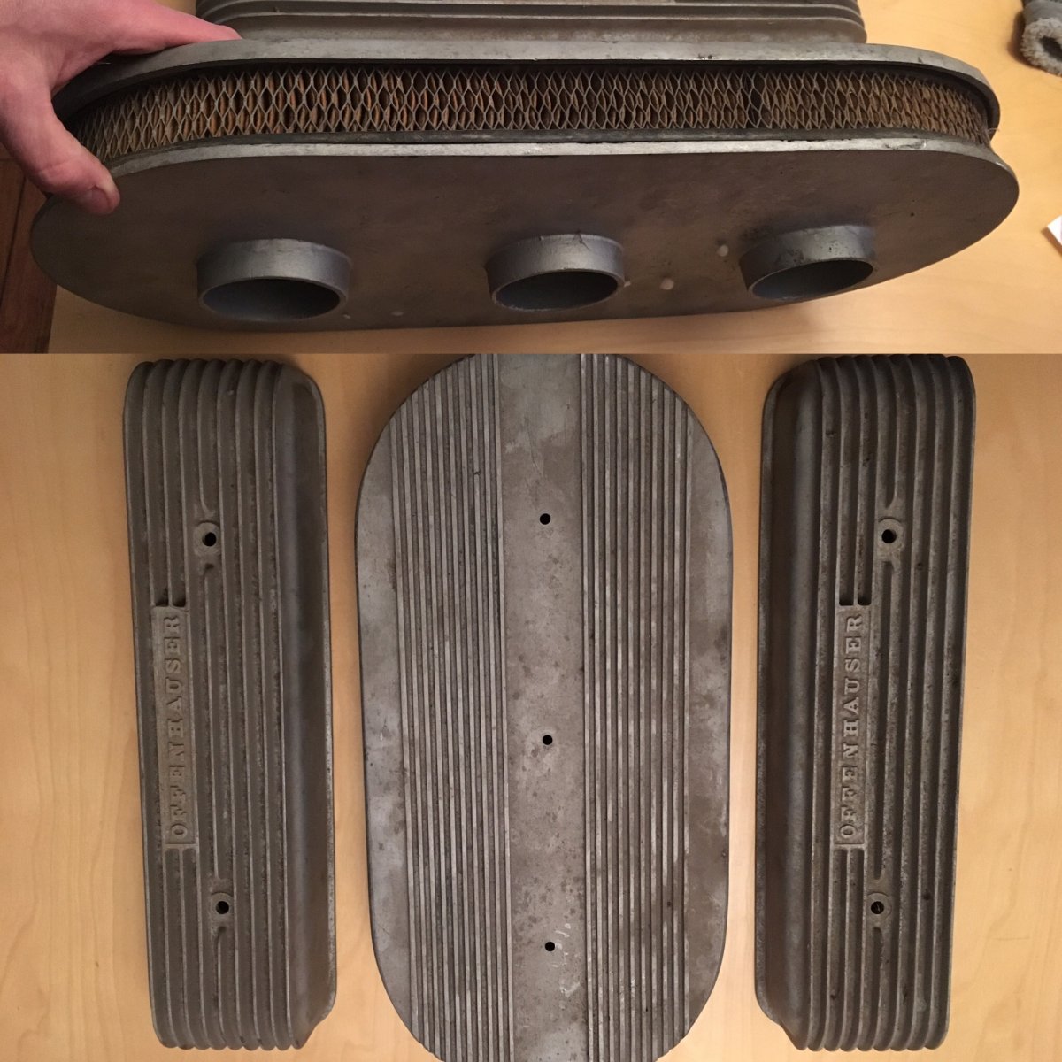

  9. mineseats9
    Joined: Apr 10, 2005
    Posts: 77
    mineseats9
    from Omaha
    Can anyone identify the air cleaner housing pictured. Bought it and the valve covers today. The valve covers are 57-58 371 and he said the air cleaner will fit a '57 J2. The price was good enough that I took his word for it. Thanks.

  11. vtwhead
    Joined: Oct 20, 2008
    Posts: 5,307
    vtwhead
    never seen that air cleaner before but if it fits I would say that is a great find!

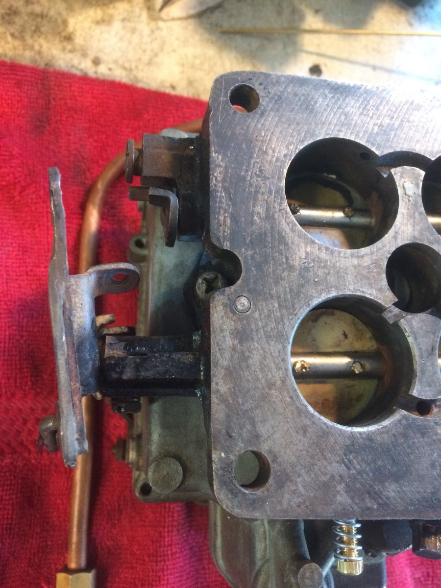

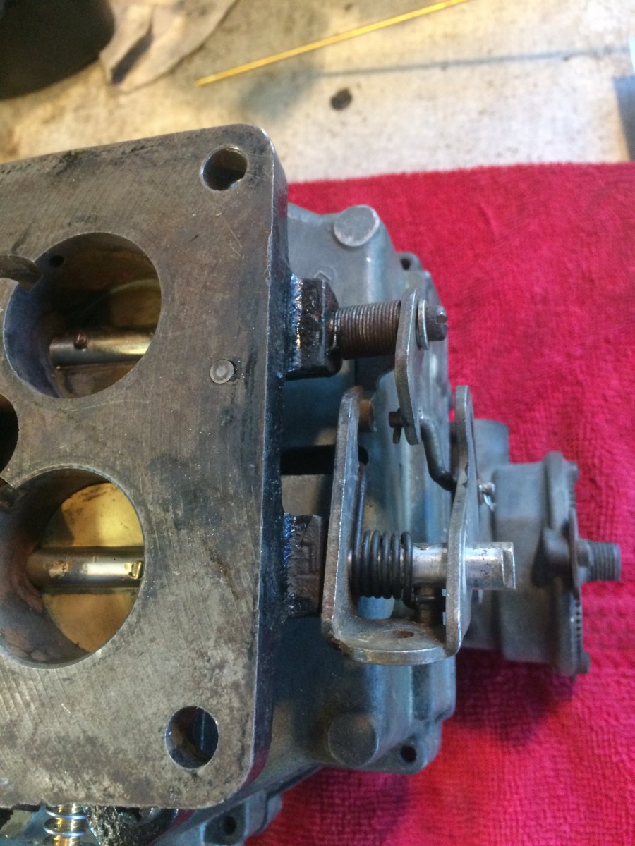

  15. gonzo
    Joined: Dec 24, 2003
    Posts: 1,900

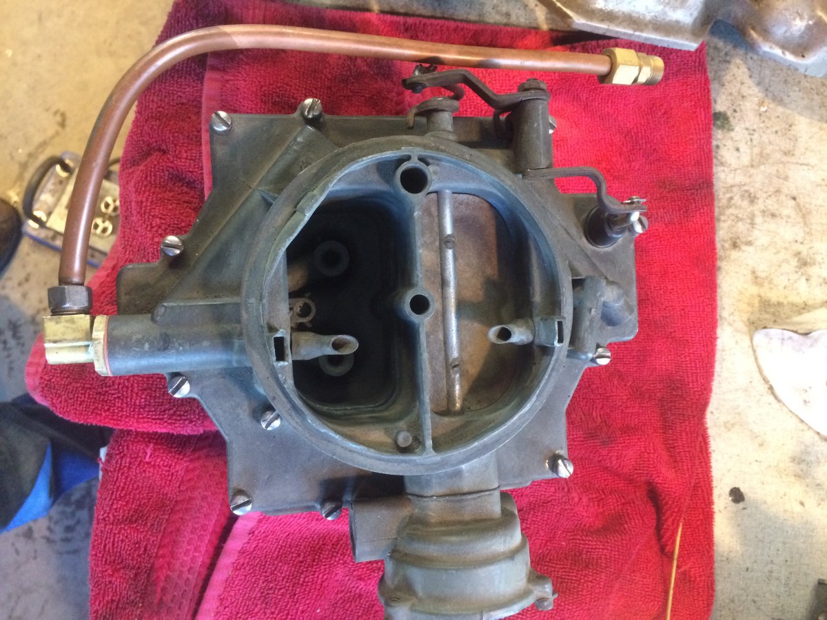

    gonzo
    Can anyone ID this carb? I believe it’s off of a 51-53 Oldsmobile. It has a 7.25” throttle shaft, I’m looking for a replacement shaft or carb base.
    kidcampbell71 likes this.

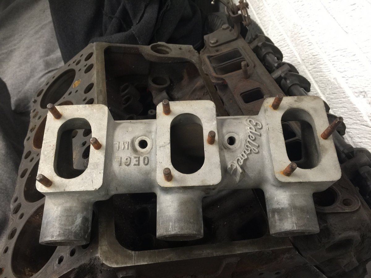

  17. the pinstriper
    Joined: Jun 2, 2011
    Posts: 236
    the pinstriper

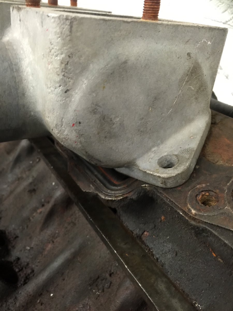

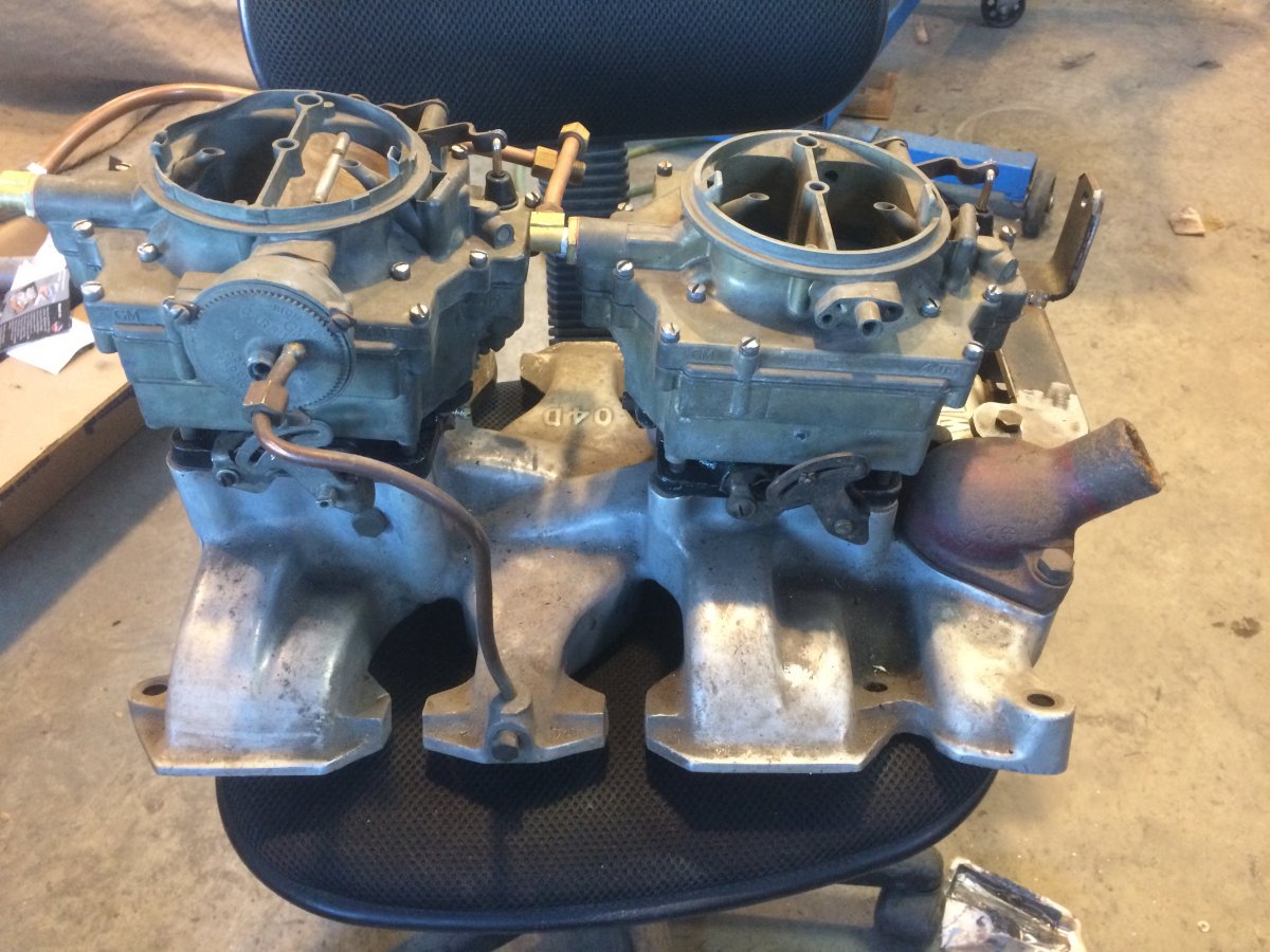

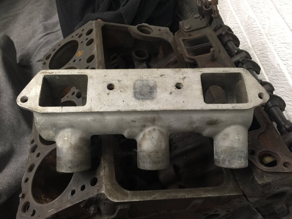

    from duxford UK
    Picked this up off U.S. eBay and had it shipped to the UK. Ports don't match up! More searching shows this is an early olds intake? My engine is a '62 394
  18. vtwhead
    Posts: 5,307
    vtwhead
    that ****s for sure. Had you known you could have asked us about the model number. We could have helped you on that. Lots of good info stored here in these forum minds!
  19. the pinstriper
    Joined: Jun 2, 2011
    Posts: 236
    the pinstriper
    from duxford UK
    Gutted, import and shipping made that a big mistake! Off to the cl***ifieds it goes
  20. Six Ball
    Joined: Oct 8, 2007
    Posts: 6,978
    Six Ball
    from Nevada
    Sometimes we do that, the great deal just doesn't pan out. I've got a few of this deals sitting around.:(
  21. gonzo
    Posts: 1,900
    gonzo
    Since that intake should work on '49-56 motors I'd say your pool of potential buyers just went up. Hopefully you'll at least recoup your cost.

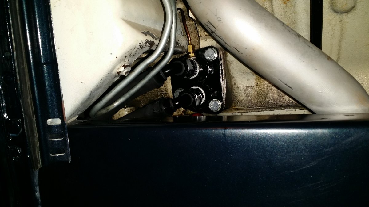

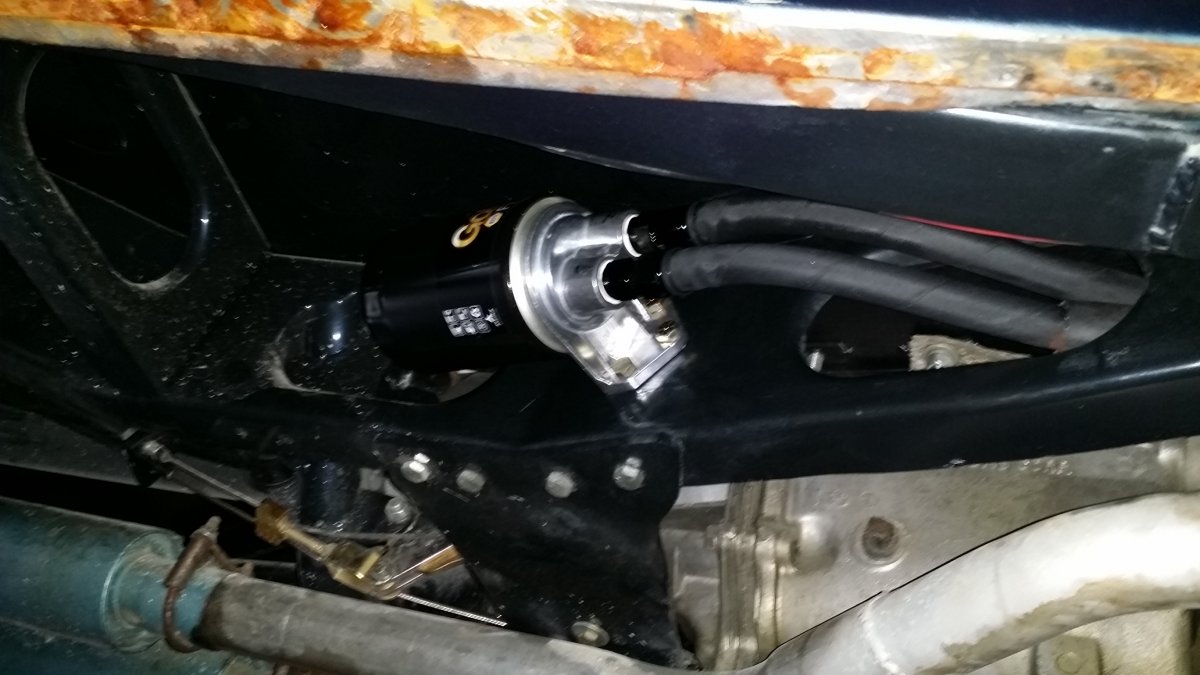

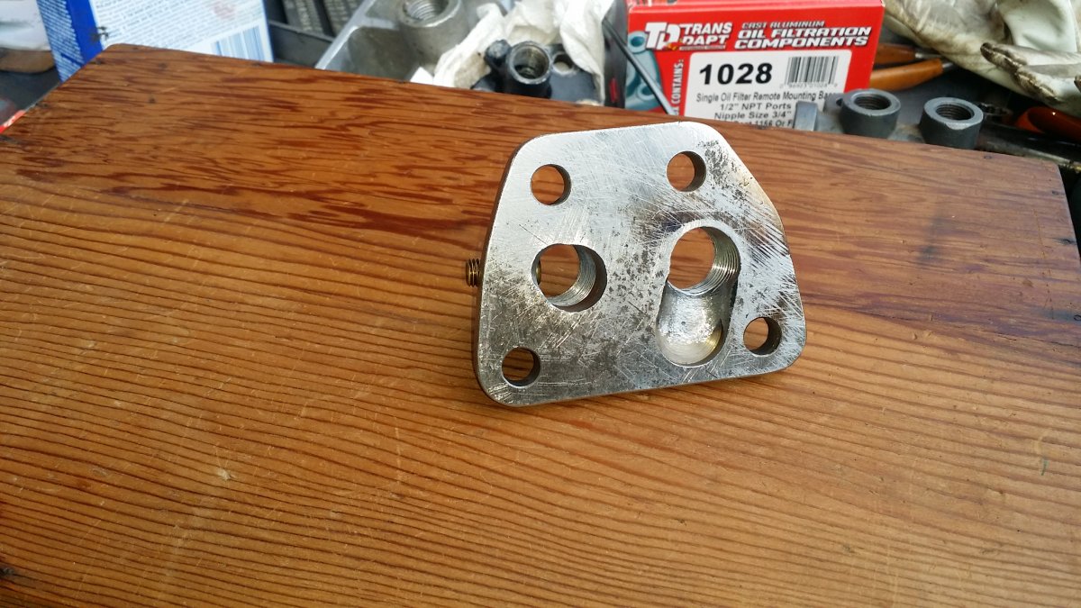

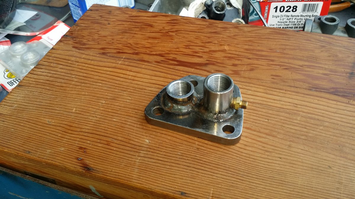

    Anybody know of a oil filter relocation kit for 324? Or a how to do it info? 56 if that matters. Thanks all
  23. They by-p*** adaptors pop up for sale with some frequency. Reach out to @GOATROPER02 as I think he makes new ones. Basically, you take off the oil filter housing and block mount, attached the new by-p***, then run lines up to your firewall, or wherever you're mounting a remote oil filter. Pretty straight forward.
    I did recently see a picture of stock housing modified to be used as an oil filter by-p***. Not sure on the work involved though.
    Picture from the Offy catalogue of the by-p*** is attached. Lower right.
  24. nochop
    Joined: Nov 13, 2005
    Posts: 4,613
    nochop
    from norcal
    Thanks Mr Canuc.
  25. Paul
    Joined: Aug 29, 2002
    Posts: 16,974
    Paul
    Editor
    the one in the catalog page above uses the stock pressure relief ball, spring and plug.
    there is also an aftermarket version without the pressure relief.
    both are relatively common,
    but a while ago I needed one but didn't have the time to go on the hunt and wait for shipping when I did find one,
    so I made the no pressure relief style out of steel,
    only took a couple hours and did the job fine.
    warbird1 likes this.
  26. nochop
    Posts: 4,613
    nochop
    from norcal
    Nice, looks like a 32, where did the filter end up?
  27. Paul
    Posts: 16,974
    Paul
    Editor
    tucked up under and out of sight
  28. nochop
    Posts: 4,613
    nochop
    from norcal
    I like it, I wonder just fo giggles If I could put a check valve in place. What does the check serve anyway, to keep dirty oil from gravitation back to block? Thanks Paul for taking the time to help me out.
  29. Paul
    Posts: 16,974
    Paul
    Editor
    If you are refering to the pressure relief valve it's job was to maintain oil pressure even with restricted (dirty) oil filter
