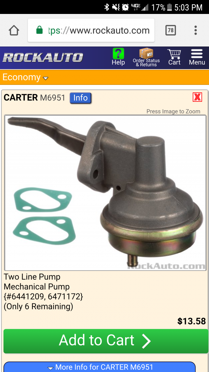

    Is there any aftermarket mechanical fuel pumps that will work with an early olds
  24. jebbesen
    Joined: Aug 18, 2015
    Posts: 797
    jebbesen
    from Winona, MN
    You can run a mechanical fuel pump off a late 70s Buick v6. Not sure if there are any high performance ones or not for that application. There's 2 different Buick v6 pumps the outside will look a little different but one of them will have the right arm.
    gonzo likes this.
  25. jebbesen
    Posts: 797
    jebbesen
    from Winona, MN
    Screenshot_20180323-170353.png This is the one I think I stuck on to get it going.
    40FORDPU and gonzo like this.
  26. jjjmm56
    Joined: Feb 7, 2009
    Posts: 557
    jjjmm56
    from FL.
    Do you know what kind of pressure it puts out, and thanks.
    49 olds likes this.
  27. jebbesen
    Posts: 797
    jebbesen
    from Winona, MN
    I haven't checked it but it's off a carbureted engine so probably a few psi. It works fine with the stock 4gc.
    40FORDPU and Paul like this.
