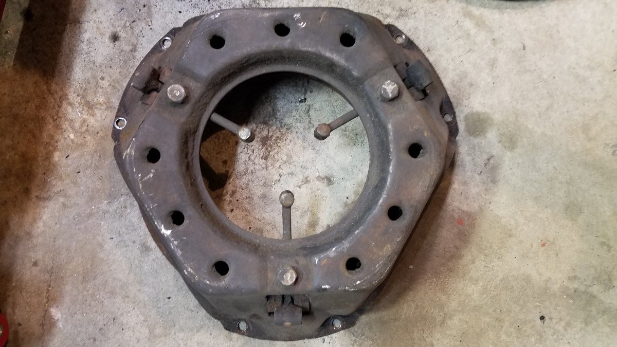

    If it is as simple as picking any 11" pressure plate and lining up the holes I'm going to feel pretty stupid...but it wouldn't be the first time.
    Or should I have new holes drilled in the flywheel for any 11" pressure plate I choose?

    The clutch disc has to fit the input shaft on the trans and clear the recess on the flywheel and bolts. If you have that it will work with any 11" pressure plate. Find someone with some old parts store clutch books. I'm sure there is something out there that will work. Are you sure the bolt pattern is the same as a Flathead? Be very careful who you let drill holes in your hard to find flywheel. They have to be dead on. You don't what to sling that m*** off center, not even a little bit. :eek: :D

    I know the previous owner had a Ford Flathead transmission on my 303. I took a picture of the pressure plate last night when I pulled it off and a couple people I showed it to said it was a Flathead pressure plate. I thought it sounded funny that it would fit but what do I know? Apparently the site I had been using to post pictures here now ants money to be a third party site and I'm not doing that or I'd post it.
    The drilling thing was more thinking out loud. That would only be a last option, everything else has been exhausted, possibility.

    You can post pictures here from your desk top, at least I can. I the '60s I had a 303 in my '38 Ford coupe. I had a '39 trans behind it, several of them. :rolleyes: It had an 11" Ford truck disc but I don't remember what pressure plate.
    What is this in? What rear end? If the car is light a 9 1/2" -10" clutch is probably enough if it's not s race car. If it is a heavy car an 11" clutch might help you break stuff. I'll try to dig out my old books. I have some Flathead flywheels and pressure plates laying around . I have a Cad 331 too but no flywheel which is the same as Olds. I'll be knocking around in the shop tomorrow.

    Wilcap can redrill your flywheel to match whatever pressure plate you need, that's what I had to do.

    Well, it's certainly nothing heavy, it's a '52 Henry J with a 8" Ford rear. I think the engine and trans weigh more than the entire car...ok maybe not more but close. lol
    I'm not really going for a race thing yet, defiantly not a g***er, but I will be hammering on it every single chance I get. I ordered an 11" clutch and pressure plate yesterday and it will be here today so I'll know by tonight. I'm trying to get this ready for the Hot Rod Dirt Drags on June 1 so time is of the essence.
    I know a very old local engine shop that does a lot of work on vintage stuff and I feel confident that, if I need to drill anything, they can handle it. If it wasn't for the hydraulic throw-out then I could just do a three finger pressure plate and that would certainly make this easier, but I'm trading off the h***le of shift linkage for this.

    If you want an "11 clutch and P.P. that will fit an early Ford, just go to Rock Auto and look up a clutch kit for a mid 60's Ford pickup with a V8 and truck 4 speed. It will have the same spline as the early Ford and is a Long style P.P. the same as early Ford, like the one in the picture. These kits are brand new Borg Warner and come complete and are reasonably priced!

    I've got an 11" GM clutch disk as my trans is a Saginaw but finding a 11" Ford pressure plate has not been as easy. I just ordered one you suggested and we'll see how it works when it gets here. I do order quite a bit of stuff from Rock Auto and the only thing I wish they had was a better description of the parts. Speedway and others had hole spacing, bolt radius, and other info. Thanks for the suggestion on the truck option.

    Why won’t a hyd throw out brg work with a 3 finger PP. I installed one on a 303 with a t5. It looks to have plenty of disengagement.

    I was going by what I'd read when ordering the bearing. Plus after talking with a couple guys the reason we came up with was that the hydraulic bearing needed a more dispersed pressure area which the diaphragm style provided.
    Either way, I'm going to use a hydraulic ram from Speedway to move the stock throwout bearing and pressure plate.
    On that note, I ordered a pressure plate from a '65 Ford pickup and it matches the holes in the flywheel and I picked up a pressure plate from a 55 Chevy to match the spline count and shaft size. Clearances all match everything I took off and I think I'm ready to go. I need to change the pilot bearing but I've got a few of those for replacements.

    Well, everything fit together but I haven't installed the slave cylinder yet. There is maybe, at most, a 1/16" play between the throwout and the pressure plate I'm not worried about that. I figure if there needs to be no play I can take it out when I place the slave.
