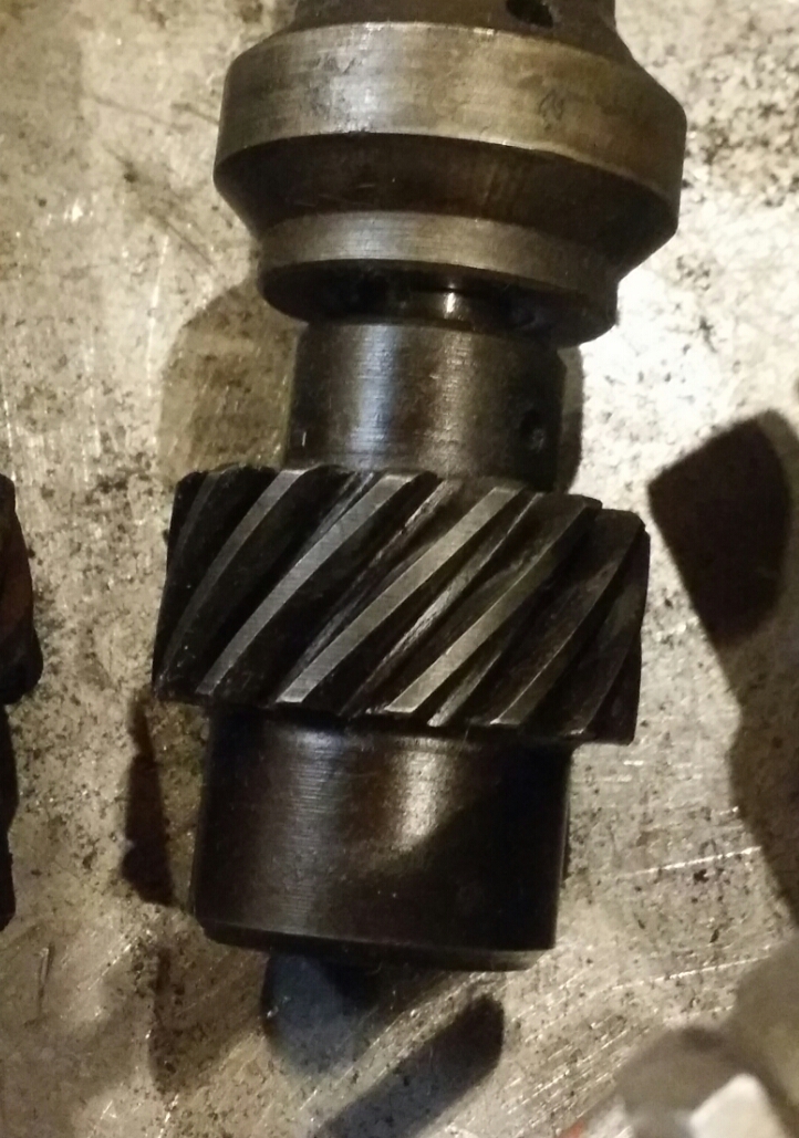

    Couple quick snapshots of what was handy,
    The one with the gear and no washers is out of a 394
    The one with washers and no gear is out of a 303

    Thanks, Paul! That does help a ton. Mine looks exactly like the 394 one, so I'm going to put it back together without the spring washer. Near as I can figure, my motor has the #8 heads, so my ***umption is it's a 324 (1955?). The numbers on the pad on the block are virtually unreadable. Going to do a cam swap, timing chain, and have the heads freshened up. Really glad this thread is here, I've been going back and making a list of small upgrades for it...like the removal of the draft tube and the elimination of the water tubes at the back of the block. The motor is in my '27 T roadster, so no heater!

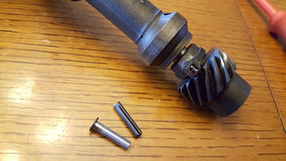

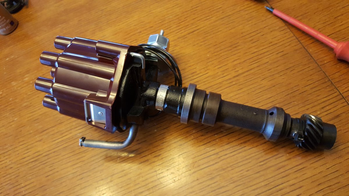

    Here's a pic of the 1956 324 one I just rebuilt. I milled the stake off the rivet so I could pull the shaft out. The new rivet is in the gear in this picture that's why the zip tie is there, just so it didn't fall out when I ran it on the dist mach. After I was done I peened it over. Wanted to make sure everything was happy before putting it in permanently. Some guys use a roll pin. I made a new rivet on the lathe. The roll pin probably would work fine but makes me nervous about it falling out. You can see how much clearance mine has. I have a couple other Olds ones that are similar. I'd honestly just run it. Mine worried me too till I found some Olds guys on another forum discussing it. One guy had shimmed his up nice and close and basically destroyed it when he put it in the engine.

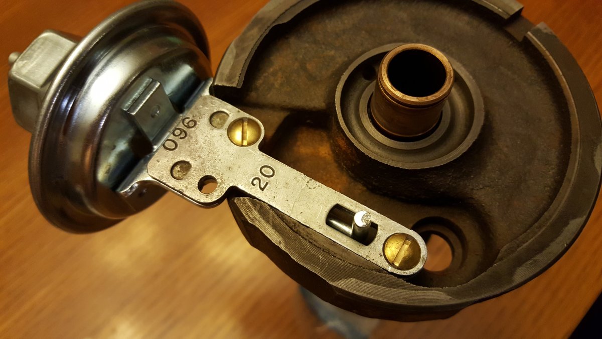

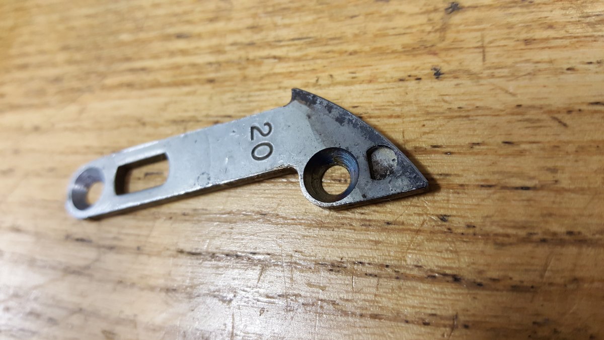

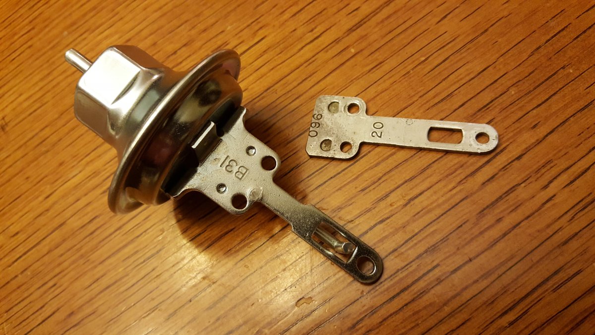

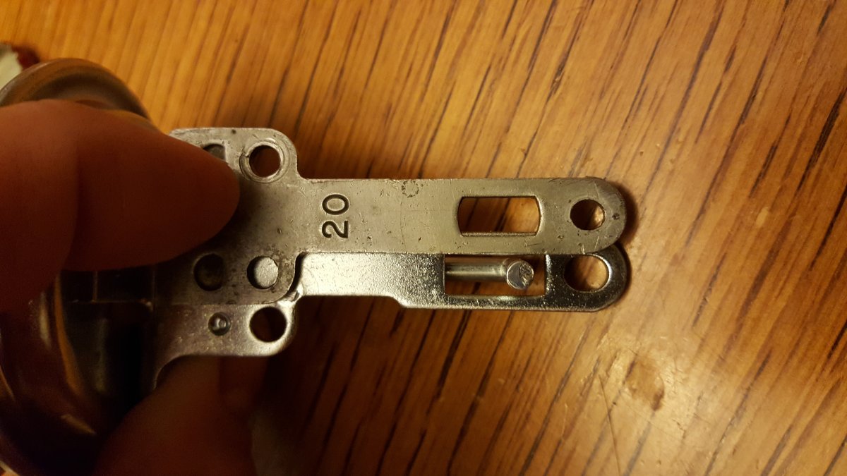

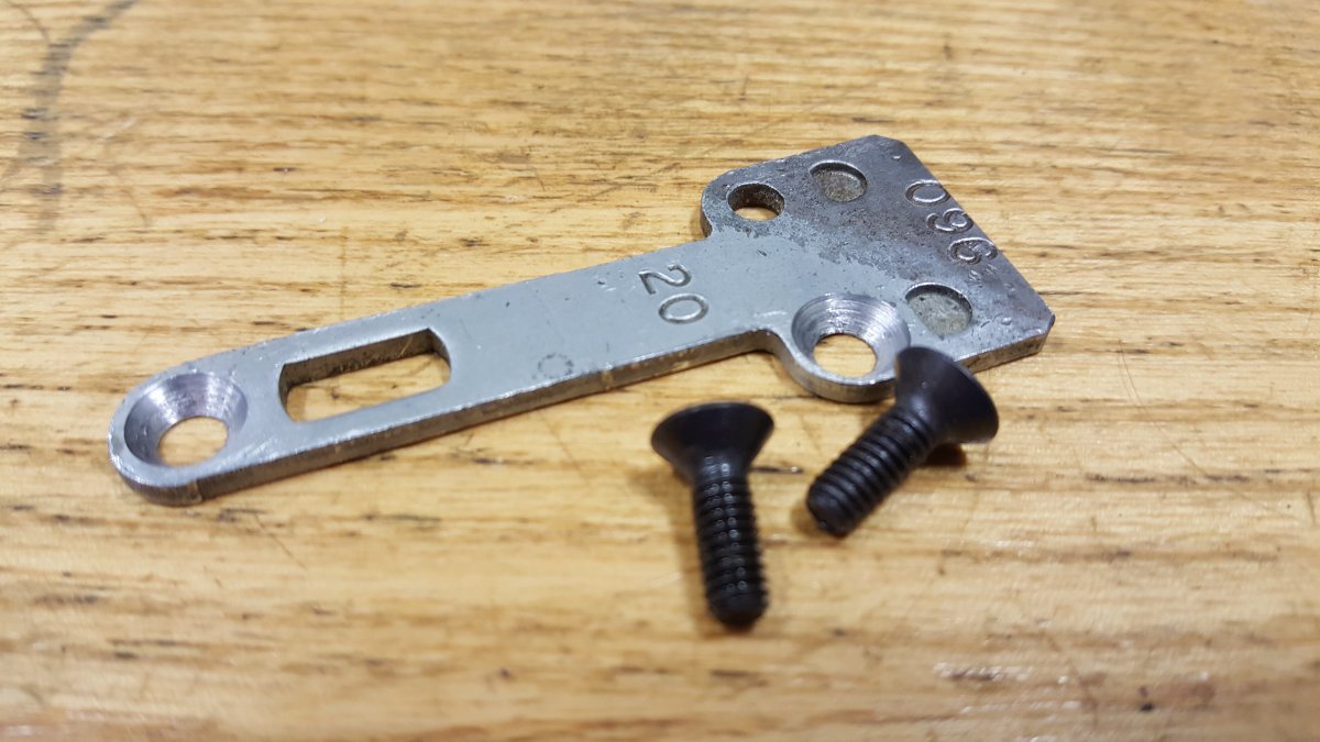

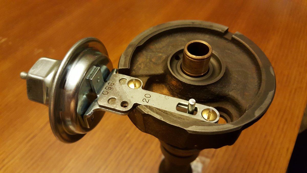

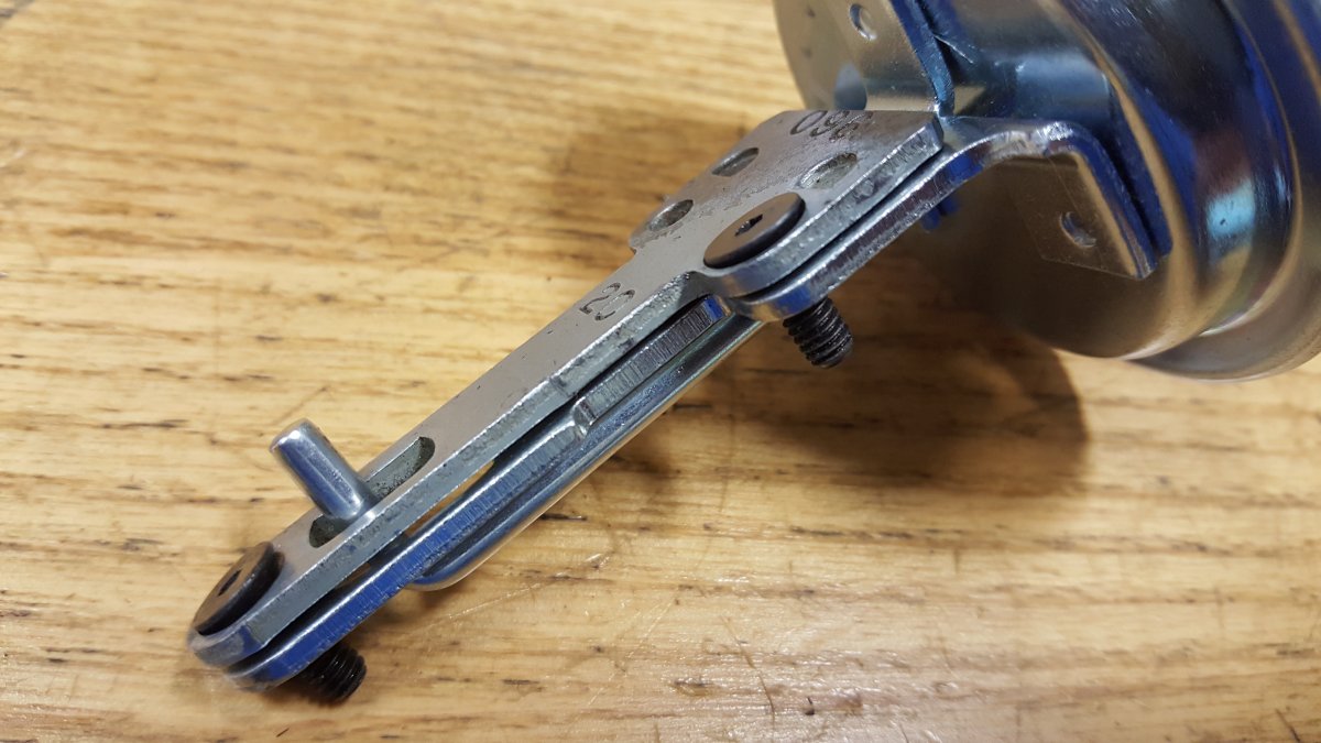

    Since we are talking distributors I wanted to share an idea I'm trying on mine. My vac advance can was shot and I thought I'd try a Crane adjustable unit. They adjust very easily but don't have to limit stops in the same place as the original can. By cutting up the original one and stacking the bracket on top of the new adjustable one I have curve adjustment with factory max advance. It all works great. Found out I had to trim the original one slightly for cap clearance. May also change the advance springs in the future but right now I set it to stock advance specs per the 56 manual

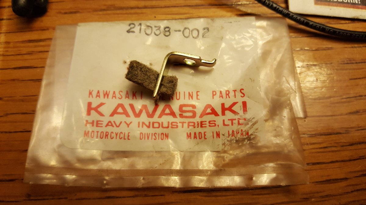

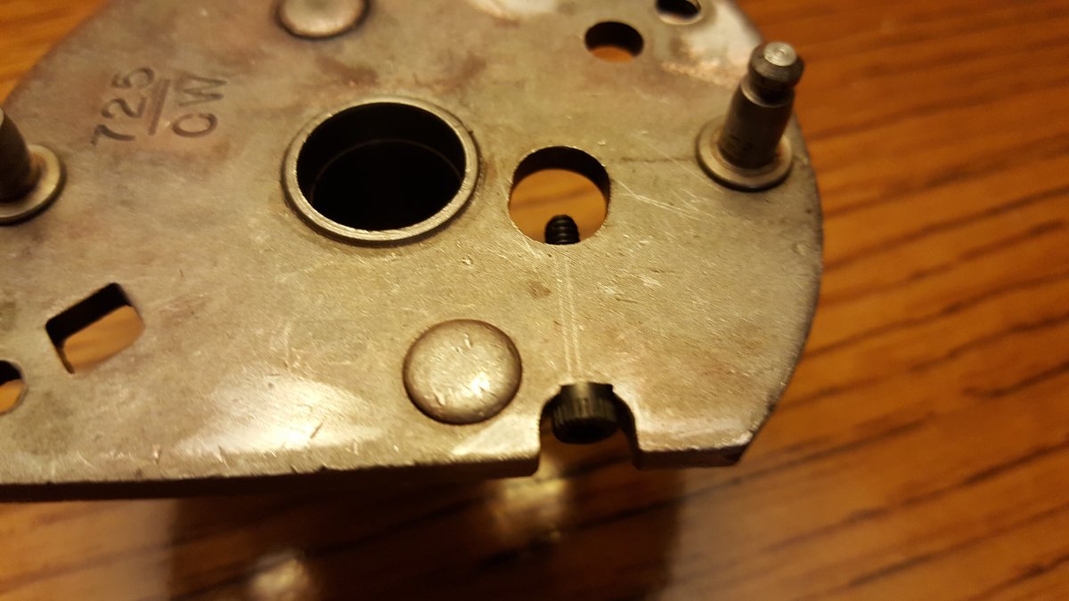

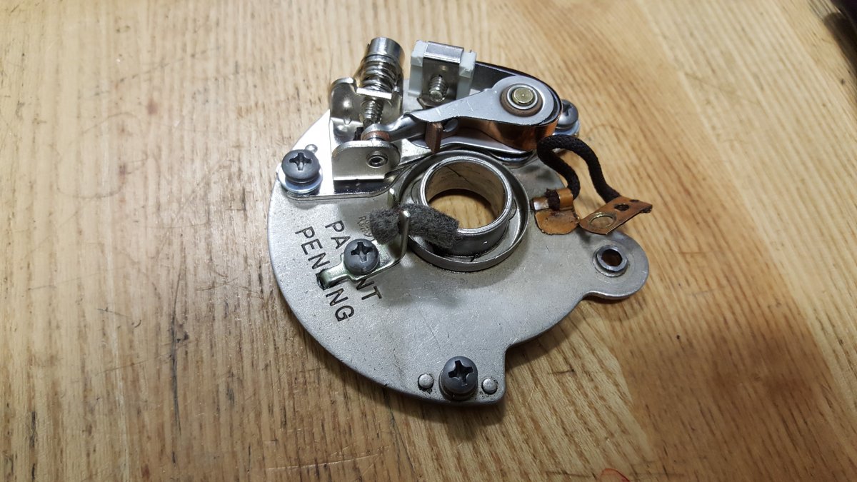

    Another mod I made was to add an oil wick bracket to the points advance plate. The Bluestreak points incorporate a wick but they have a plastic rub block. I prefer the phenolic rub block that the Napa Echlin points have. However they eliminate the wick. When I saw this Kasasaki wick holder I decided my problems were solved.

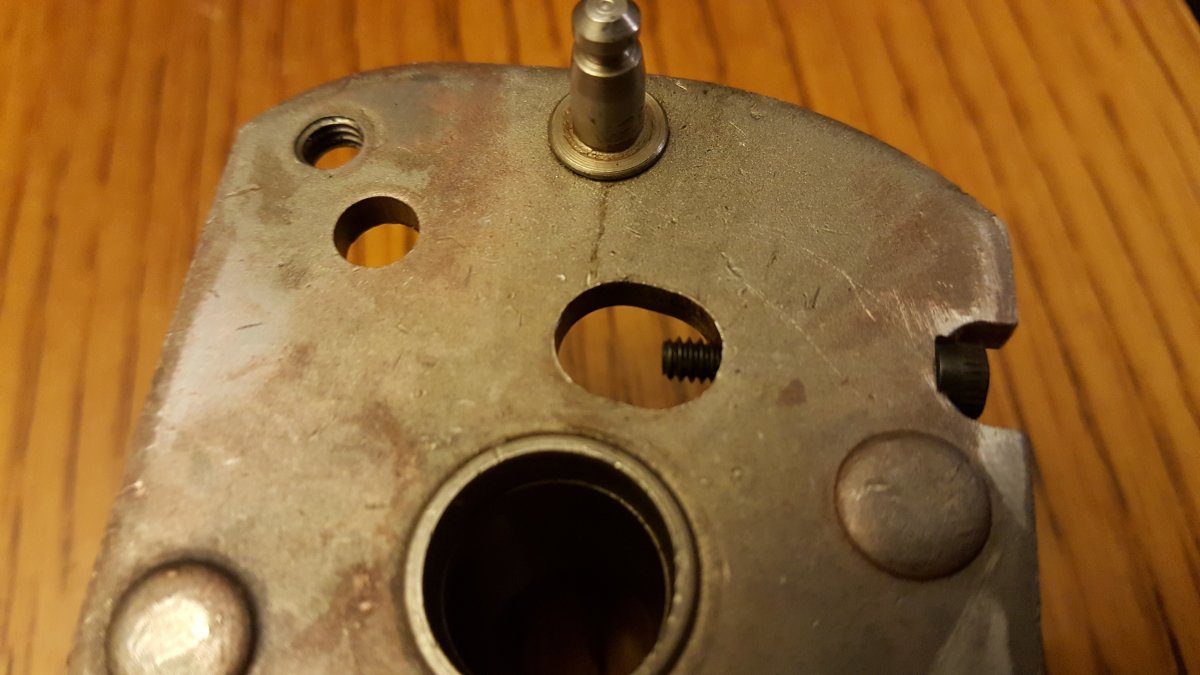

    I also added a mechanical advance weight stop screw like Bubba does to his flathead distributors. Not sure this was necessary but figured now was the time since it was all apart.
    points cam2.jpg points cam3.jpg .

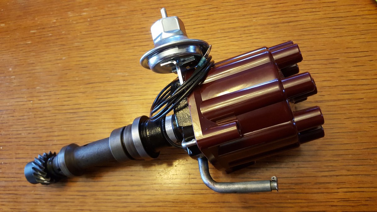

    Finished it up with a Summit Racing cap and rotor. Very nice parts with br*** contacts. I'd put them on par with the old Mallory stuff.
