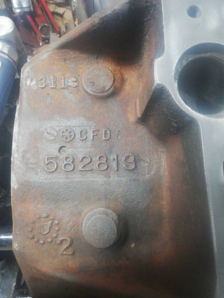

    I have what I believe to be a 1962 394 engine which needs a rebore. It hasn't got 4 1/8 cast at the back but bores measures that within a little taking in account the wear. So my question is, is this a smaller block been bored to 394 size or is it just one block that never had 4 1/8 cast next to the number. I don't want to have it bored and go into the water jacket

    From my info, that is a 62-64 394 replacement block (probably no serial number pad on left deck outer edge in middle)

    That's great thanks I didn't realize they did replacement blocks? Was this done in the period or later on ? My next question is were is the best place to get parts from? It needs a complete rebuild, so need everything!!!

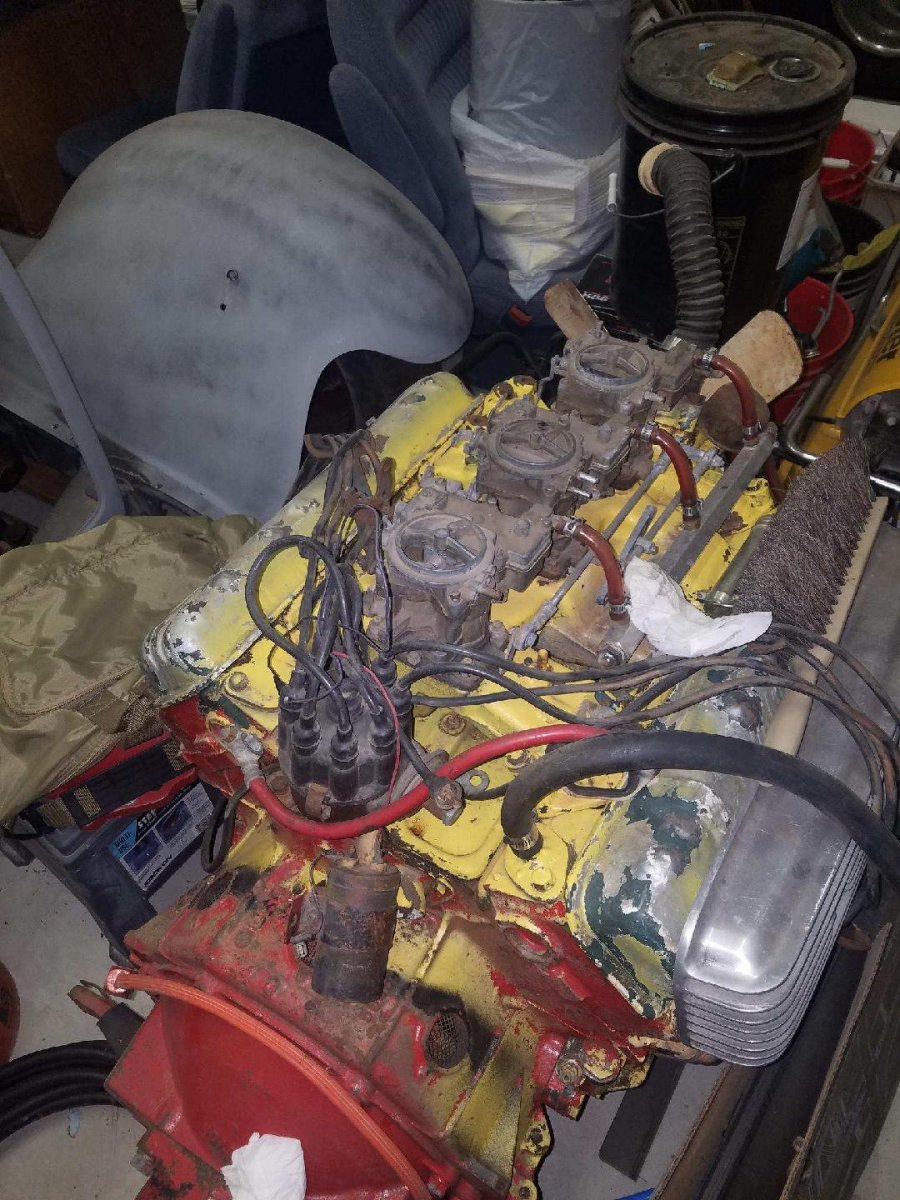

    I can make out 56 under the coil in this picture but not much else. Any guesses which Olds engine this is?
  11. Hard to say without better pictures/more information. Head numbers would help, though those can be changed. Looks like 324 valve covers, at least one anyways on the left side. 303-324 based on looking at it, but that's about it.

    Without serious modifications the factory 3x2 manifold will only fit the 1957, 58 371 block/heads.
    Paul likes this.
  13. Is that the factory 3x2? I couldn't tell from the picture. Agreed though, without wedge adaptors, the factory 371 tri-power intake won't fit the earlier 303/324 heads.

    Is that a transmission adapter on this engine? I asked for better pictures of the block numbers. Not sure when any will be forthcoming.

    Screened port holes on block extension make it an early block, looks just like my spare '51 block.
    Carbs and intake are '57-'58 J2 stuff.
    Bell housing is a '50 Olds.
    Definitely a mix and match setup, interesting to see what other secrets it has

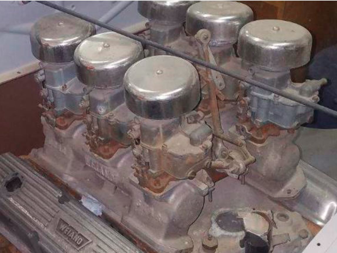

    There is this Drag Star setup as well. I am wondering what I should offer? I have not laid hands on it and do not know whether carbs are seized or anything else. Not much to go on, especially with home confinement.

  17. The expert has spoken! :)
    I've seen 6x2 setups go for quite a range, $200-$600+ Hard to say without knowing the condition of the carbs but I think a package deal for everything will be your best bet. Without knowing condition of everything it's hard to say. Up here, all of that for somewhere between $500-$1,000 would be a good buy, but Olds motors and speed parts are not that common in my area.

    The J2 manifolds are wider than the 49-56 blocks so in order to fit the early engines they must be milled (If memory serves me correctly around .100 per side) to fit an earlier engine. The Distributer in the engine in the picture is a 51-55 unit.

    Looks like '51-'55 distributor to me

    Was there supposed to be a water crossover that came with the 6x2 Drag Star?
  27. vtwhead
    Joined: Oct 20, 2008
    Posts: 5,307
    vtwhead
    I believe it is separate and an expensive item to find.

    It's a 303 with a 57-58 J2 setup. So I imagine the J2 has been machined. There is an adapter and LaSalle trans still hooked up. Apparently it was all put together 50 some years ago by a young 16 year old.
