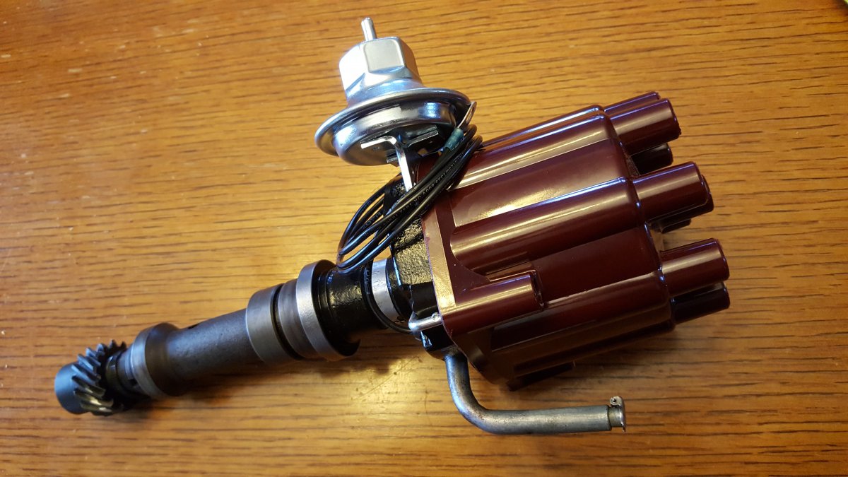

    @Paul and @jebbesen great info from you both on the distributors.
    Can you run any year distributor in any 303/324/371/394, as long as it has the appropriate cam gear?
    I have a good '61 394 distributor with a Pertronix in it, and would like to run it in a '56 324. Is swapping the cam gear from the 324 distributor to the 394 distributor all that's involved? How involved of a process is it to get that rivet out of the gear? Or would it be easier to just buy another Pertronix and put it in the 324 distributor?
    Thanks again for your contributions to this great thread

    yes '49-'64 distributor bases share the same configuration
    the difference is the oil pump drive shaft
    swap gear to fit shaft
    can't advise on Pertronix as I have never used it.

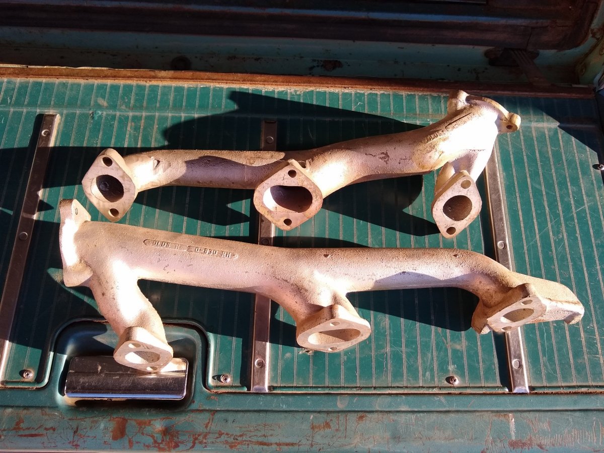

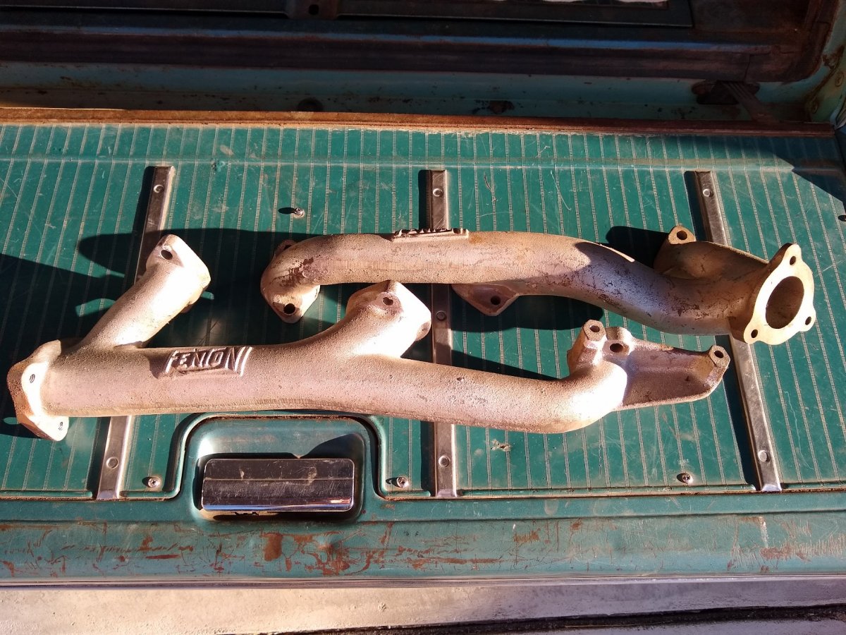

    NOS Fenton Olds 303 headers
    curbspeed, cactus1, 36 ROKIT and 2 others like this.
  12. 57JoeFoMoPar
    Joined: Sep 14, 2004
    Posts: 6,510
    57JoeFoMoPar
    Malcolm likes this.
  13. I p***ed on a set about 7 years back because I thought the $500 price tag for NOS was too steep. Still kick myself on that one. Great score!
    Let me know if they're for sale... :D

    @Speedy Canuck looks like they sold already :( or did you get them???
  15. Been a crazy busy couple of days. I missed out on them :( C'est la vie.

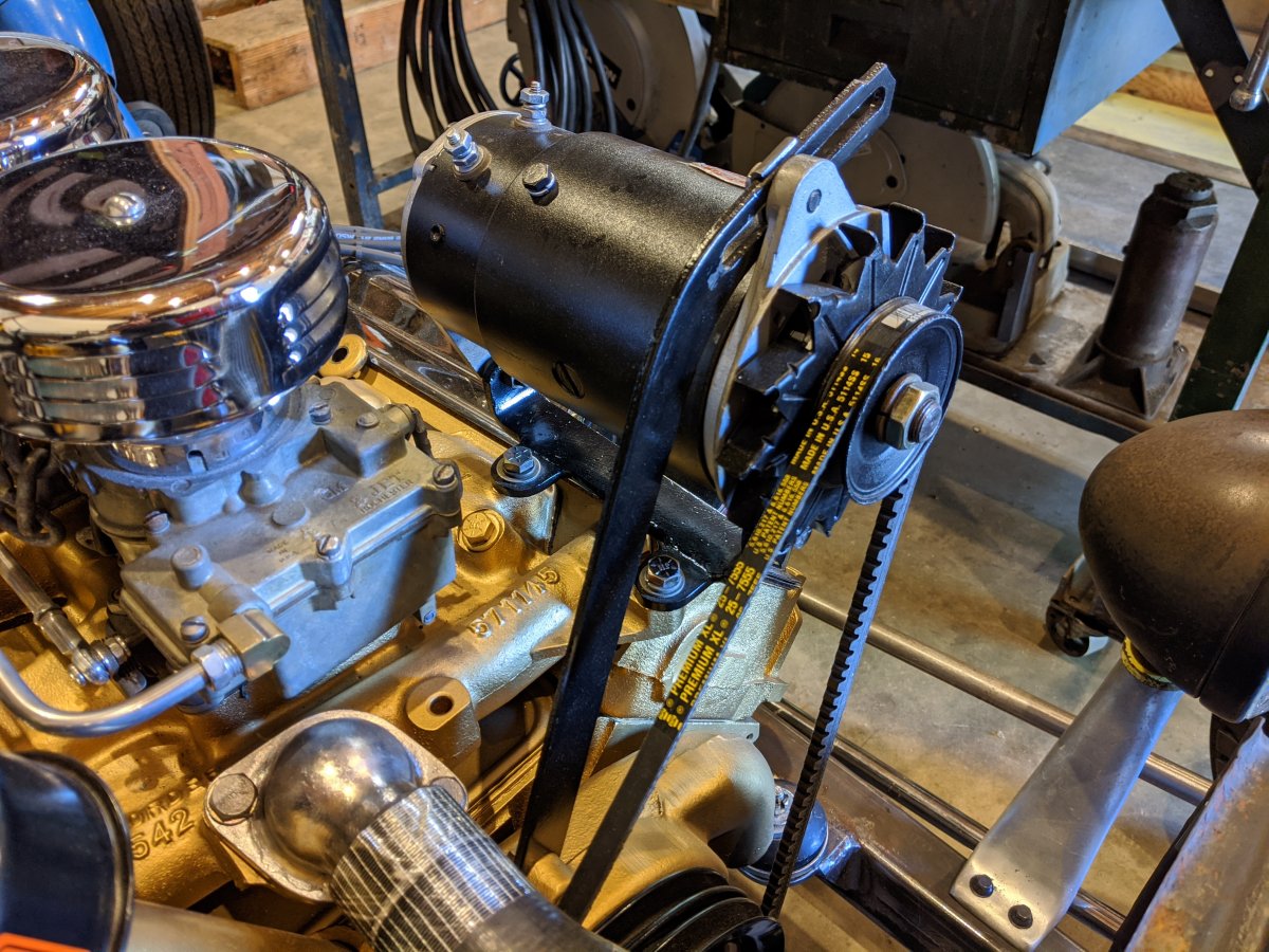

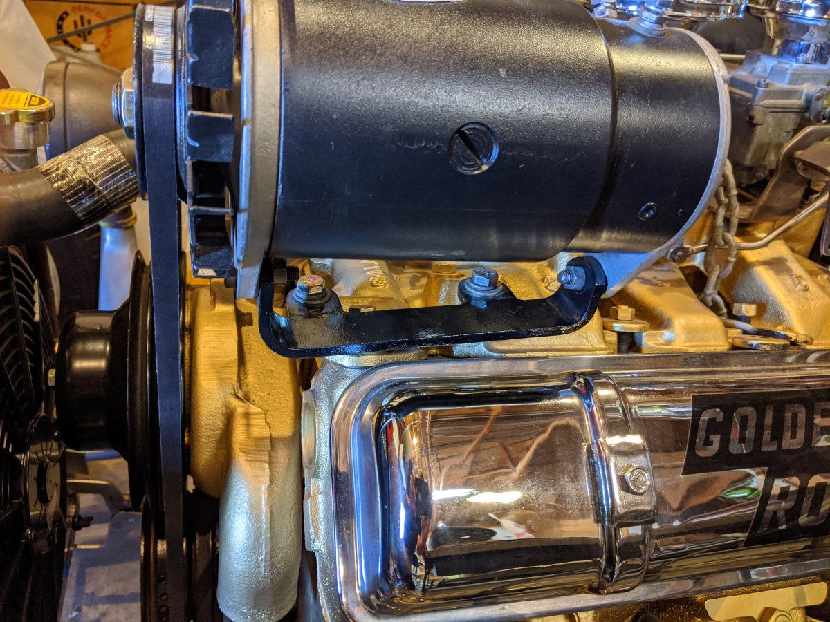

    Paul, what year is the generator bracket on that engine? I have a '57 J2 that I want to move the generator to the drivers side. Any help is appreciated

    'forget which engine it came off of originally. '55 2 bbl? I modified it slightly by welding up the stock mount holes and adding ears to offset it some.
    The adjuster arm did come off a '57 2 bbl but they were probably used on others as well.

    Many thanks for the detailed pics Paul!

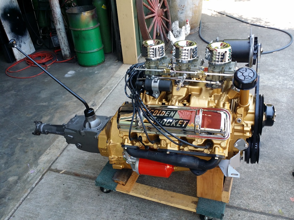

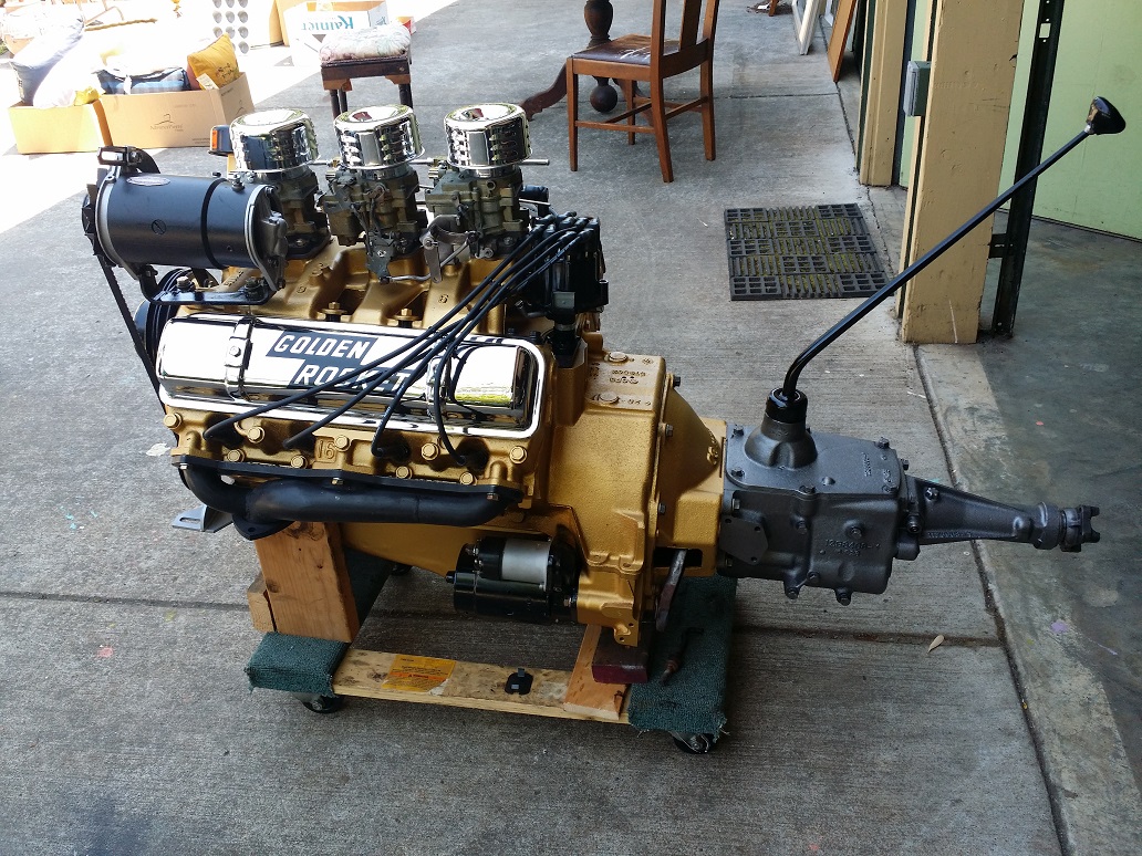

    I don't post much at all. This is one of the most informational threads I have followed. Thought you guys would appreciate this. This was on my 55. I unfortunately had to sell it, but I kept the running gear though!! New owner wanted an LS. Hated to see the swap, but glad I got the engine. This thread is awesome. Thanks for all of the info. Screenshot_20180517-221721.png IMG_20180522_105304061_HDR.jpg
  23. belair
    Joined: Jul 10, 2006
    Posts: 9,036
    belair
    Great car. New owner doesn't know what he's missing. I have a 324 with no home too.
    kidcampbell71 likes this.
  24. bskustoms
    Joined: Jul 23, 2008
    Posts: 424
    bskustoms
    from Aloha, Or.
    Great looking motor, new owner of car sure wasn't thinking :confused:
  25. The new owner can't have known very much about these wonderful Olds engines. I hope you have a project in mind.

    I know man. I would take this 5 mile per gallon jewel any day over a 30 mile per gallon clone. Would be awesome in a chop sled or a slammed old truck.

    Thanks, really stoked I still have it. Big challenge to tune, (I'm not very good at it) but worth it.
