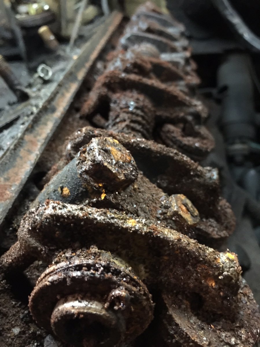

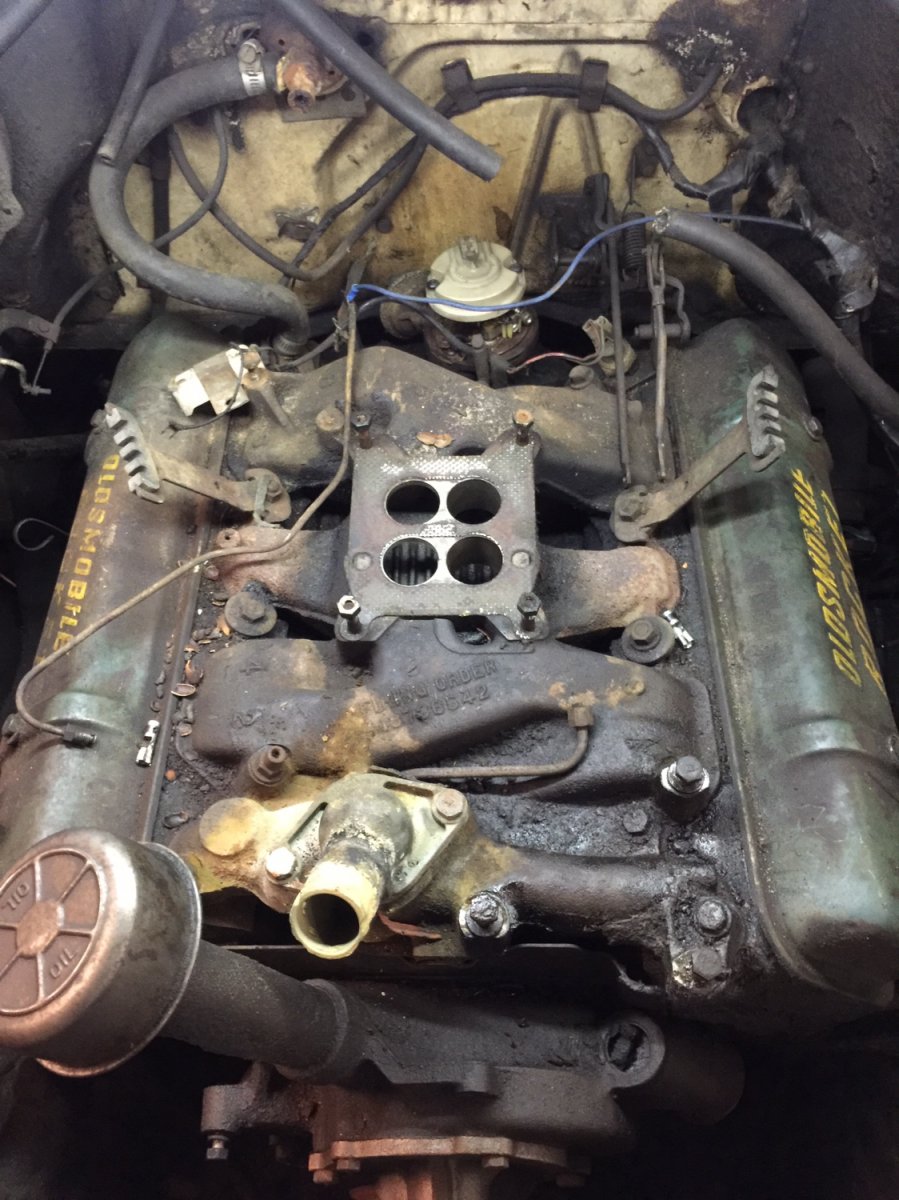

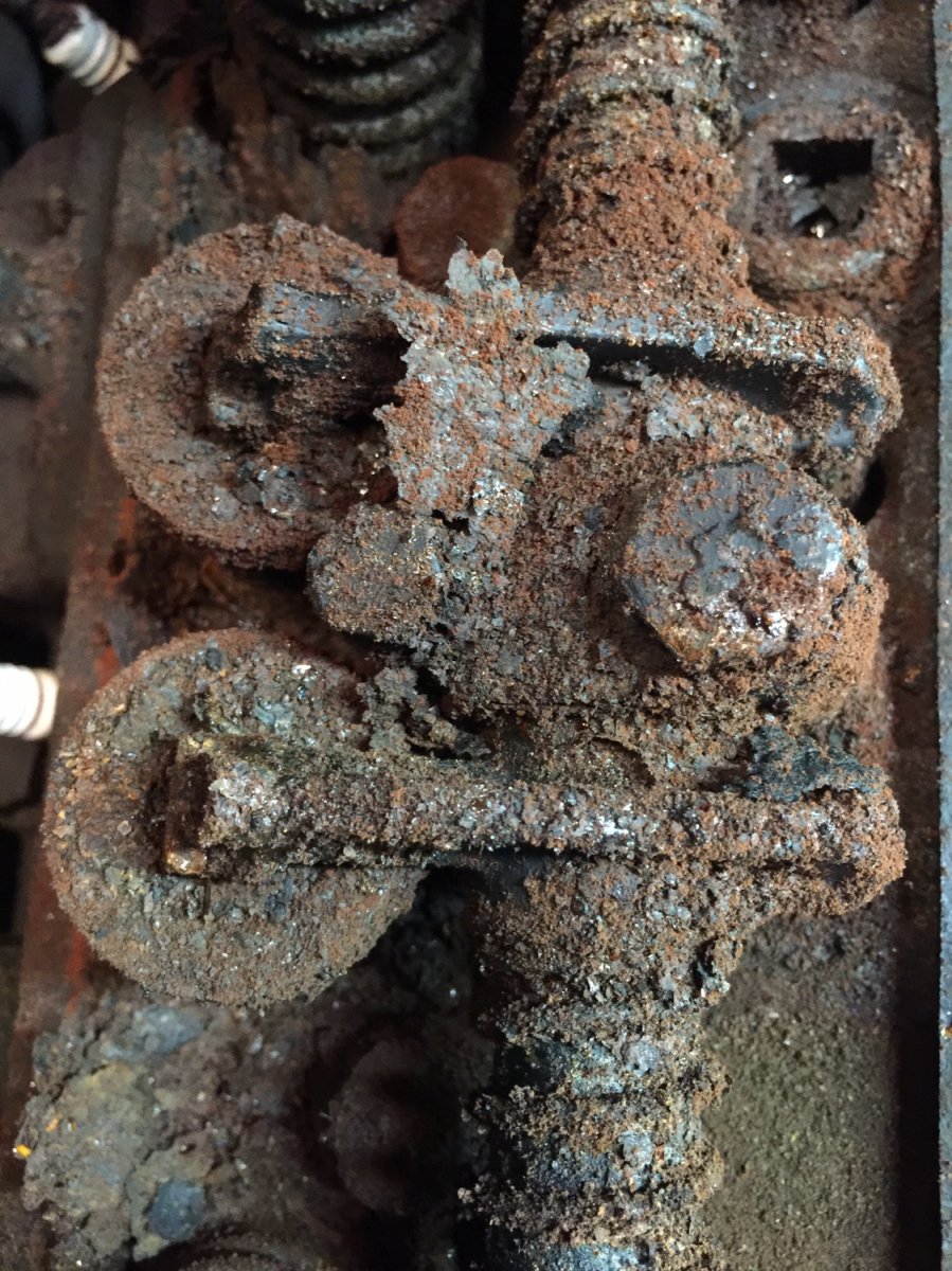

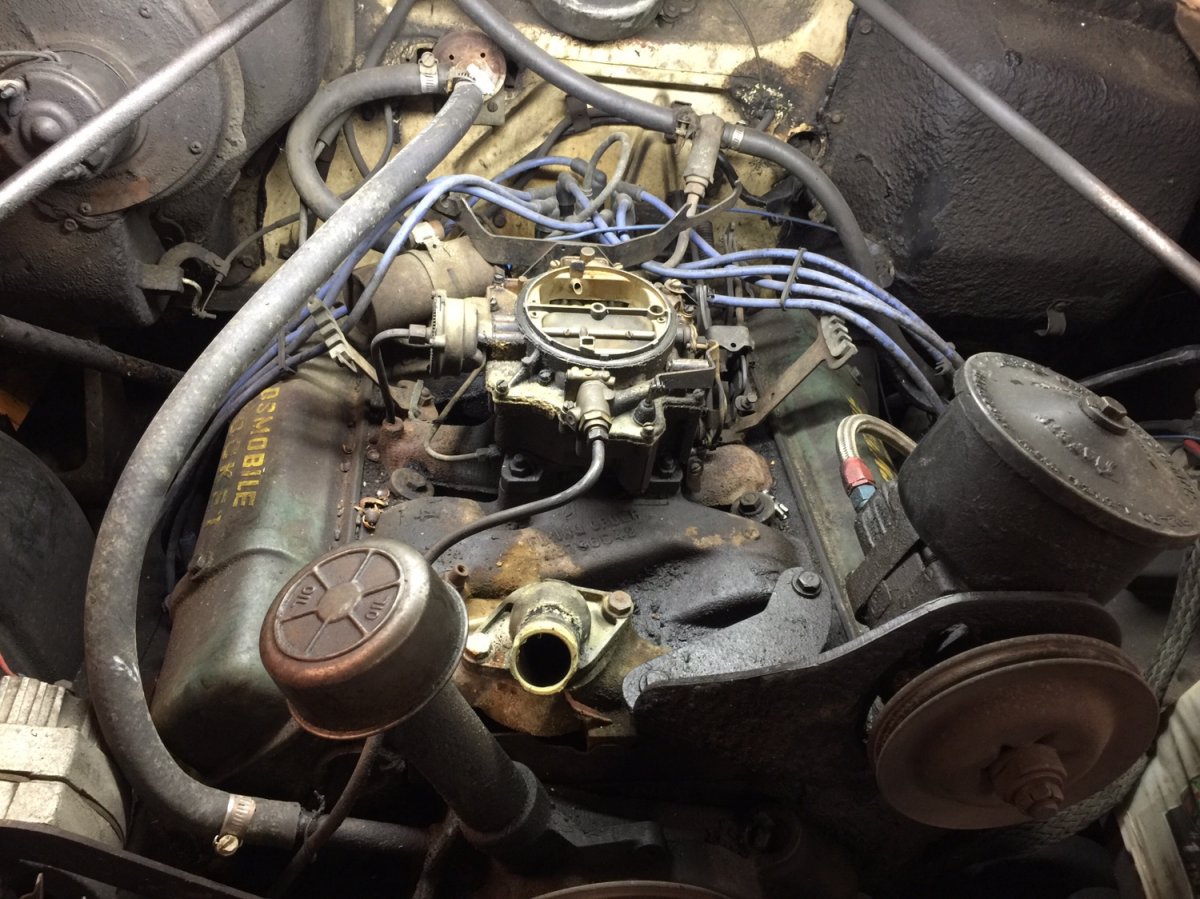

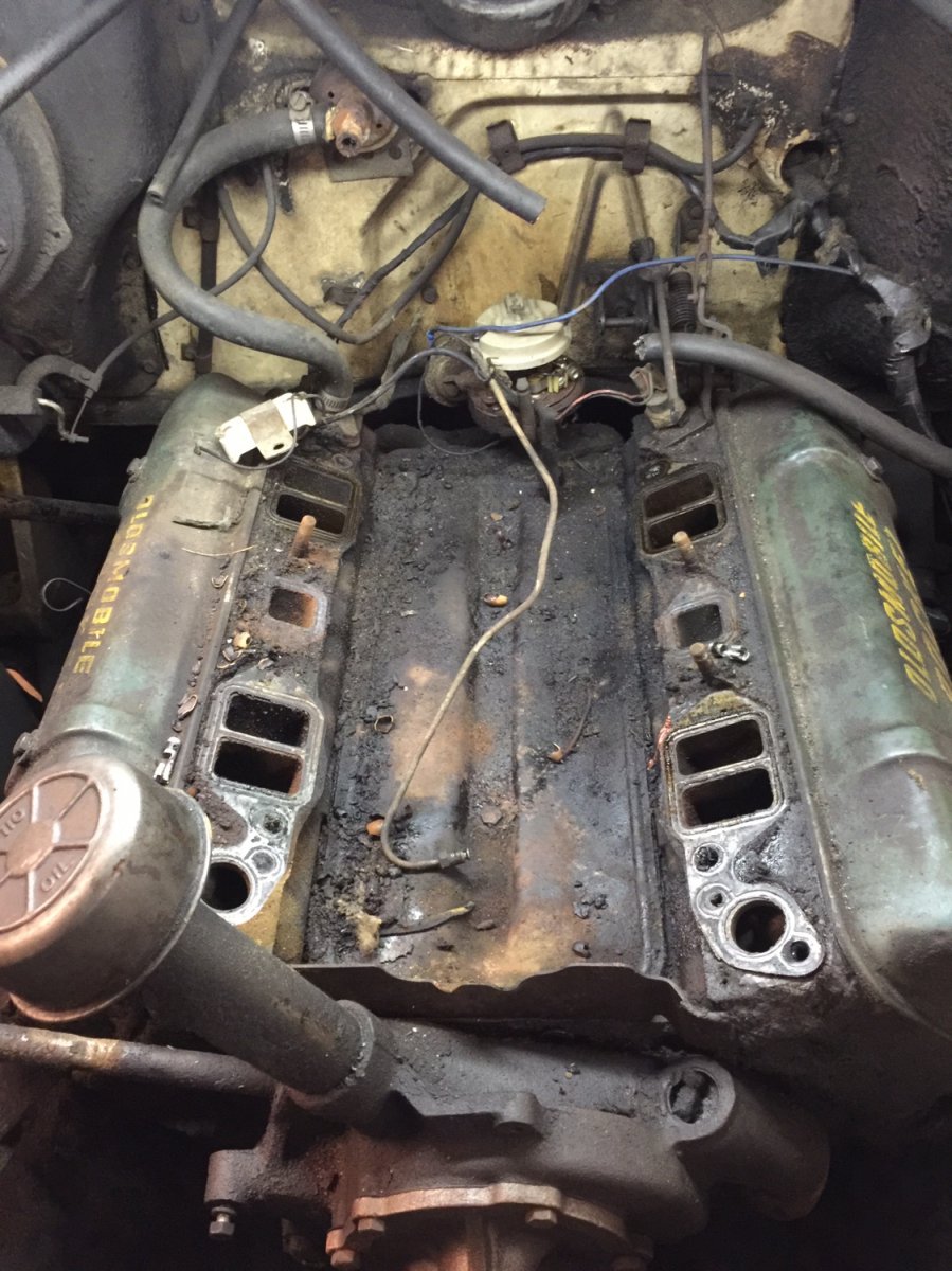

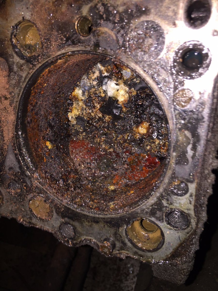

    Posted this over on my ‘56 Olds build thread, but thought I would also share it here
    Stripped top half of the 324 today, to see why she was seized and make it easier to remove. This motor is toast.
    Anyone interested in the #10 cylinder heads or other engine parts?
    PM me if so
  28. gonzo
    Joined: Dec 24, 2003
    Posts: 1,900
    gonzo
    That motor can be bored 1/8". Could still be salvageable.
    ted kovacs likes this.
  29. jakespeed63
    Joined: May 1, 2005
    Posts: 2,867
    jakespeed63
    Gonzo, I’ve heard they can go more than most but that’s incredible!!
    Good to know
  30. 57JoeFoMoPar
    Joined: Sep 14, 2004
    Posts: 6,510
    57JoeFoMoPar
    The worst part about a seized first gen Olds with a transmission attached is dis***embling the engine with it all still attached and lifting the block off of the crank. What a *****.
