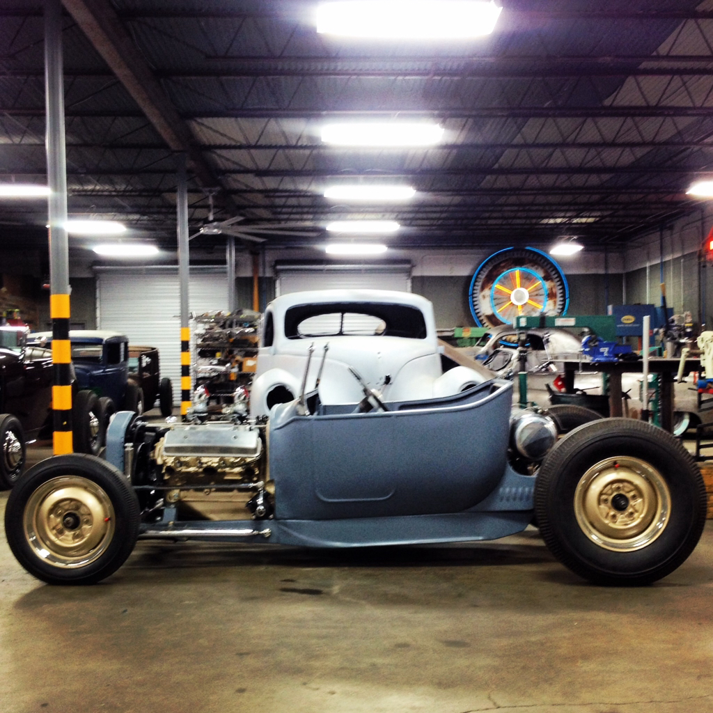

    Very cool. I've been doing a little sand casting with a goal of making a set of Olds covers that are tall enough for adjustable rockers but smooth so that someone could machine their name into the top like Iskenderun did on his T back in the day.
    I'd either of you would be up for trading those Valve covers I have olds speed parts I'd be willing to put on the table.

    I have a pair of Fentons I'd been thinking of shaving the fins off of to do that

  15. @Anderson did that that on his 24 T Roadster build. Can't remember what he started with, as it looks like some photos are missing from his build thread. But here's a shot of how it looked.

    I don’t know what they were, there was no name on them and I never could decide if other ones I saw were a match.
