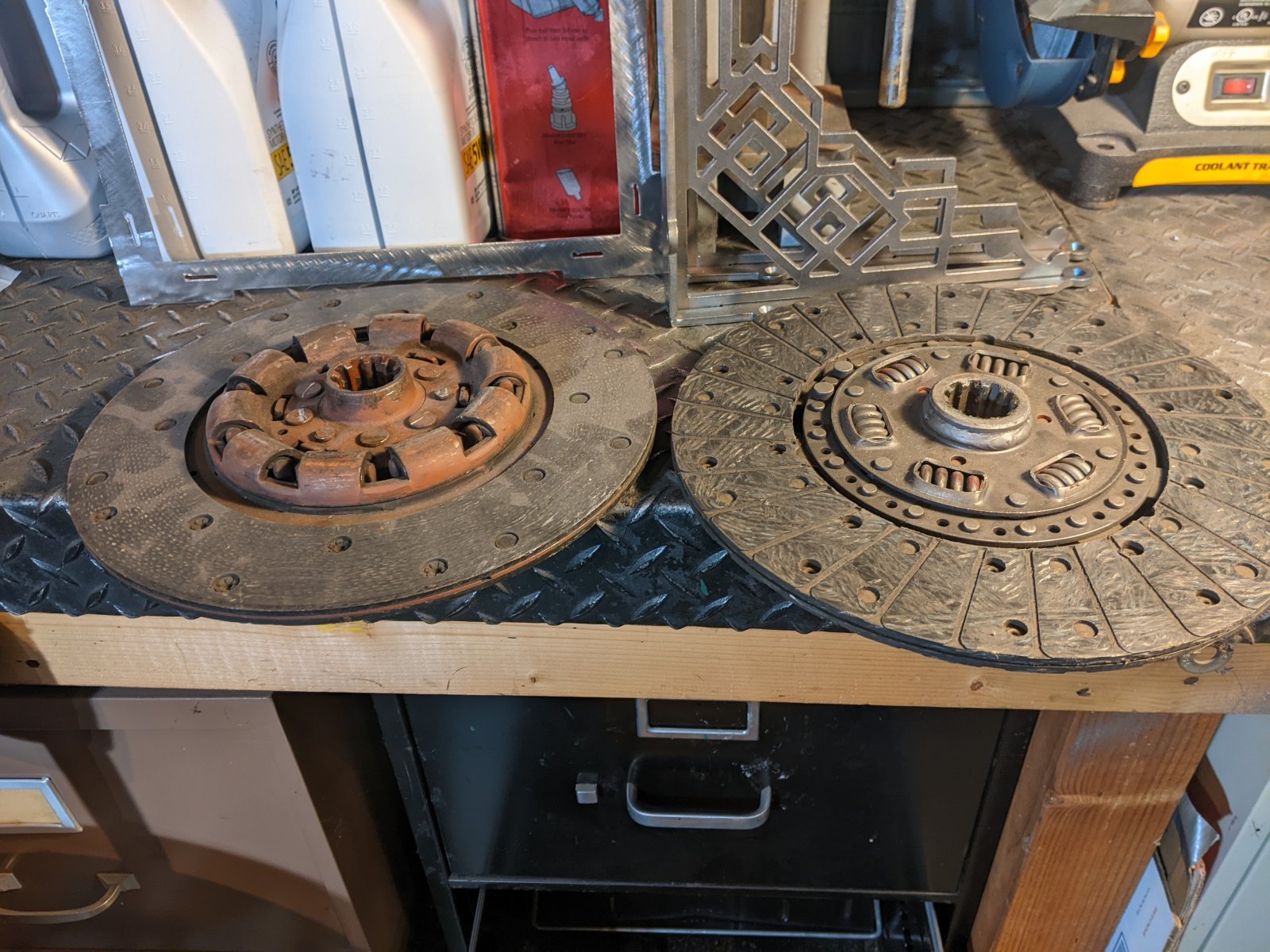

    here is a picture showing the Scout clutch plate (disc) on the left and an Olds on the right with the flywheel side up on both.
    there may be other Scout plates out there that would work but this is what came when I ordered one.
    11" diameter with correct spline but hub too big.

    Thanks! That is a lot more of a difference than I was thinking. The Scout must have a meatier flywheel maybe because of 4 wheel drive.

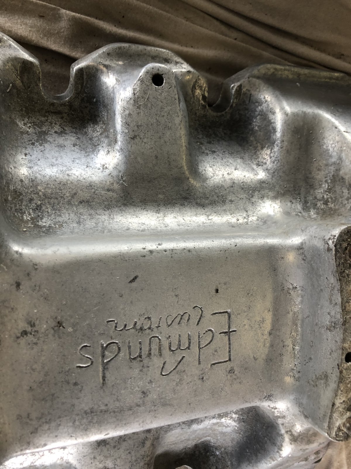

    Since this thread is open again can anyone tell me what these holes in the middle of my edmunds intake are? They are connected by a metal tube that runs through the manifold, it looks like someone made a half *** effort to thread one of them but I have no idea why.

    the hole is for the choke heater tube
    bchctybob and nochop like this.
  10. Crusty Chevy
    Joined: Aug 28, 2007
    Posts: 1,333
    Crusty Chevy
    The metal tube inside it is to keep exhaust soot and corrosive products out of the choke housing, thus it is open on both ends to the atmosphere. It can be a source of a leak as they are often cracked internally and should be pressure checked.

    Bingo. I threaded mine and put a plug in it but it's still a leak. Oh well, turn the radio up

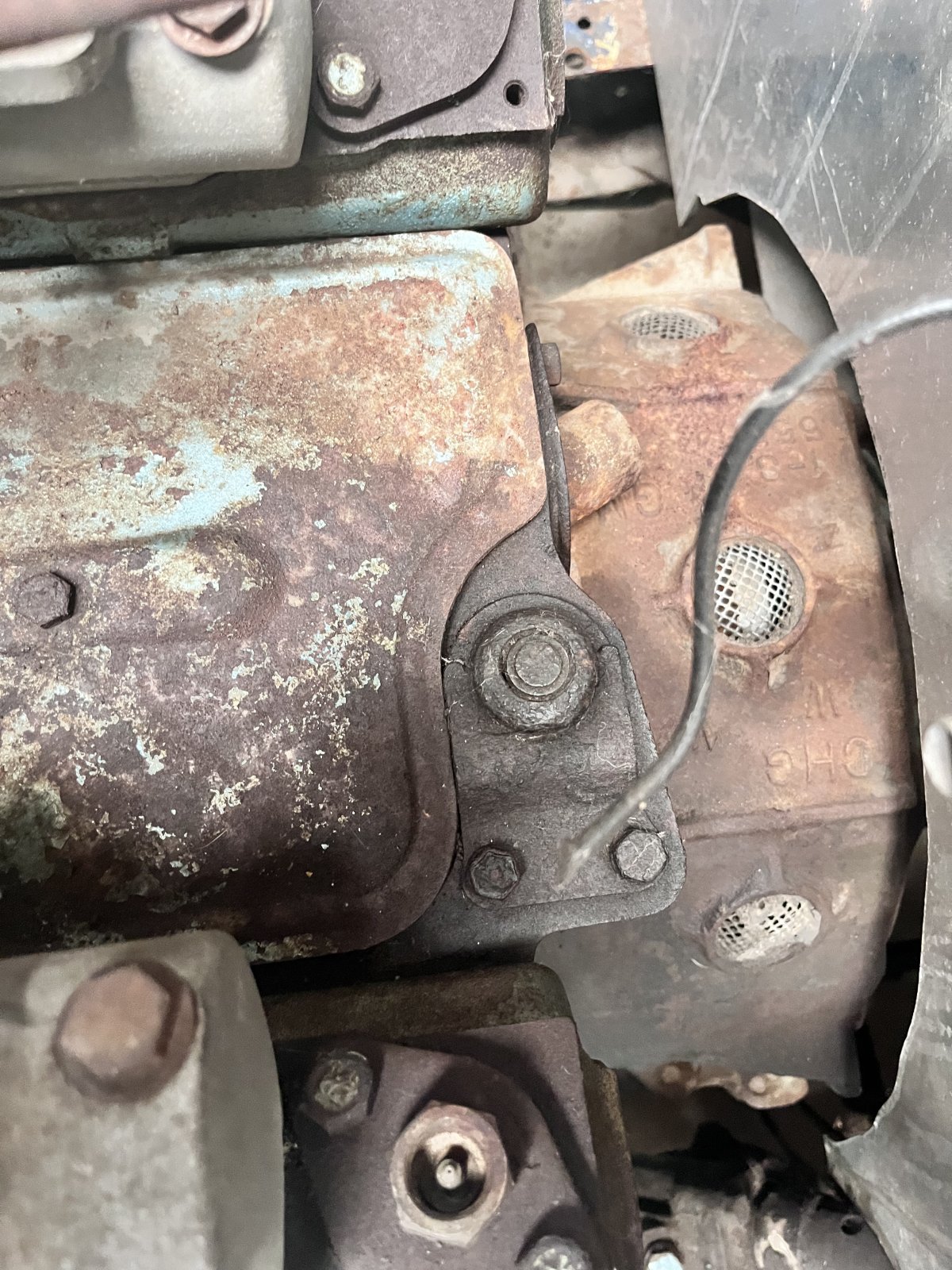

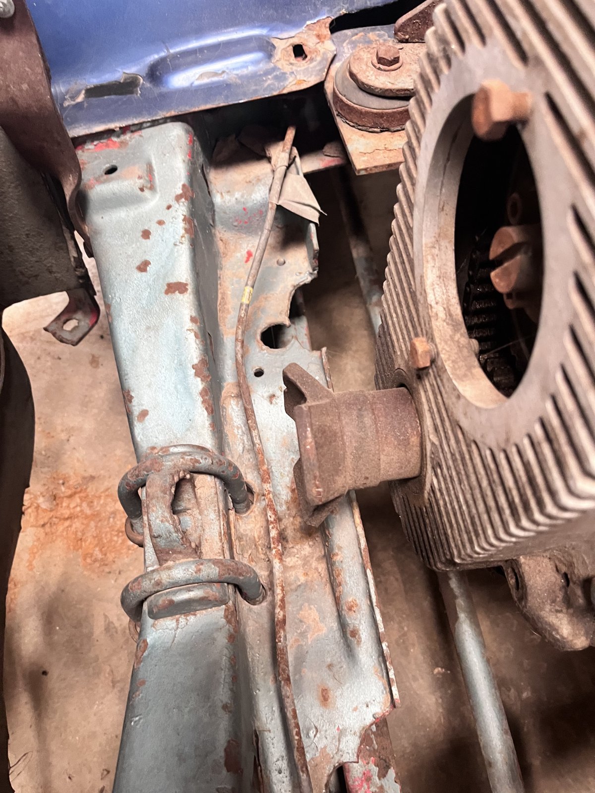

    656E7306-2940-4489-8C29-801332D3C780.jpeg D5948AB3-DBC0-40F5-A4F9-5A3AC44EC183.jpeg Looking for info on front cover mag drives. This motor ran with some sort of front mag. The cam ****on has a slot machined like it would take a hemi shaft. The distributor hole has a block off plate with a cut down shaft to drive the oil pump.

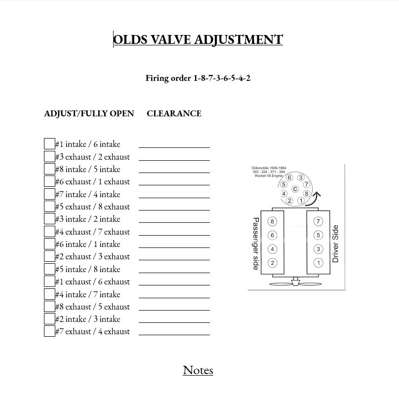

    I put together this sheet from info here. The valve sequence should be right but I'll verify in a couple weeks. Thought it might be handy for anyone with adjustable rockers or pushrods.

    I know this is ancient history but has anyone learned anymore about that front cover?
    I always thought it was just a water pump delete used for drag racing, never occurred to me that it could drive a mag.
    I've had one hanging on my wall forever.
  22. wrenchbender
    Joined: Sep 5, 2007
    Posts: 2,492
    wrenchbender
    That cover should be for a fuel pump dive or water pump could be both especially in a marine application the distributor in those engines were in the back similar to a Chevy if you have one of those covers I would be interested in it as my 394 needs one for the fuel pump drive for two port hilborn I’m running on it
    gonzo likes this.
