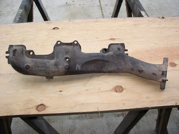

    Hey guys i bought a 62 four door Olds 88 this winter and i am just now getting a chance to work on it. The car has the 394 in it and I want to put dual exhaust on the car, but the exhaust shop is telling me that with the drivers side exhaust manifold thats on the car its not possible. So my question is to you guys is there an exhaust manifold i could put on the car that will go around the steering and allow me to put on twice pipes (i was thinking maybe something off of a two door, or aftermarket even). I'm sorry if this doesn't fit into this thread but i figured if anyone knew about olds motors they would be on this thread. Thanks in advance.
  26. Paul
    Joined: Aug 29, 2002
    Posts: 16,833
    Paul
    Editor
    yes, the factory did make one that dumped at the rear.
    not common but they are out there.
    I sold one not too long ago,
    here is a home made version someone made by removing the stock dump, welding some plate over the hole and welding a new dump on at the rear

  28. NotNuRodz
    Joined: May 18, 2008
    Posts: 282
    NotNuRodz
    Thanks paul i heard rumors that it would be hard to come by (and a little costly). I think im gonna get a second manifold and try that home made one.
