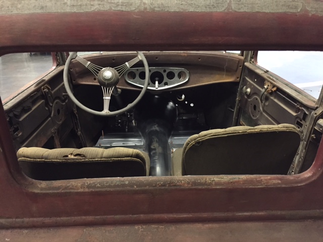

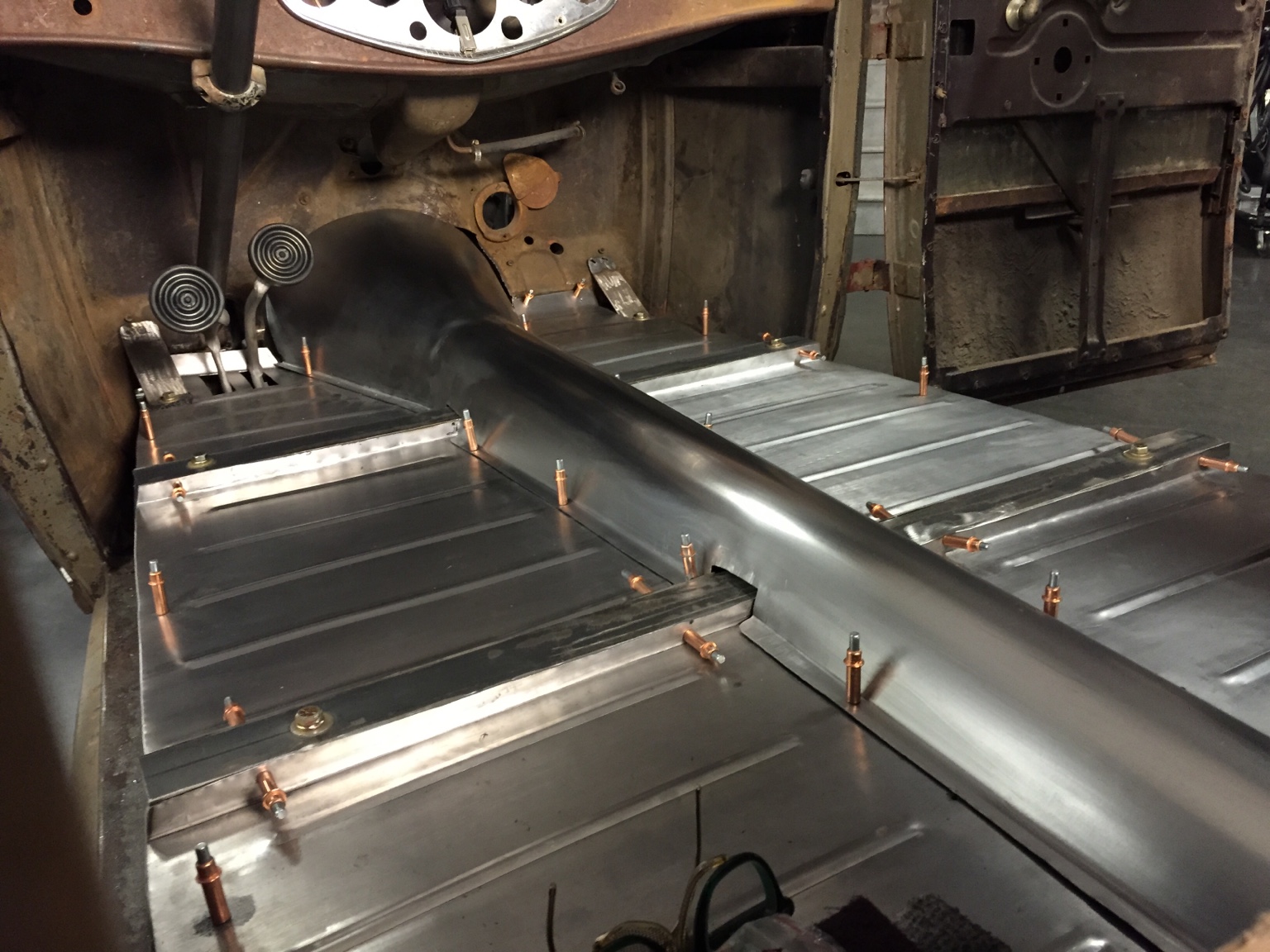

  1. Did you shorten the torque tube? As I'm looking at this picture it looks like the torque tube is way too short...
    The end of the torque tube should be inside the 2 piece clam shell thingy that bolts on the transmission.
    Or maybe I am just seeing things.

    Good eye. I got the torque tube from a buddy who had it shortened and it was made too short. He donated it to me for mockup. I have it mounted that way right now just to find the height of the torque tube as I'm building the floors and such. I plan to buy one of those nifty seal/flange kits the one guy sells for the rear of the torque tube to keep gear oil from draining down the torque tube and I'll make it the correct length then. Thanks for the heads up regardless. [emoji106]

    Cut flanged and further formed the tunnel. Gonna weld it all together this week and hopefully move on to the trunk sheet metal. Need to find a donor seat quick!

    Fit and welded the tunnel pieces together. Need to cut the shifter hole and make a heel insert/step for my foot on the go pedal. Moving on to the trunk sheet metal this week if all goes well.

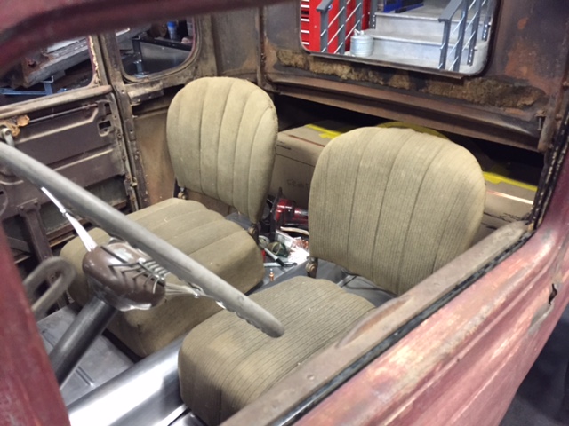

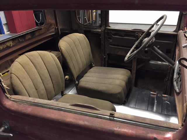

    Found a pair of seats that are perfect for the car at the Jalopy Showdown the other week. Supposedly from an early Chevy Suburban. They fit right down in between my cross braces and have just about the perfect height. Just need to build some tilt into the mounting brackets. Working on the trunk floor this week. Hoping to start welding floors in here soon!

    Huh. Those do look great, never would have thought about those. Neat.

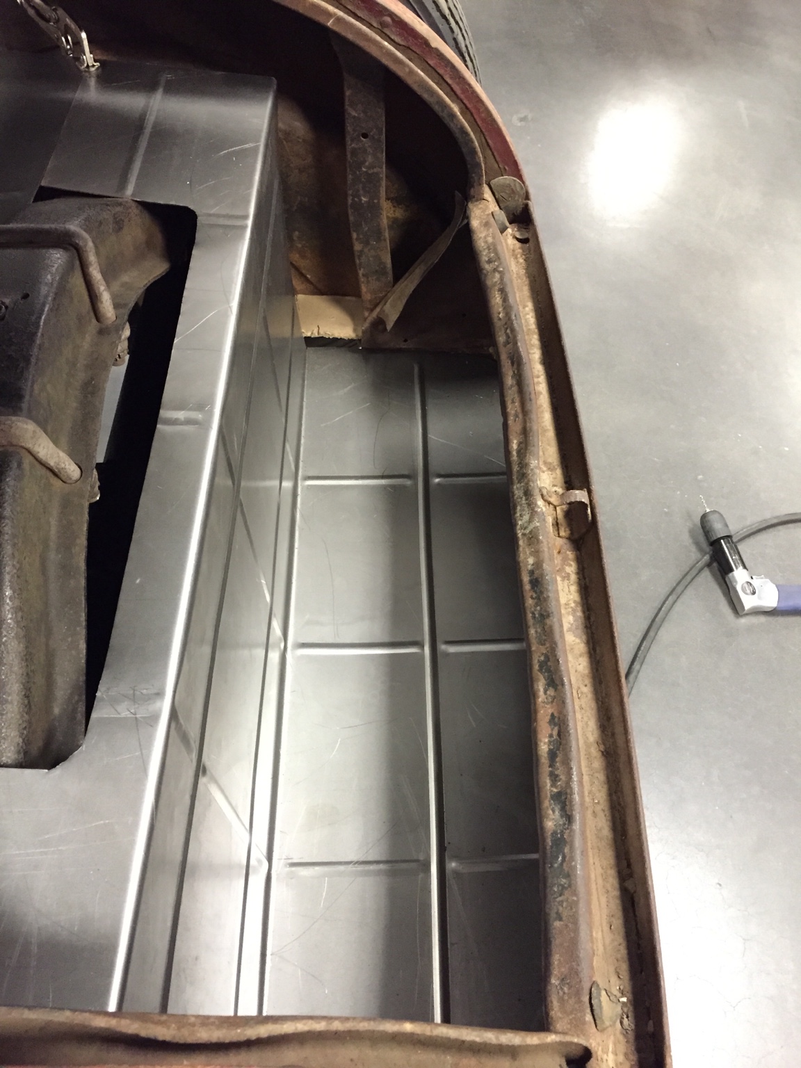

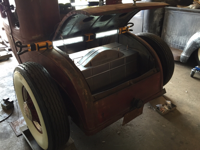

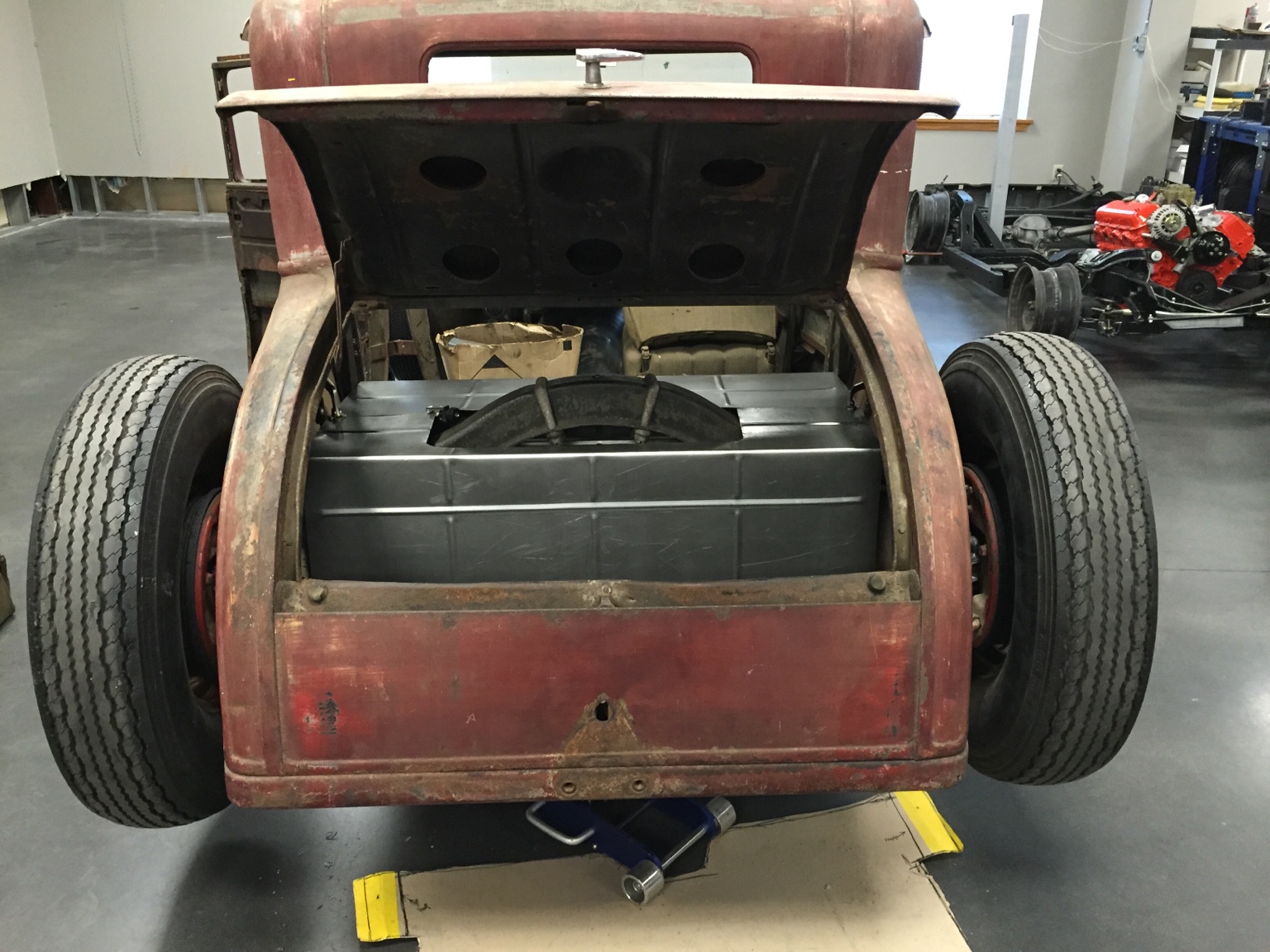

    Started on the trunk floor. Need to make the rear crossmember hump and weld it all together. Then on to fitting a gas tank and tying up some loose ends.

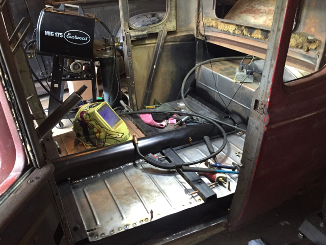

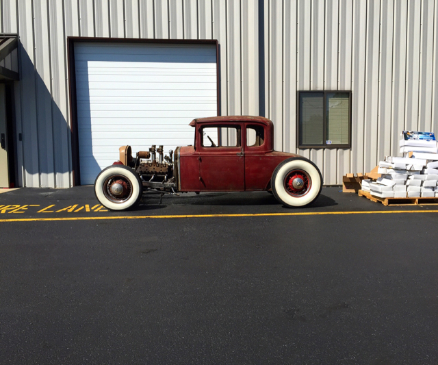

    Forgot to update here. Been busy with life but have been picking away at the car. We're doing some remodeling inside of the headquarters here so I decided to take the car home and work on it at my leisure. Got the first shot of it sitting outside from far away before I loaded it on the trailer. I'm digging the profile, just need to get some blackwalls on that sucker!

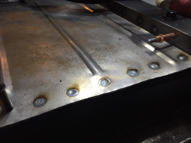

    I got the rear cross member hump made and the floors all welded into the car with a million rosette welds with the MIG 175 and finally all feeling solid again!
    Also broke down and bought a Bosch Laser Level after wasting an afternoon chopping and chasing the positioning of my headlight stands. Took all of 10 minutes to get them sitting right after the level up!
    Working on building a gas tank to tuck into the back trunk recess right now. I'll snap some pics as I work on that this week.

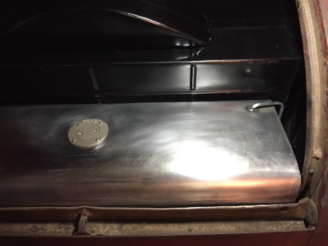

    Been picking away at this. Gas tank is 90% done other than leak testing. Added a little breather that exits out the bottom of the floor. Fun project making this tank as large as possible but sit down into the trunk and out of the way as possible with the big step in the rear.

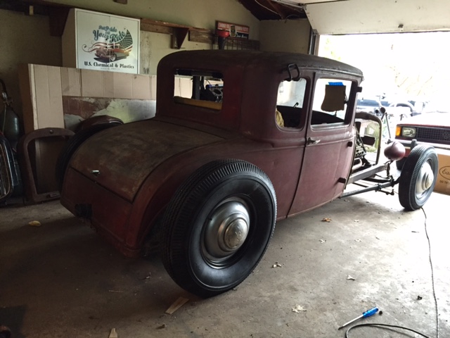

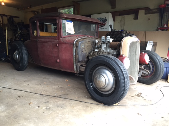

    Been slow going on this lately. But I managed to get my spare set of '35 wires powdercoated and installed a set of Lyons style spun caps I got off of a guy on Instagram that's repopping them. GREAT quality and they look the part. I threw the blackwalls on with the smaller 5.50 front tires it sits just right in the front. I'm still trying to decide what color to do the wheel covers, kind of like them in a raw-like gray.

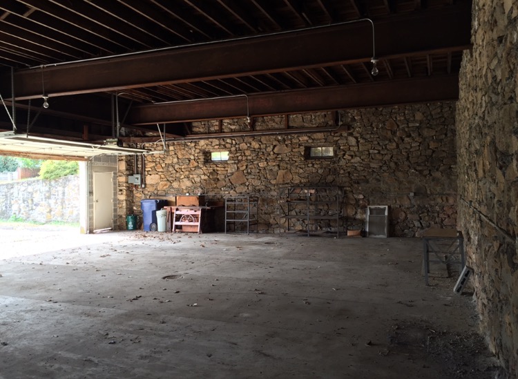

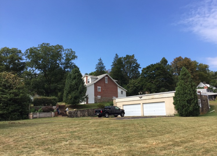

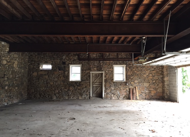

    Buying a house with a huge shop and preparing to move my life here shortly. The new garage is roughly 2,000sqFt and is PERFECT for spreading out and getting more organized. Once I get done rushing around getting the house and shop ready before winter hits I'll be back on the coupe. Hoping I can button up the last few things before I blow it all apart for final welding and paint on the chassis and floors. More to come!

    Looks good man, new shop is really cool congrats.

  24. pumpman
    Joined: Dec 6, 2010
    Posts: 2,674
    pumpman
    Damn, that garage is freaking great, love the field stone walls. Looks it could take a hit from a bomb and not even shake. More room for more stuff.

  26. Old-Soul
    Joined: Jun 16, 2007
    Posts: 3,789
    Old-Soul
    Now that is a wild shop, very cool.
    If you haven't yet, maybe do a thread over on the Garage Journal about your newly acquired home/shop. Love the stones.
