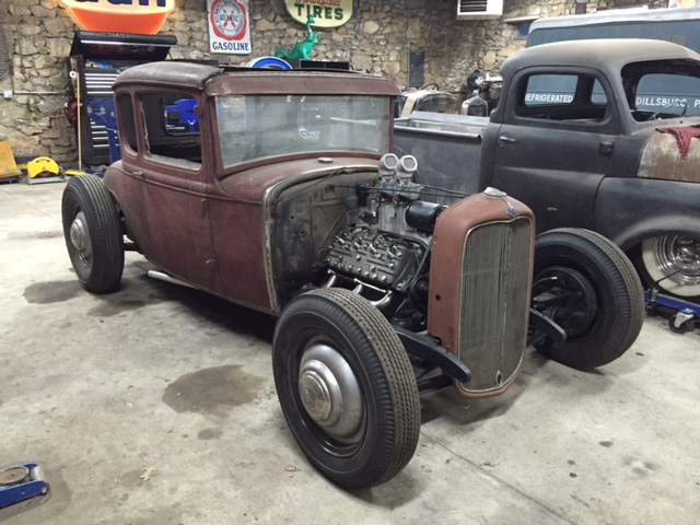

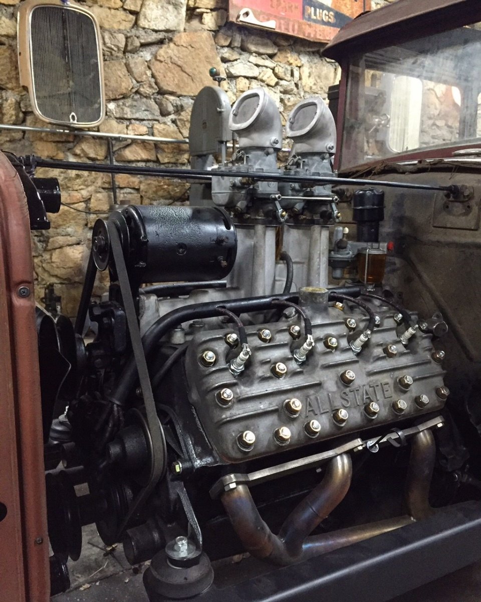

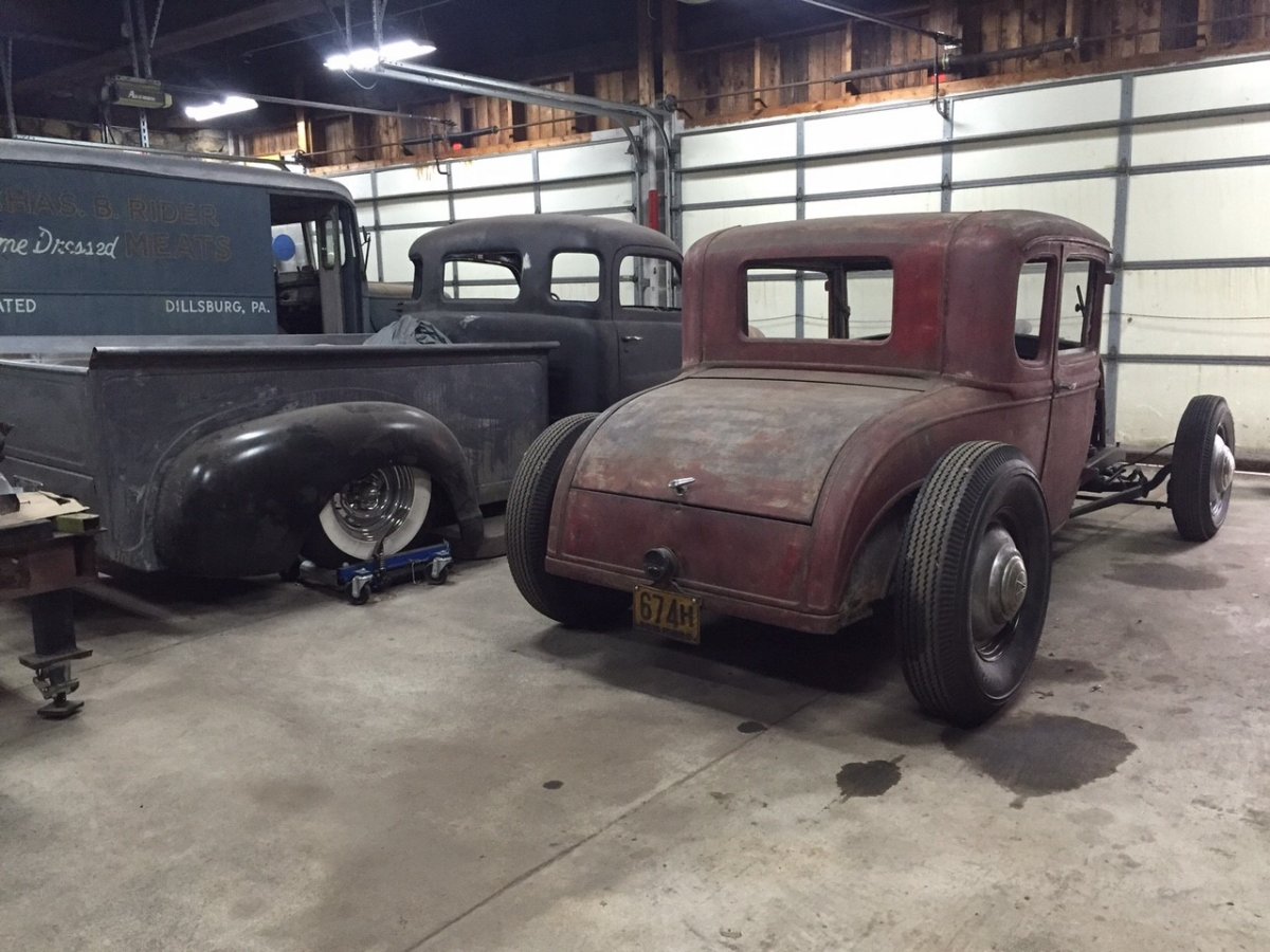

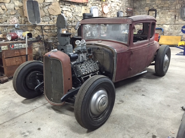

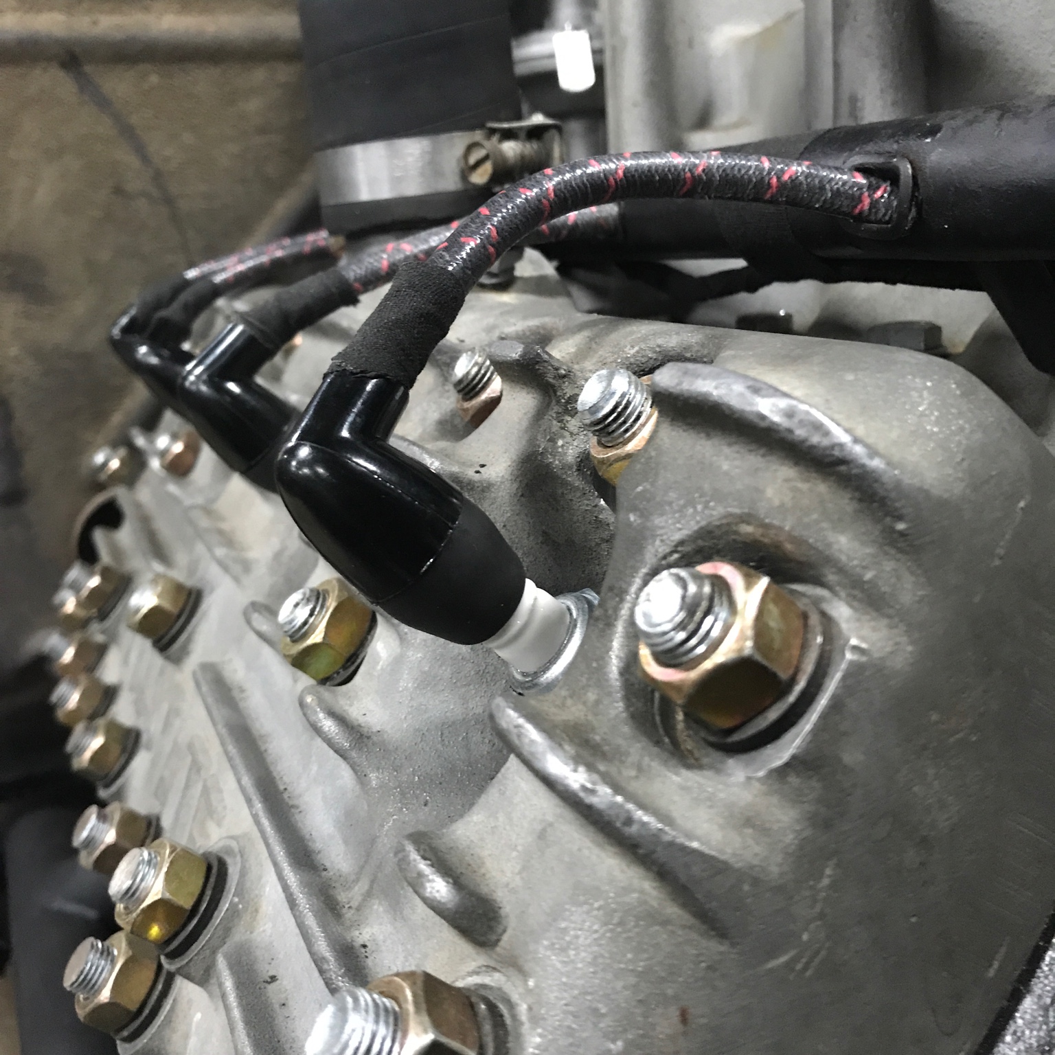

    Been burning the midnight oil. Making progress. Got the plug wires all finished on the engine and some other odds and ends done. Also got all of the pedals in place and the return springs hooked up. Man was that a relief it all fit and worked with everything 100% in place with how much shortening, heating and bending, etc. I also filled the steering box with some fancy grease/oil a friend had luck with in his '32. Need to blast the headers and build the exhaust before I can hook the steering up for the last time.
    Hoping through the end of this week I can get the fuel tank back in and the fuel line run to the front of the car. If the wiring shows up in time I'll also start laying all of that out. Exciting to think this thing might make noise here soon!
    Couple shots from the past few nights because everyone loves pics.

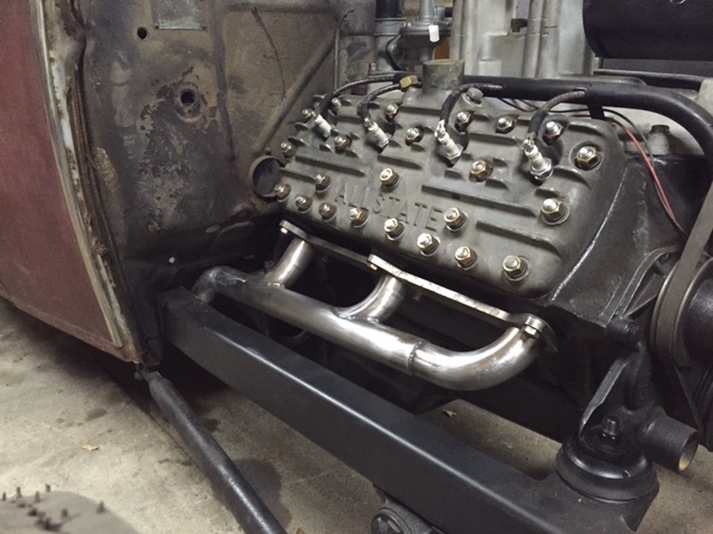

    Been a busy week/weekend trying to get stuff done on the car. Lots of small little things done. Biggest thing was I had a friend bend up the pipes to go down around the center cross-member/pedals. I adjusted them to fit the headers and welded them up and blended my weld seams so it looks like it all flows as one. Need to make the frame mounts for the tailpipes and I can paint them up black to make them disappear and install for the last time.
    Got my wiring and a buddy is coming over tonight to help me lay out the harness and all that jazz. Also ran my hard line for the fuel yesterday and just need to install a barb fitting adapter into the fuel pump so I can hook up the flex line from the hard line.
    Also having a little shop party this Saturday with Gene being in town and I need to get the shop cleaned up too, not much sleep in my future!

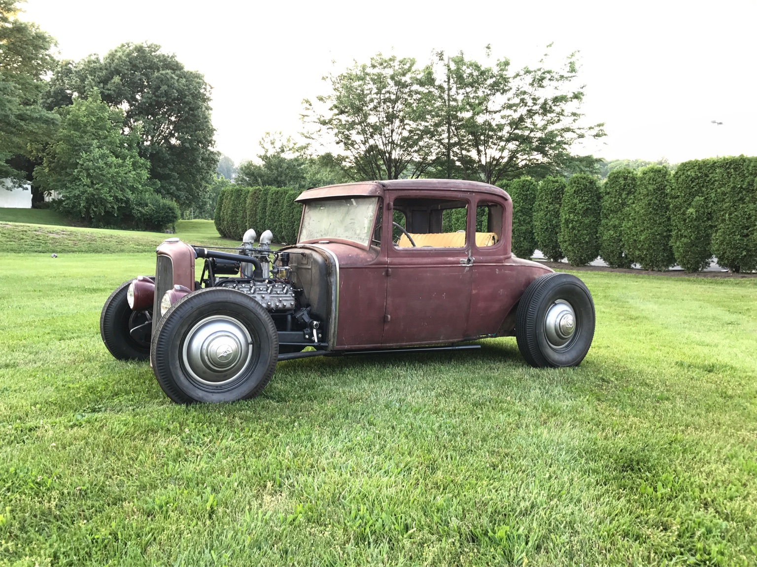

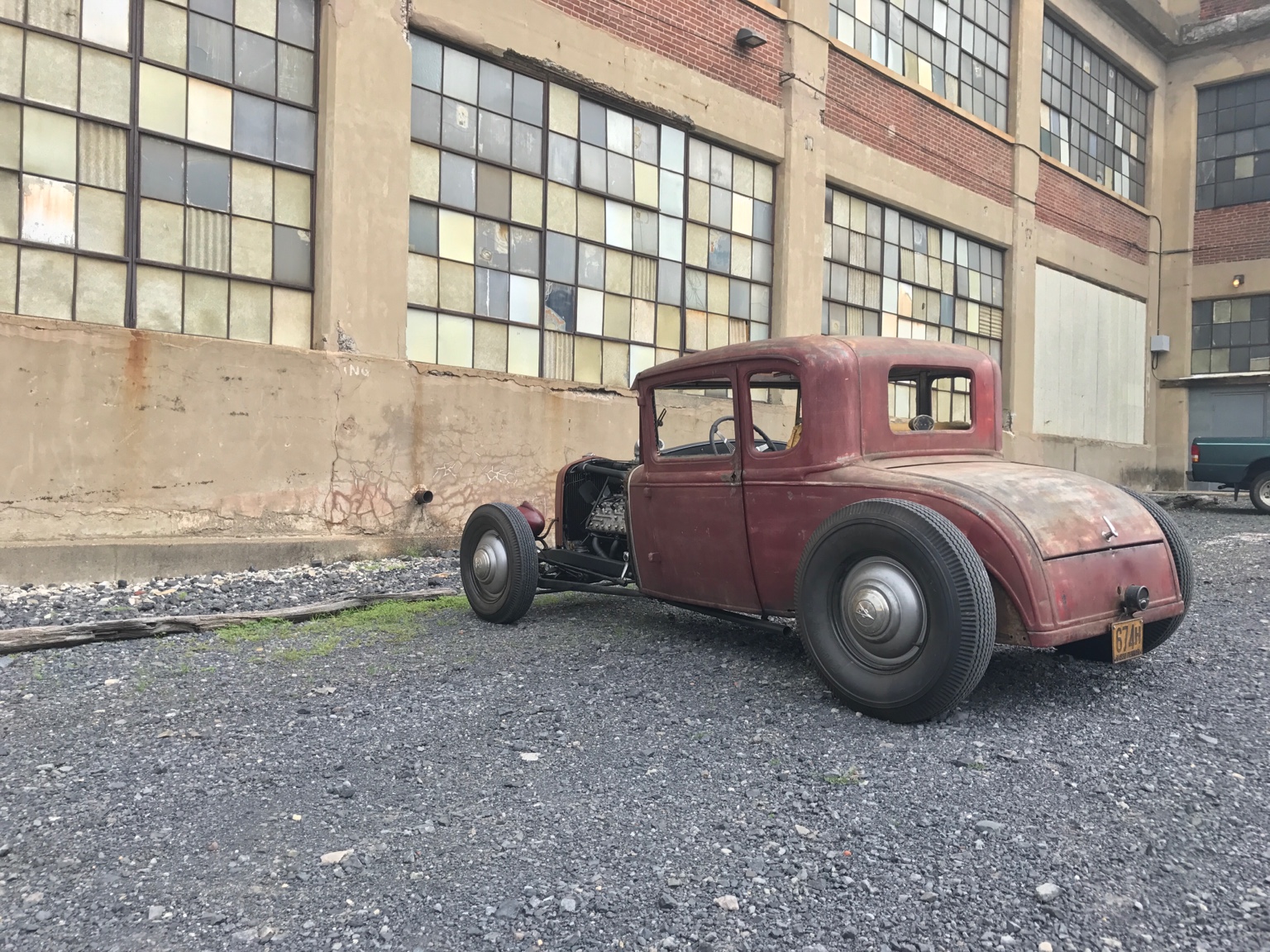

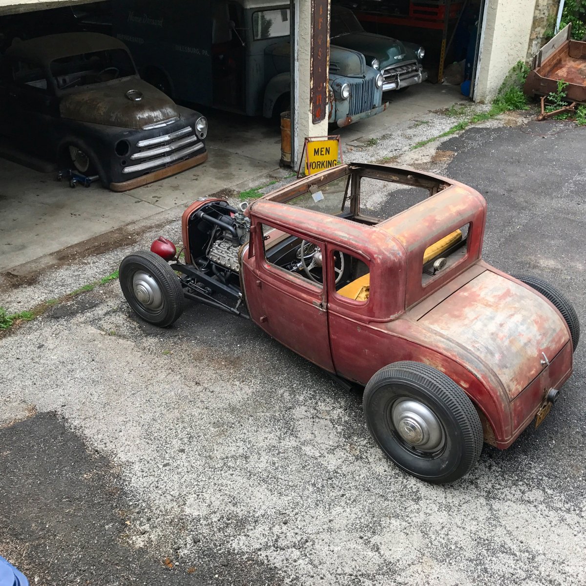

    Slowly making progress on this thing. Been messing with the pedals a bunch as now that it's sorta drivable they need to be tweaked and adjusted to get them working better. Probably the most difficult part of this car has been using floor mount f-1 pedal stuff and channeling it so hard. I think I have it all figured out and need to do a little more heating and welding and they should be good to go.
    Also cobbled together a choke setup for the car. Took an old aftermarket cable choke setup with a neat knob and scavenged the knob and mounting sleeve. I then welded up an extension and Z'ed a spare choke rod from a 46 Ford truck. Tapped the knob and opened up the sleeve and I have a pretty neat looking setup. These stupid small details make me so happy haha.
    Hoping by the end of the month it'll be at a point I can take it out for a real drive. For now it's just joy rides around the block to find all of the glaring issues.
    Couple photos below of it after my drive around the block yesterday.

    Been driving the car around a bit and trying to shake out the issues. Been fighting a misfire issue that has seem to gotten worse. I think I was the stupid clip on plug wire ends I was trying to run. Got a set of NOS sealtight connectors and threw them on last night. Hoping that fixes my issues I've been fighting.

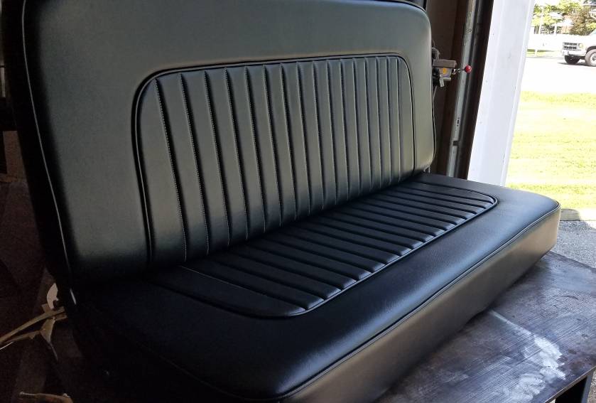

    Jerry @HomemadeHardtop57 is a local buddy and he has been learning upholstery and offered to redo my crappy S10 seat I narrowed for this car. I wanted something simple and not too flashy and he knocked it out of the park! Here's a few photos of it when he finished. I'll add a few more once it's installed here soon. I'm going to try and roll out a roof insert on my wheel next week and then have Jerry cover the insert to match the seat.
