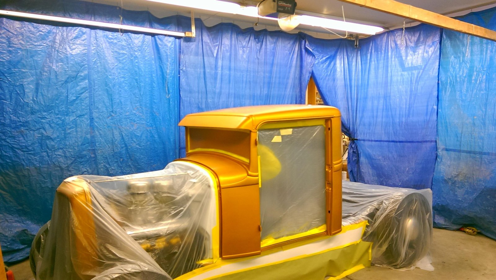

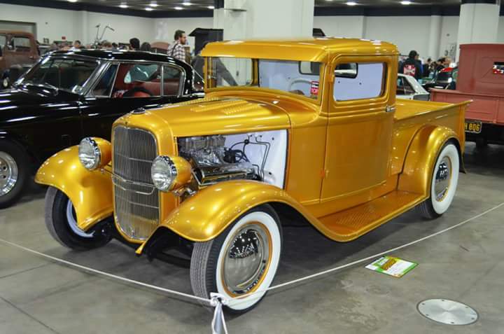

  1. My buddy and I painted the Caddyhauler in our garages using a turbine sprayer. It turned out good enough to win Best Of Show at the Detroit Autorama Extreme and a Street Rodder Magazine Top 100. Look for it in the 2nd issue of Hop Up out in a few months too.

    Love it. What's the color , type of paint and manufacturer?

    That is NICE, congratulations and great job! :cool:

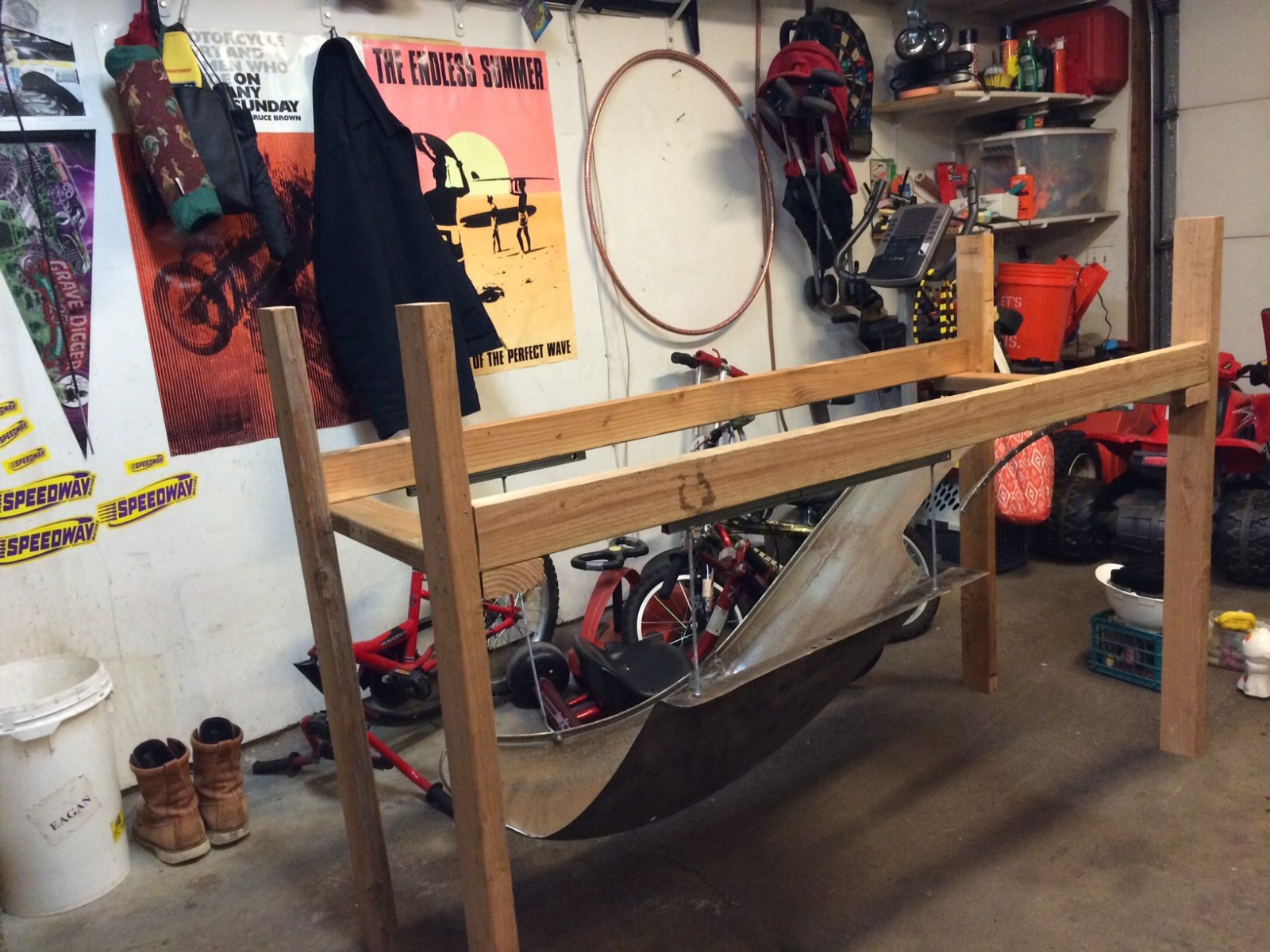

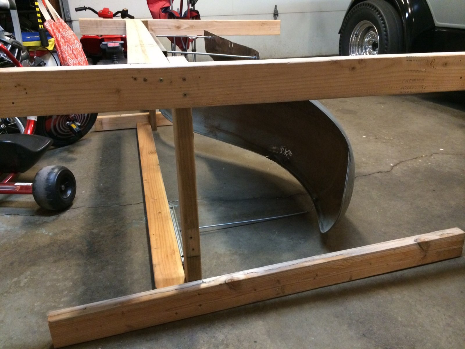

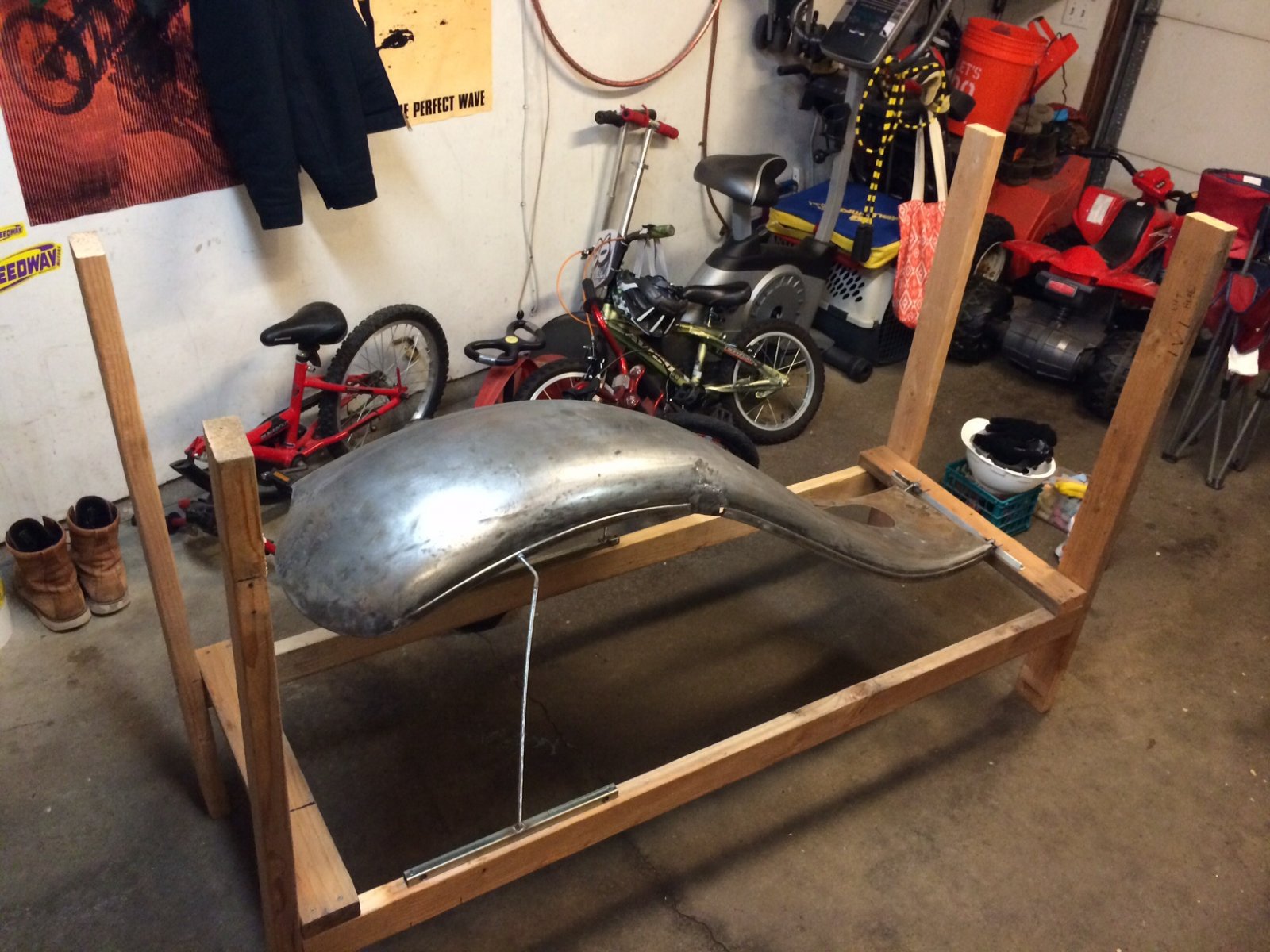

    I got tired of monkey f#%cking my "A" fenders, so I made this contraption. You can flip them over, and they won't touch the floor.;) Welding to bodywork to paint to install without touching them.

  6. chevy57dude
    Joined: Dec 10, 2007
    Posts: 9,557
    chevy57dude
    Plumbid - That is simplistic genius right there. An idea I'm gonna put to use right away!

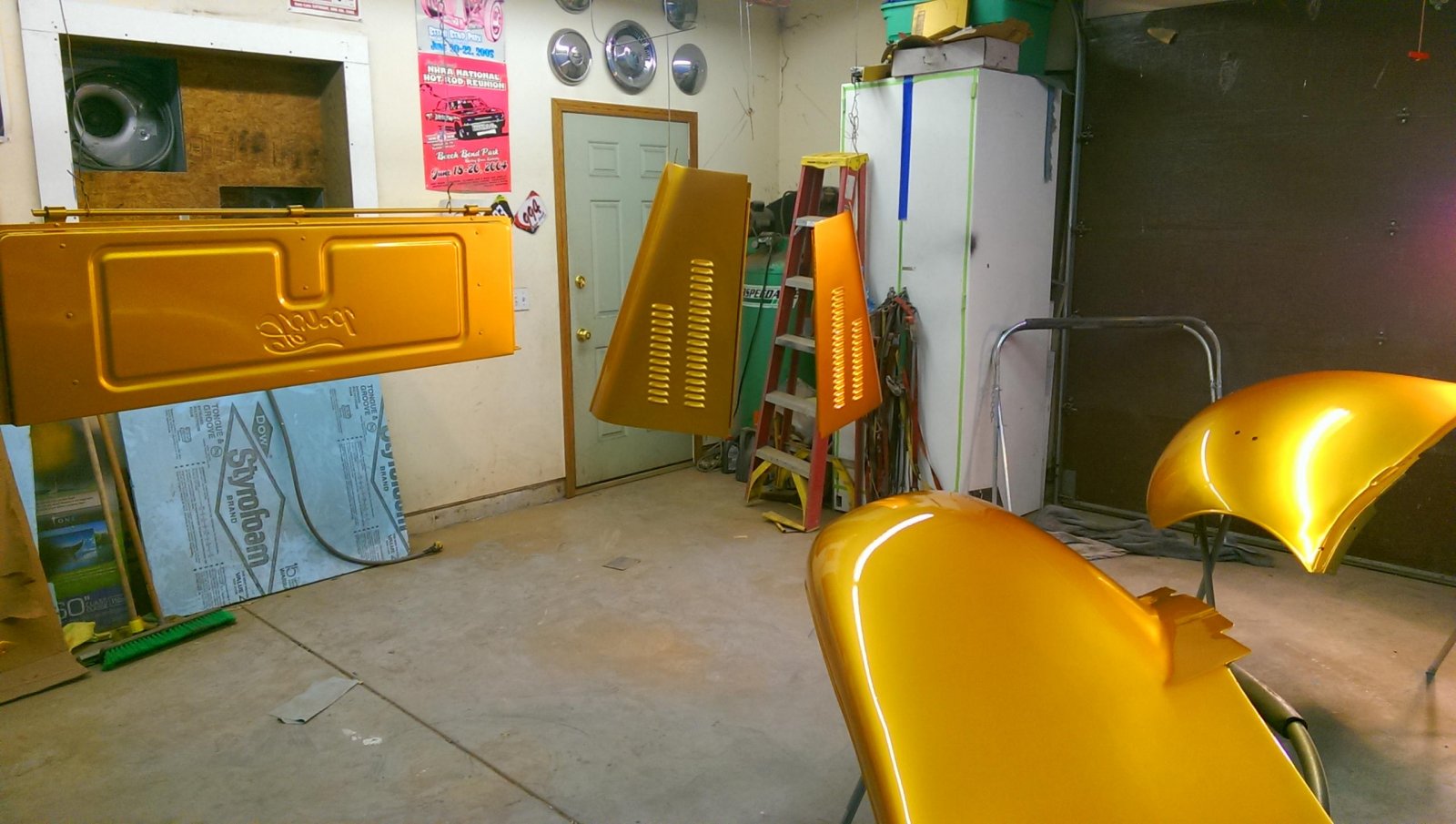

    I am painting the panels on this toolbox in my garage. White base, abalone metalflake, tons of clear. Using turbine HVLP

    plumbid: I just used a couple of engine stands for my rear fenders...................

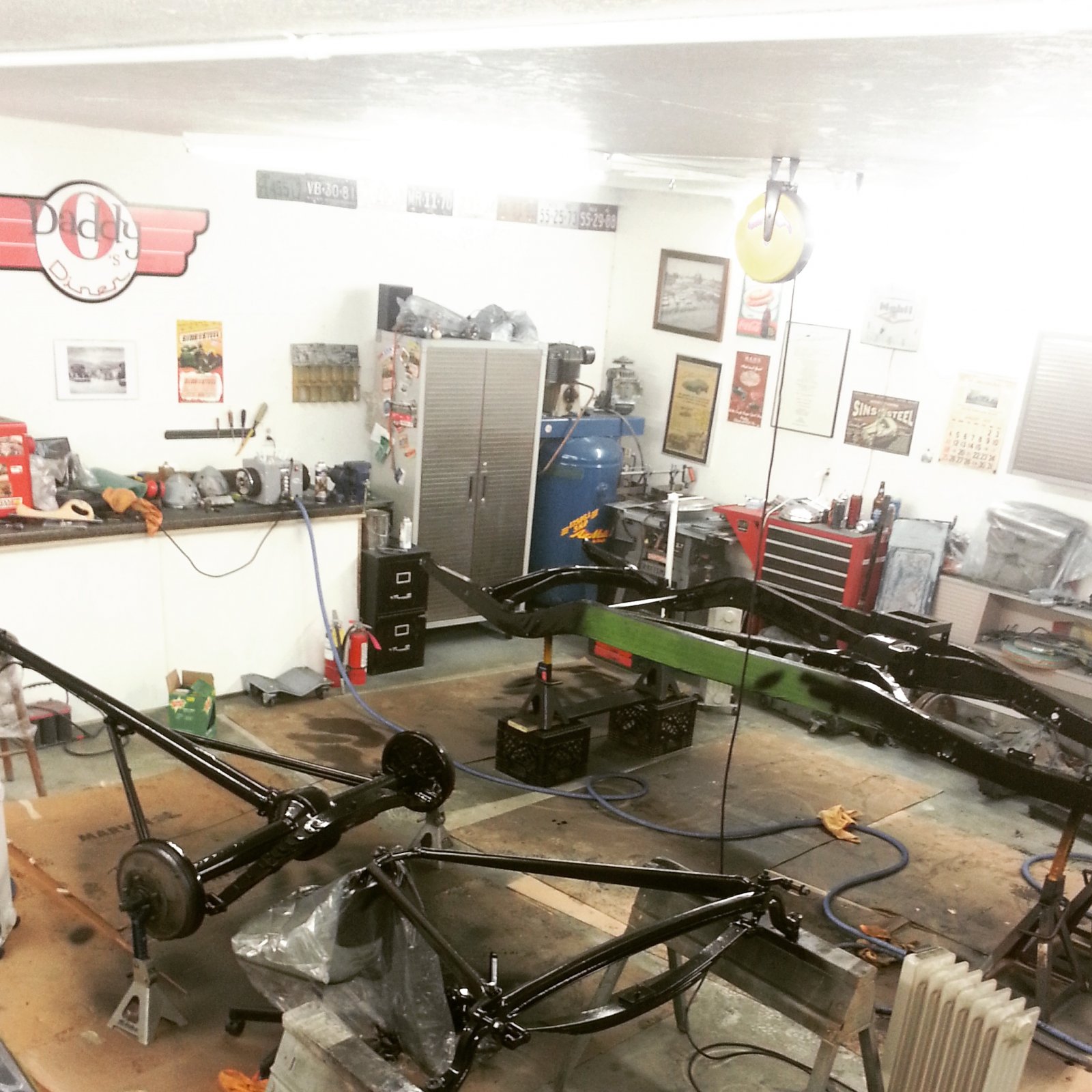

    I'm actually painting in the garage, but what I'm painting is the inside of the garage. :rolleyes:
    Nice and white too, painted with Olympic Ultra-White, over white Kilz primer, over white Sheet-Rock brand plaster. Yup. It's gonna be white. Bright too, so the place is lighted well enough to paint in since I installed (8) 120 watt ( 960 watts total) new down-lights to help my dimming eyeballs. They're 6" dia LEDs can-lights, recessed into the new white ceiling (did I mention it was white?) and them suckers are bright when you turn them all at once.
    Anyhow, I'm mentioning all this because a bright, well-lit area, is the first step to a high-quality paint job. And clean! 17 sheets of drywall now cover my dingy, dark, filthy, spider infested rafters. They're plastered up nice & now (almost all) painted!
    I've started filling & painting the walls too. Man, the place is getting clean! And it's gonna stay clean too, as I also have a side yard to do all the filthy scraping, sanding, welding, de-greasing, and such. The garage will be reserved for assembly work and final finishing.
    I never would have done all that work on the old garage, except I'd decided to restore Edith (the P15 Plymouth.) Hopefully I'll feel it was all worth it when she's all done too.

    The above is a great point. Visit any pro paint booth, note all the lighting. Also important during the prep stage.

    Painting with too little light makes it paint by feel and that is a recipe for disaster. Being able to see the coverage as you paint is a must. You can use portable lighting if you don't have enough. in your garage.

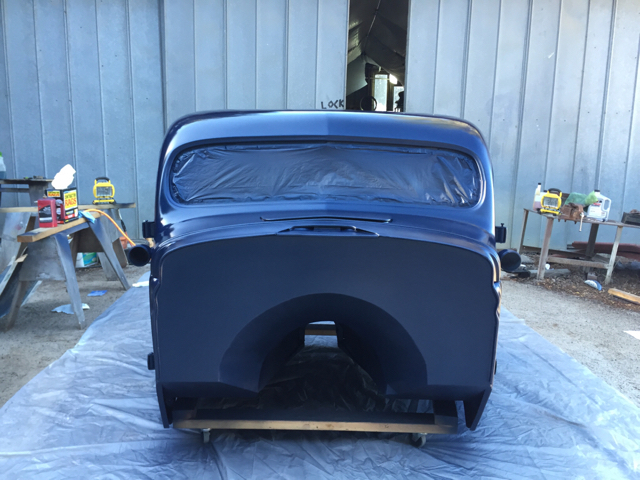

    I just laid ImageUploadedByH.A.M.B.1432995638.766660.jpg a sheet of plastic out in the dirt and shot it first thing in the morning before the bugs came out. I'm using one of those 3m disposable charcoal respirators. Tried building a temp booth inside the barn but found that the lighting just wasn't good enough for a novice like me. BTW- this was my third attempt to spray this cab!

    For a novice, it looks pretty good from what I can see here! ;)

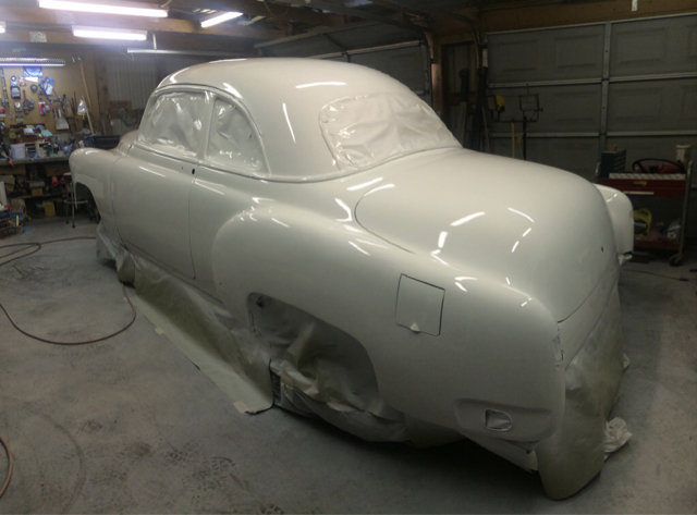

    ImageUploadedByH.A.M.B.1433049010.833165.jpg ImageUploadedByH.A.M.B.1433049087.784945.jpg
    Have done quite a bit of garage paint/primer work. I use PPG envirobase waterborne base and PPG global 8152 clear. Spraying with SATA 3000 for base and SATA 4000 for clear.

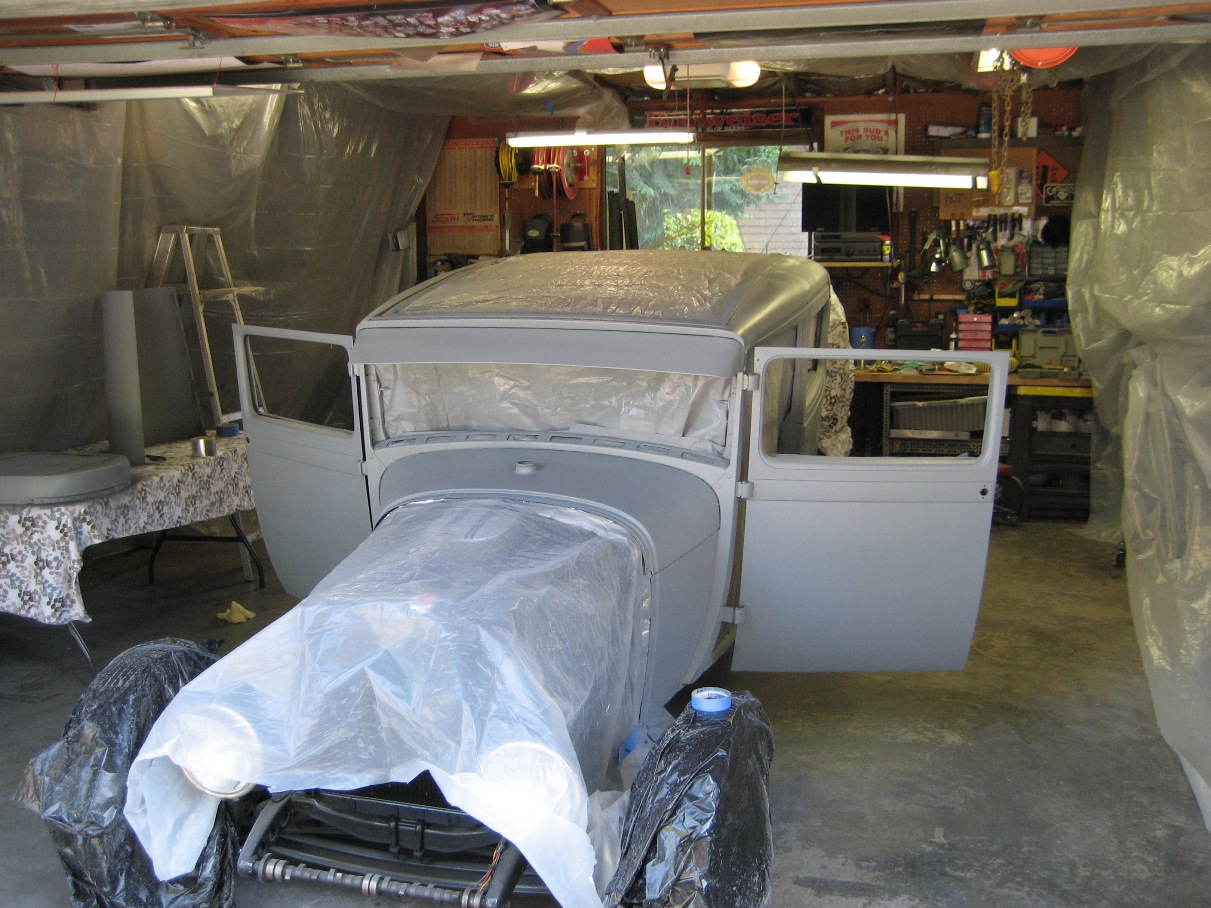

    Looks like what I'll be doing, something similar :D
