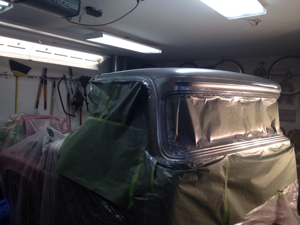

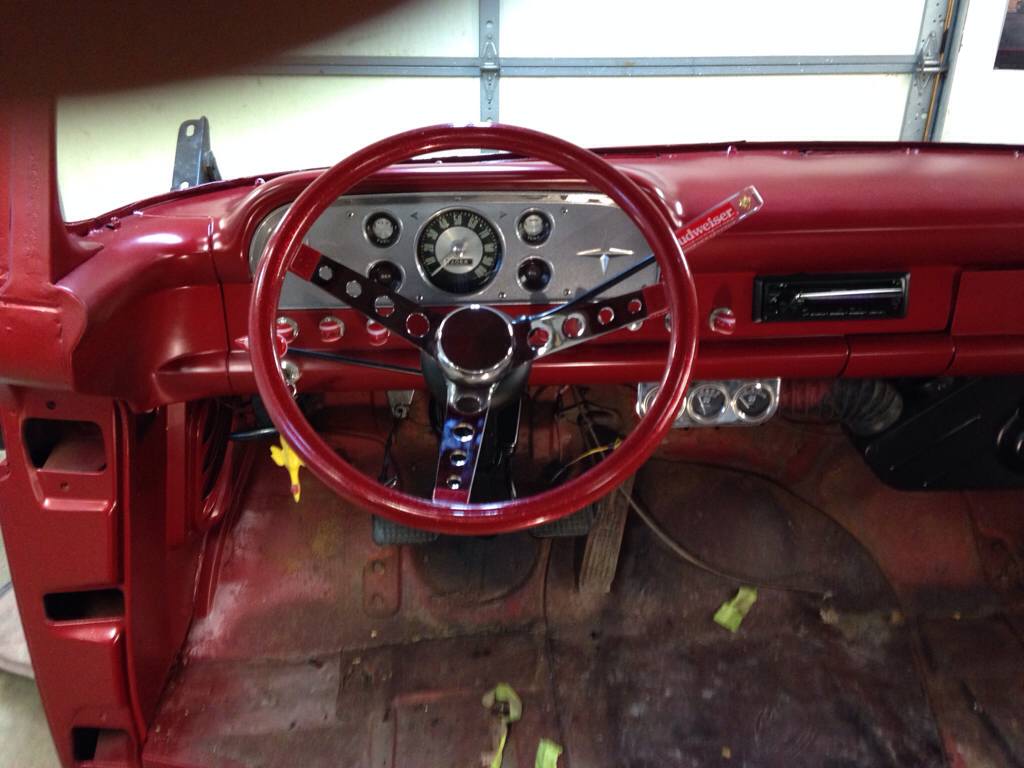

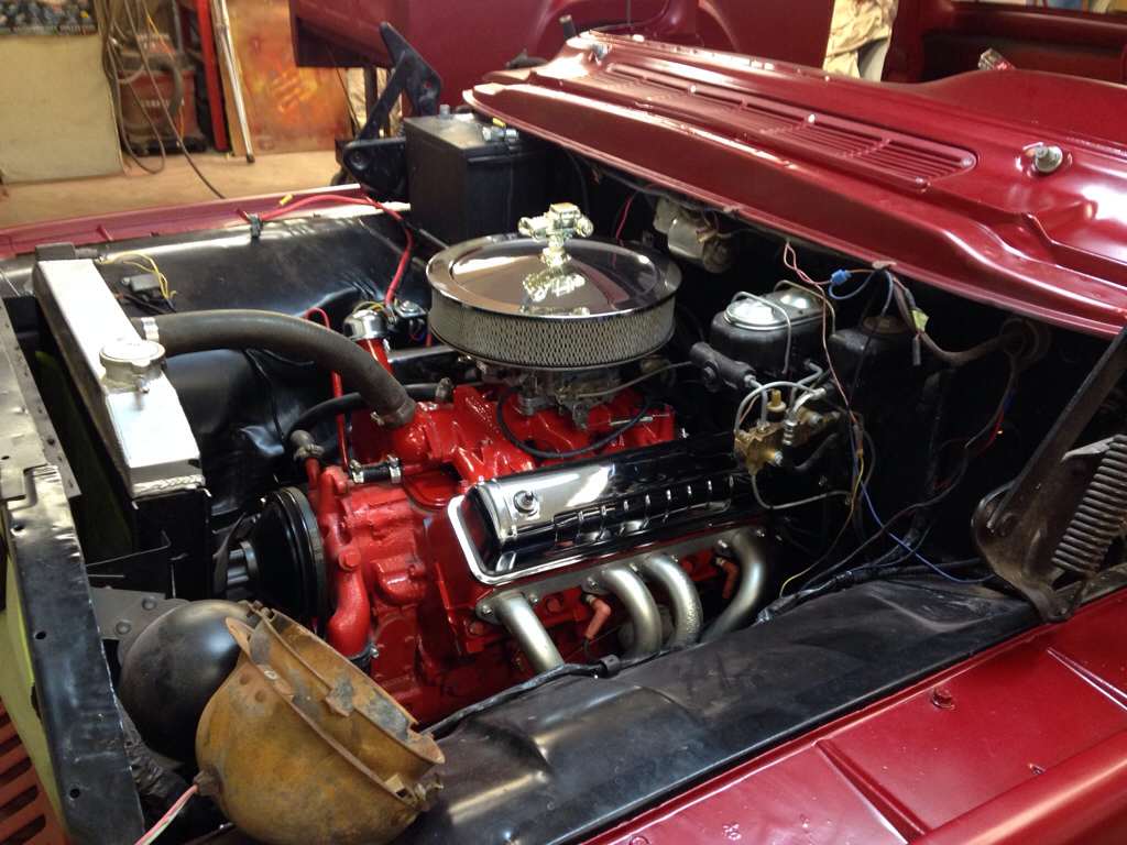

    ImageUploadedByTJJ1433121243.902376.jpg ImageUploadedByTJJ1433121280.878549.jpg . Shooting the two tone tomorrow with TP tools turbine

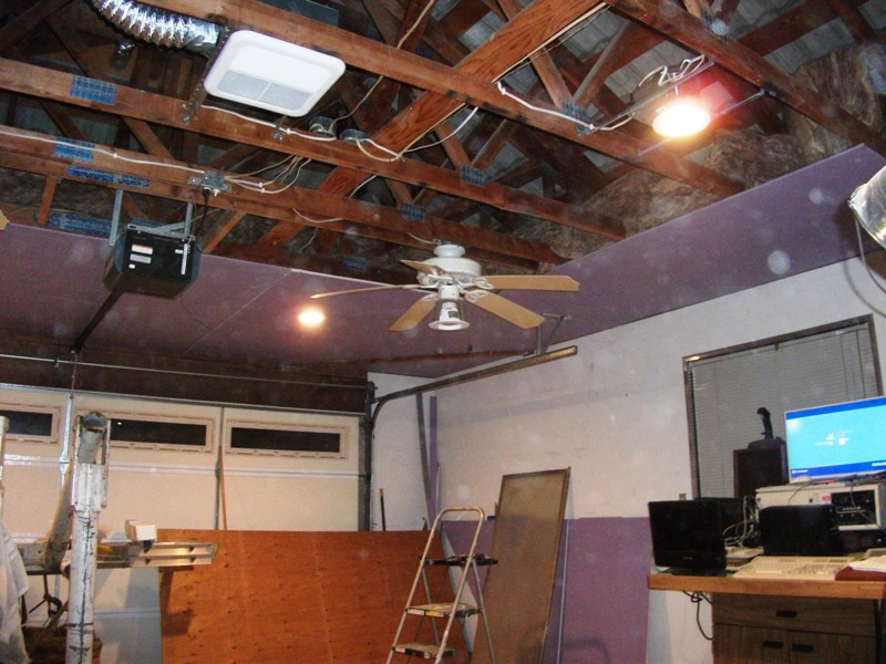

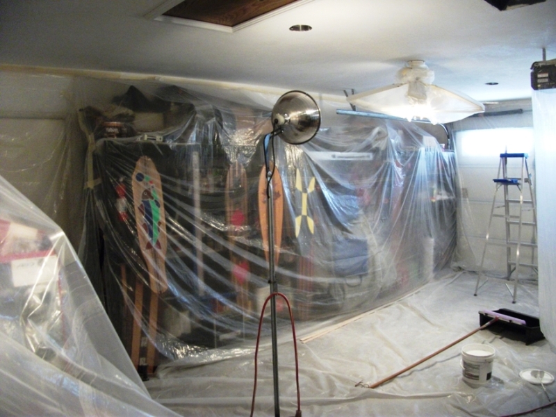

    The weather here has been exceptionally nice, and I've finally managed to get my ceiling finished and get the garage cleaned up a bit.
    BEFORE:
    Nasty old rafters full of dust & dead spiders.
    AFTER:
    Wow! It's clean for the first time since the house was built in 1990. ;)
    BTW, I've learned that I prefer fixing cars about 10x to drywall & plaster. I also discovered that the limiting factor in house painting is not the size of your roller, but the energy of the man pushing it. You can push the 9" roller around twice as fast as an 18". LOL
    <EDIT> Obligatory hanging plastic photo:

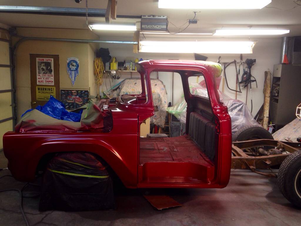

    Painted the white today, redo the roof tomorrow. ImageUploadedByTJJ1433204892.116840.jpg

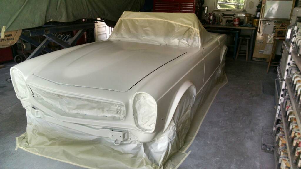

    orangeamcs
    In base

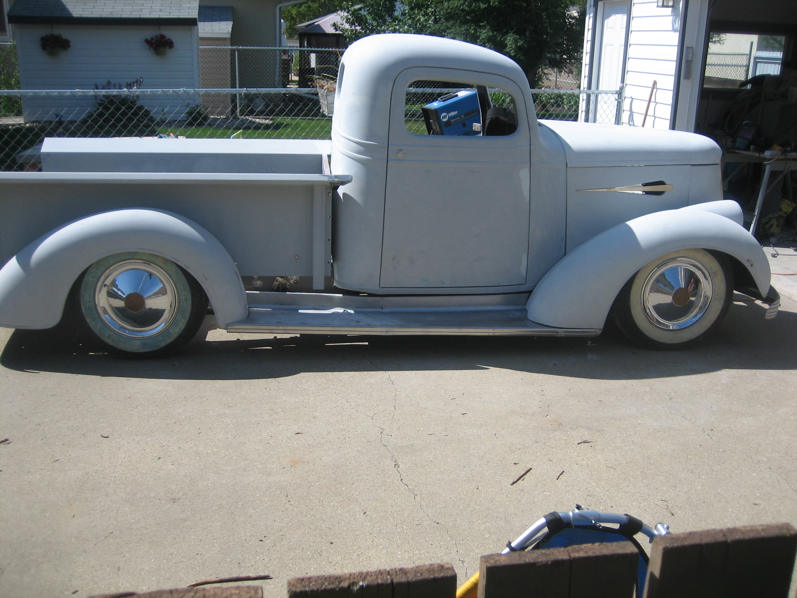

  20. Chucky
    Joined: Mar 15, 2009
    Posts: 1,862
    Chucky

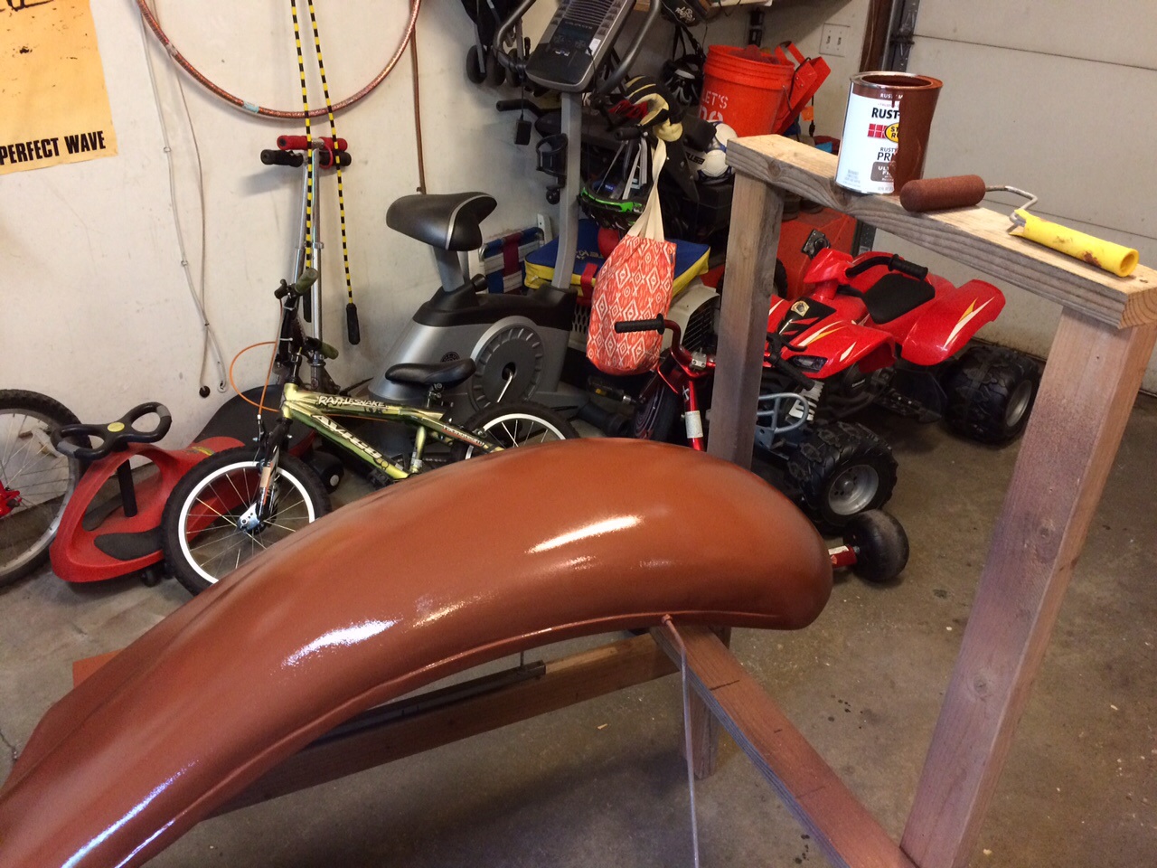

    Here's one to make the professionals squirm:eek::p...
    In my 'home-brew' method of refinishing painted surfaces, I occasionally encounter inclement weather (rain). Not being able to go outside, and not wanting to mask off the important things in the garage, I resort to the "little foam roller". Did I just pour the paint right onto the fender???:cool: You might be surprised at the results.

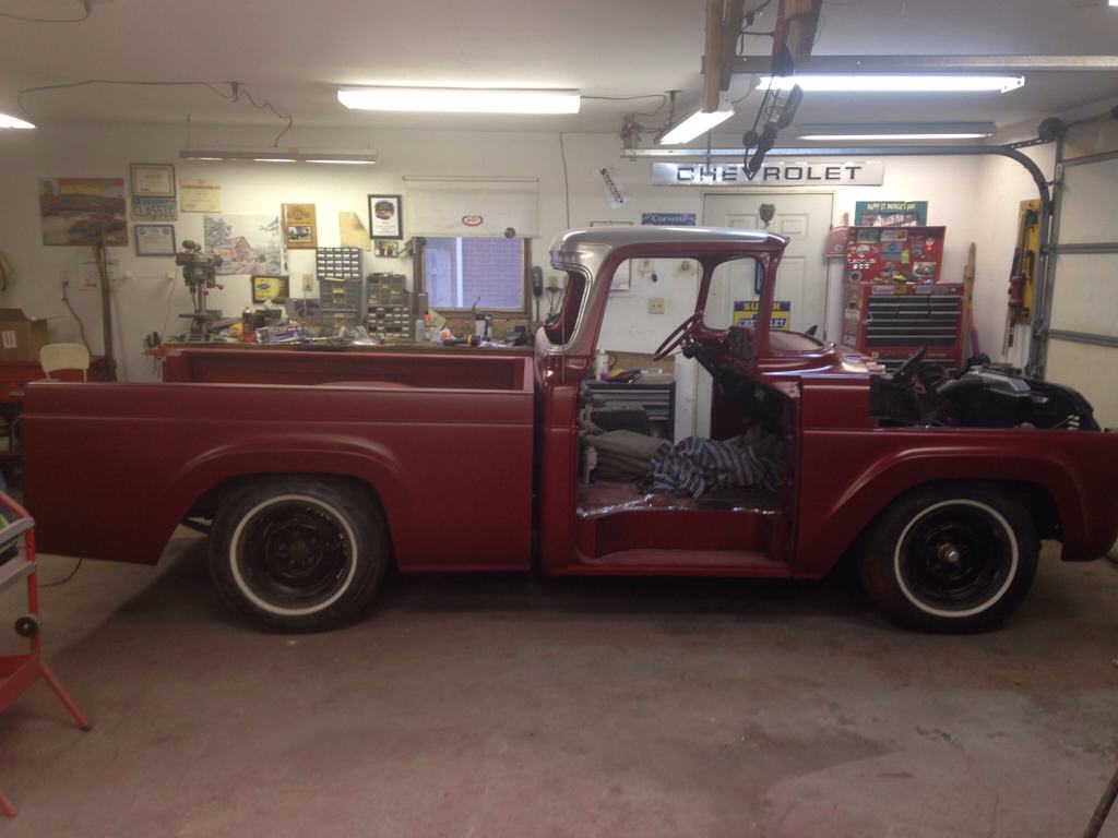

    My son was 17 when he painted this Aussie Falcon ute in the garage at home.
