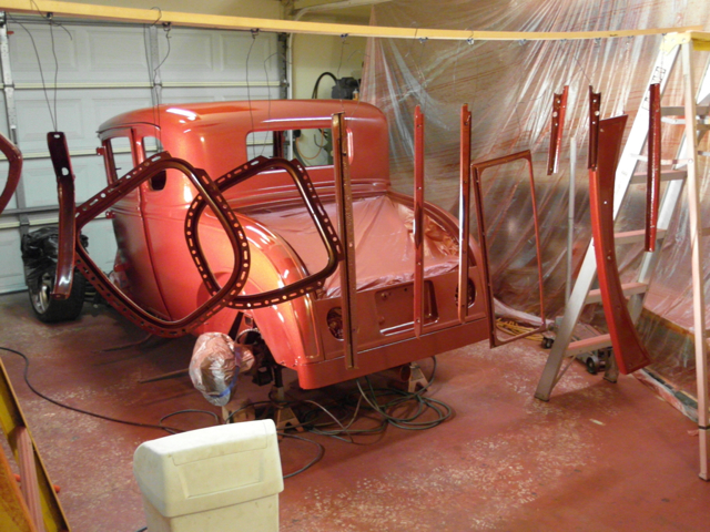

    I have a build going on right now that goes with this thread. Click below to see. 100% done in one side of the garage. If anyone has questions feel free to ask. I use a couple of buckets of water 20-30 min. to wet the floor before painting. The best way to have are flow is to create an exhaust fan by simply running fans in front of the garage opening pulling away the fumes, this will allow for a dust free paint job. http://www.jalopyjournal.com/forum/threads/1937-ford-truck-hot-rod-roadster-build”.925593/

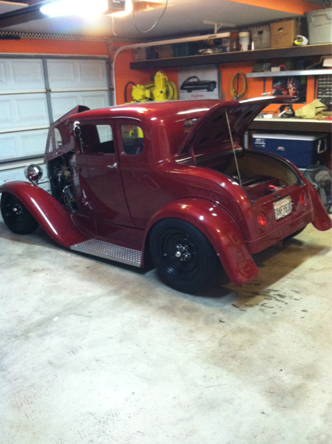

    ImageUploadedByH.A.M.B.1435245476.845946.jpg ImageUploadedByH.A.M.B.1435245537.207252.jpg ImageUploadedByH.A.M.B.1435245572.128478.jpg ImageUploadedByH.A.M.B.1435245638.843141.jpg
    I painted mine in the garage, two stage metallic. It came out good. Had to color sand it to smooth it out ( first car I've painted in 15 years lol ). The wife was really pissed about the floor though. I had to rent a floor sander to clean it, and it took all day to do. I will never paint another car in the garage after that! I think it's best to rent a booth if at all possible. Usually they supply the air compressor which is nice too. ImageUploadedByH.A.M.B.1435245885.211335.jpg
