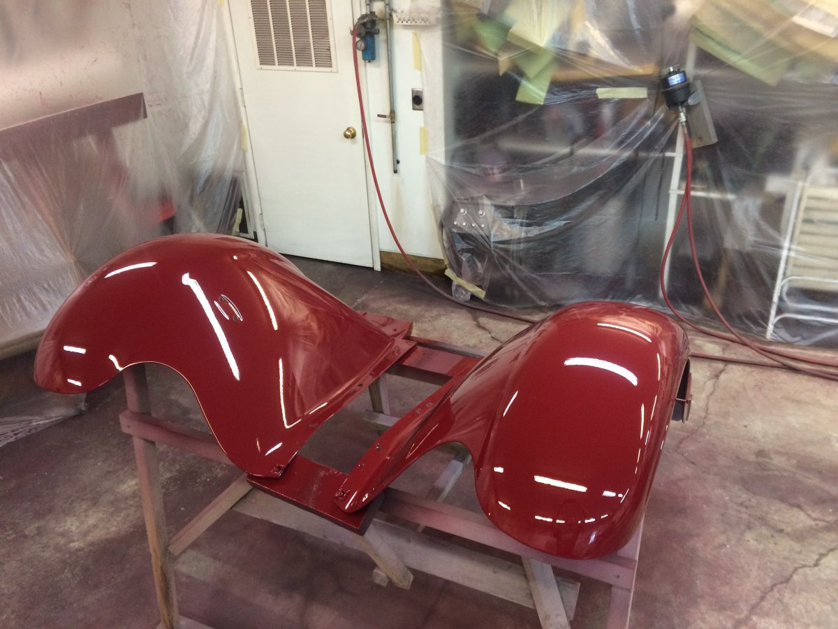

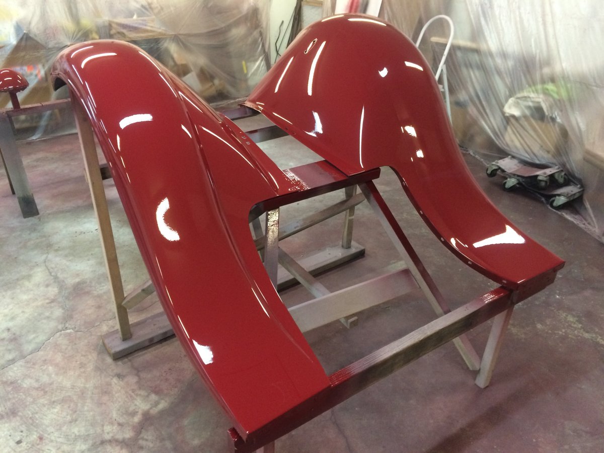

    Here is my 34

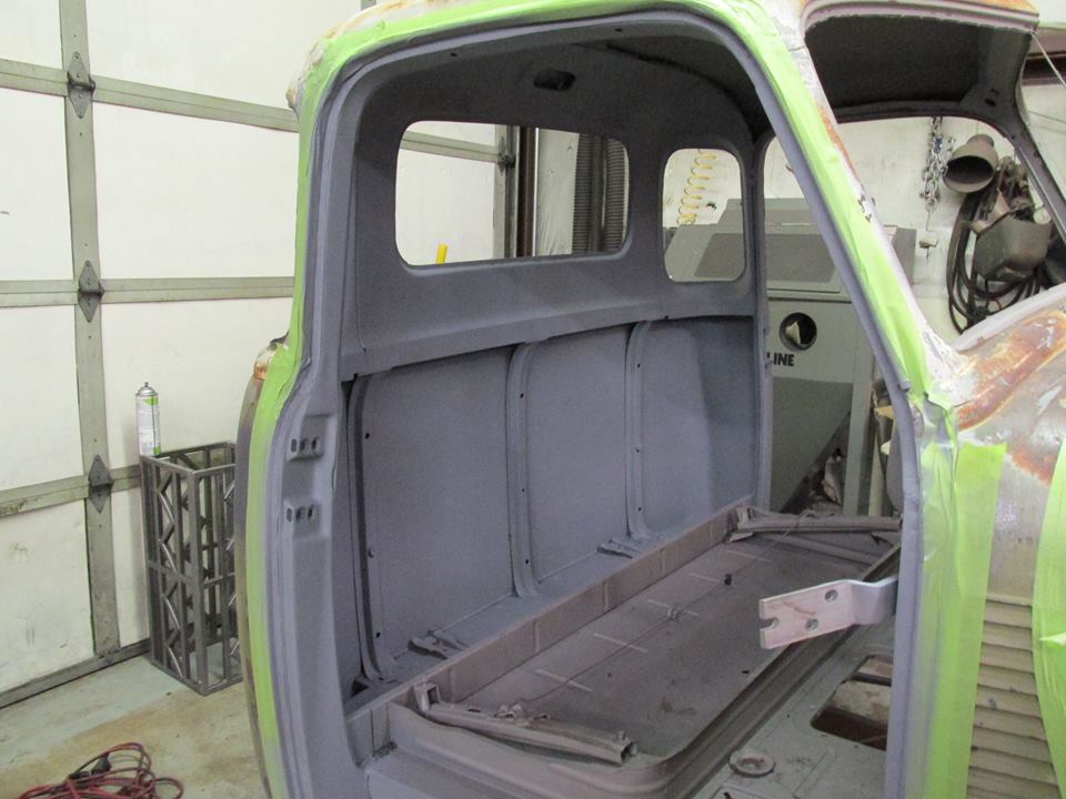

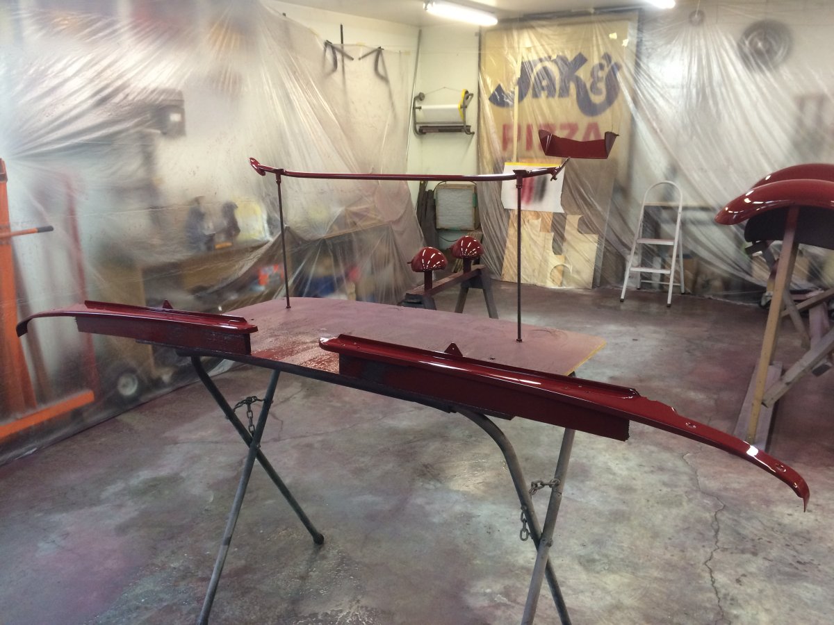

    image.jpeg image.jpeg image.jpeg Painted the front end parts to the "A" yesterday.

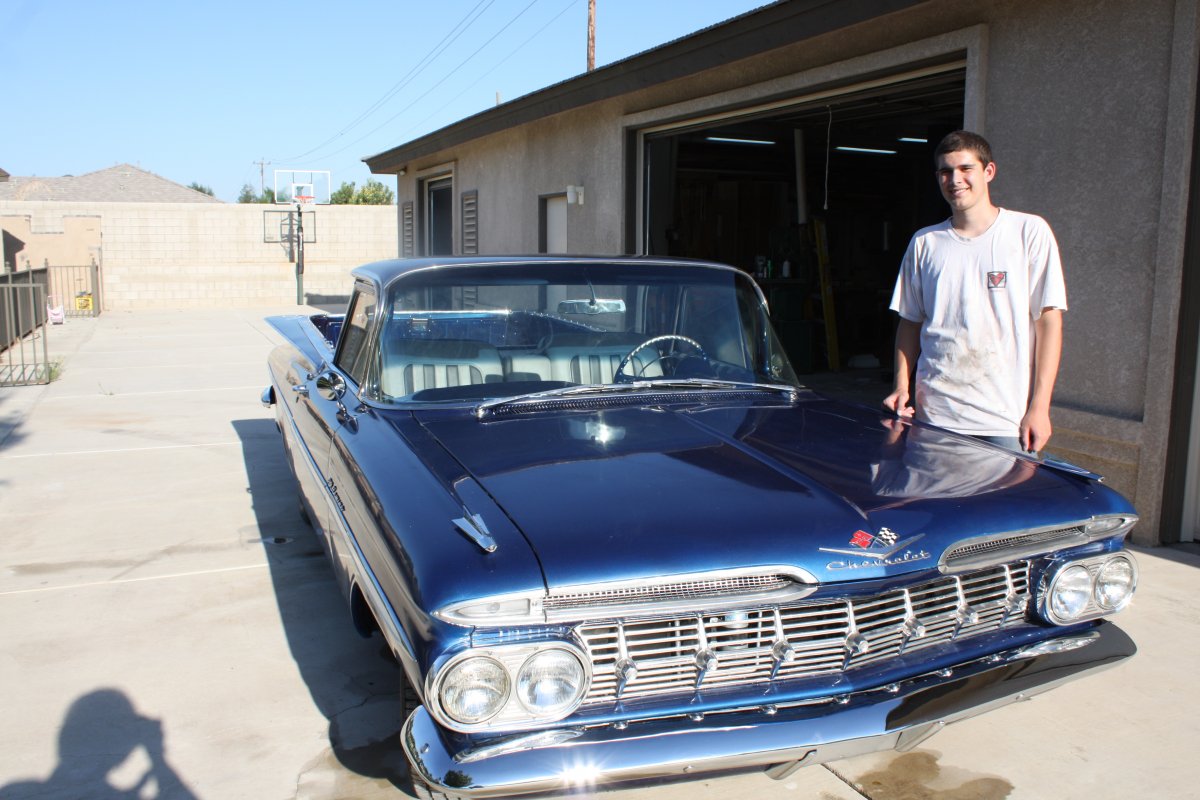

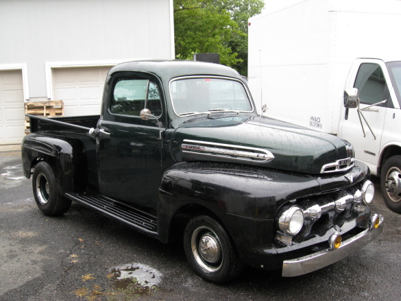

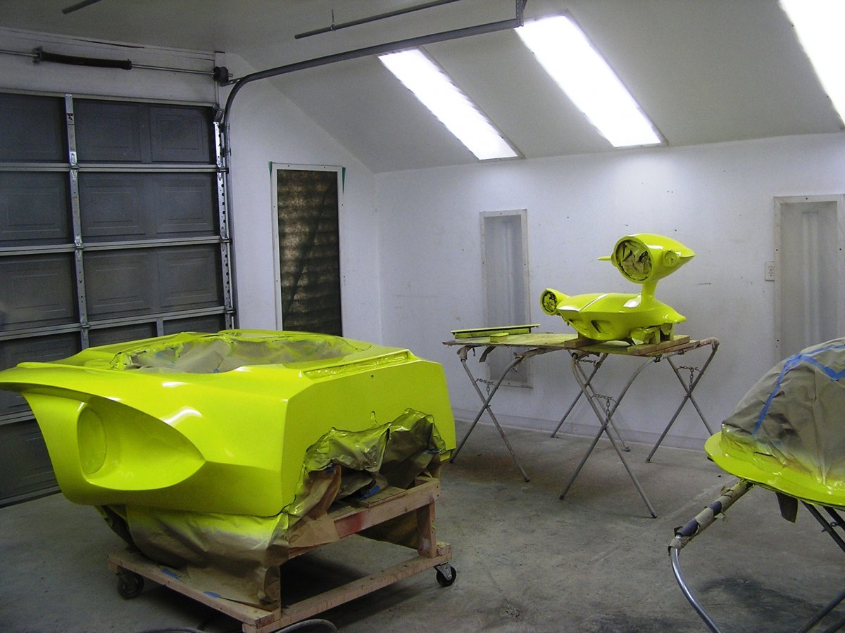

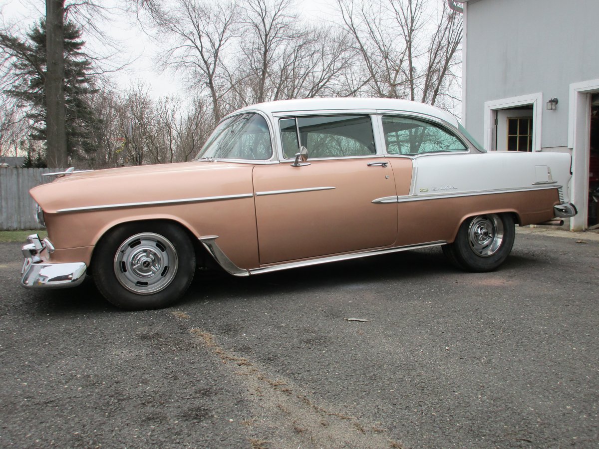

    Here are the two most recent paint jobs. This is the fanciest job I have done; epoxy white sealer, pearl white intercoat, 3 coats House of Kolor lime gold candy, 3 coats clear, all catalyzed urethane. Bob Coslett did the striping, I have never got the hang of that.
    Painted my grandson's '59 Elky urethane Chrysler Deep Water Blue metallic pearl,

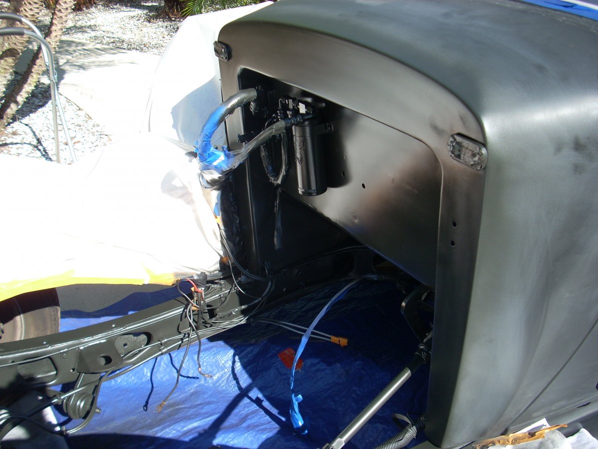

    Here's a start on my first vehicle. Owned for 30 years. Bought it with paper route monies and help from my folks. Parked it under a tree in Tacoma after the loosey goosey steering box locked up when I gunned it out into traffic and I hit a parked car. [​IMG][​IMG]

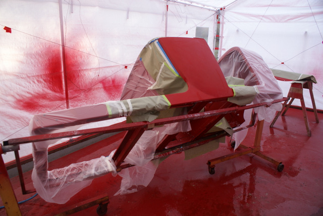

    Put up a cheap canopy on a slab,screens in one end and a fan in the other. Sprayed early in the mornings. I only had a couple bugs (re-sprayed) It came out pretty good for my first paint job in forty five years. DSC05917-001.JPG DSC06037-001.JPG DSC06070.JPG DSC06938-01.jpg
