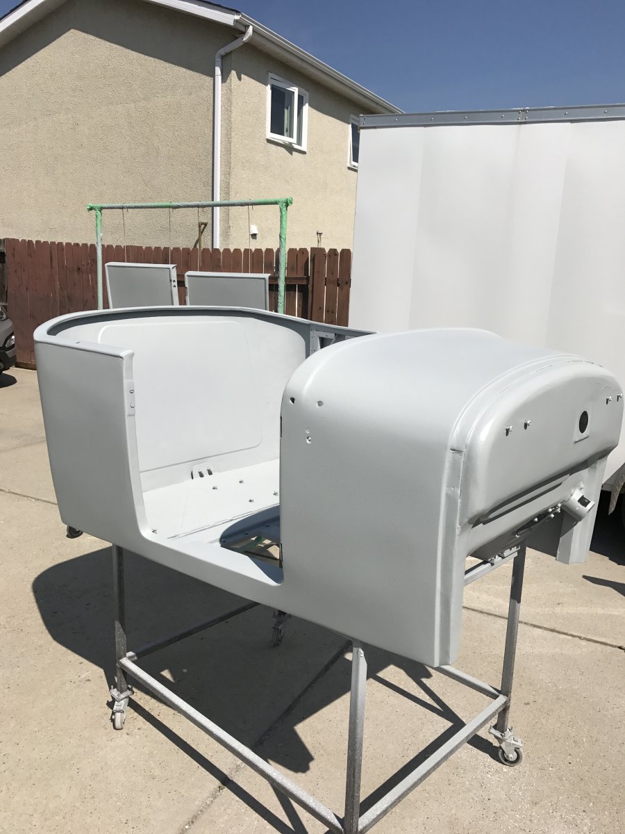

    Grille , bumper and tailgate in
    Primer. Next is to blow it all apart and put it in color.

    Wow you're not just painting in the driveway your painting in the drainage ditch!
    It looks like you had quite an interesting situation there.
    So anyhow, what's the rollover trunnion ***y for?

    Ulu. I like to call that a rotisserie... although it won't rotate 360 degrees...

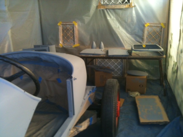

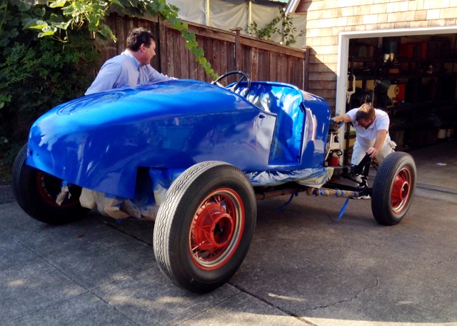

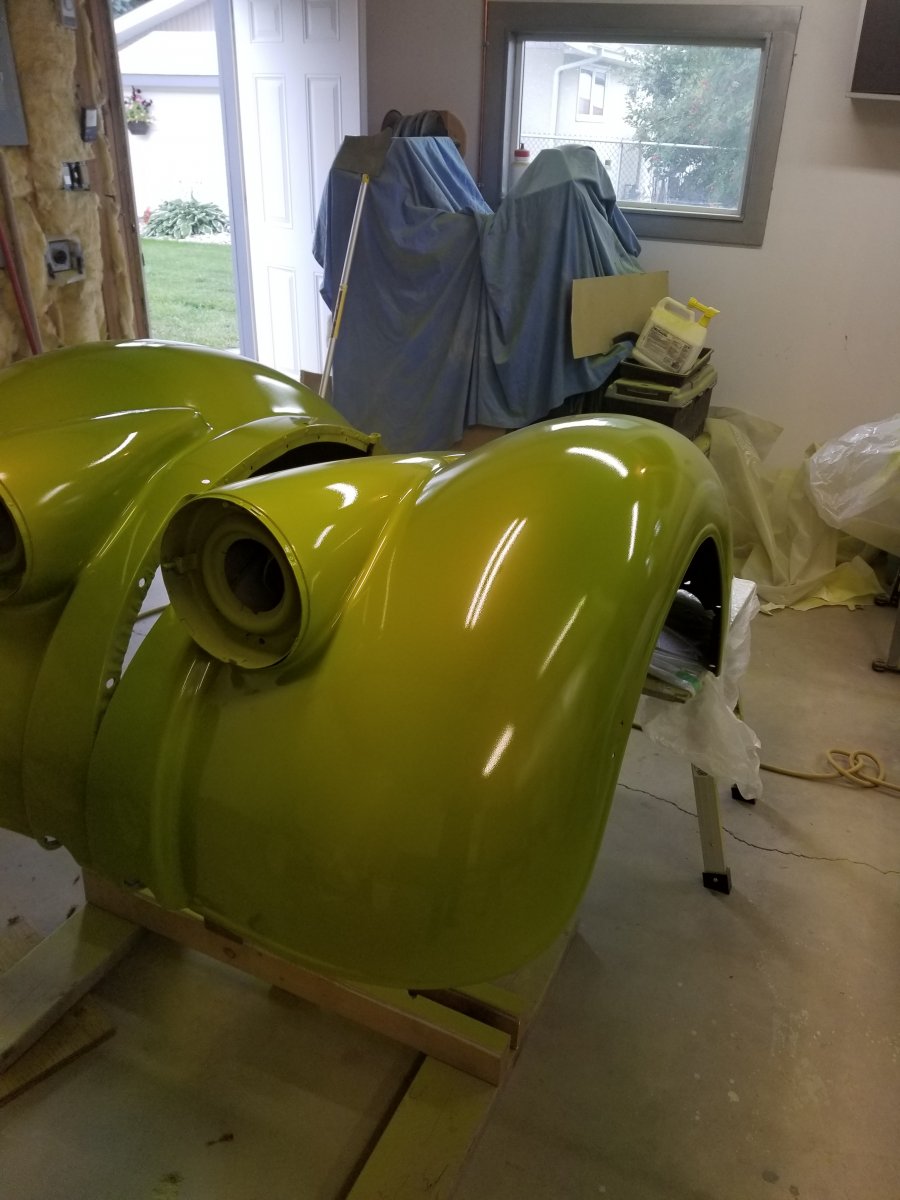

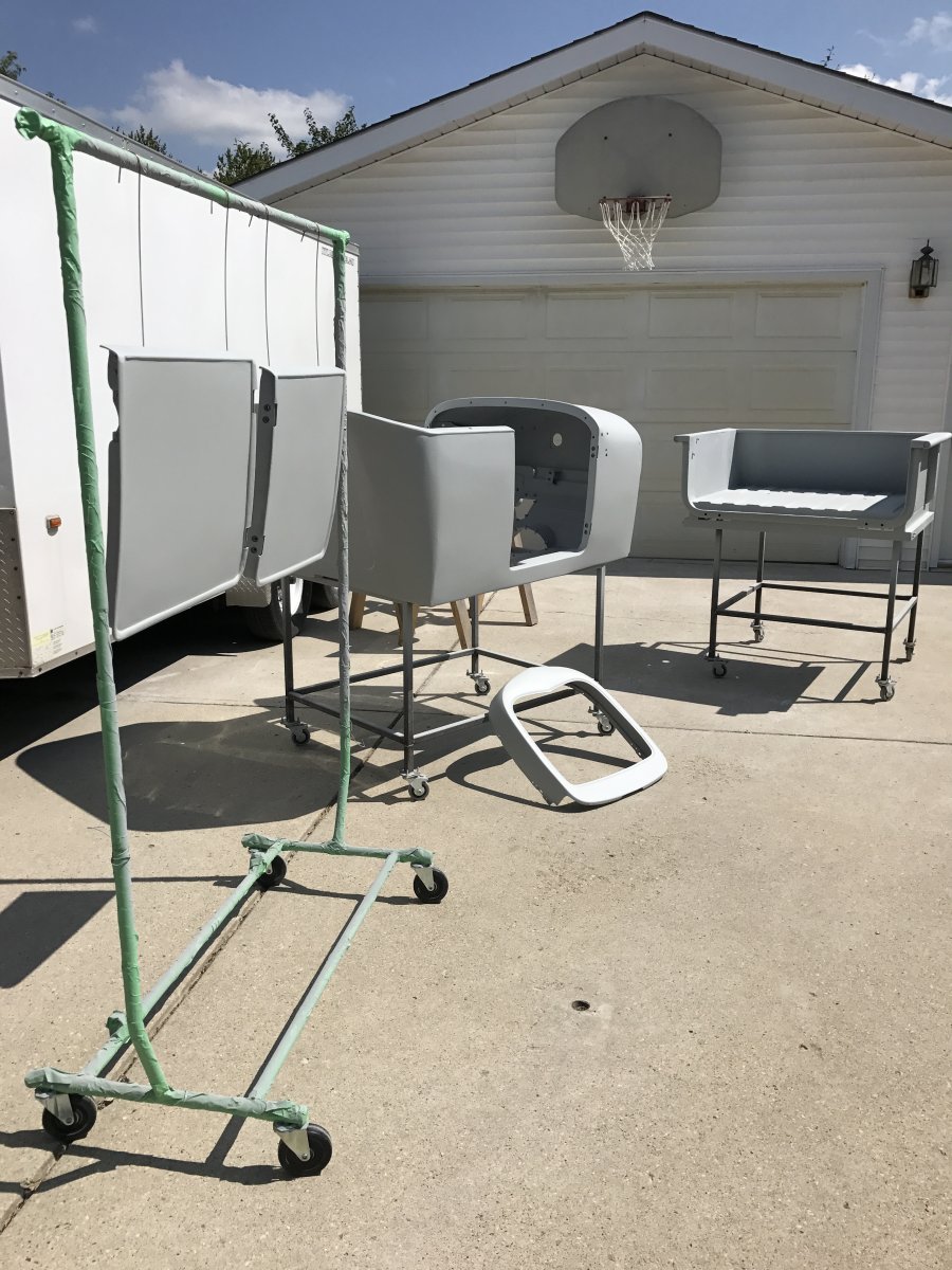

    Been meaning to post to this thread for a while. Painted my speedster just about exactly a year ago. Sealed the carport with plastic and installed several blowers and fans with furnace filters. Epoxy base, 3 coats of build primer followed by three coats of color.
    Started in August and it was a race against time. My makeshift paint booth was up for about 6 weeks, and at the end I was re-taping plastic every couple days, as the original duct tape slowly failed. My buddy Steve took a day off on the last 70-degree day of the year to shoot the color for me.
    By the way, it turns out you can have too much airflow. Had to shut one of the blowers down when shooting color. Another tip is that it’s OK to cover wheels and such with plastic when shooting primer that you will sand. But when it’s time for color it's better to use canvas, because paint can bounce off plastic and back into your fresh-laid paint. This is only an issue if you have a situtation like mine where the surface of the open wheels face the surface of the body.

    I have a stainless electric rotisserie I use to cook chicken on my BBQ. What you got there is a rollover fixture on trunnions.
    One of my first engineering jobs was to design some big hydraulic ones ones to roll over a piece of heavy construction equipment as the counter weights were being welded into the ch***is. It was very substantial and it had to handle tons of weight.
    I will probably end up building a roll over to do the body welding on my old Plymouth, but it will not be a permanent welded ***embly.
    It will be bolted up and I'll design it so that it can be dis***embled when I'm done with the thing.

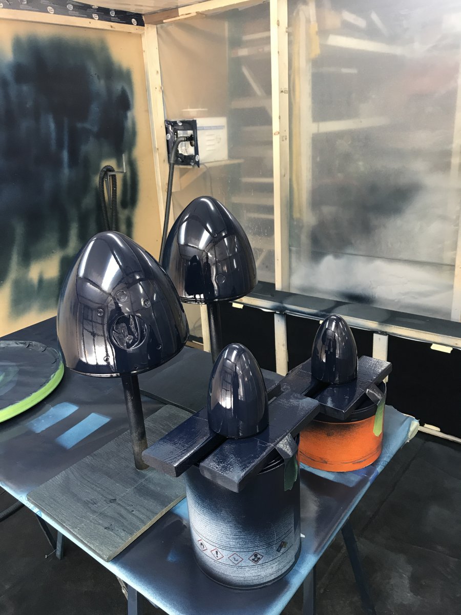

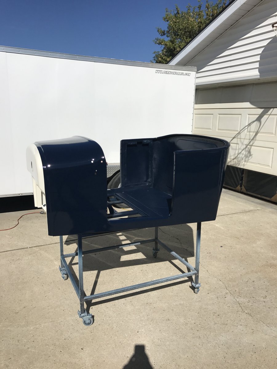

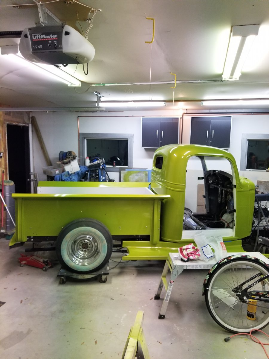

    Since I started this thread, here's the paint booth that I built in my garage.

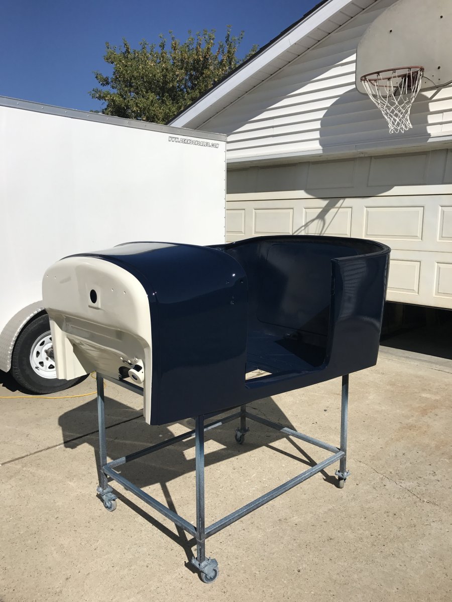

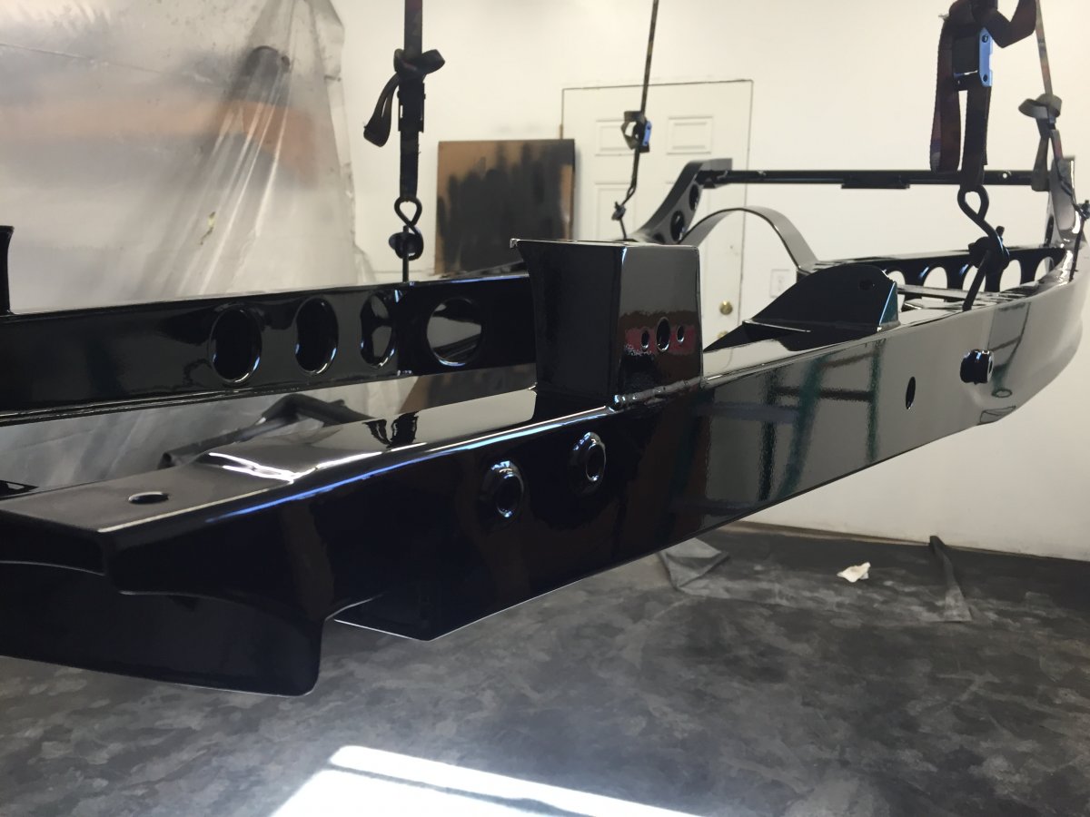

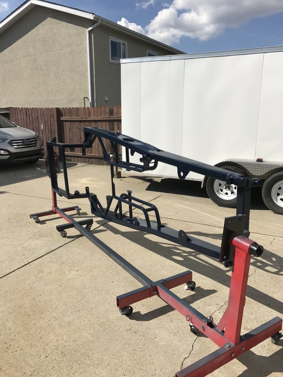

    And some of the results of using it.

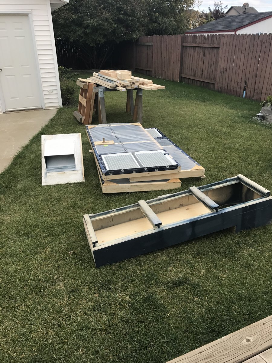

    And finally, the remains of the booth when it was all done. :cool:

    Anyone else doing any painting ?

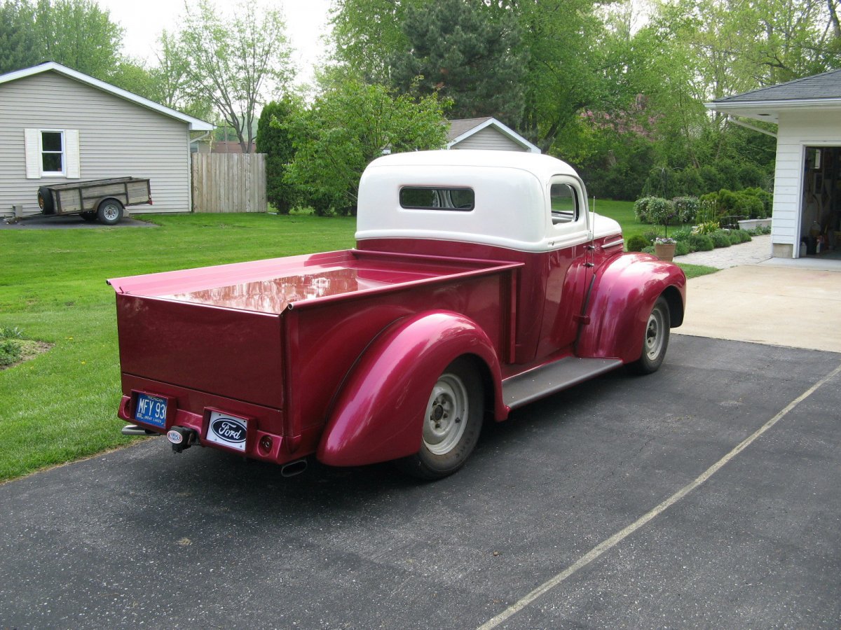

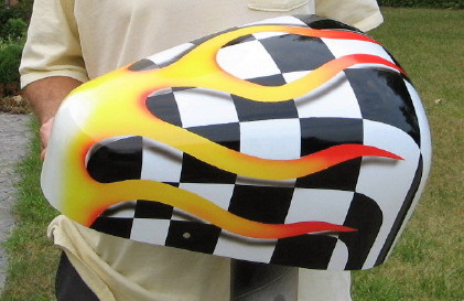

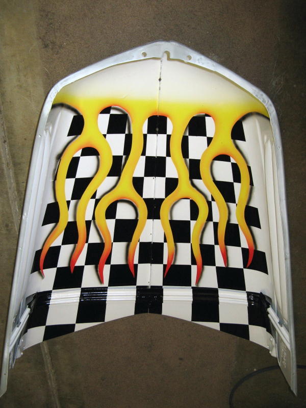

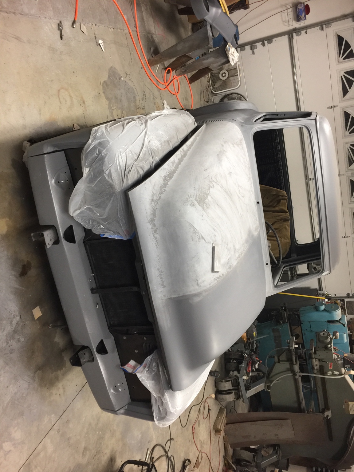

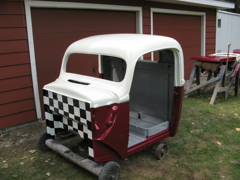

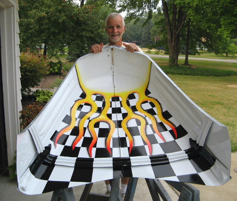

    I did my pickup in my back yard. It is the LAST paint job I will do that way. From now on I will rent a booth. Today's paint - in this case two-tone with a clear coat, are just too complicated to do in one day, which I tried to do. Looks OK from twenty, but has lots of minor flaws.
    46trk07bondo.jpg 46trkbodypaint01_1.jpg 46trkbodypaint02_2.jpg 46trkbonnet03_3.jpg 46trkhood01_4.jpg 46trkhood02_5.jpg ins08.jpg USAC 02.jpg

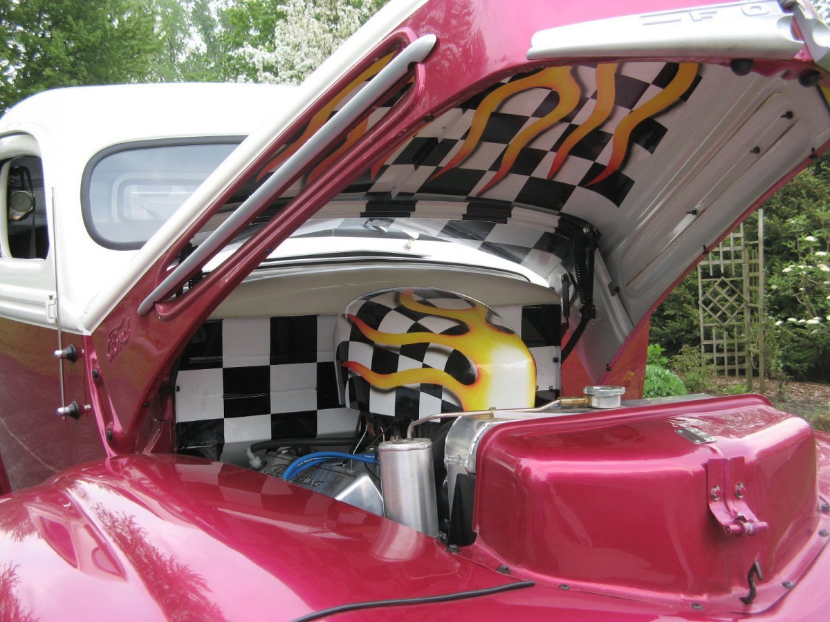

    The checkerboard / flame job was done on a previous day. ins02.jpg

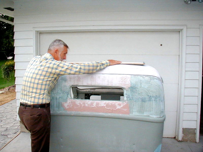

  21. Can you expand upon what we are seeing in that first picture?
  22. loudbang likes this.
  23. oldrelics
    Joined: Apr 7, 2008
    Posts: 1,727
    oldrelics
    from Calgary
    I'm wondering too, spread body filler with a mortar trowel?
  24. Dick Stevens
    Joined: Aug 7, 2012
    Posts: 4,139
    Dick Stevens
    Appears he is sanding the top with a longboard to get it just right before spraying color! :)
  25. THE FRENCHTOWN FLYER
    Joined: Jun 6, 2007
    Posts: 6,110
    from FRENCHTOWN
    Yes, that is correct. I use a long piece of plywood. I cut apart a sanding belt from a belt sander, wrapped it around the ends and affixed it to the board. I use a set of mold sweeps to get the curvature consistent. O/T, but I used two roofs for the 3" top, with only one seam across the top.
    As far as the troweled on bondo, I like to do the first coat like that so subsequent coats will show when sanding them down I am nearing the original surface of the metal. It helps me gage the thickness of the bondo applied.
    Also O/T, the cycle-tank-turned-air-cleaner was rescued from hurricane Wilma debris and striped using a carpenters laser level, as was the inside of the hood.

  26. Man... this is cool. How much do you think the booth cost you for everything?

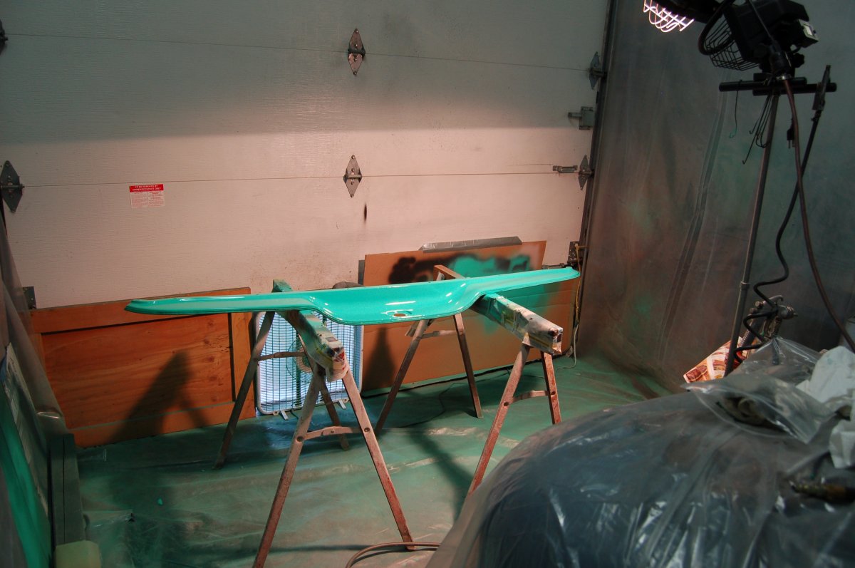

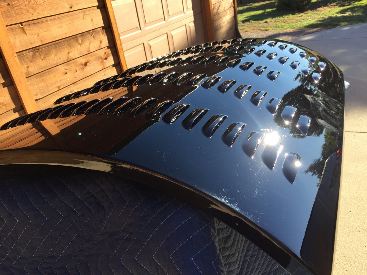

    Hanging plastic and wetting the floor keeps the dust low. This is single stage PPG.

  28. Blue One
    Joined: Feb 6, 2010
    Posts: 11,519
    Blue One
    from Alberta
    The lumber and plastic was about $200 and the 12" vent fan was $120 and 25' hose was $70.
    I spent another $100 on a 10' x 16' canvas tarp for the floor.
    I didn't use a cheaper poly tarp on the floor because of the static factor.
    The booth wasn't big enough for a full sized car at 15'x 9' x 80" tall, but it did the trick nicely for my RPU painted in pieces.
