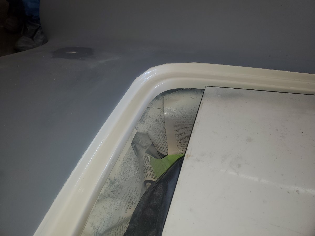

    This is my wife’s off topic car but I painted last summer in the driveway .

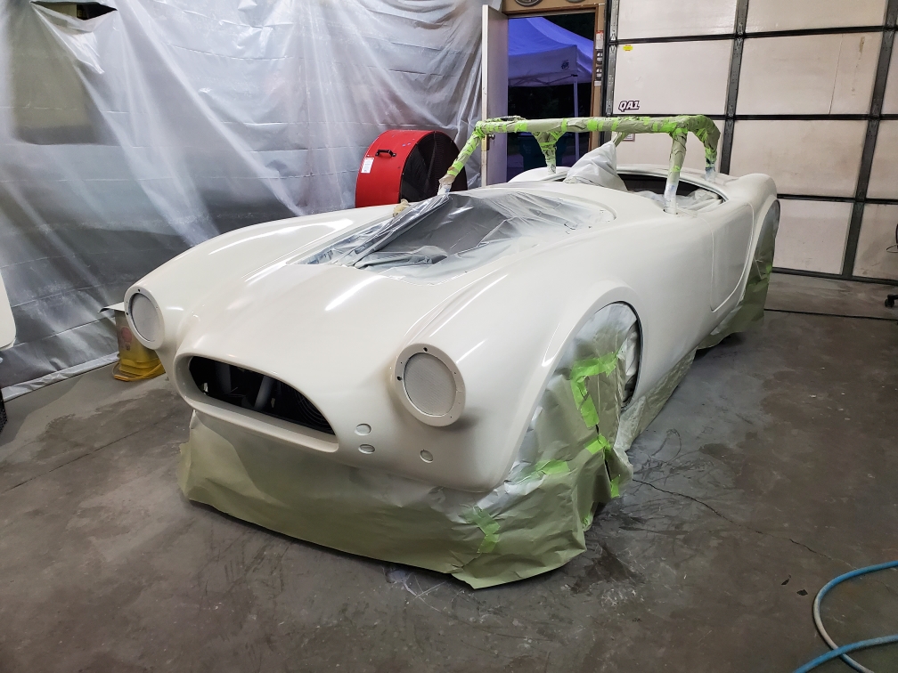

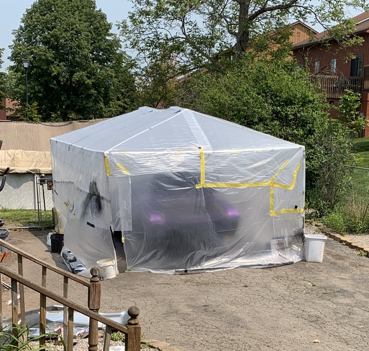

  5. Amazon wedding tent .
    10x30 goes up and down quick and easy with 2 people. Then you seal it as good as you want/need.
    For this job I was just concerned about keeping the over spray fallout inside the container and not floating all over the shop.

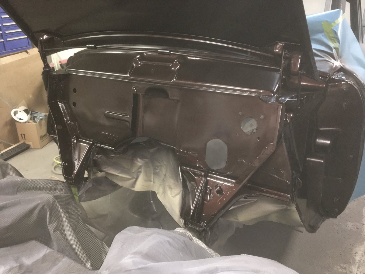

  6. Getting closer to finishing up the rest. Firewall , inner fenders dash all done. Stude coming back to life.
    Training Better half to paint her stuff. 4B2249A9-F519-408C-A0CA-4906F9109C63.jpeg F2CEB69B-2800-4E3A-A9D7-90E85953FDA6.jpeg D5B8C1A2-4DDD-4E66-A5CD-2023C9B0AF99.jpeg B54B17F9-C133-427A-B36F-7D045ED86C6B.jpeg

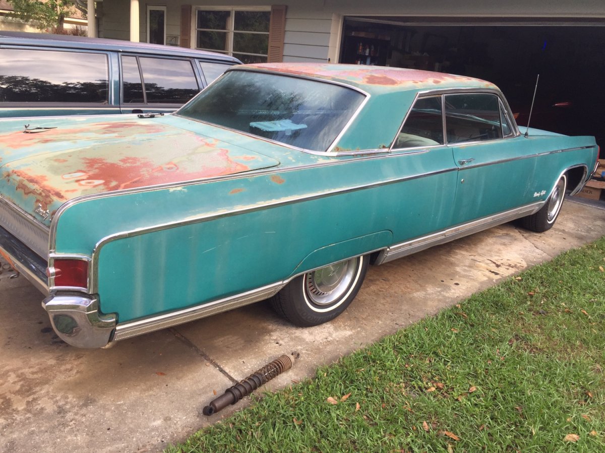

    Finally got some paint on the bare metal roof
    Florida humidity wreaks havoc on steel
    Actually used a small gloss paint roller. Very windy today and wife is sick. No way I could have sprayed this in or out of garage
    Don’t care about small bumps because will get sanded after rust repair complete
    Honestly thinking about Dustless Blasting rest of the car, in near future
    Looks so much better than before
    I.Color 2010 Voc Dtm epoxy Hybrid Primer
    I.Color 2015 Activator

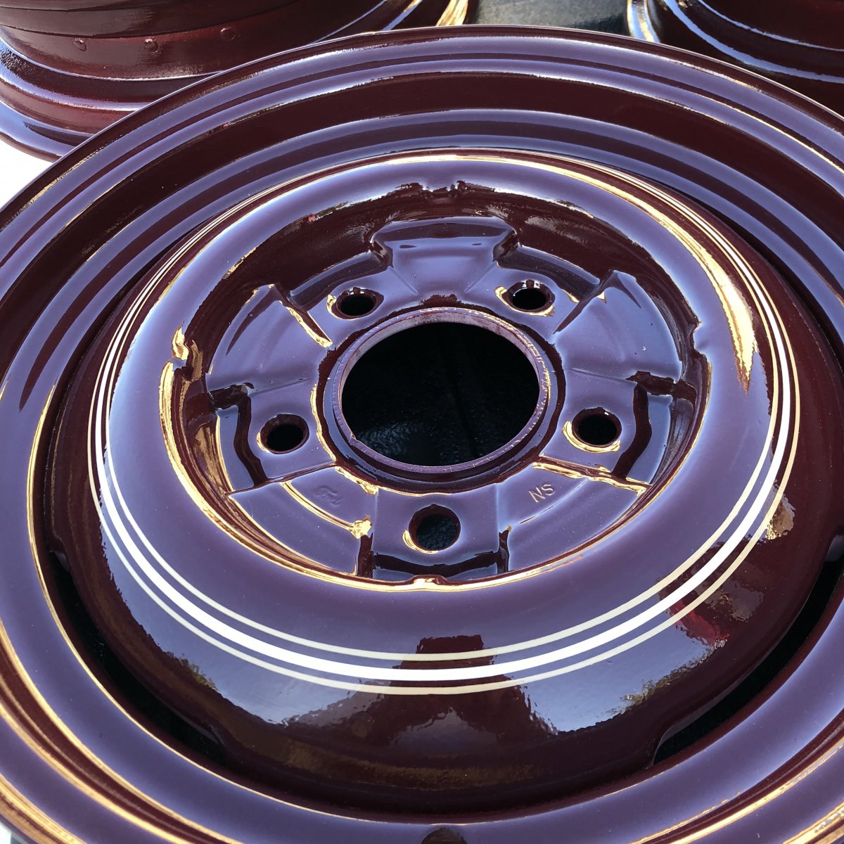

  13. I did these in AU in my RV parking area…didn’t have to be perfect, going on my original paint ‘46 woodie…Phill Whetstone pinstripes... BB83A541-5A95-416B-80A7-64747CA8F9D4.jpeg 5F4BED82-23C6-4C55-9137-CDDB74987489.jpeg

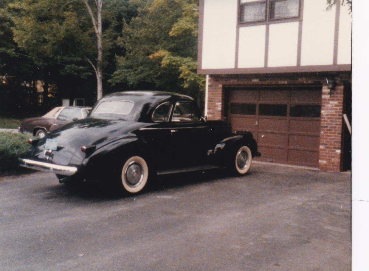

    lasalle finished.jpg lasalle fender.jpg My 1st paint job in 1978. Painting cars in my driveway just about every year since then. This car was probably my best paint job This is the last car I painted black.
