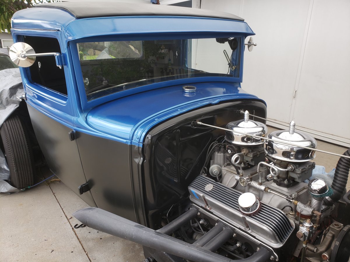

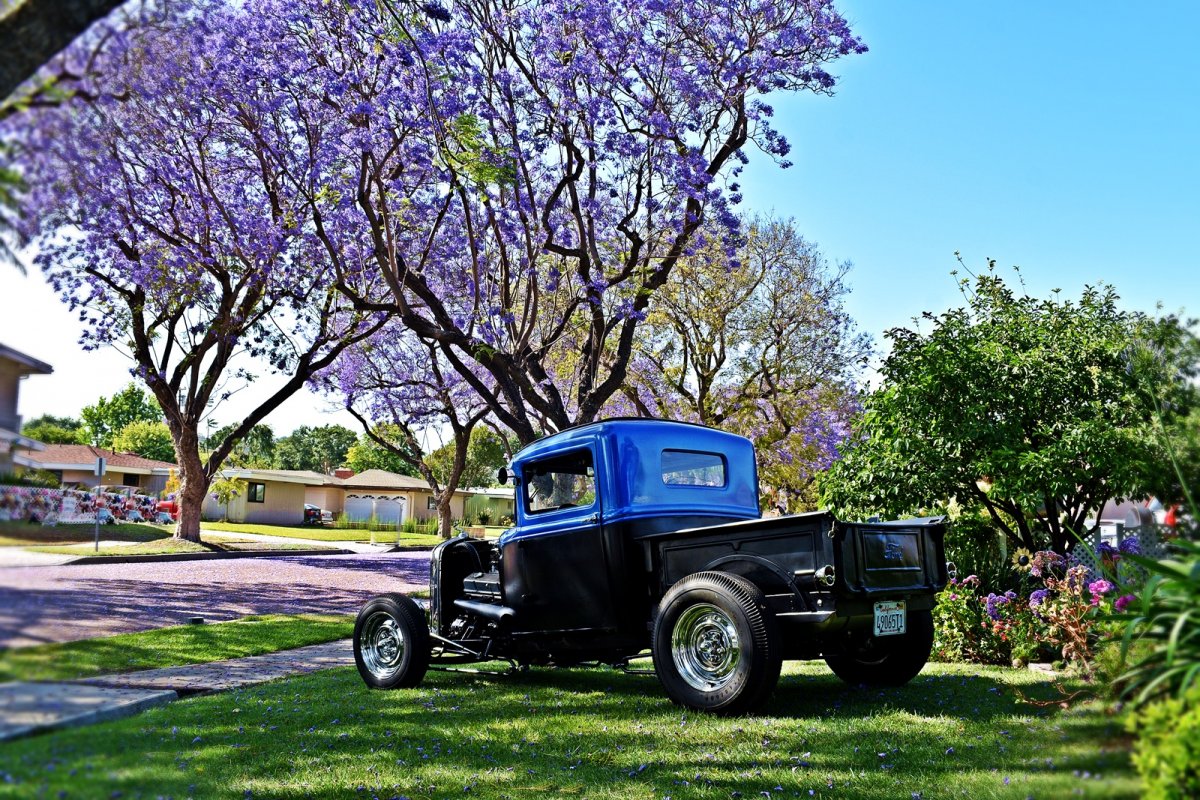

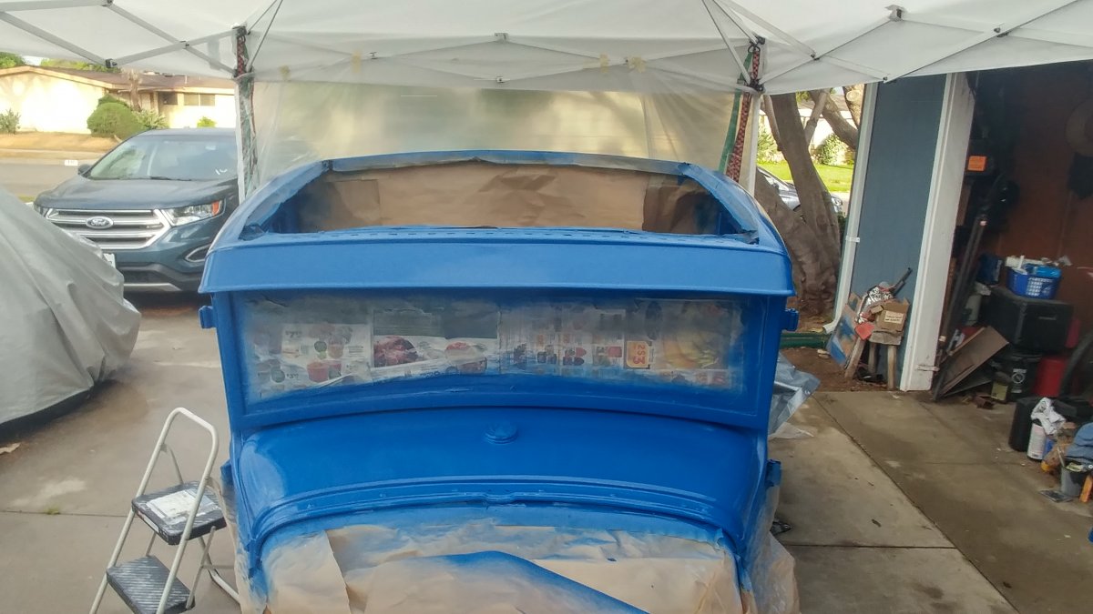

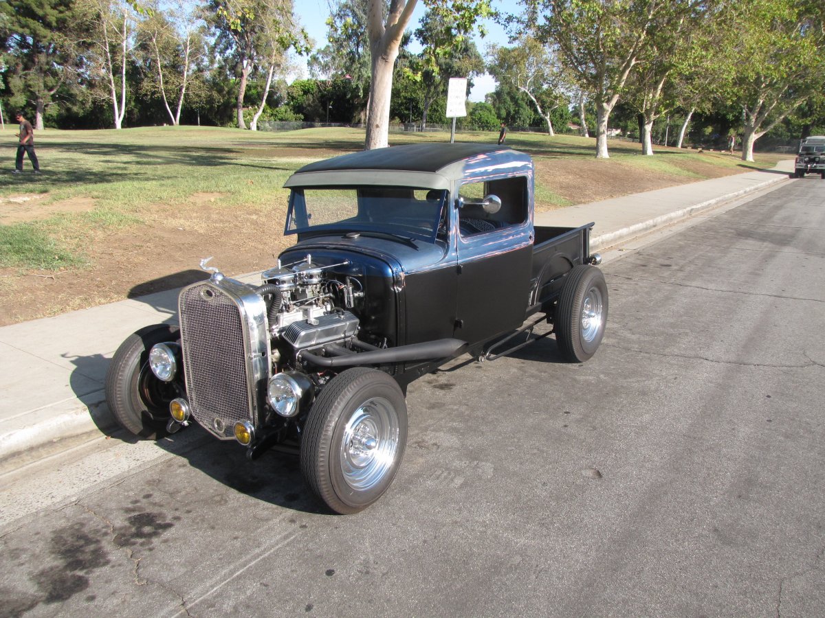

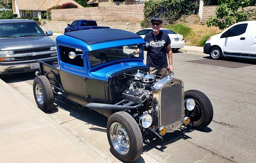

    This was a covid project for me. It was actually on my New Years project list for 2020, when covid hit and all my blues gigs ended, I decided to the project. This was a true driveway (rattle can) paint job.
    Before:
    Mid way:
    After:
    I still need to do the below the belt line. Currently there is about 4 different shades of black. I need to make it all 1 shade, and I think I've finally settled on the paint I'm going to use.
    The blue consists of a couple of coats of Krylon True Blue, a couple coats of Krylon Shimmer Metallic Candy Blue Razz, and a couple coats of Spray Ma** 2K clear.

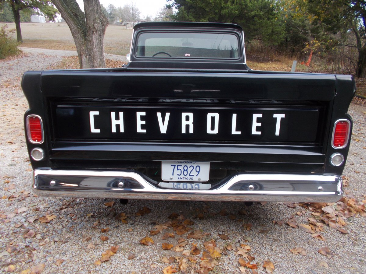

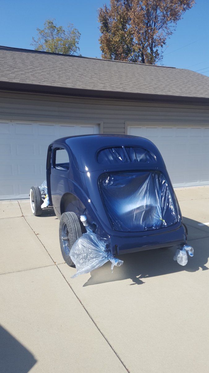

    46trk_with champ 02.jpg I painted my pickup in my back yard.
    Two tone.
    Base coat / clear coat.
    Started at the crack of dawn with first taping.
    Finished after sunset with bugs sticking to the clear coat.
    Never again.
    From 20 ft away it looks gorgeous. But up close the flaws from hurried pace and bad environment show up.
    I'll rent a paint booth before I ever do a two stage, two tone job outside.

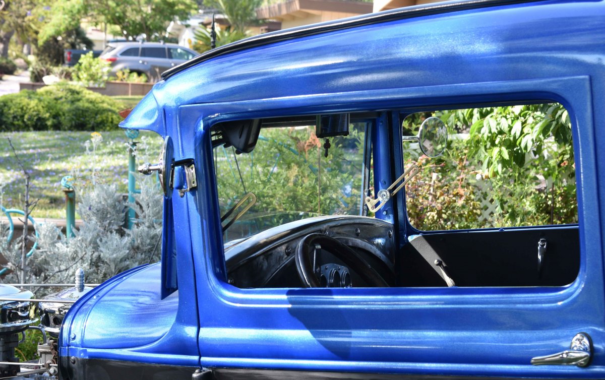

    This is the only close up I've got, probably not what you're looking for. I can try to get out and take a shot of the cowl later.
    The Spray Ma** 2K is nice to work with, it sprays excellent; with a great nozzle, the best I've ever seen or used on a spray can. I actually took one of the nozzles and used it on the cans of metallic blue too, one reason I was able to lay that down as nice as it came out.
    Note, I never did wet sand it and rub it out, it definitely could use it, especially along the back panel around the back window, there is a slight amount of orange peel. I guess I was just so happy with it after years of looking at it the way it was I just wasn't motivated enough to rub it out. I think it's too late to do that now, but I'm OK with it, it is just a truck afterall.

    When I did mine, I had everything taped off and ready to go the night before. In the morning I started about 6 am, hung a plastic drop cloth on one side of the awning (the direction the wind blows from when it starts), swept the driveway and hosed it down, then started spraying, leaving ~20 minutes between coats, I was done spraying by 10:30 or so, just as a light breeze started. I ended up with no bugs or leafs or anything in the finish.
    A booth would be nice, I'm not sure if there are any to rent around here.

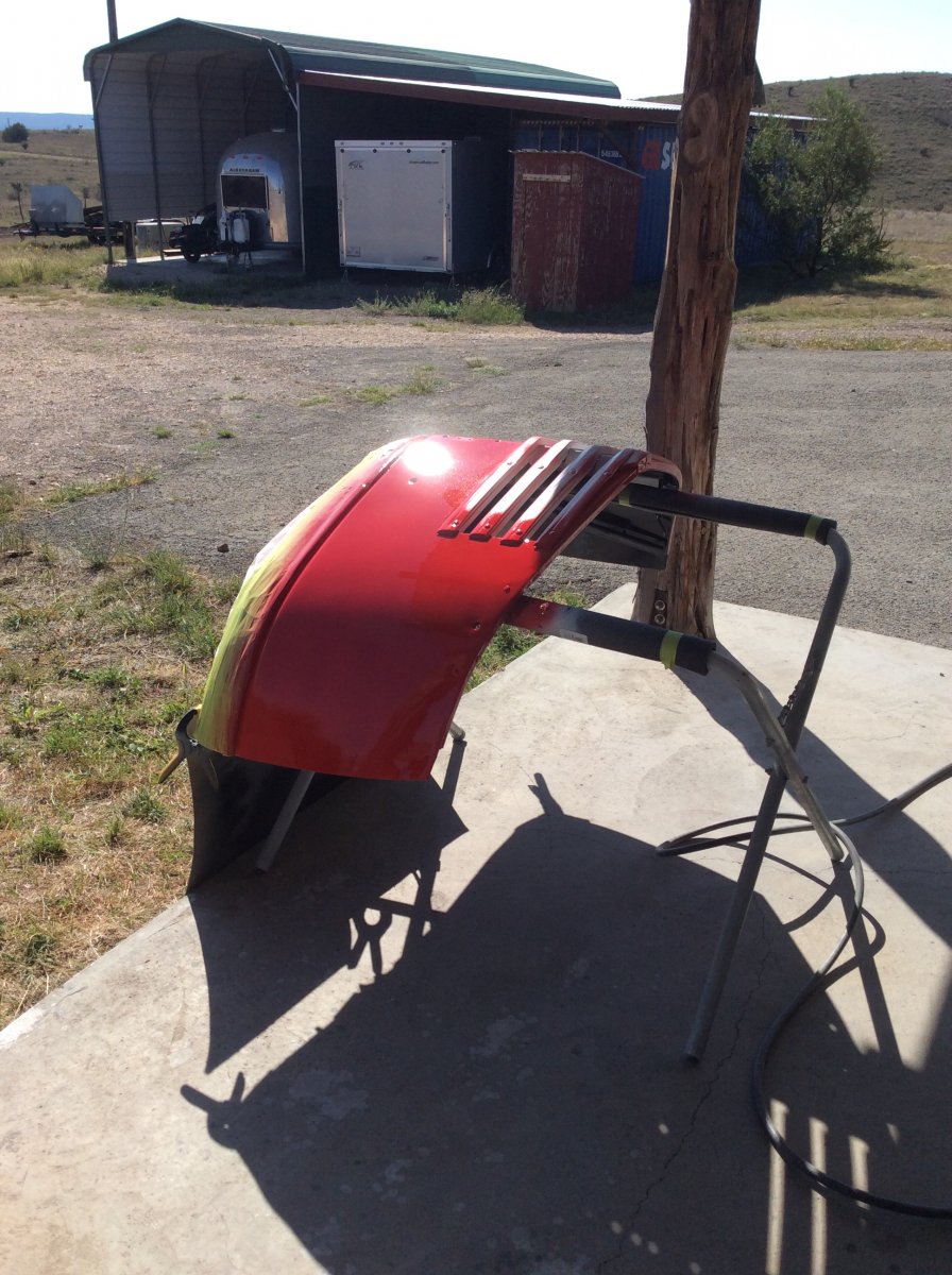

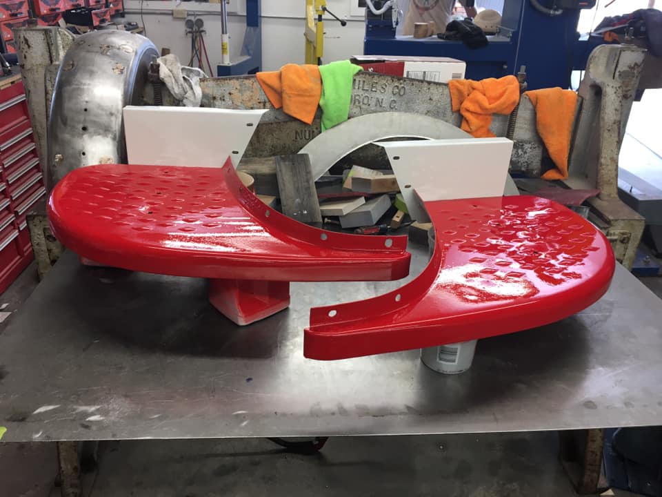

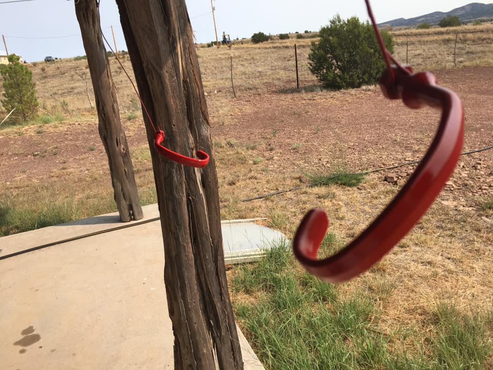

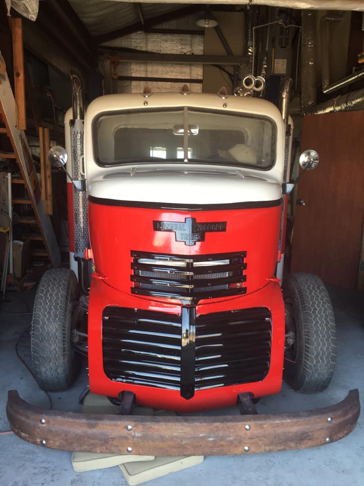

    Did some parts for my COE on the porch and in the yard .
    457DA5CE-906C-4C23-805D-2D6440538AB6.jpeg 0B3BFDDF-D86A-45C7-9587-BF16CC933226.jpeg 7EFFC0D9-A619-4D65-87BB-B2FDFA17A0F9.jpeg E4FFEE17-5CEB-4B8A-B90E-DB8BB9326972.jpeg 649BC8B1-ACD8-46B5-9FBE-6DCA5BC49430.jpeg 1CA34E10-6D8A-4651-A50B-137CAE6306ED.jpeg 40F945E0-1498-4BFC-AAFA-032210C7F30F.jpeg D5B06A09-0AFF-4E10-AC57-4F75160DD375.jpeg

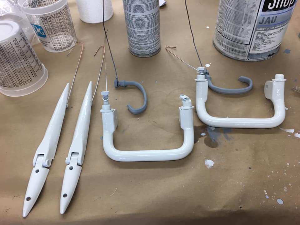

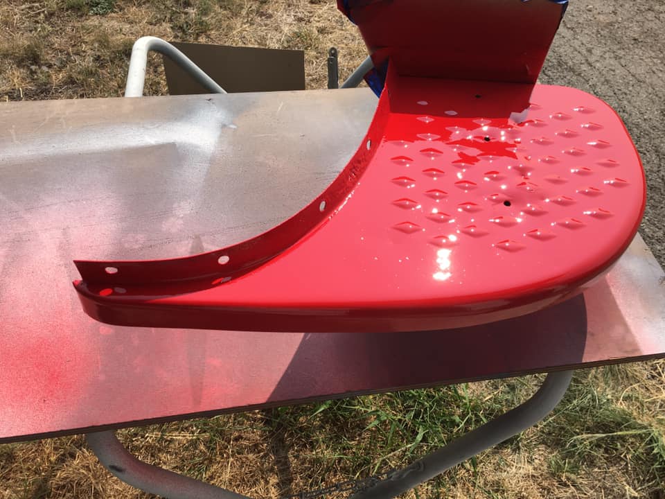

    About all I have done on this topic in recent months is paint my 1/8 scale Mysterion. Used same paint as I used on the 1:1 version.
    • white primer
    • catalyzed urethane clear with white pearl dust
    • urethane base coat/clear coat using HOK candy Lime Gold toner
    • pinstripe with Robin's Egg blue 1/64" ChartPak striping tape (this is different from the big car of course which was professionally striped)
    • bubble was tinted with clear urethane with HOK cobalt blue candy toner

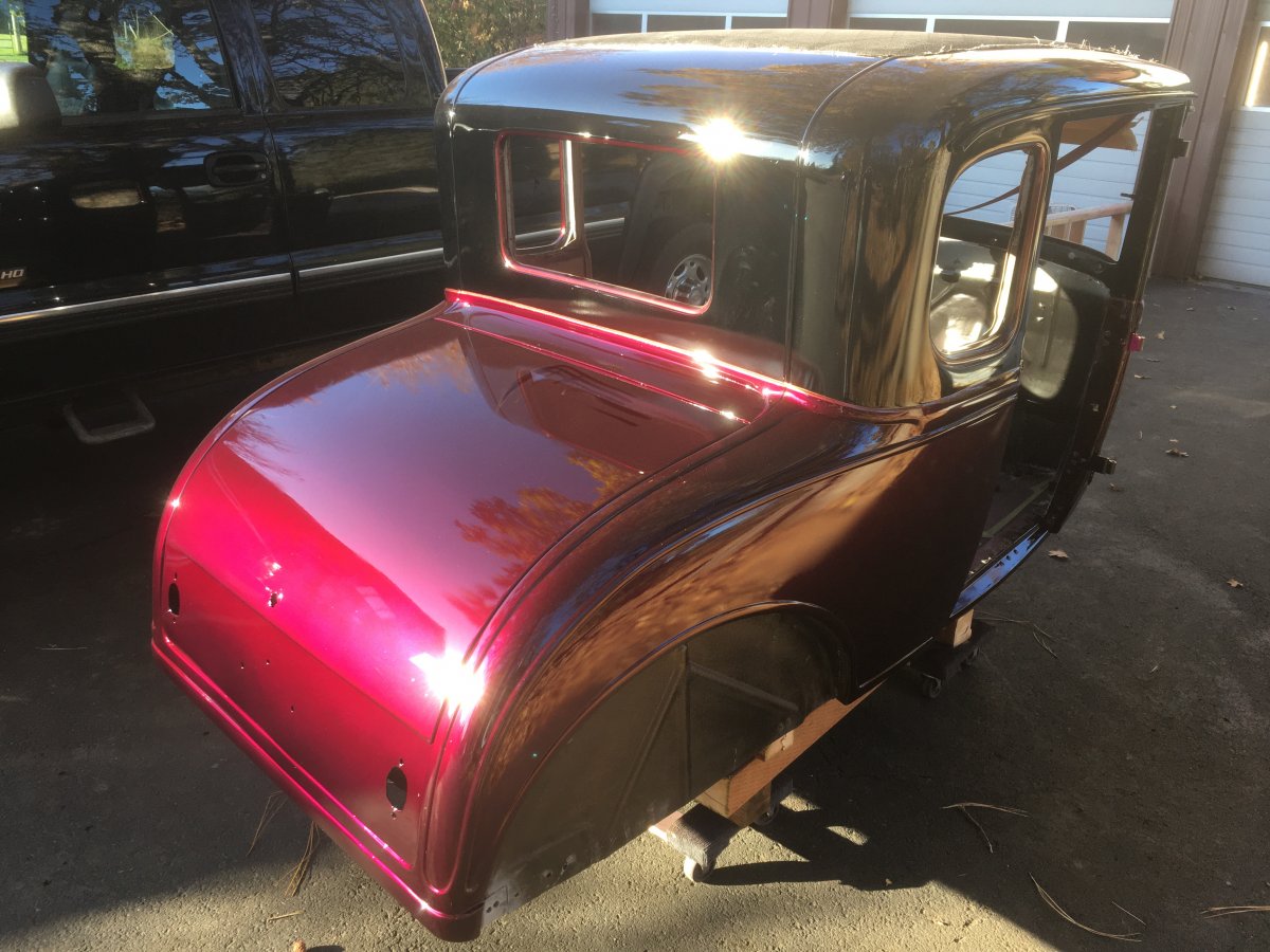

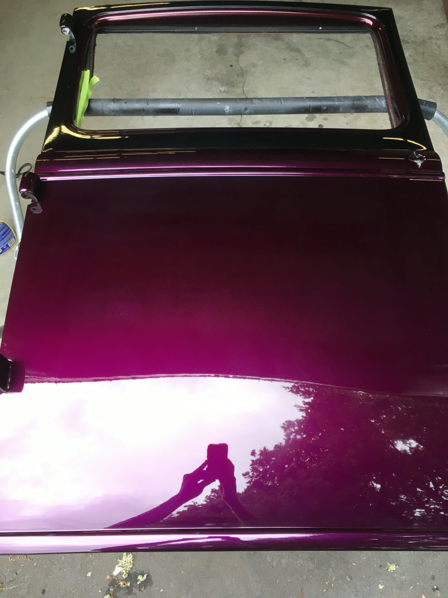

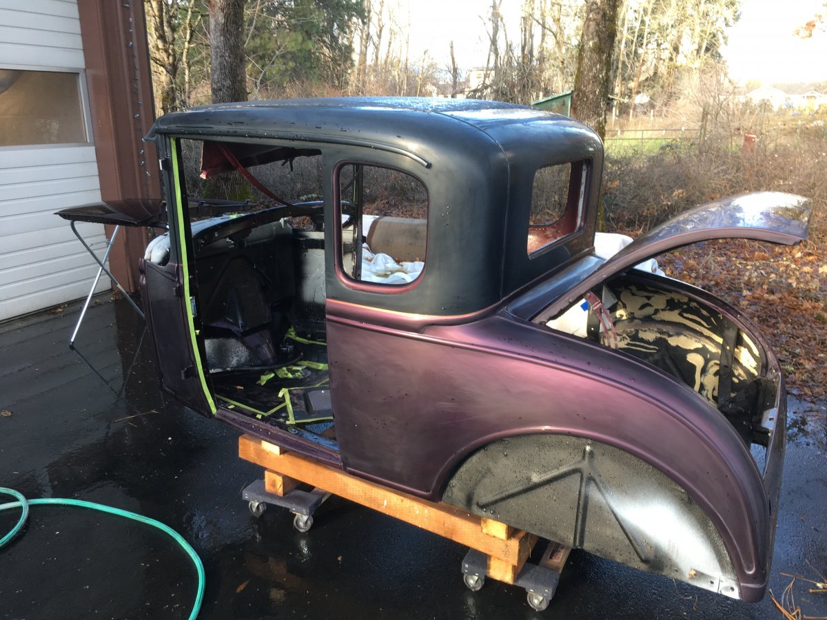

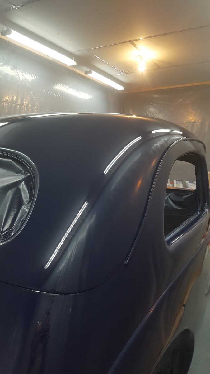

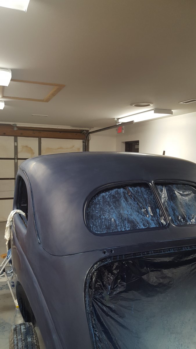

    Built a ‘spray booth’ in my garage, repainted a Model A with House of Kolor Black Cherry candy base coat. One coat of sealer, two of black ground coat, 4 of color, 2-3 of clear. A real spray booth would have been better, but it worked pretty good. Eastwood gun, help from a friend.
    Second to last picture is a reflection in the trunk lid.

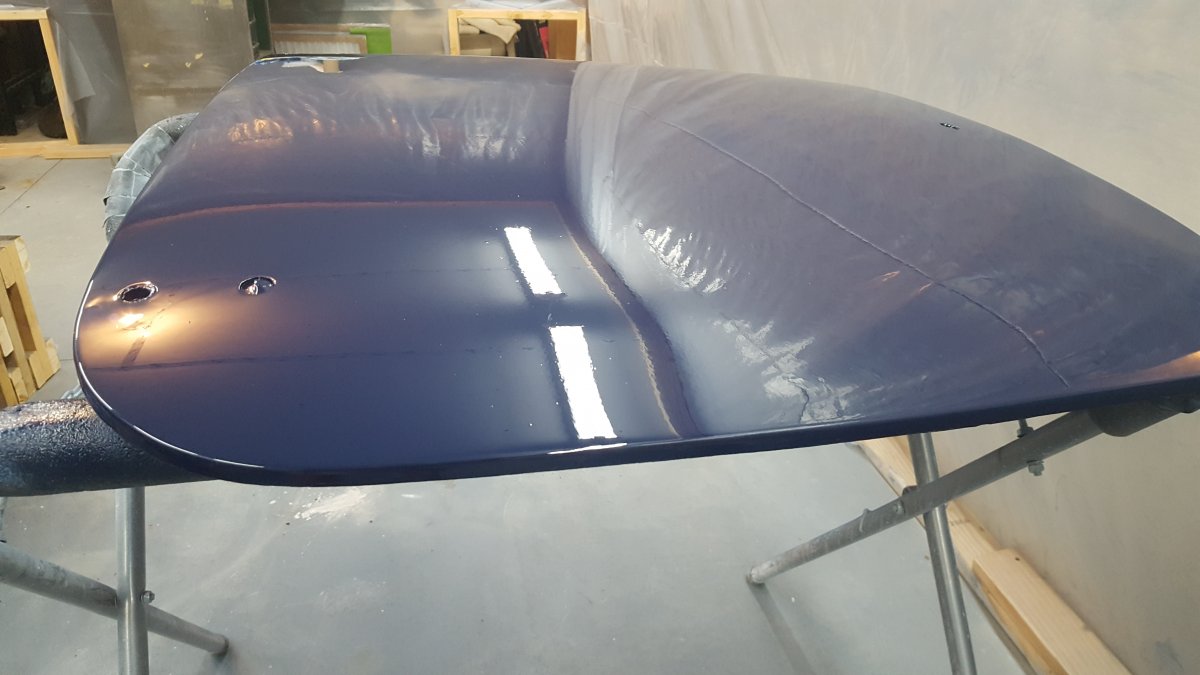

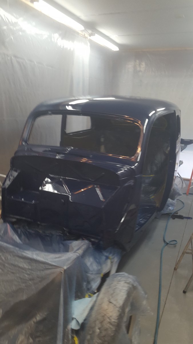

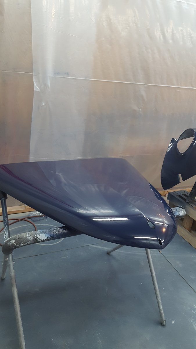

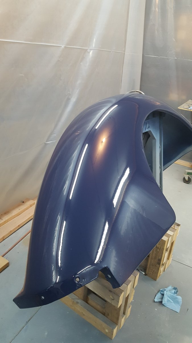

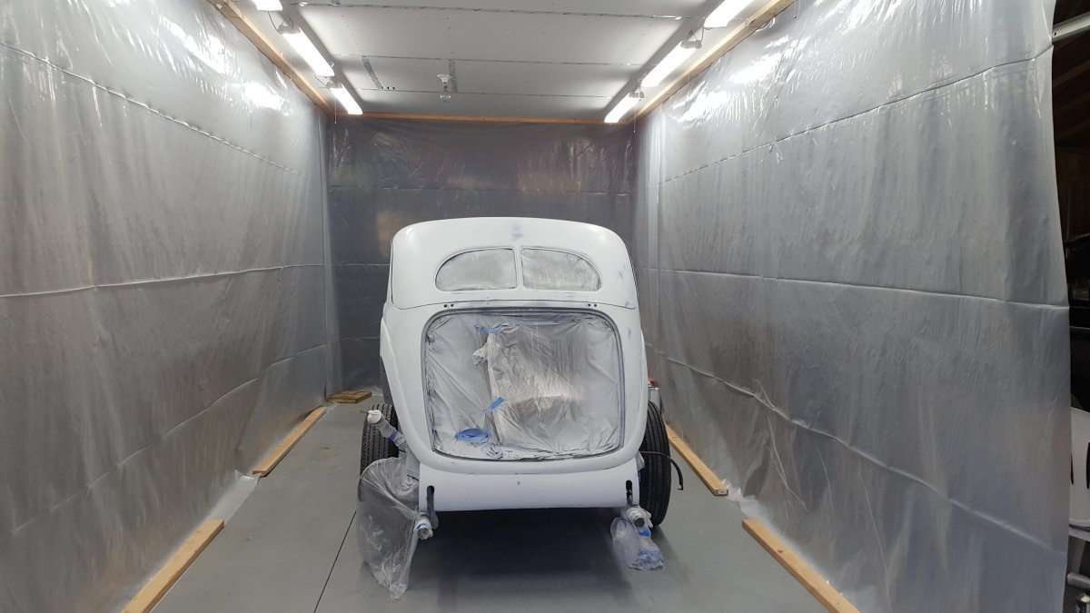

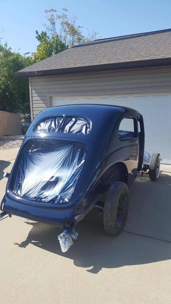

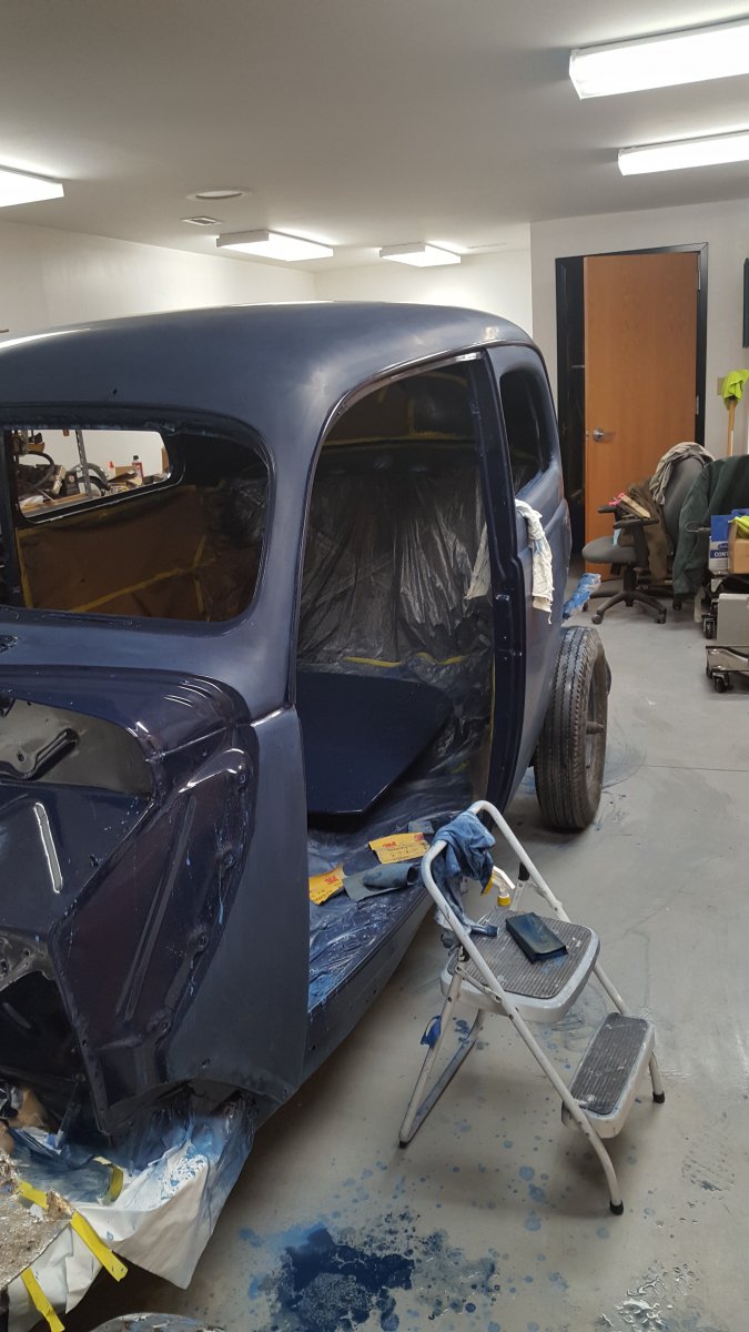

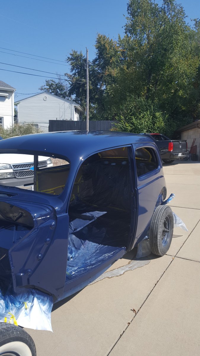

    Made up a 24'x12' "booth" with filtered intake and exhaust fan blowing out under the partially raised garage door. 20200913_184744.jpg 20200920_124958.jpg 20200920_125005.jpg
    Got a little foggy
    20201006_173655.jpg 20201006_185721.jpg 20201007_123737.jpg 20201007_123747.jpg 20201007_123805.jpg
    Professional grade fender stands
    Man this **** takes a lot longer than it used to...... just about got the orange peel out and ready for 1500/2000/3000 cut and buff.........
    .......... NO MORE SHINY CARS

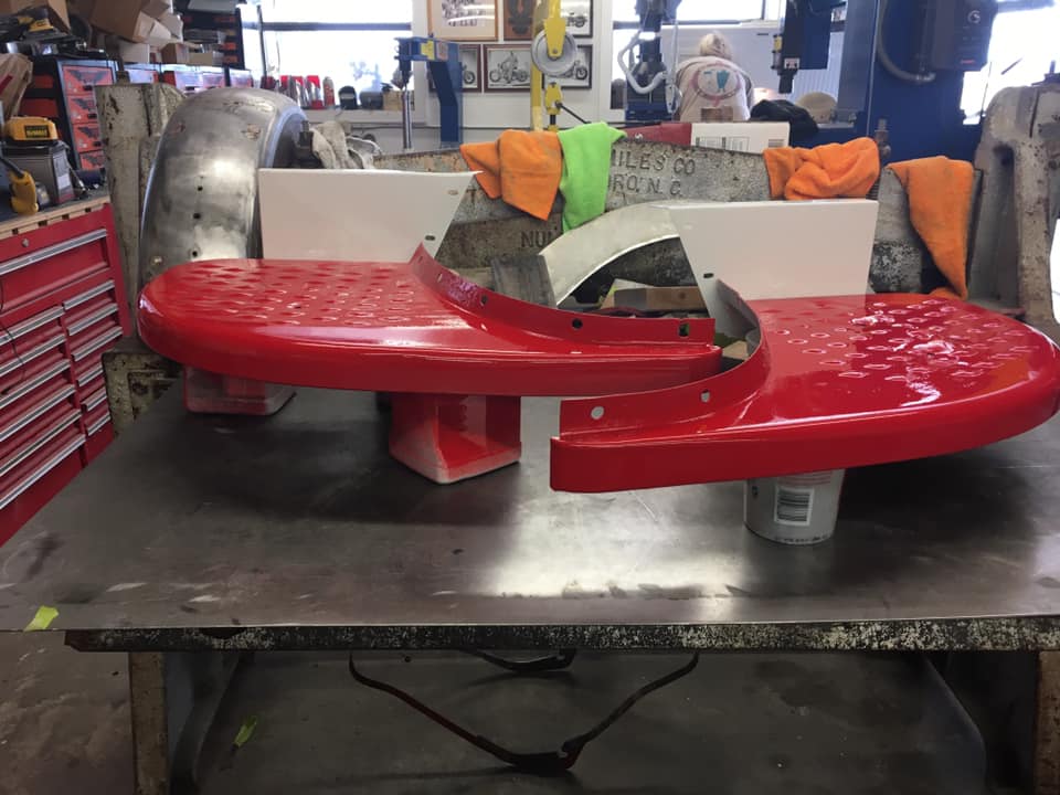

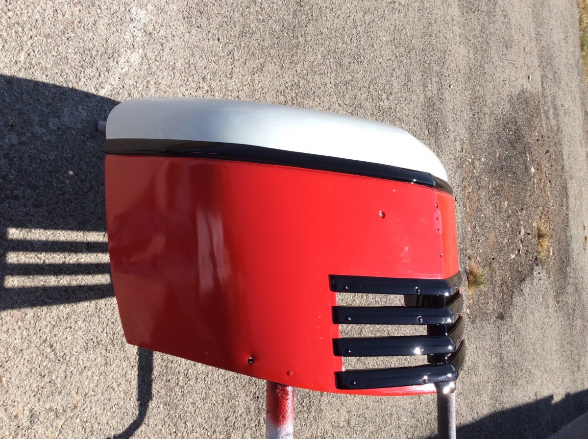

    Did a little more on my COE .
    058D4318-204F-464E-95DF-83098E5BA8EE.jpeg 137B5EA0-5D2A-46B0-A219-D72D6FDFB186.jpeg FF08242A-F56E-4351-BC64-E1A4D0301479.jpeg 3B3B0FBA-013C-4FFD-87D4-842F29887280.jpeg 0118BED9-6864-4A6B-9A5F-A68781FBD466.jpeg
