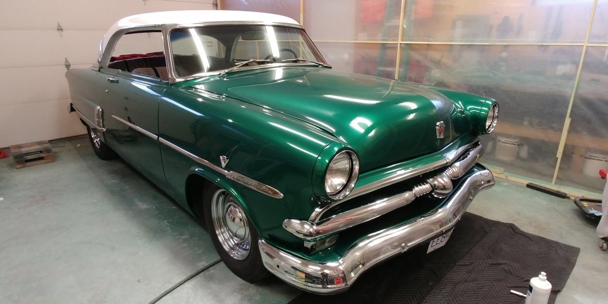

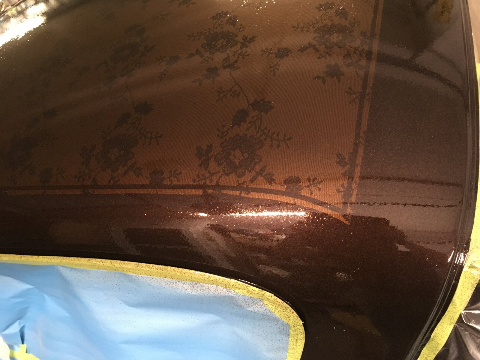

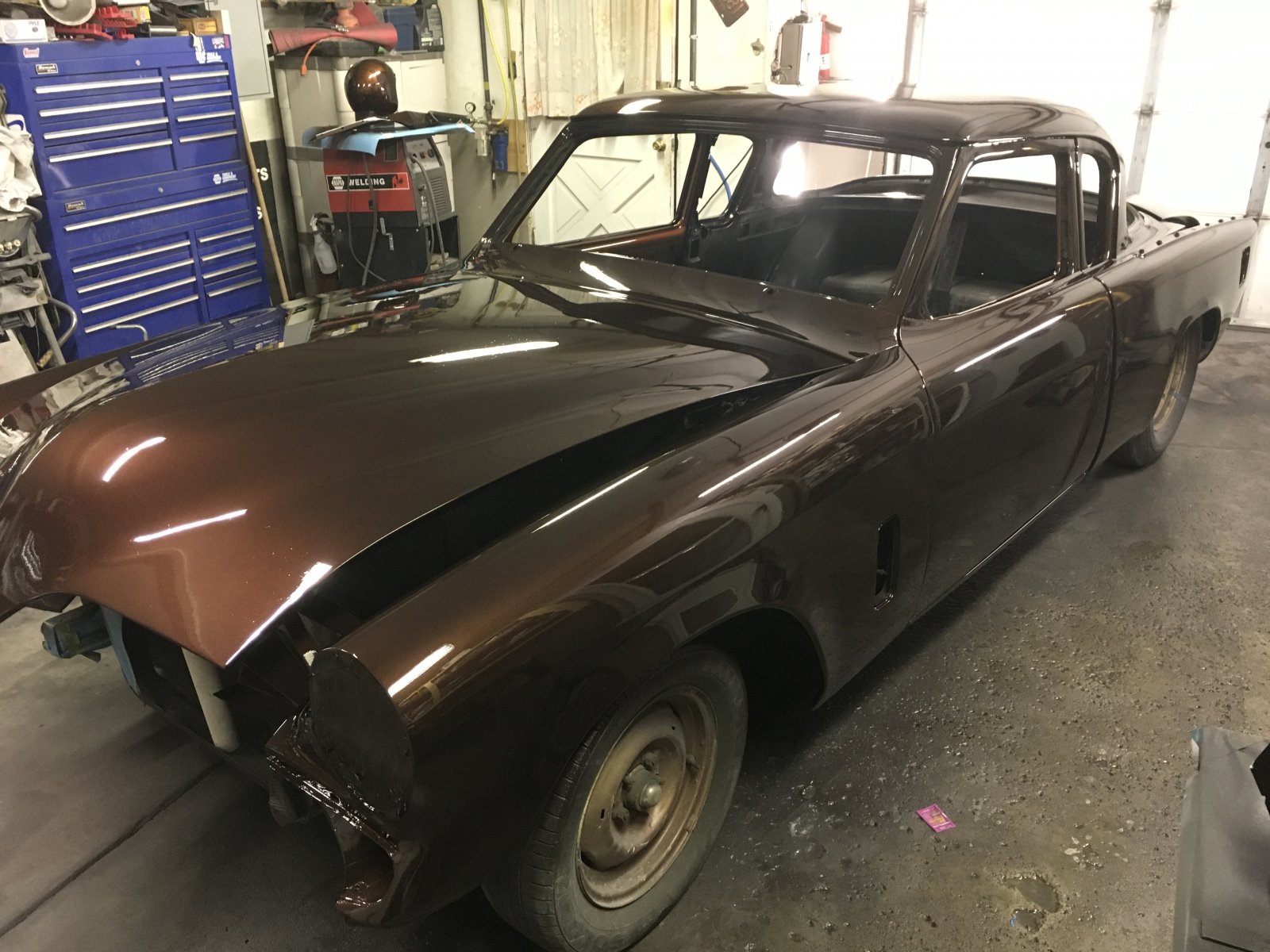

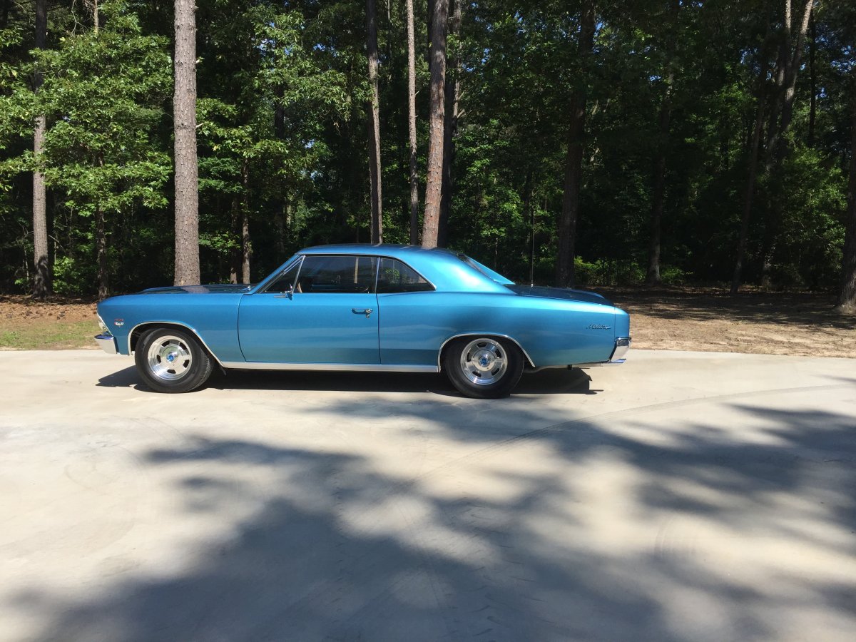

    I made a booth in my shop with filtered intake and exhaust. Never painted before. This was my first one and I was using a 3M accuspray gun with a 1.3mm tip. Valspar BC/CC. Hardly any orange peel and 1 minor run.
    Pre cut and buff
    After Cut and Buff
    My new project is a 52 F1 which I plan to do the same way. Cheers

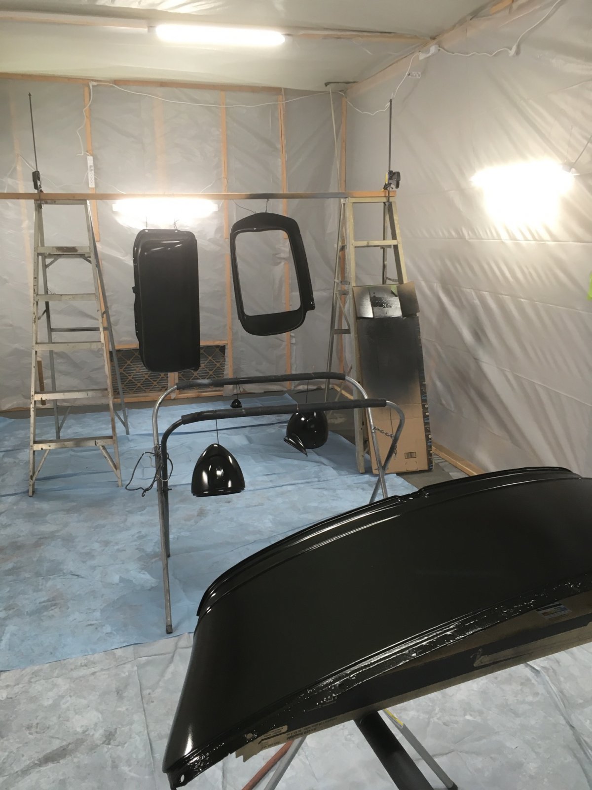

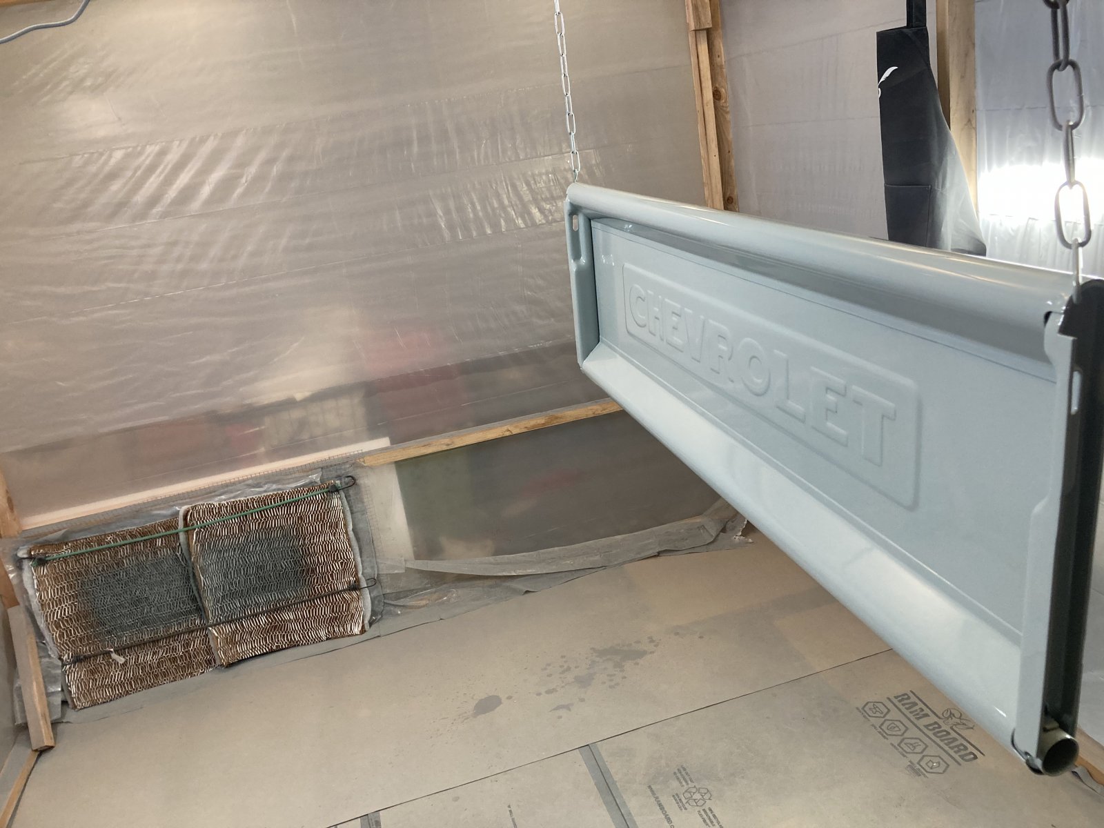

    Not finished yet, painting my 1950 Chevy truck in pieces in a homemade booth in my garage. The color is Mini Cooper ice blue (single stage) but for some reason it’s coming out with more of a green tint instead of blue. I like it though. I think the biggest challenge when doing this is determining when it’s “good enough”. I’m aiming for perfection which isn’t very realistic for a first attempt at painting but every flaw drives me nuts. I got the plans for this booth from this thread. :)

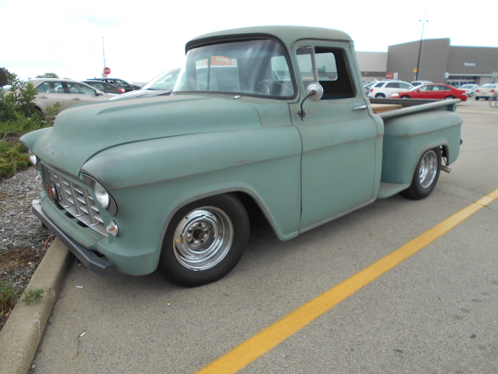

    painted this in my garage with a 3 dollar brush and a 8 dollar quart of Walmart house paint, scuffed the edges a bit,... 2 easy days of fun....

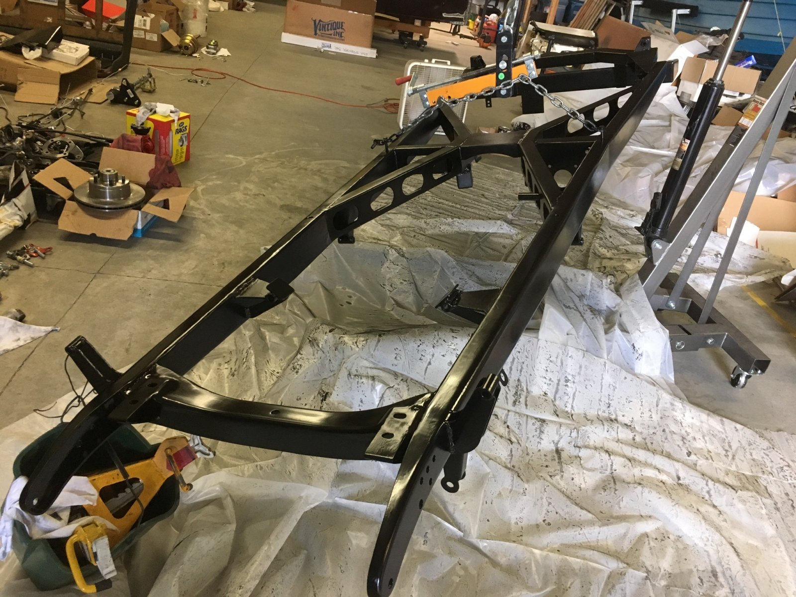

    Did all of my drivetrain.
    It's going on a different frame.

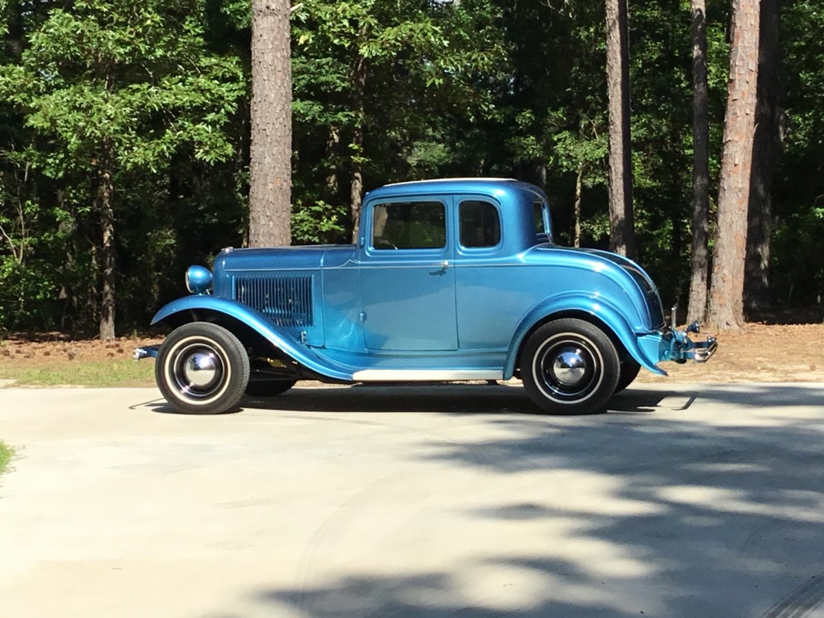

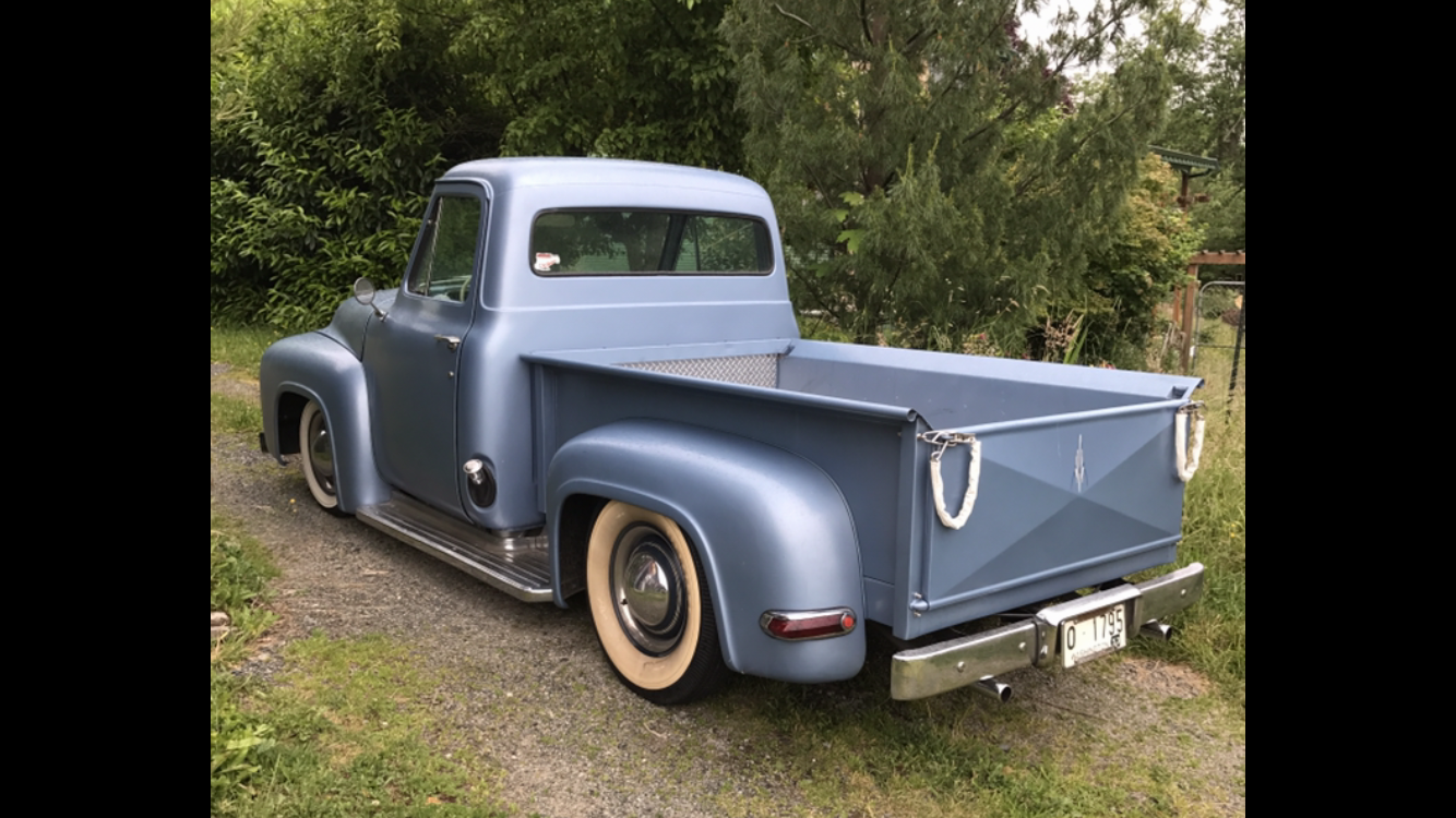

    I painted this in my gravel driveway with Rustoleum $30 a gallon EDD7A4DD-BD08-4442-A293-30EC623E89B4.png 4FED0E2B-B627-4B5F-BECF-DC9E333DE54D.png

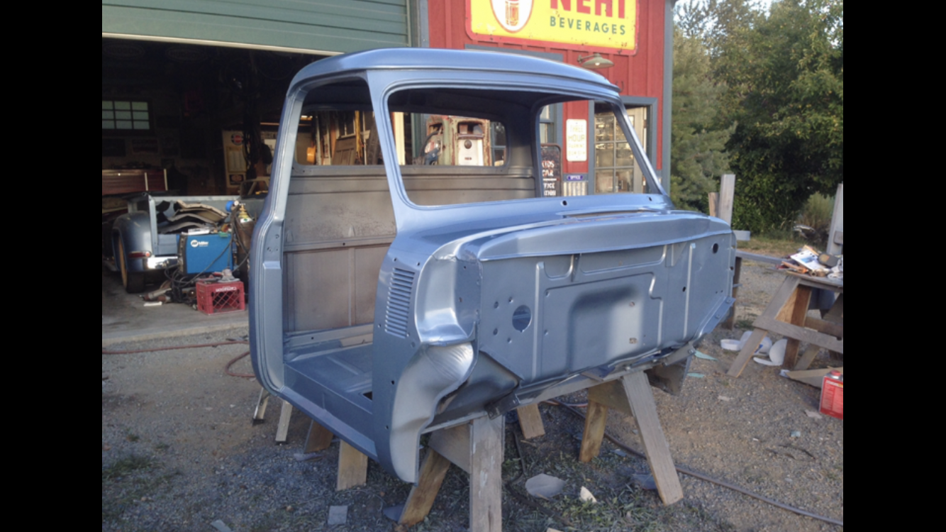

    IMG_20210719_140232879_HDR.jpg IMG_20210720_155726903_HDR.jpg IMG_20210718_171846168_HDR.jpg IMG_20210809_161945991.jpg painted my 36 in front of my barn under a canopy...

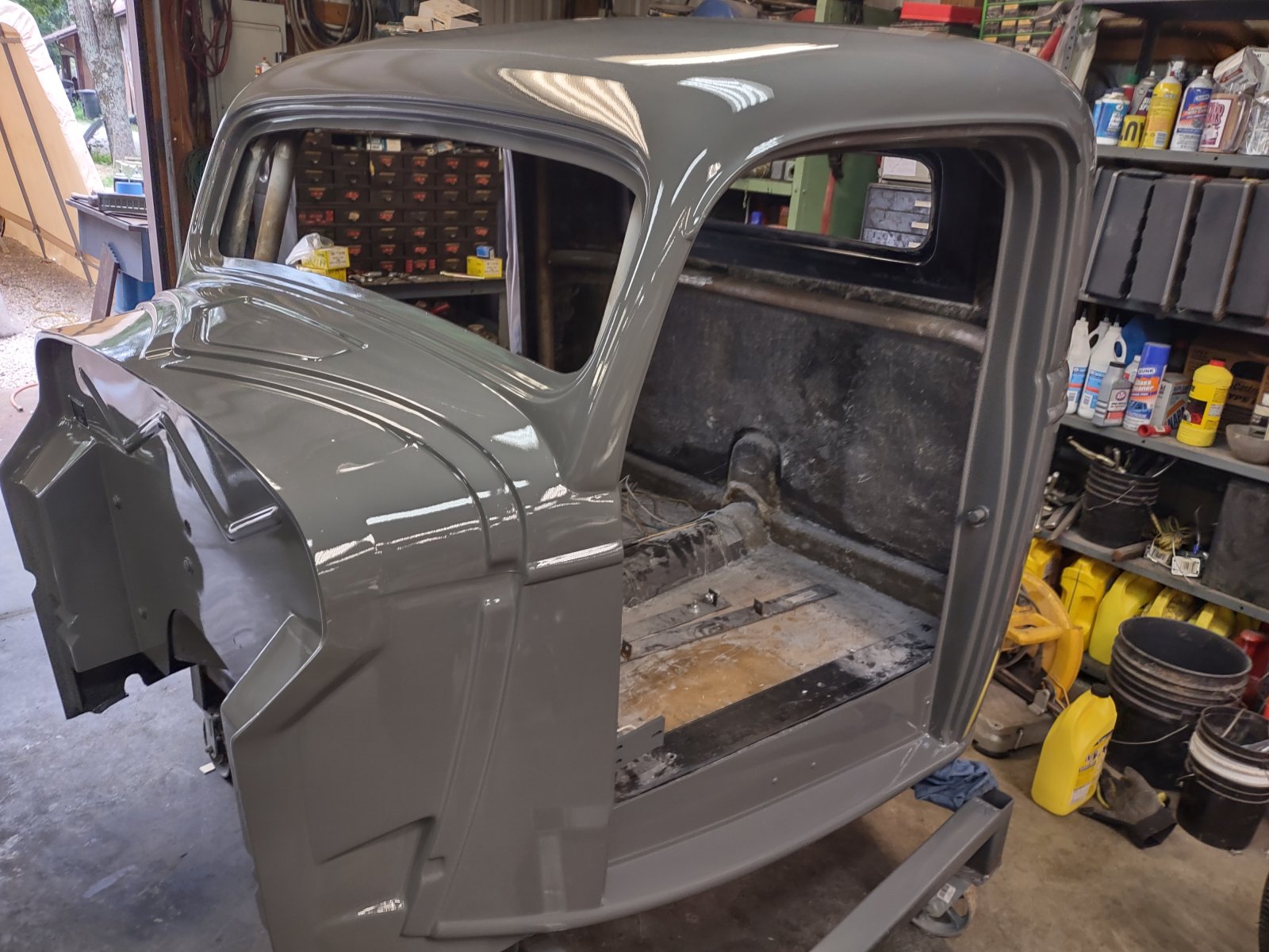

    Never painted a whole car before my recent one. I painted the occasional hood, or 1/4 panel, etc. and the results were somewhat mixed. Never horrible, but sometimes ending less than I hoped for.
    Last year I got to the point I wanted to get paint on my '39 Chev project. Of course I first tried to find someone who did it cheap at home or their own shop, but nothing came up. Then I tried to find someone who'd rent a paint booth and allow me to use it for a couple days to paint my '39. Nothing worked there either.
    I finally decided to attempt painting it in my tiny 10'x20' shop where it was built. Barely enough room to step back from the car, and no windows to open, so had to crack the rear barn doors enough to set a box fan in the opening, and block above that with clear plastic to exhaust the fumes.
    To my surprise it actually came out much better than I expected, and although not show quality, I felt it was plenty good enough for my build.

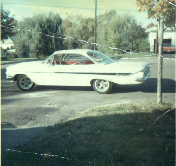

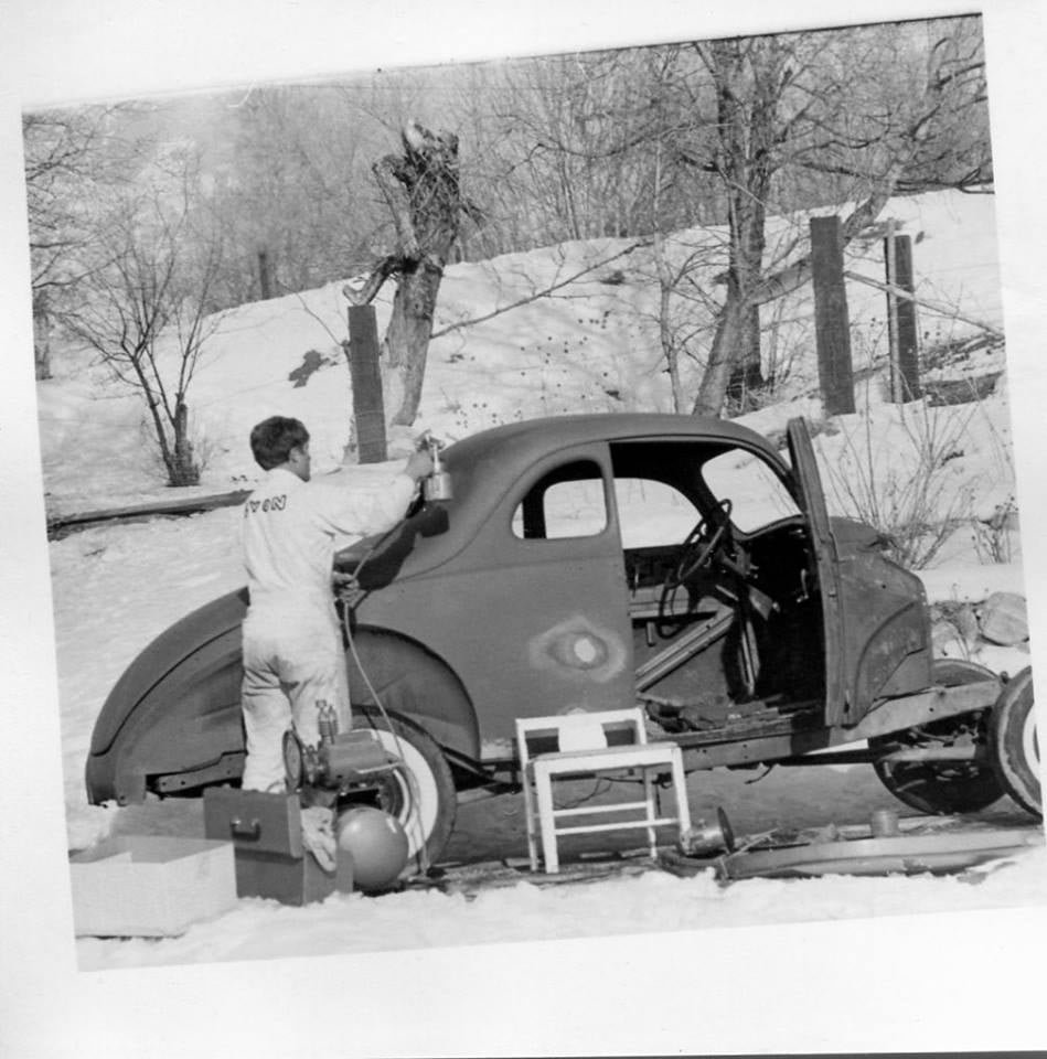

  24. Painted my '40 coupe in a gas station bay (1961), nitro-lacquer, my '61 Chev in my folks driveway (1965), acrylic lacquer........old pix don't show the high quality finish.....

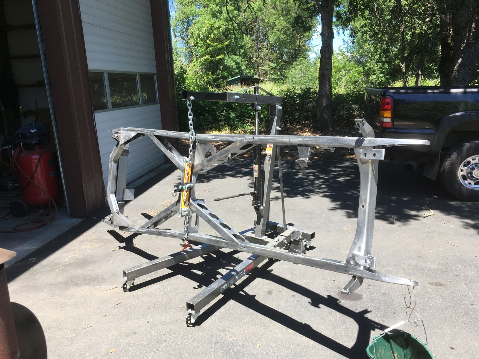

    I painted ch***is and suspension parts over a tarp in the shop. I used rattle can Eastwood Extreme Ch***is Black; it covered well and after a couple years and 2500 miles is holding up well. That paint has a lot of solids and they drift far and wide while spraying.
    John

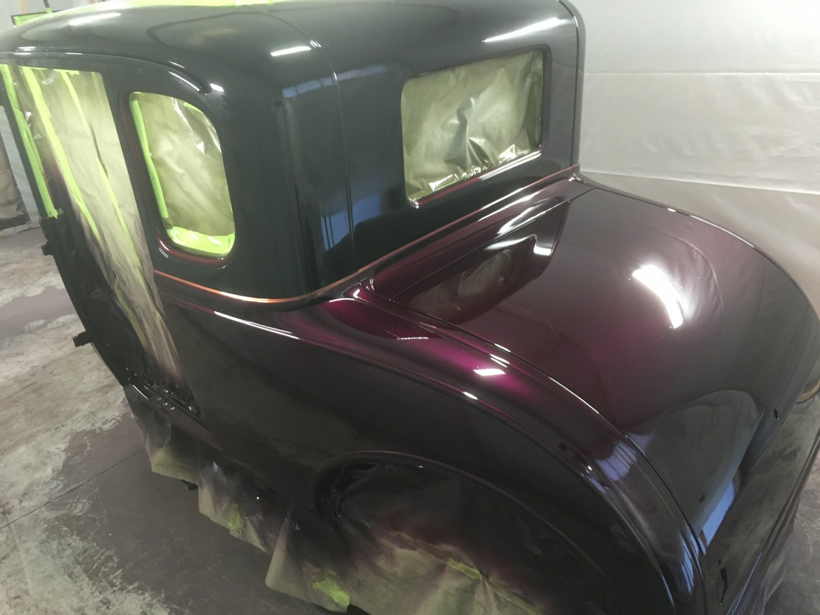

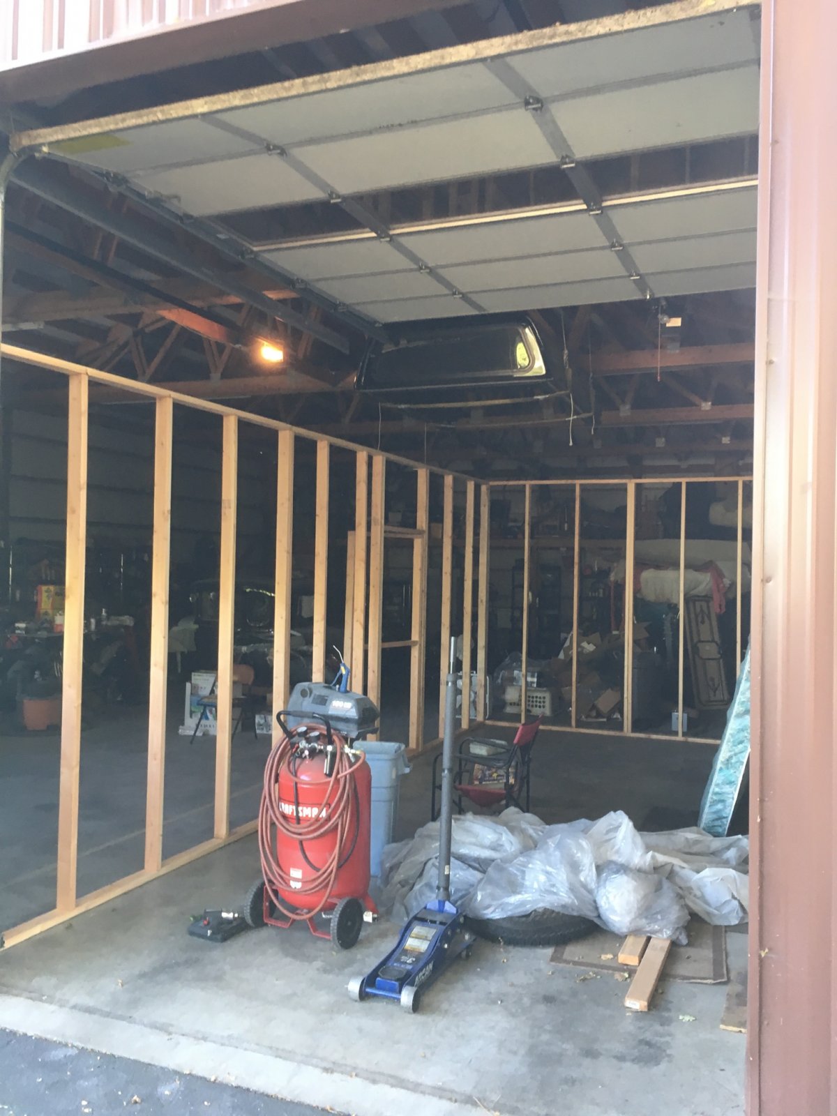

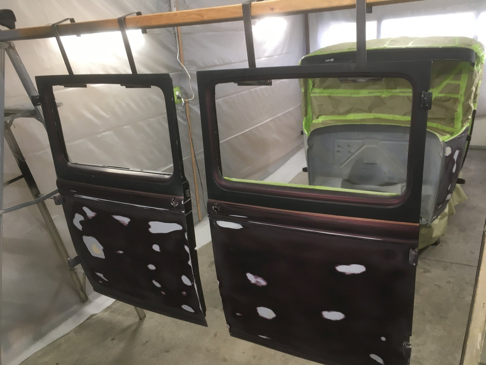

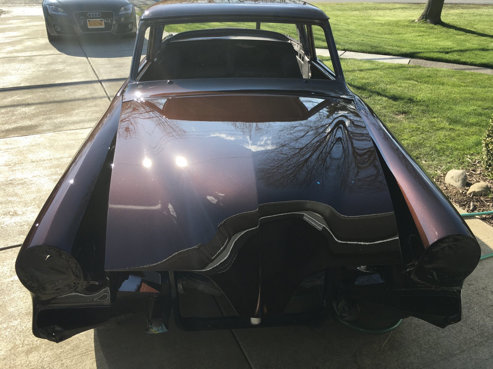

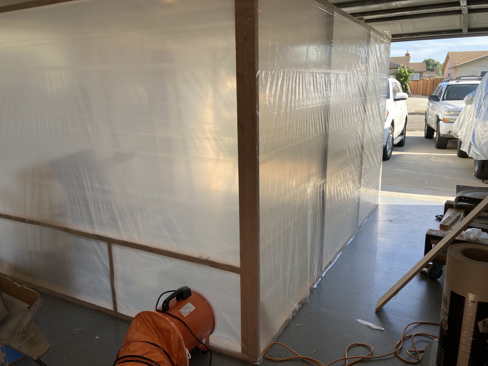

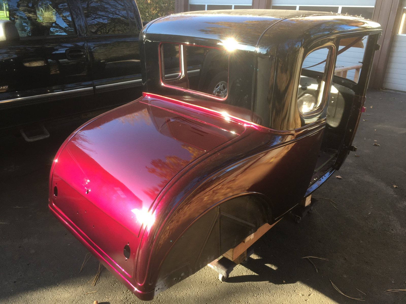

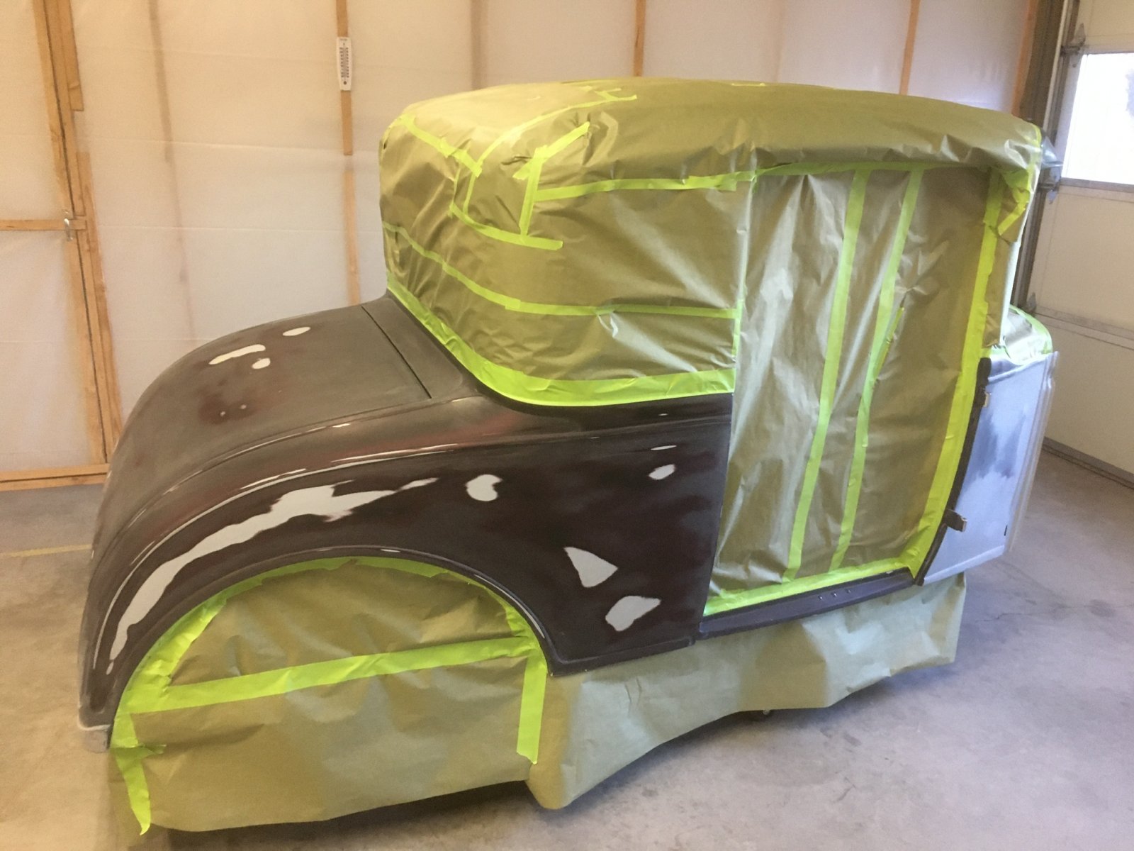

    I painted a Model A body and ***ociated parts in a home-made spray booth that ran me about $300 in parts and some time. Two box fans blowing through furnace filters for air in and one pulling through a filter for air out. After several sessions I think sparing air in and relying mostly on exhaust air worked best.
    In the end I probably could have rented a real booth once for the same cost, but I’ve done several projects in mine, so it works out.
    Paint: House of Kolor Wild Cherry Kandy Base over their Shimron Black ground coat which was over their sealer. DuPont Chromabase clear.
    Spray Gun: Eastwood Concourse 2 (about $200).
    Air source: Craftsman 30-gal 150 psi compressor (worked, but loud and barely kept up)
    Results: A friend did most of the painting, as I had no experience (I did the black ground coat). I did the cut-and-buff. Lots of nibs to deal with, but came out very nice.
    The process was a re-paint over a candy that a previous owner had sanded through and had other defects due to some body mods of my own.
    The booth pictures don’t show the ceiling and one side wall. The garage door closes over the knee wall with the exhaust filter in it.
