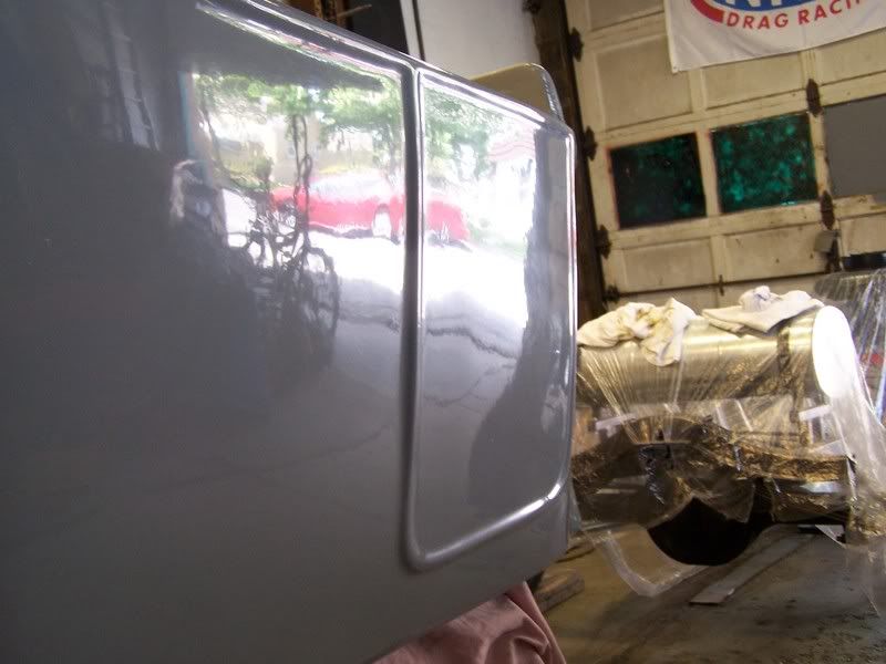

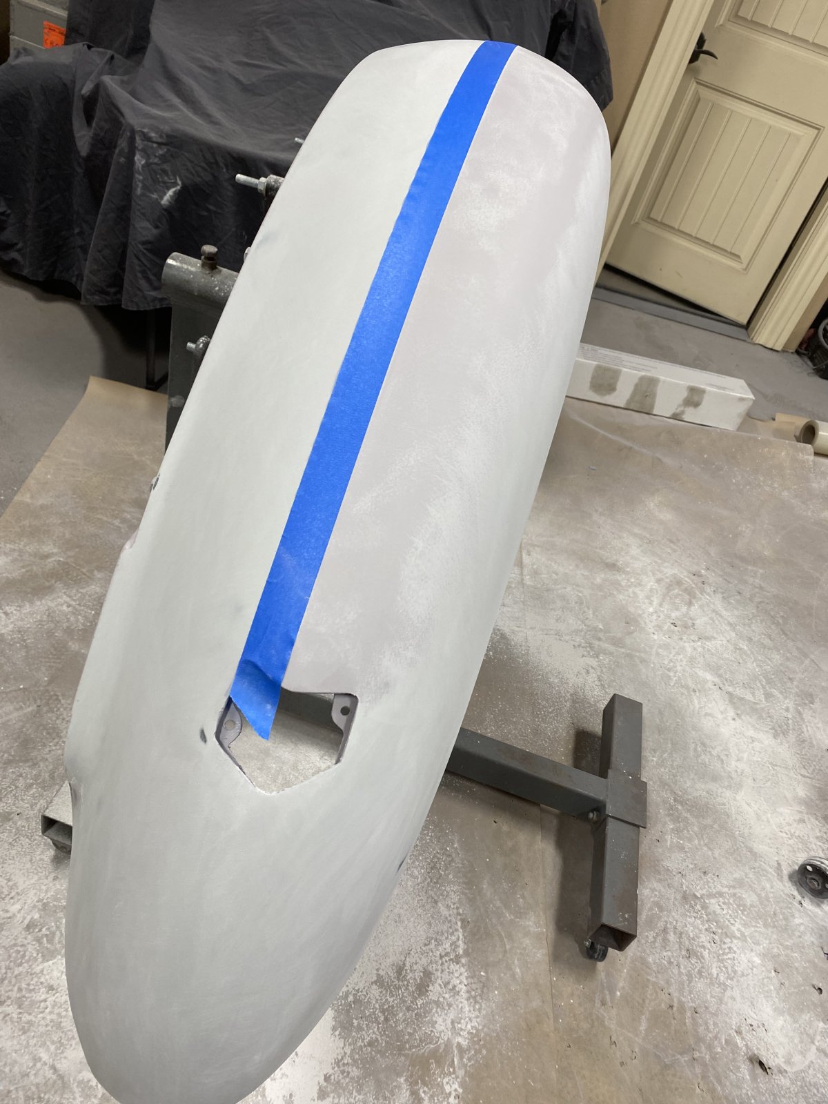

    Thanks for noticing. They are peaked form the factory but a lot of body guys primer and block the peak away. I taped the peak on one side, block sanded up to the tape, removed it and taped the other side of the peak and repeated the process. Then give the peak a little knock down so it isn't too sharp. I do the same on 69 Camaros to keep those fender lines crisp and not rounded.

    Pics from the way back machine

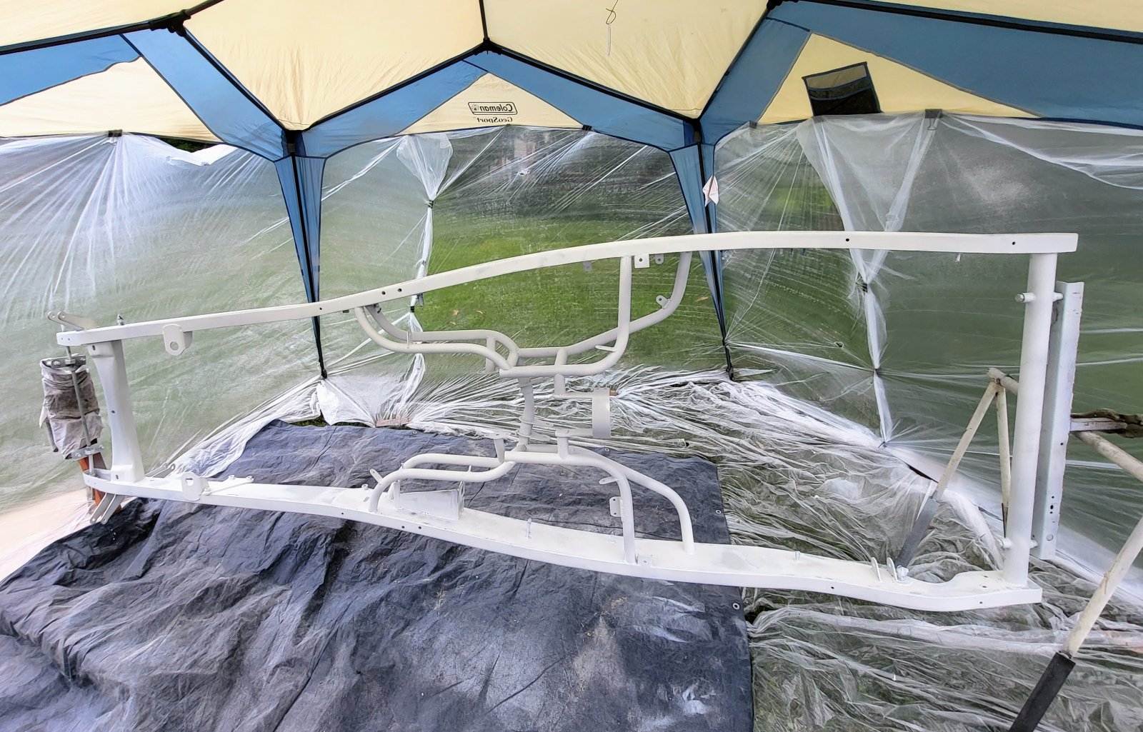

    Epoxy primer in a no-longer-used-for-camping 12'x14' picnic canopy.:cool:

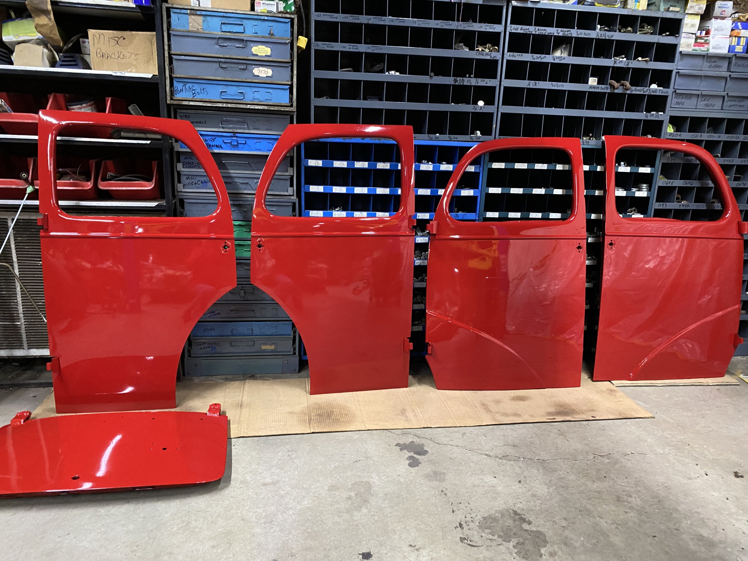

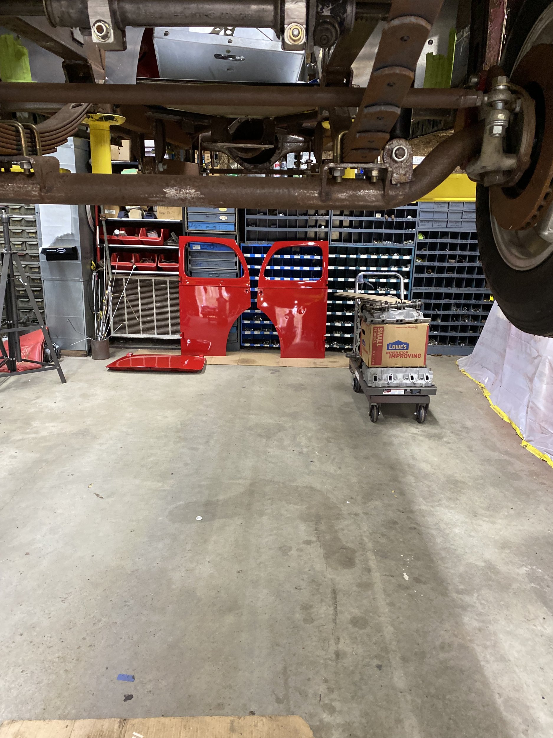

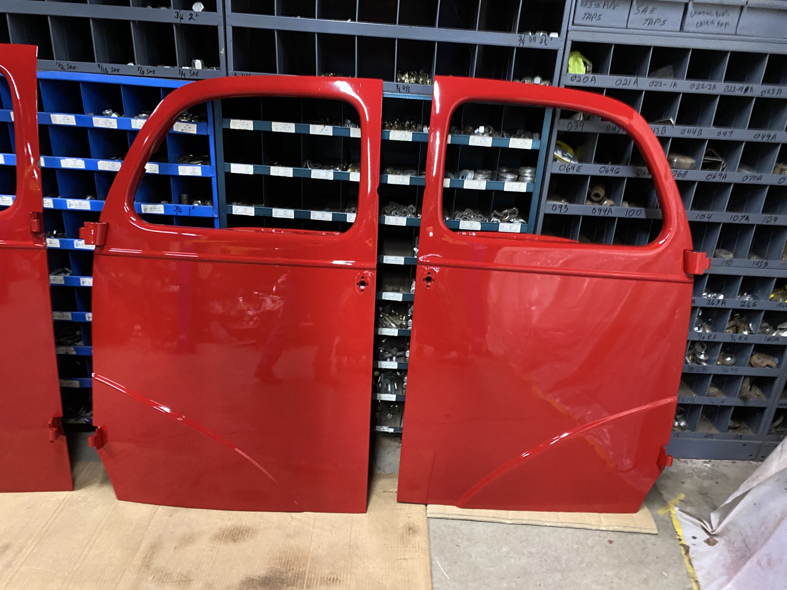

    Both of these (heck, ALL my cars) painted in the shop. C12754B7-B21E-4094-924A-D449E5135A01.jpeg

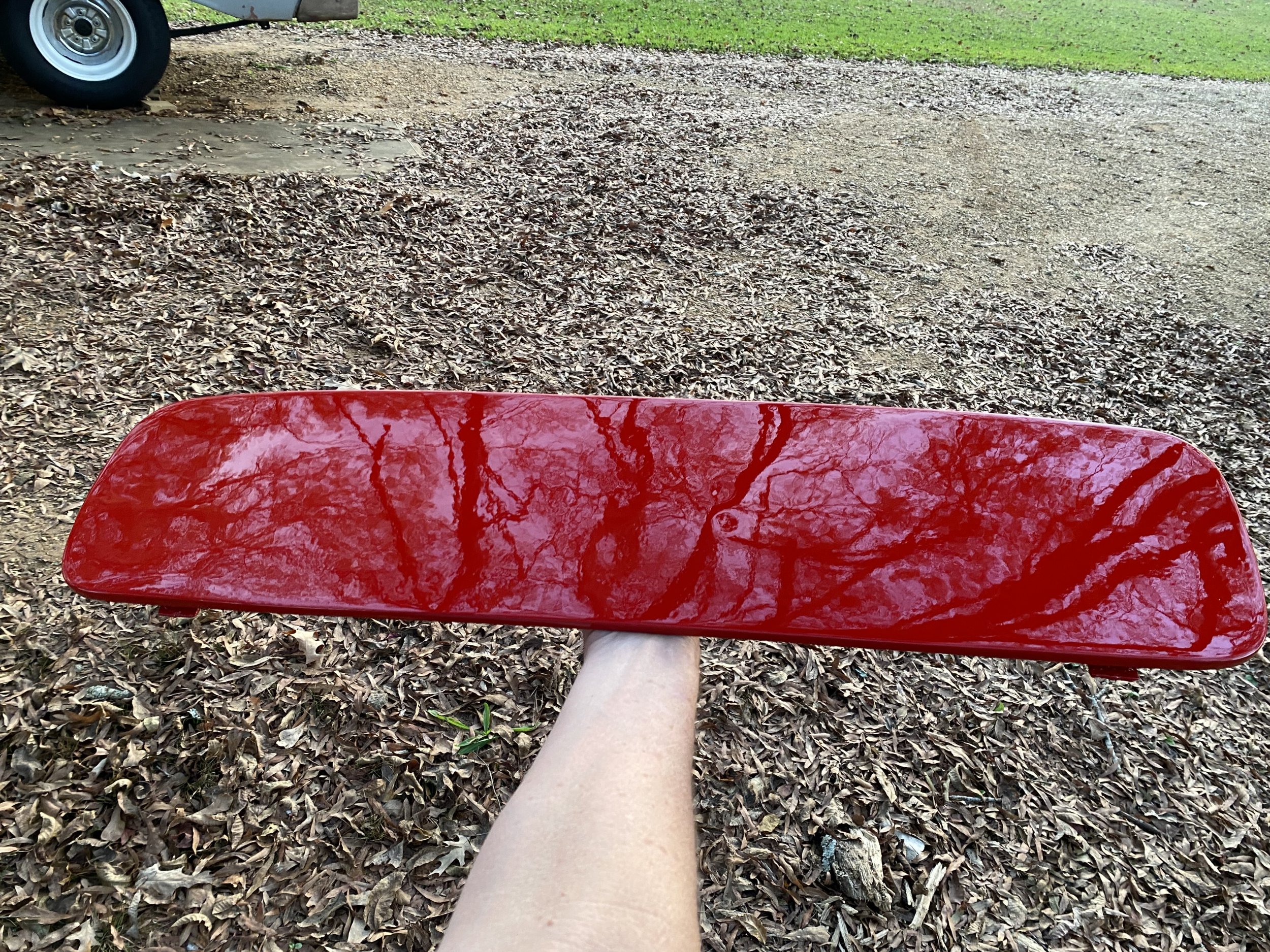

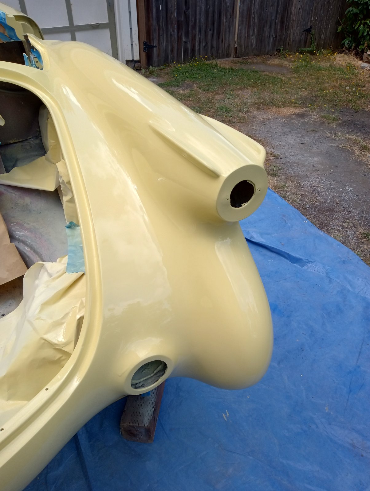

    Couple of bugs and dust but it's single stage and will buff out. IMG_20240816_104208441.jpg IMG_20240816_104133588_HDR.jpg IMG_20240808_192408951.jpg

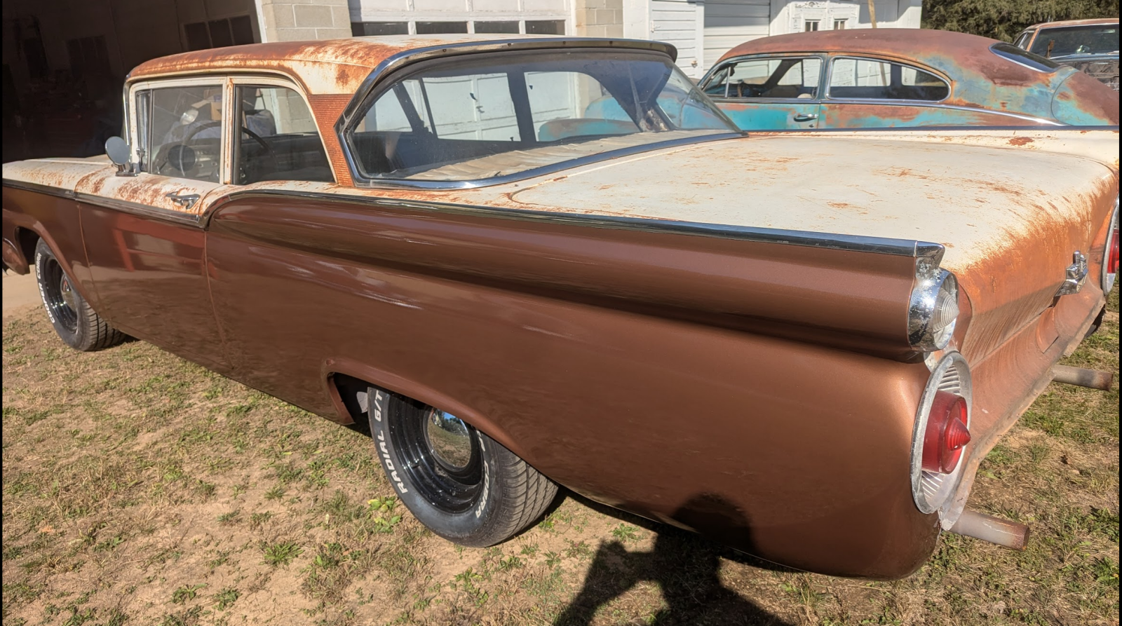

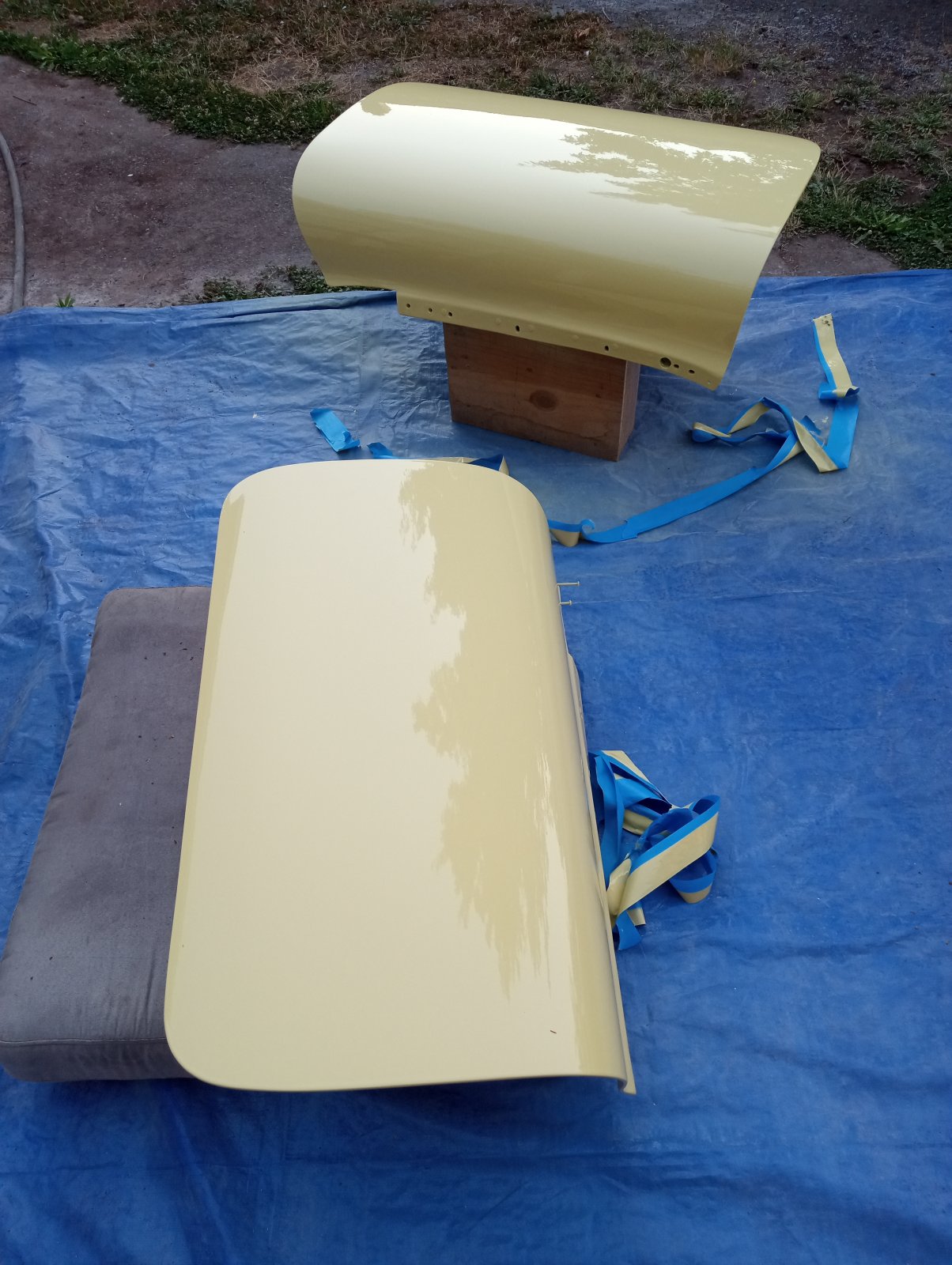

    Well, they don't always work out. I did this one last year. Mixed a bunch of old lacquer together (brown), taped off the scallops, then painted the really cheap eBay "Hot Rod" satin black enamel over it. Should have worked, but the black was coming off in sheets. Took most of it off with a razor blade. Take 2. Found some nice-looking Dark Saddle acrylic enamel on the bottom shelf in my shop. Says it was mixed in 1985 on the label. That'll work. Looks better brown anyway. He wanted the scallops back on, but I need to work on my stuff.

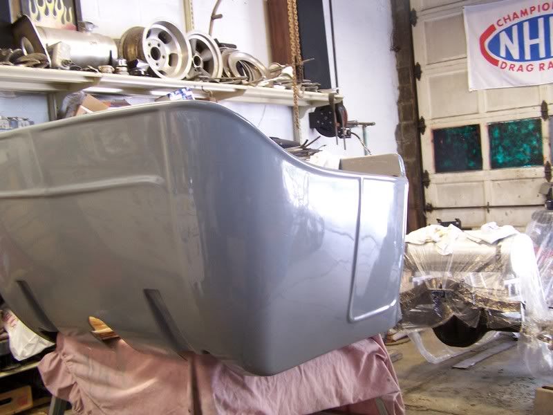

    I used Rustoleum and a roller to paint the t-bucket
    And the Henry J
    Both are holding up really well

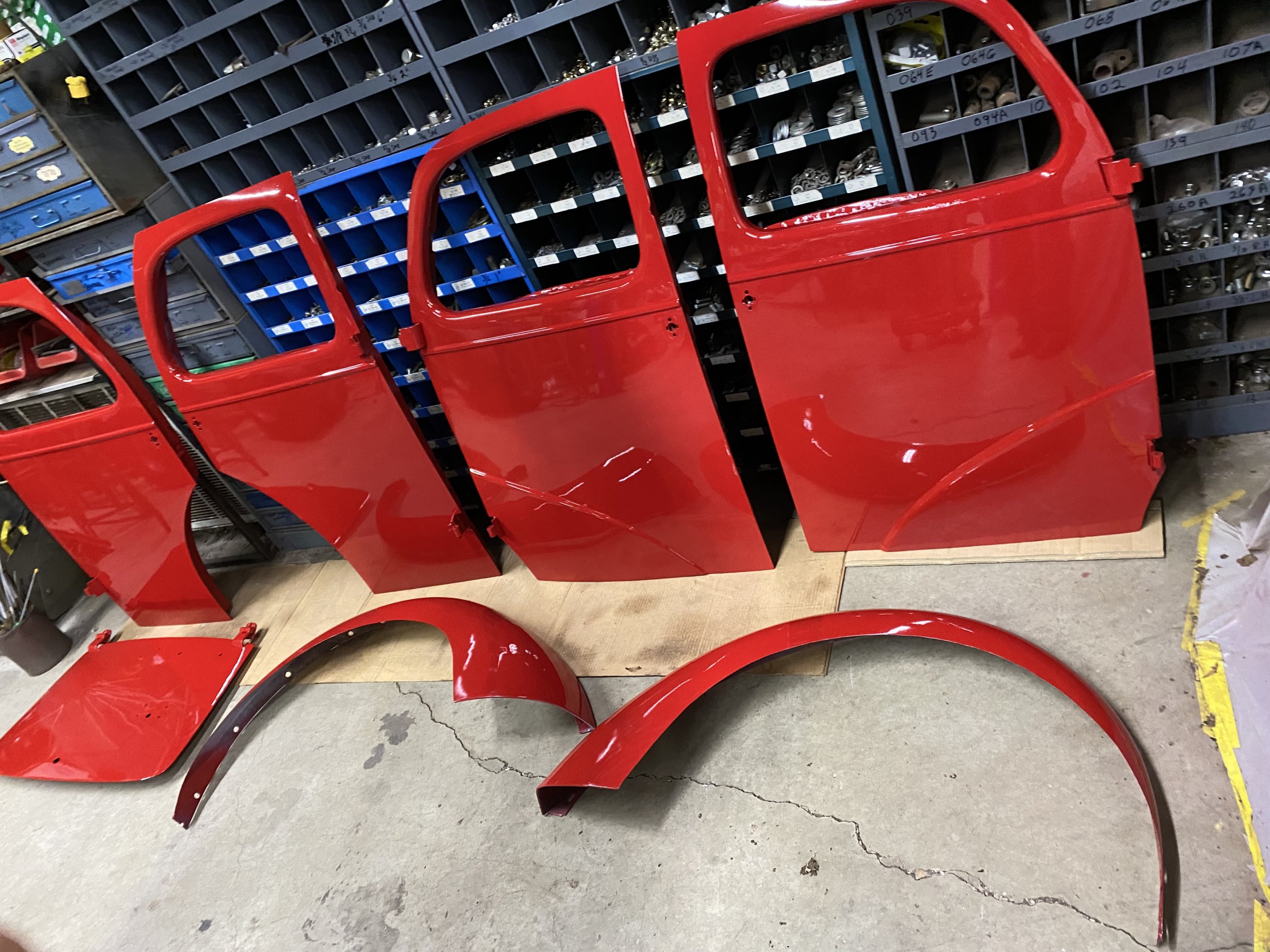

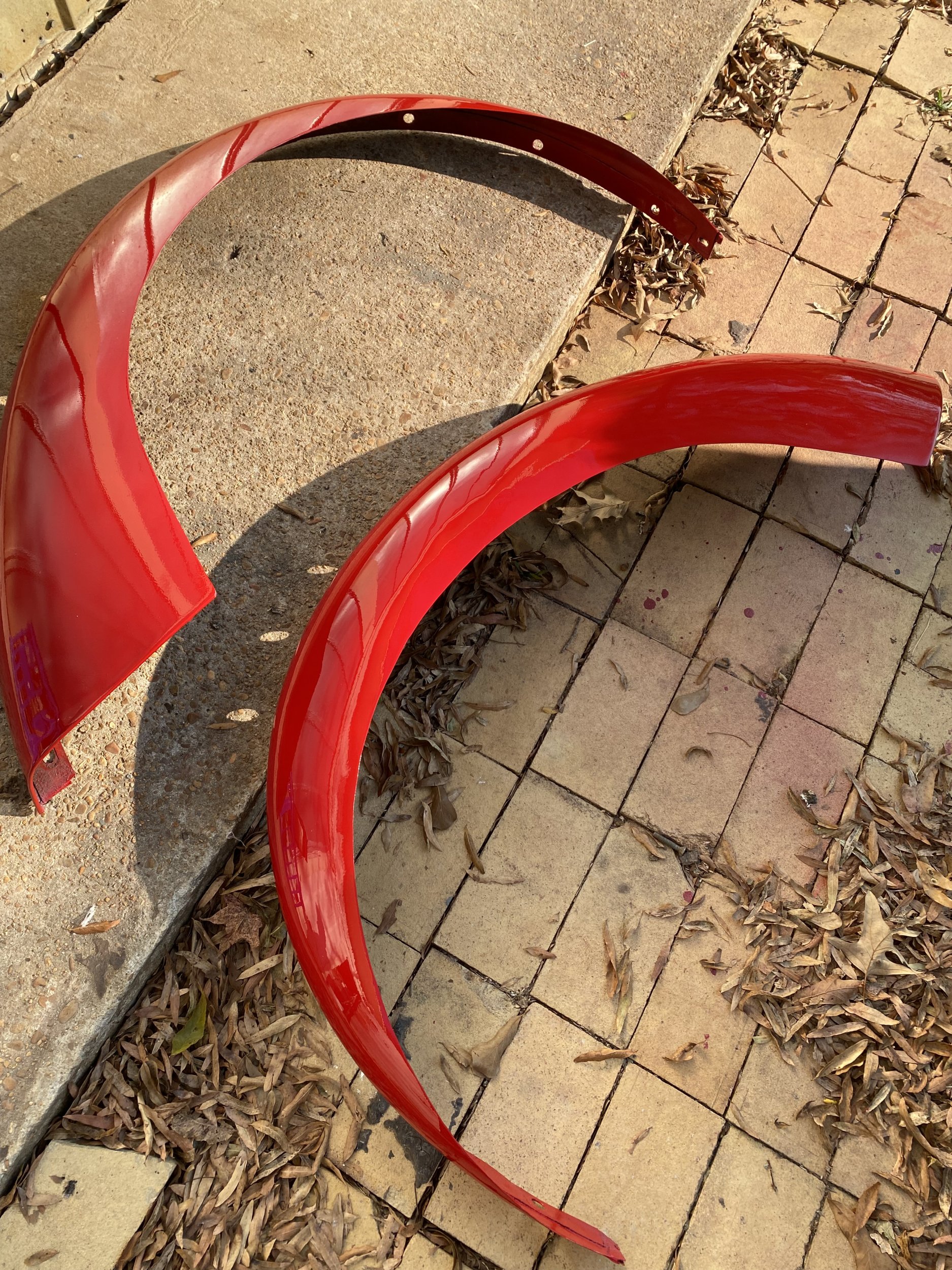

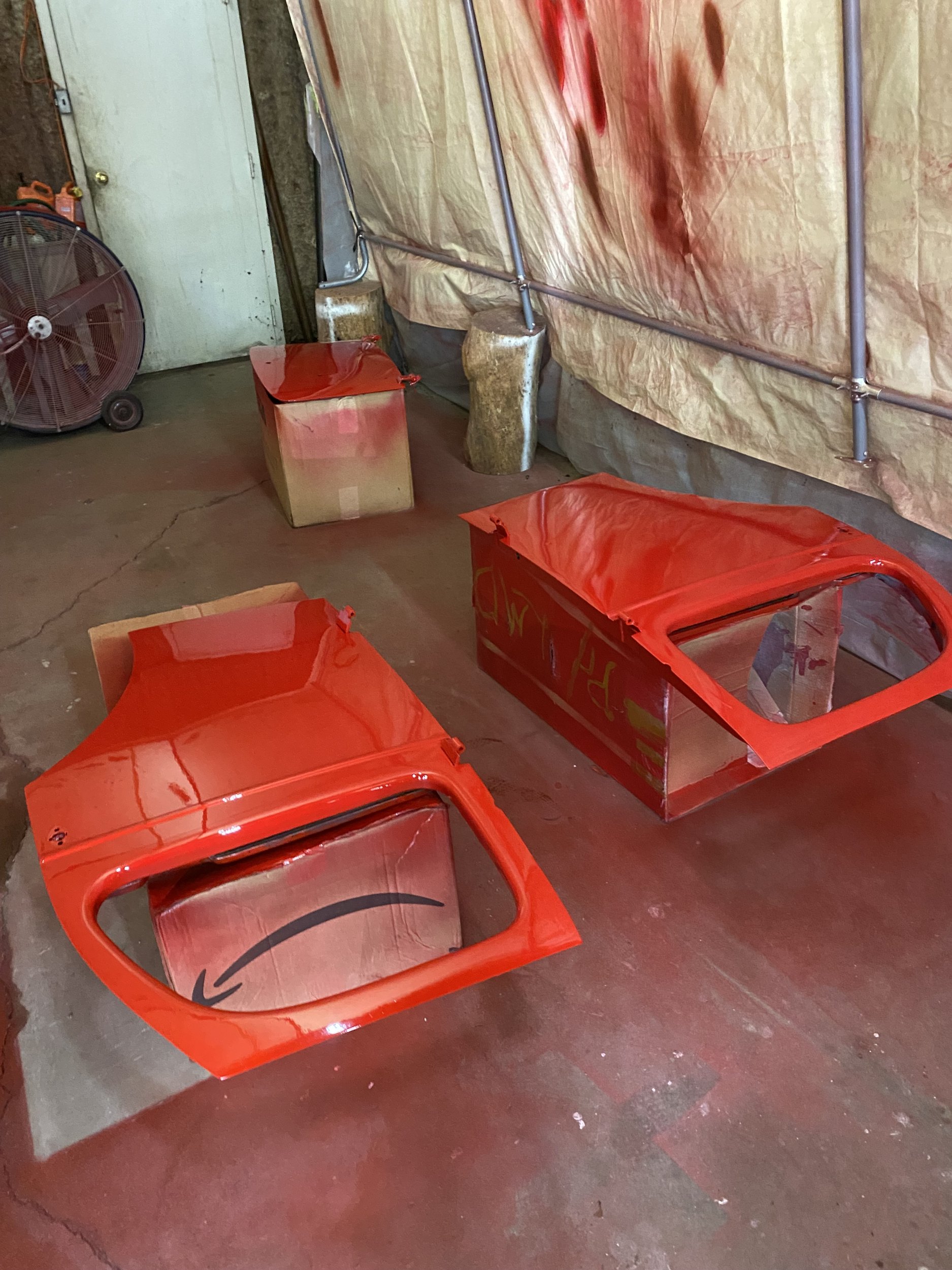

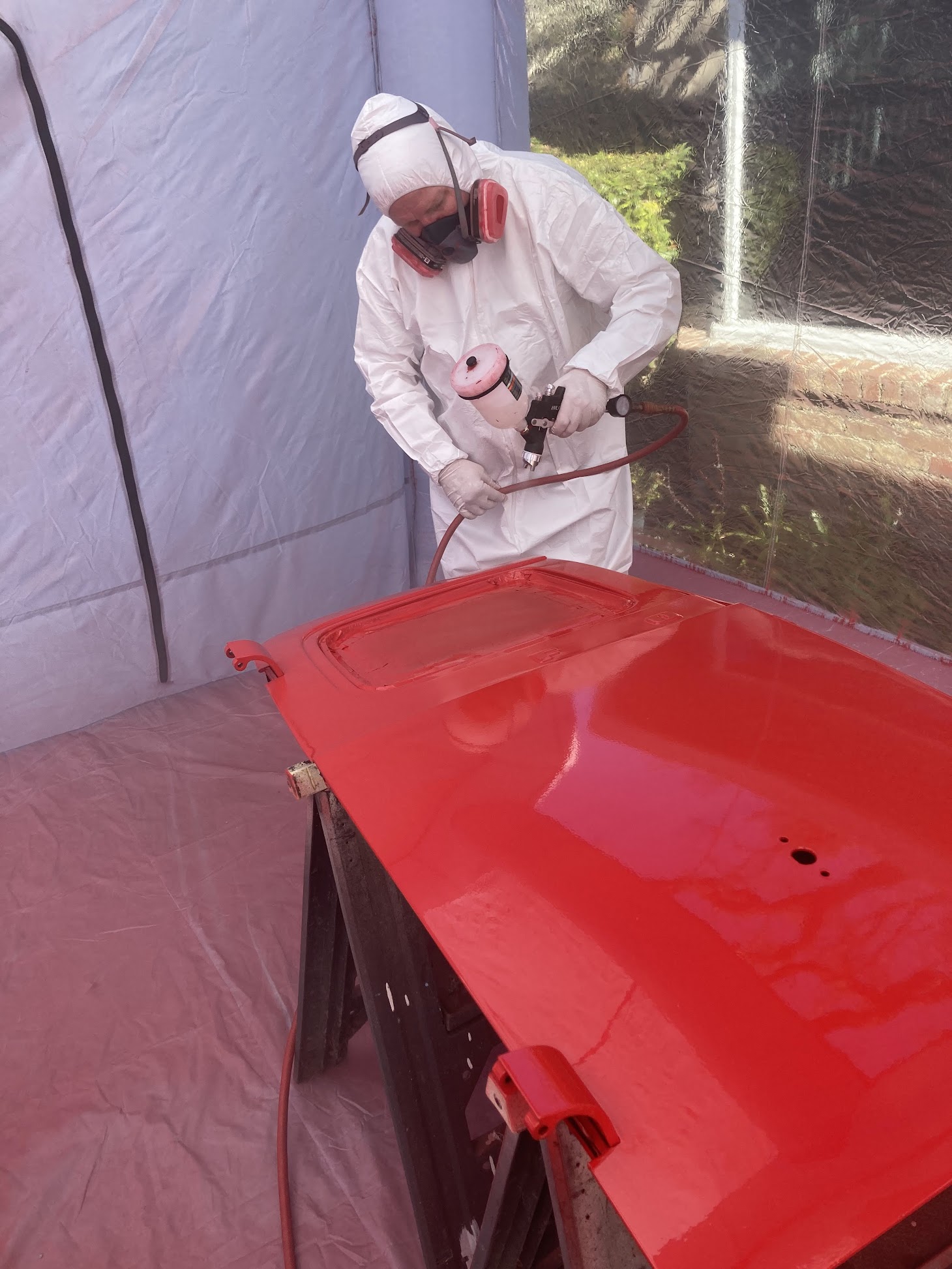

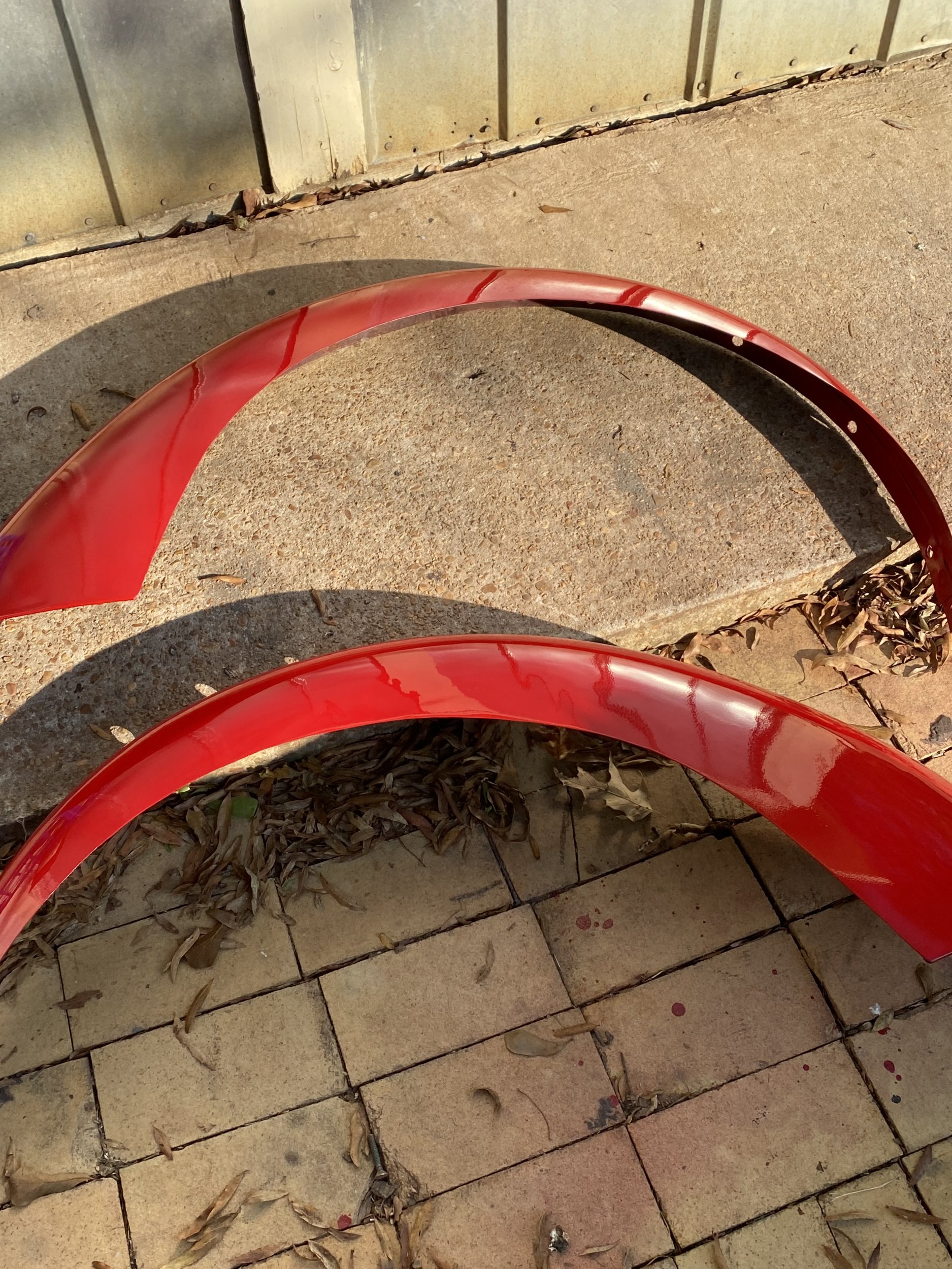

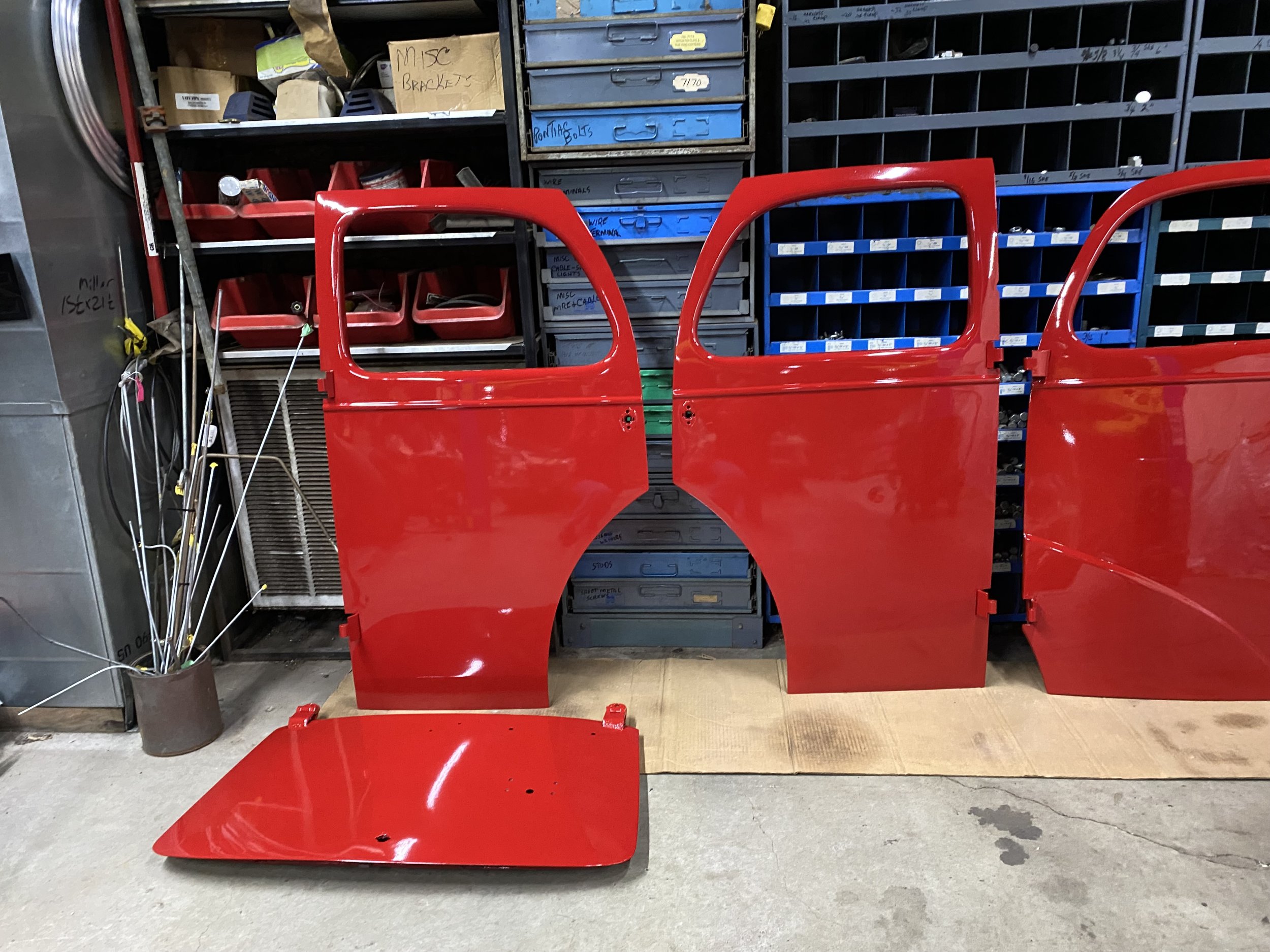

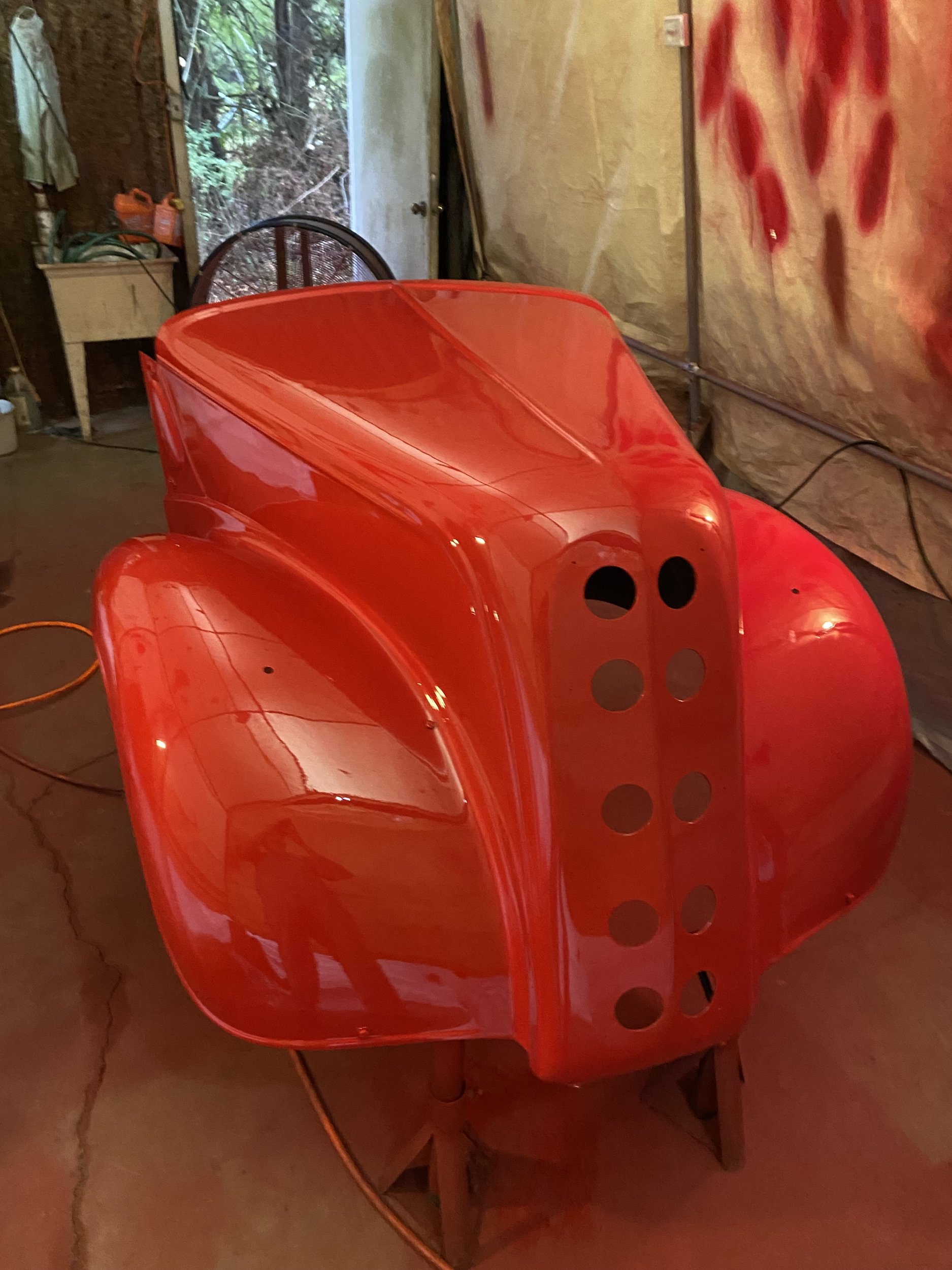

    Funny that I just found this thread. Used a portable car port from HF as a paint booth. IMG_3130.jpeg IMG_3135.jpeg IMG_3133.jpeg IMG_3137.jpeg IMG_3138.jpeg IMG_3150.jpeg IMG_3163.jpeg IMG_3164.jpeg IMG_3165.jpeg IMG_3166.jpeg IMG_3169.jpeg IMG_3168.jpeg IMG_3170.jpeg IMG_3193.jpeg IMG_3192.jpeg

    Cool... let's see 'em installed!

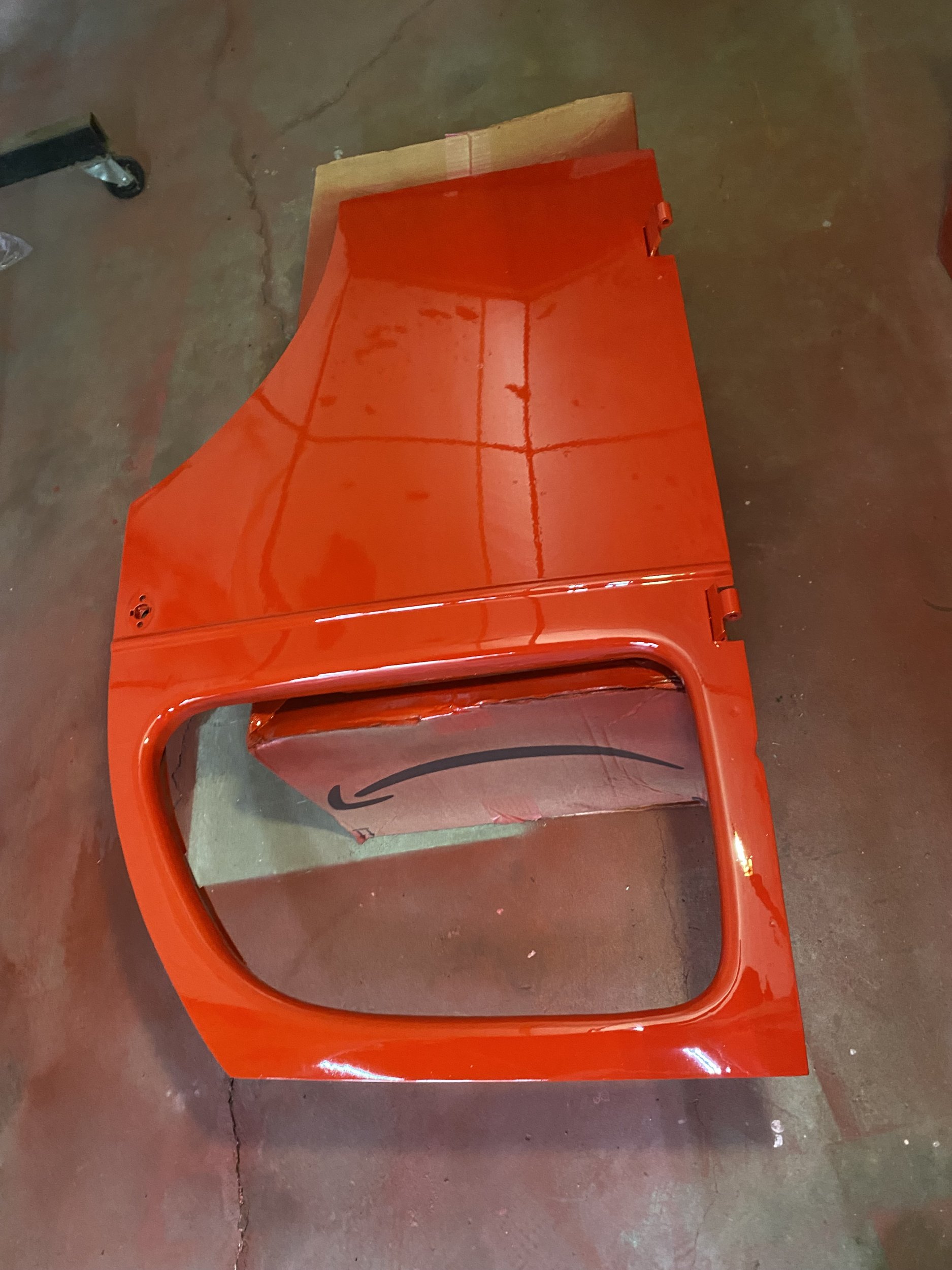

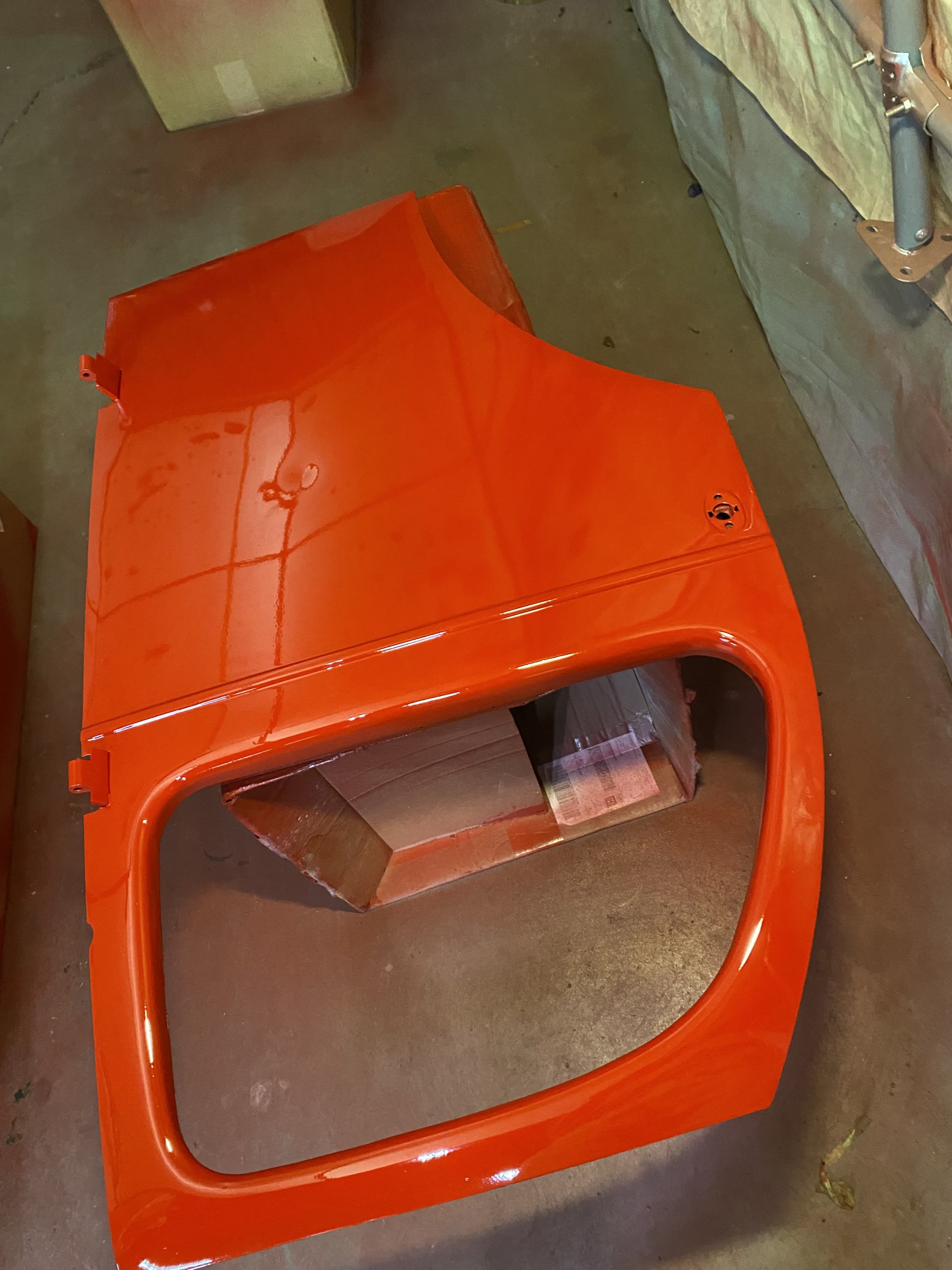

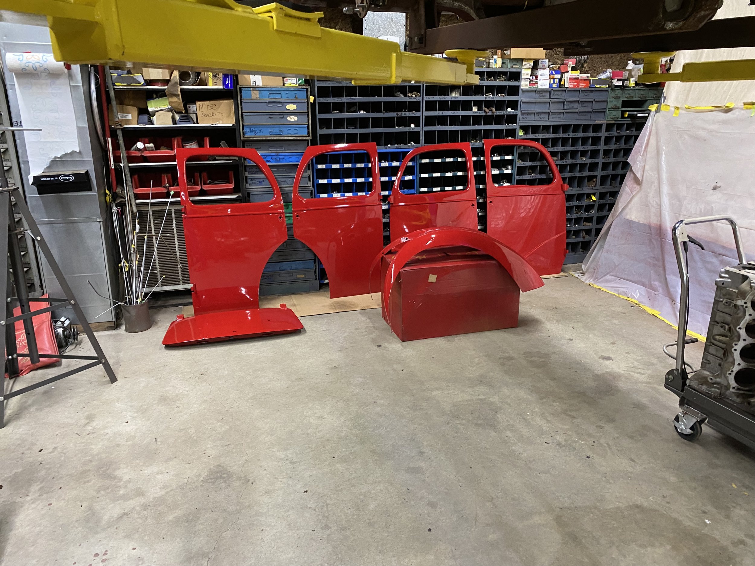

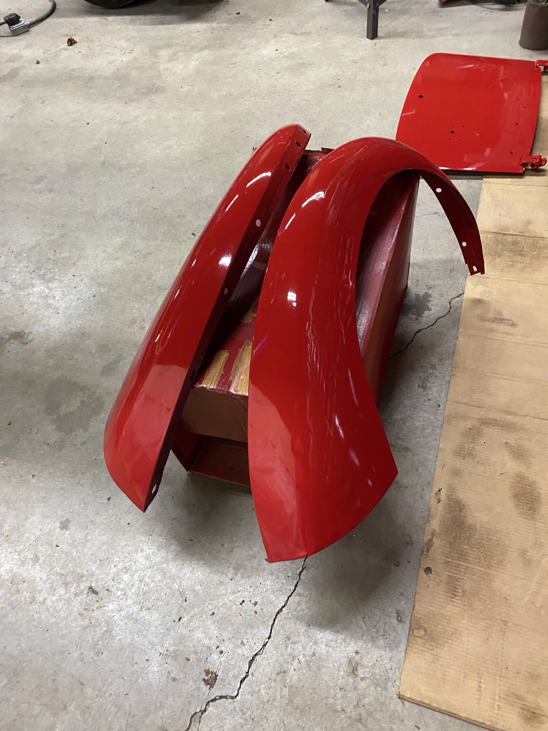

    IMG_3197.jpeg IMG_3198.jpeg IMG_3199.jpeg IMG_3200.jpeg IMG_3201.jpeg IMG_3202.jpeg Gonna hope to be through buy Christmas. Lol

    This front cap will be a pain. Many compound curves back to back.

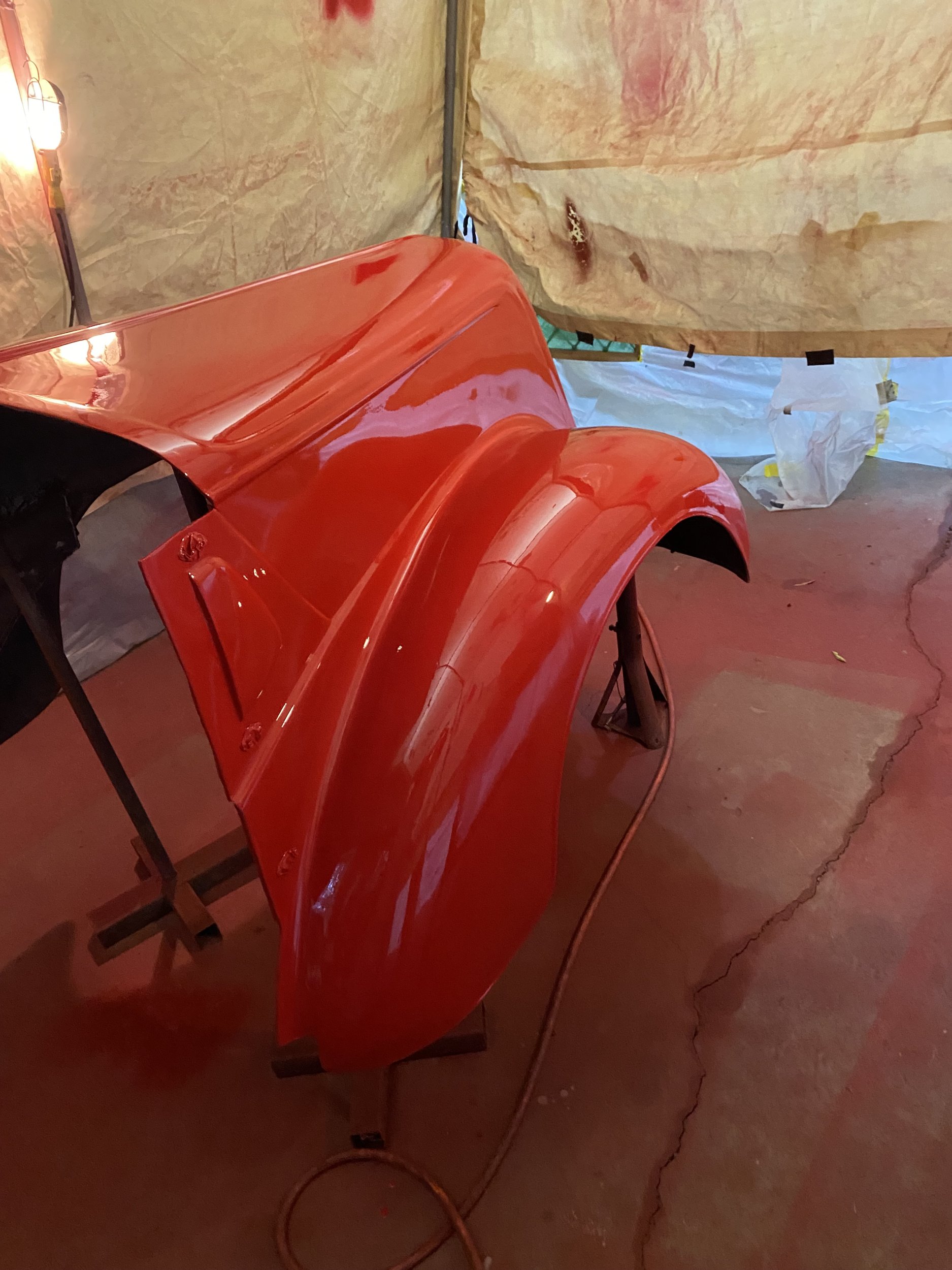

  23. Work In Progress
    Joined: Dec 14, 2010
    Posts: 199
    Work In Progress

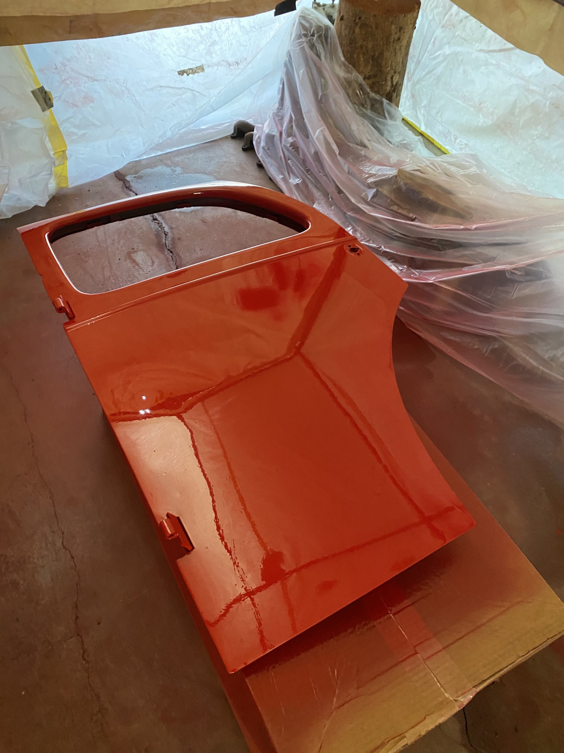

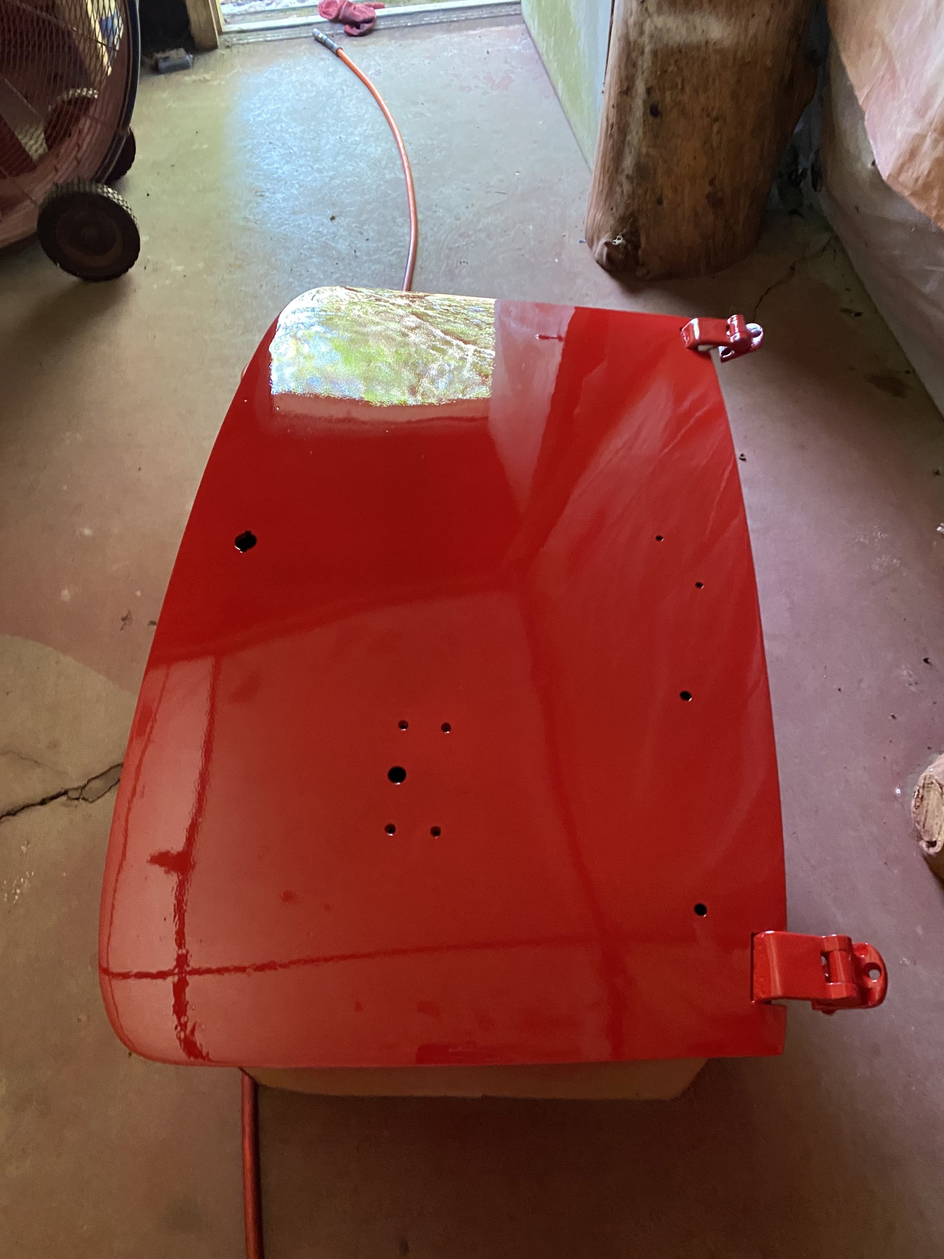

    I used a blow up booth and painted my panel. Came out pretty good

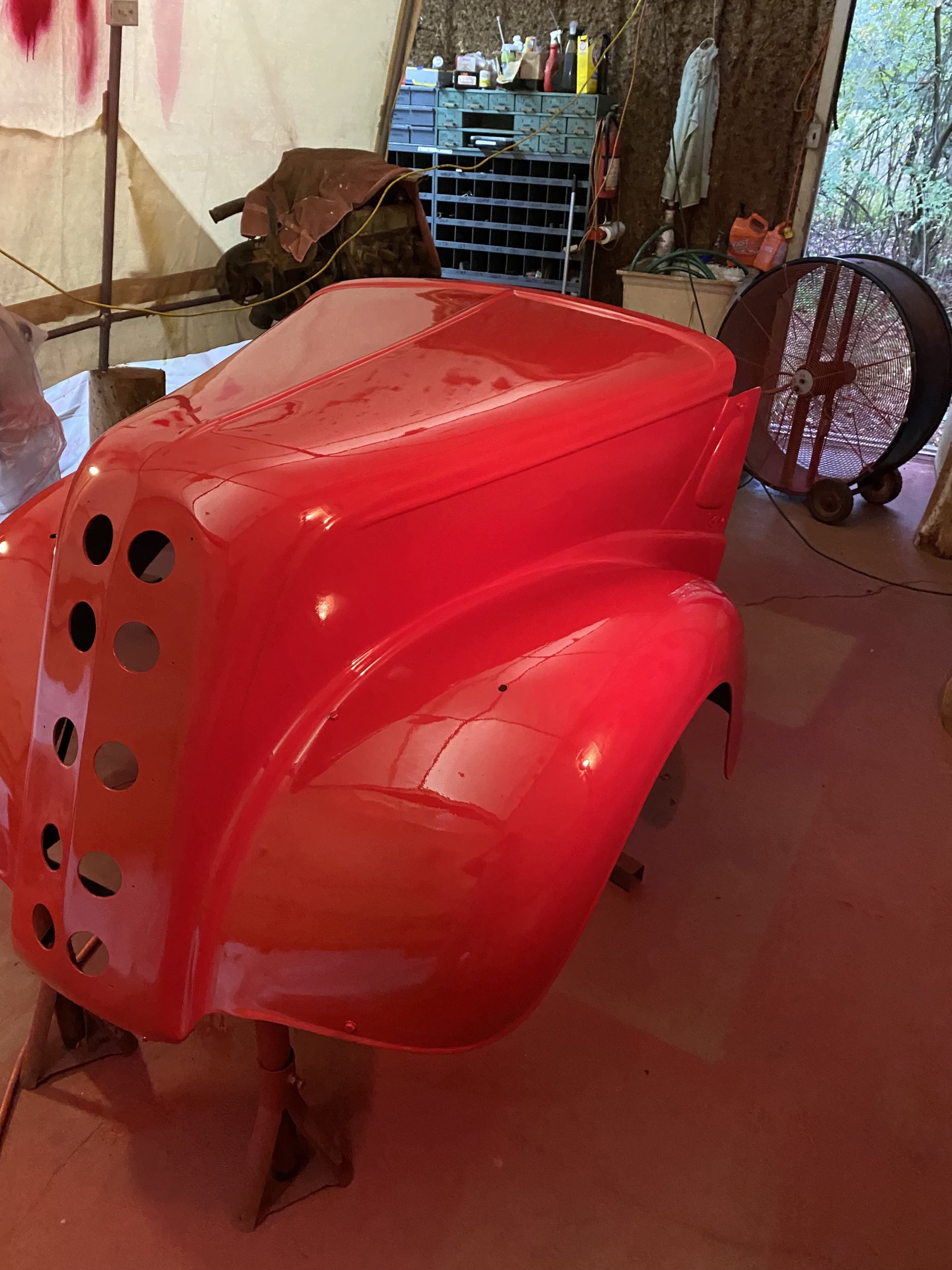

    I love the fact that you get to use natural light which is so important to me. Nothing is as good as natural lighting. Todays work. Down to the front cap. Then the main body.

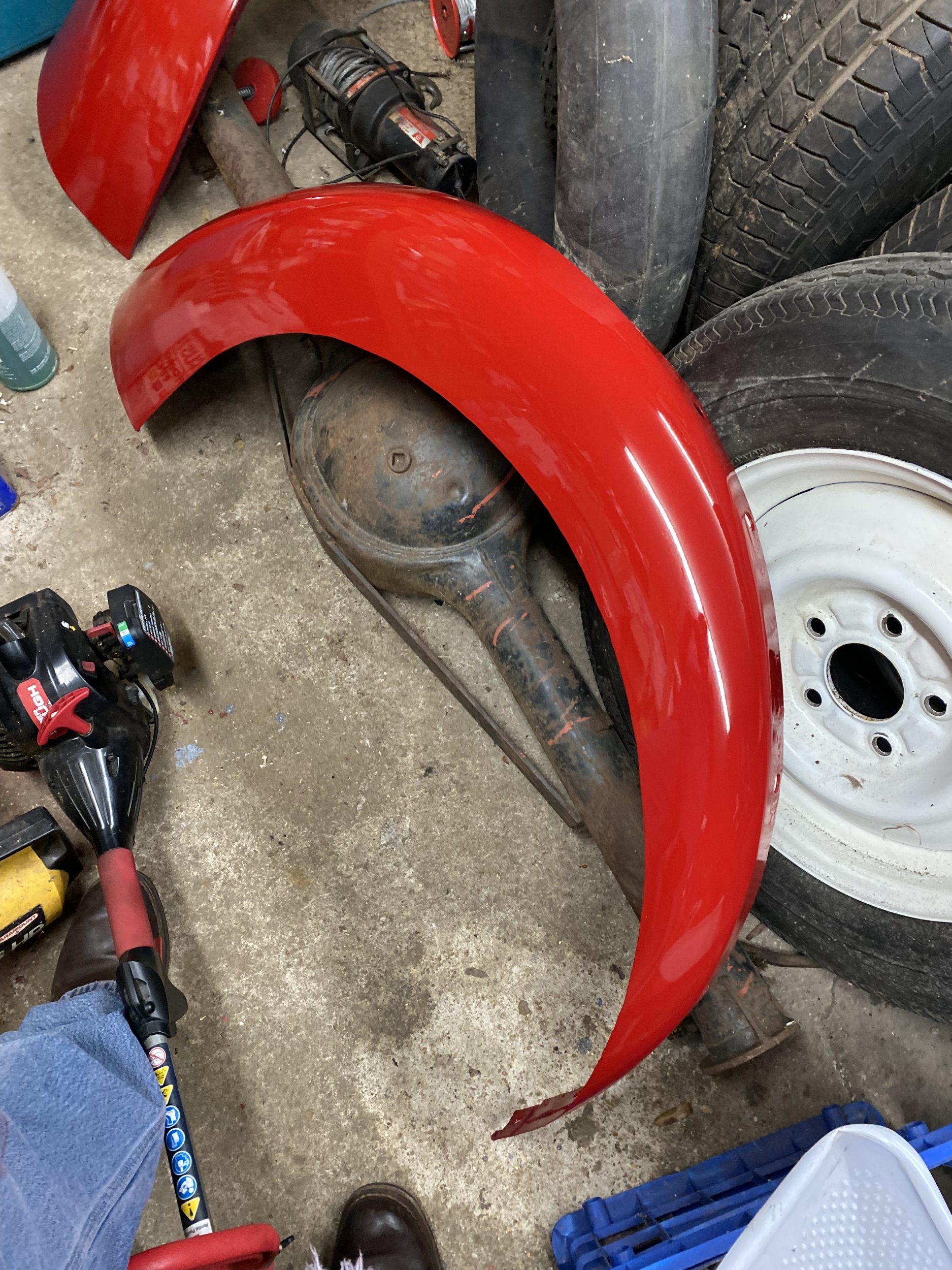

    Also finished the front cap on the Prefect/anglia today. IMG_3228.jpeg IMG_3231.jpeg IMG_3230.jpeg IMG_3229.jpeg IMG_3232.jpeg IMG_3234.jpeg
