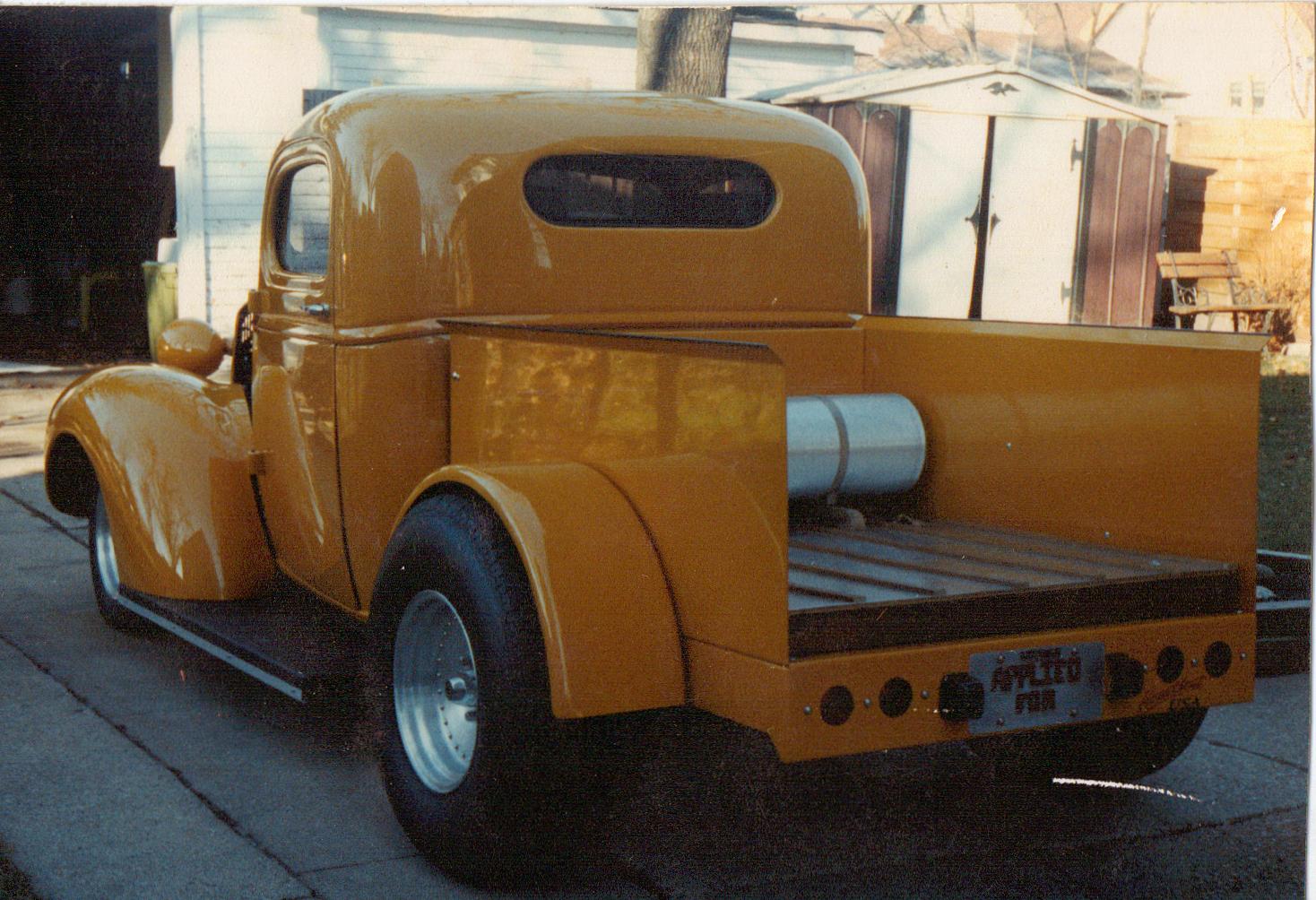

  9. 1.jpg I've painted one car (truck) in my driveway maybe 30 years ago. It turned out great but since then I've always had access to a shop and booth. My Chrome Yellow 40 Chev. pick-up came out pretty good for a driveway job. Centari acrilic enamel single stage.

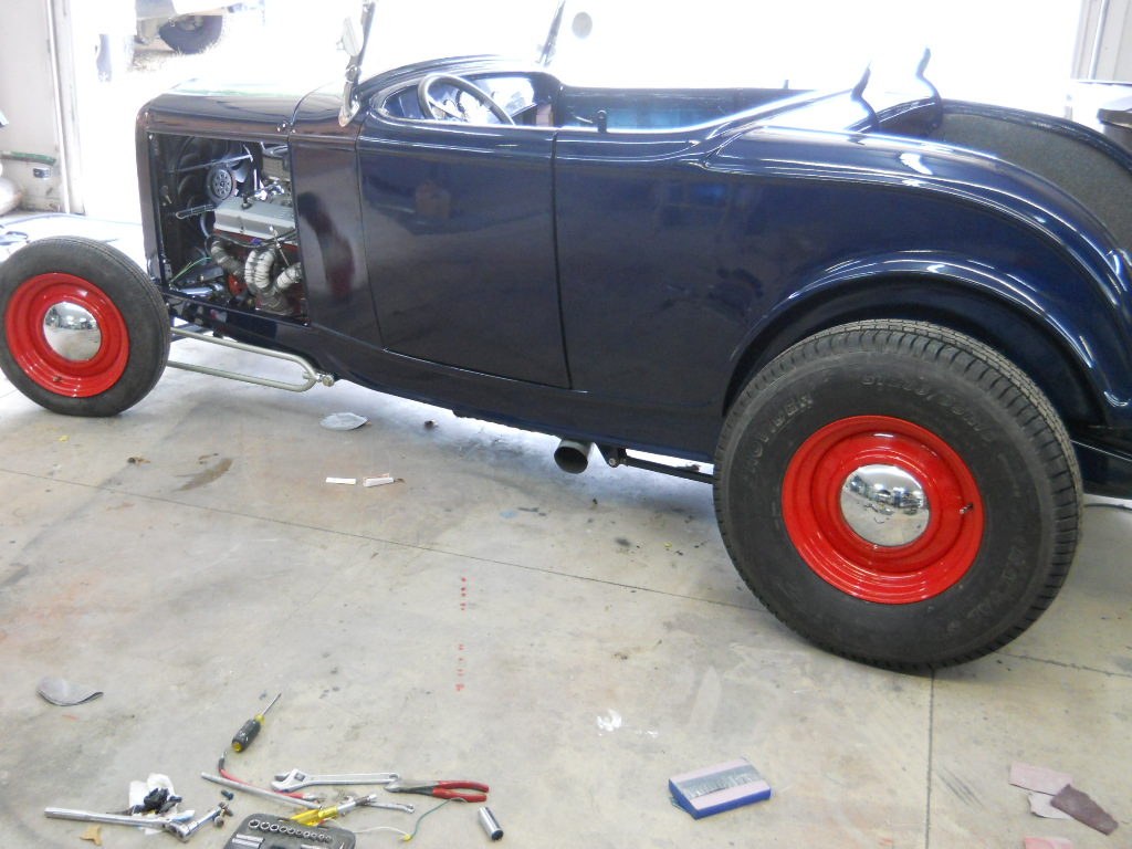

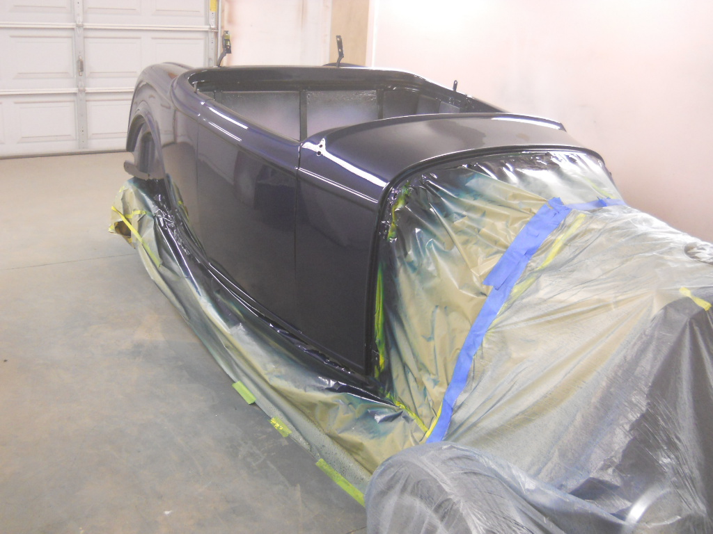

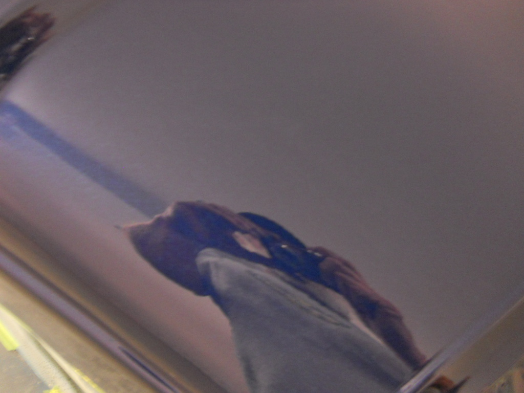

  11. dana barlow
    Joined: May 30, 2006
    Posts: 5,426
    dana barlow
    from Miami Fla.
    Wow,some nice work on this thread.

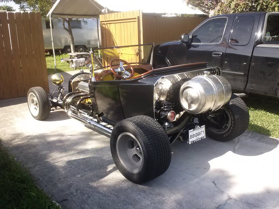

    I did my own also,pretty much same way I've been doing it for many years,at home in the back yard. 1462906_634501409926311_188278128_n.jpgsmall.jpg rearView1.jpg

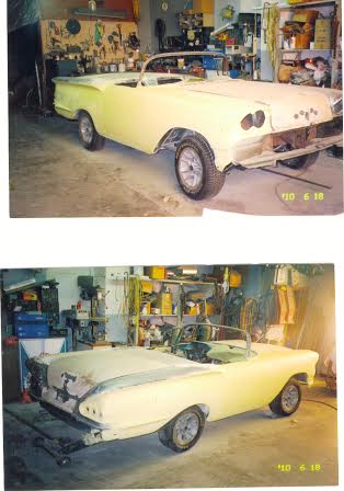

    unnamed.jpg !cid_ii_142249370f97397f.jpg all of this build was done in my barber shop back room. Paint and primer was sprayed with an old sharp 75 gun.

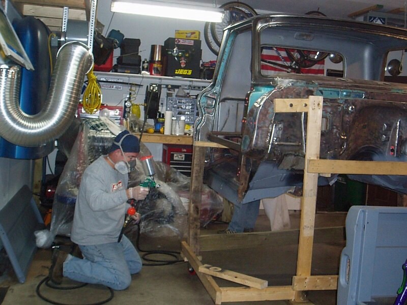

  25. Chucky
    Joined: Mar 15, 2009
    Posts: 1,861
    Chucky
    image.jpg image.jpg Nothing like an action shot of me priming the cab. And one of my favorite photo's of the ***embly.
