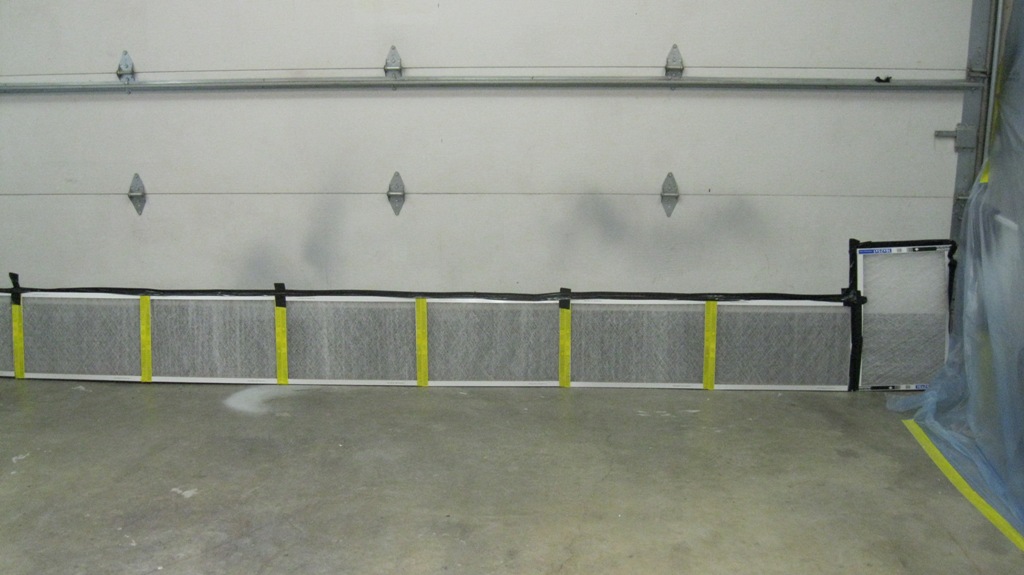

    Now were talking, this is the stuff I hoped would be in this great thread.
    Can you give more detail on how this was done?
    Is this a custom process you developed?

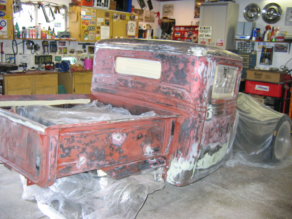

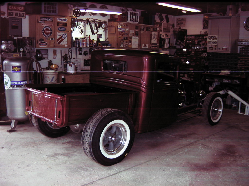

  3. I just used the plastic masking sheet-when opened up it's 12 feet wide-I put the 'paint this side' to the inside.
    I stapled it to the ceiling and taped it to the floor to create 'the booth' inside the garage-furnace filters under the big door filter incoming air-furnace filters on the back door keep particulates in and allow cross-ventilation with an exhaust fan.
    Tape the car to the floor to keep the belly clean from over-spray
    Just before spray time-wet the floor down(dont splash water on anything you are painting)

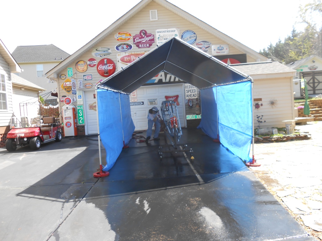

    Driveway ...... ImageUploadedByH.A.M.B.1411136508.552189.jpg ImageUploadedByH.A.M.B.1411136526.587111.jpg

  11. Is that one of those " can you find how many things are wrong in this picture?" pictures ?
    I don't want to be responsible for taking the thread off on a tangent ,,,
    But I can't look at that and say nothing.
    So ill just resign from this one.

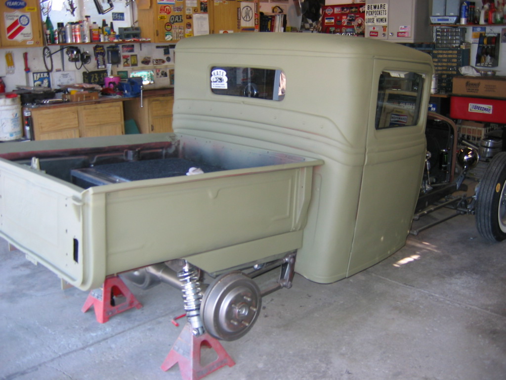

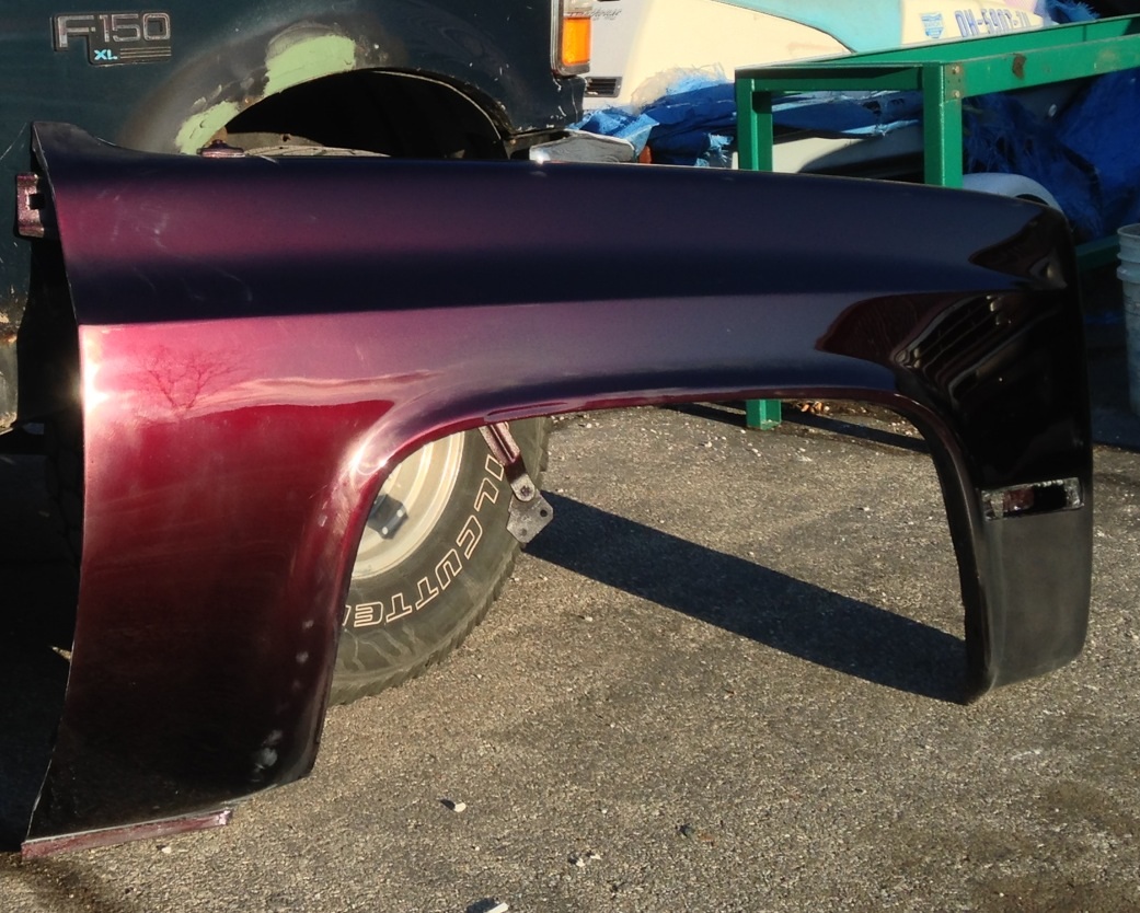

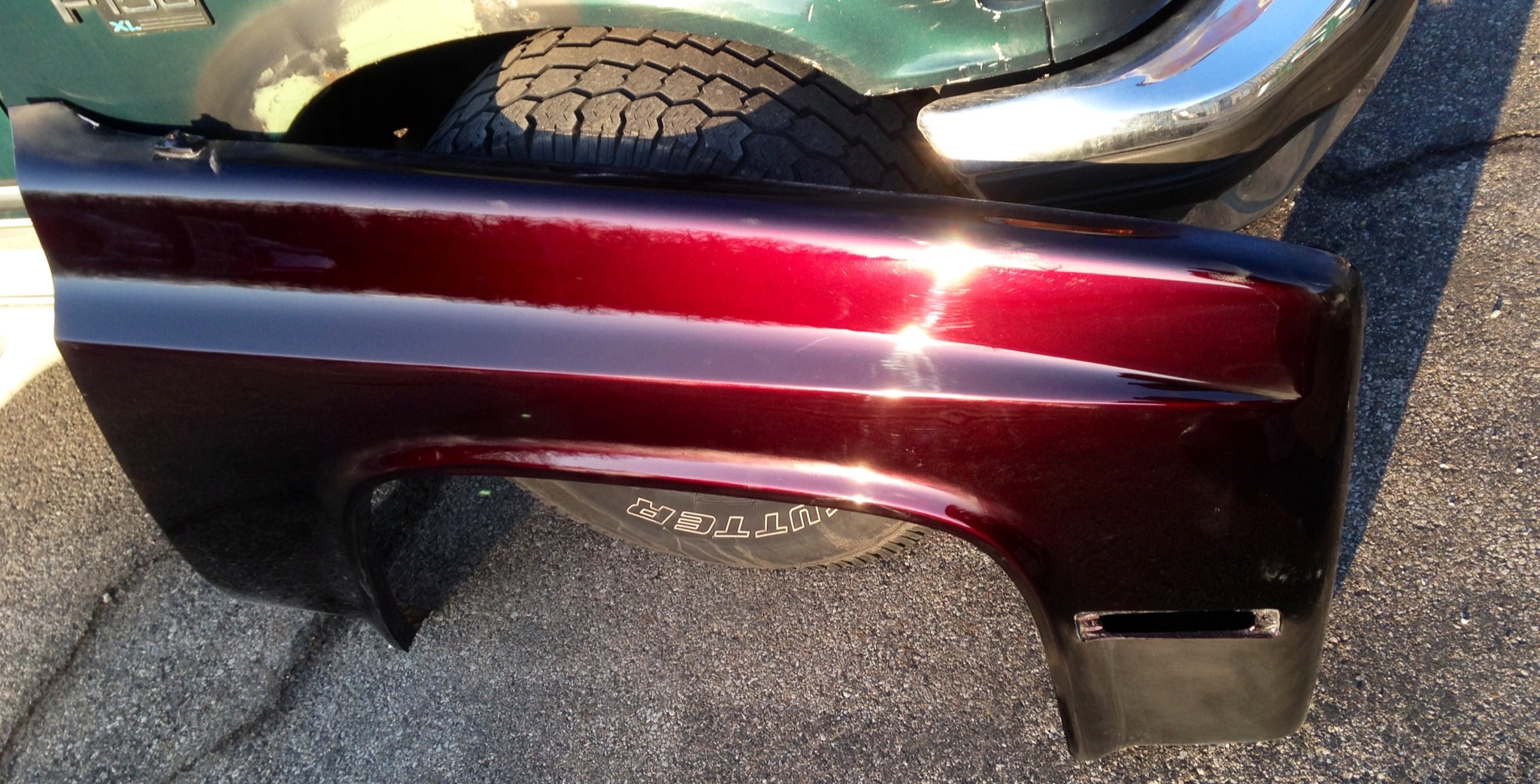

    I painted these in a garage also did an ot car ImageUploadedByH.A.M.B.1411278424.217647.jpg ImageUploadedByH.A.M.B.1411278480.968833.jpg ImageUploadedByH.A.M.B.1411278538.433666.jpg
