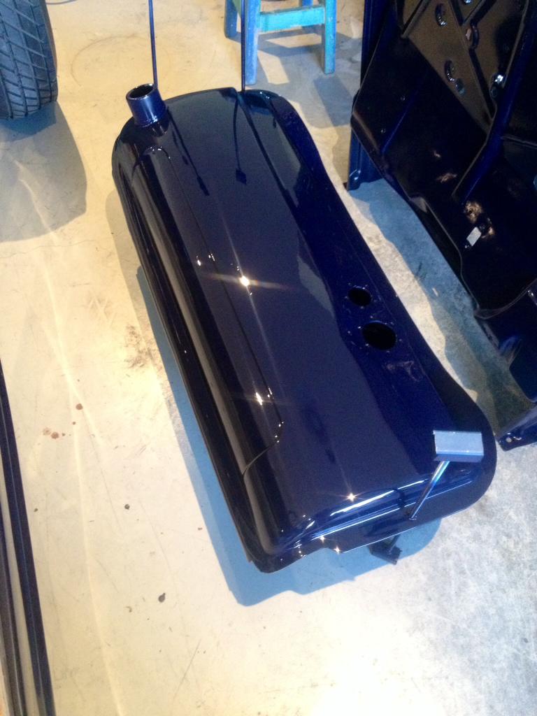

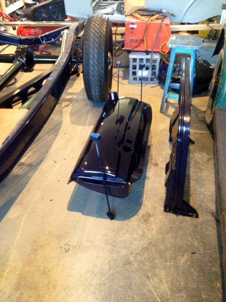

    Here are some of mine, painted in my garage:
    Gas Tank
    Of course it helps its such a small body.

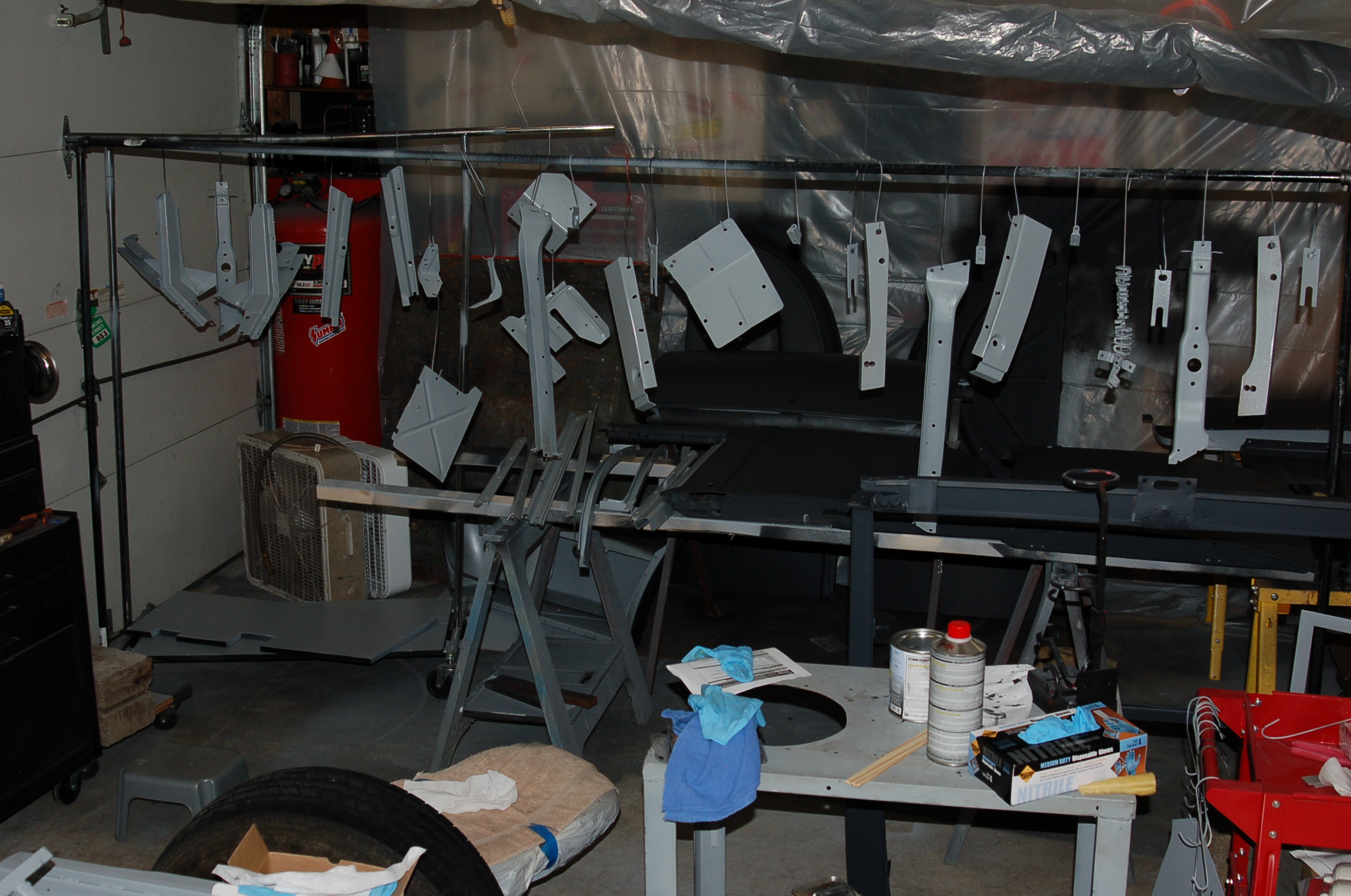

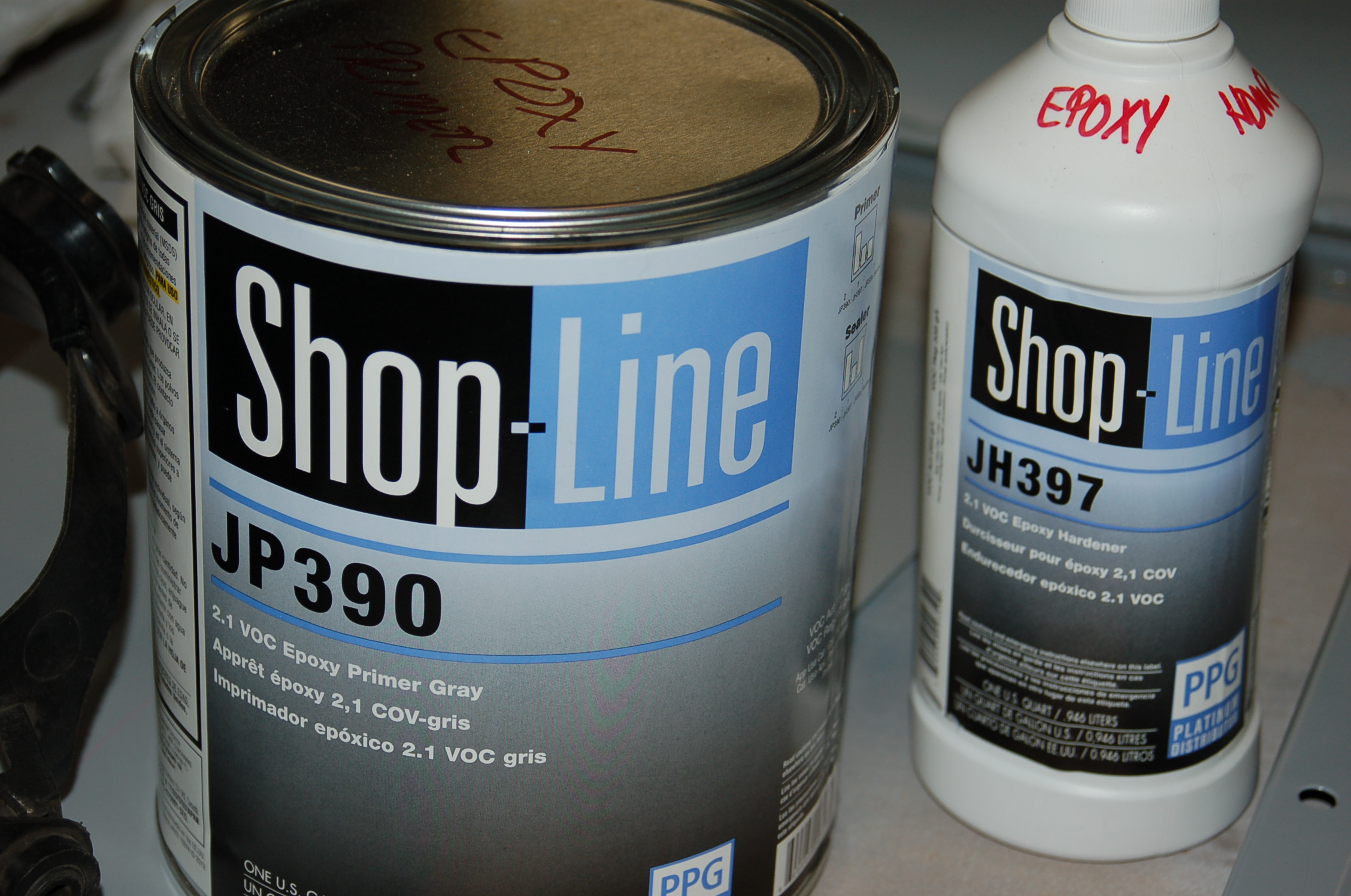

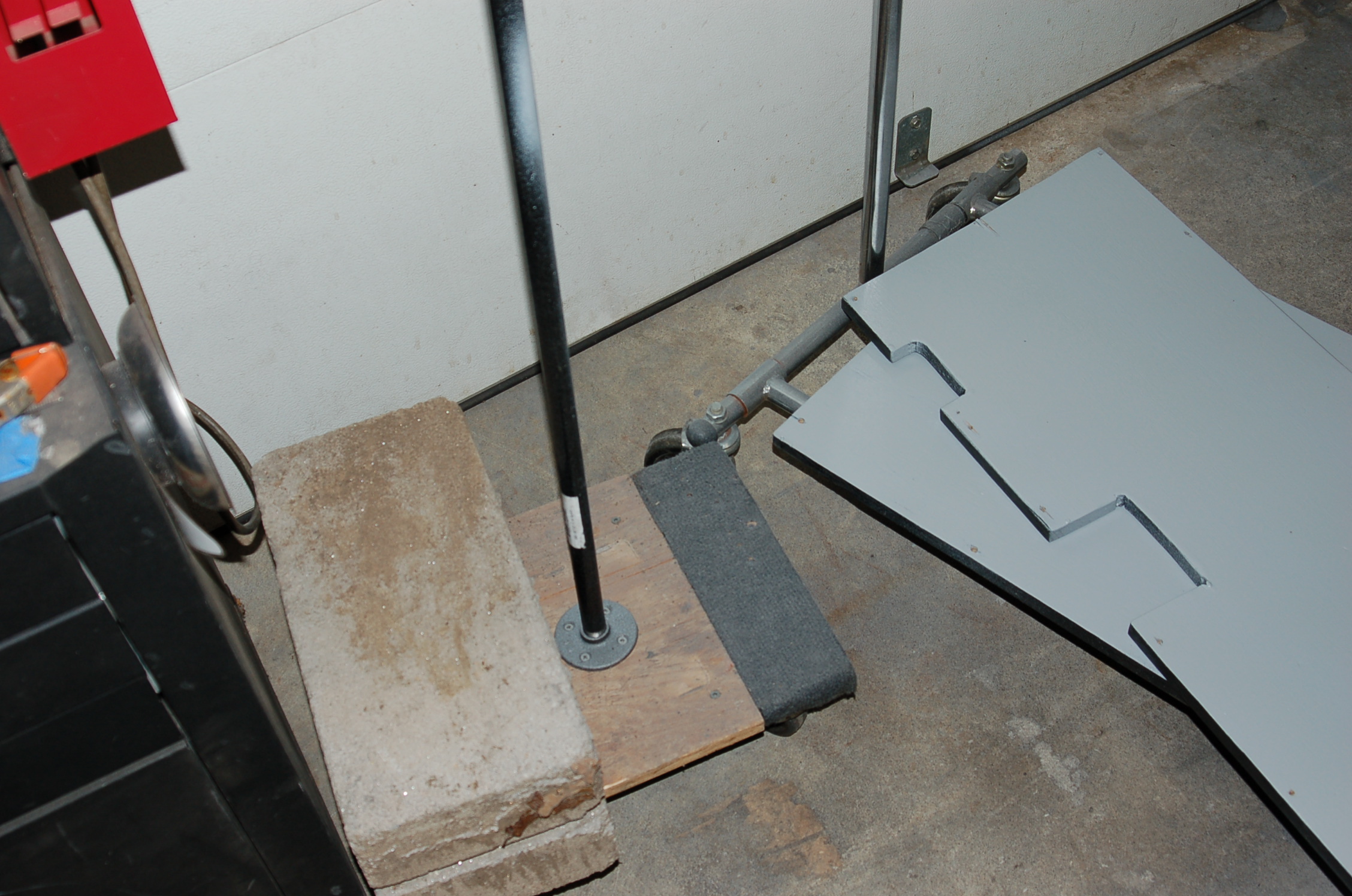

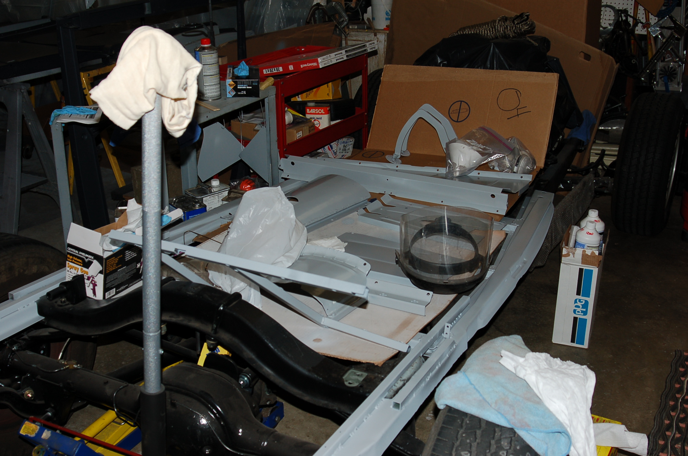

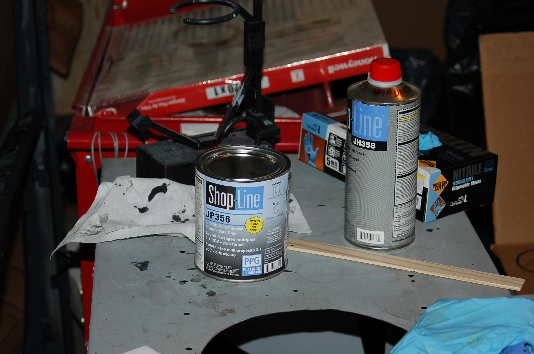

    DSC_0011.JPG DSC_0012.JPG DSC_0013.JPG DSC_0014.JPG DSC_0015.JPG DSC_0016.JPG Would like to share my recent experience with paint. Used PPG Shopline epoxy, then hi-build primer, cheap A HF hvlp gun, 3M respirator and the smaller half of a 2 car garage. Opened the ceiling access to the garage attic, walled off from the house, two 20" box fans with better level furnace filters, garage door rolled down on top and the rest of the opening blocked off. Lots of filters in the airline, protective suit from Home Depot, faceshield, latex gloves etc. I'd painted a few planes in the Navy in the 60's, and sort of remembered the technique and also read anything I could find on the HAMB about painting. Two main thoughts are having a better gun and more room would have helped, but I'm 67, retired and watch the coin. McHenry paint supply in Frederick, MD helped with a lot of good advice. I was going to start with the DP ** epoxy, but chose the Shopline at half the cost and good recommendations once they knew what I was doing. The pics show the part #'s. Overall, the epoxy (4 hr pot life) went on with 2 good wet coats (light gray-all they had for color) and the hi-build drove me nuts with a half hour pot life. I had to clean the gun out between refills and tossed it when done. Whether that's typical for that primer, I don't know, but I was able to get two good coats down and will do two morwe once the bondo is done and sanded. I changed the furnace filters after each day and my neighbors never noticed. I'm OK with the results since I did it all myself and comfortable that I can get a decent look when and if I color coat it. Now I have to put it all back together and bondo on after I block sand the high build.
