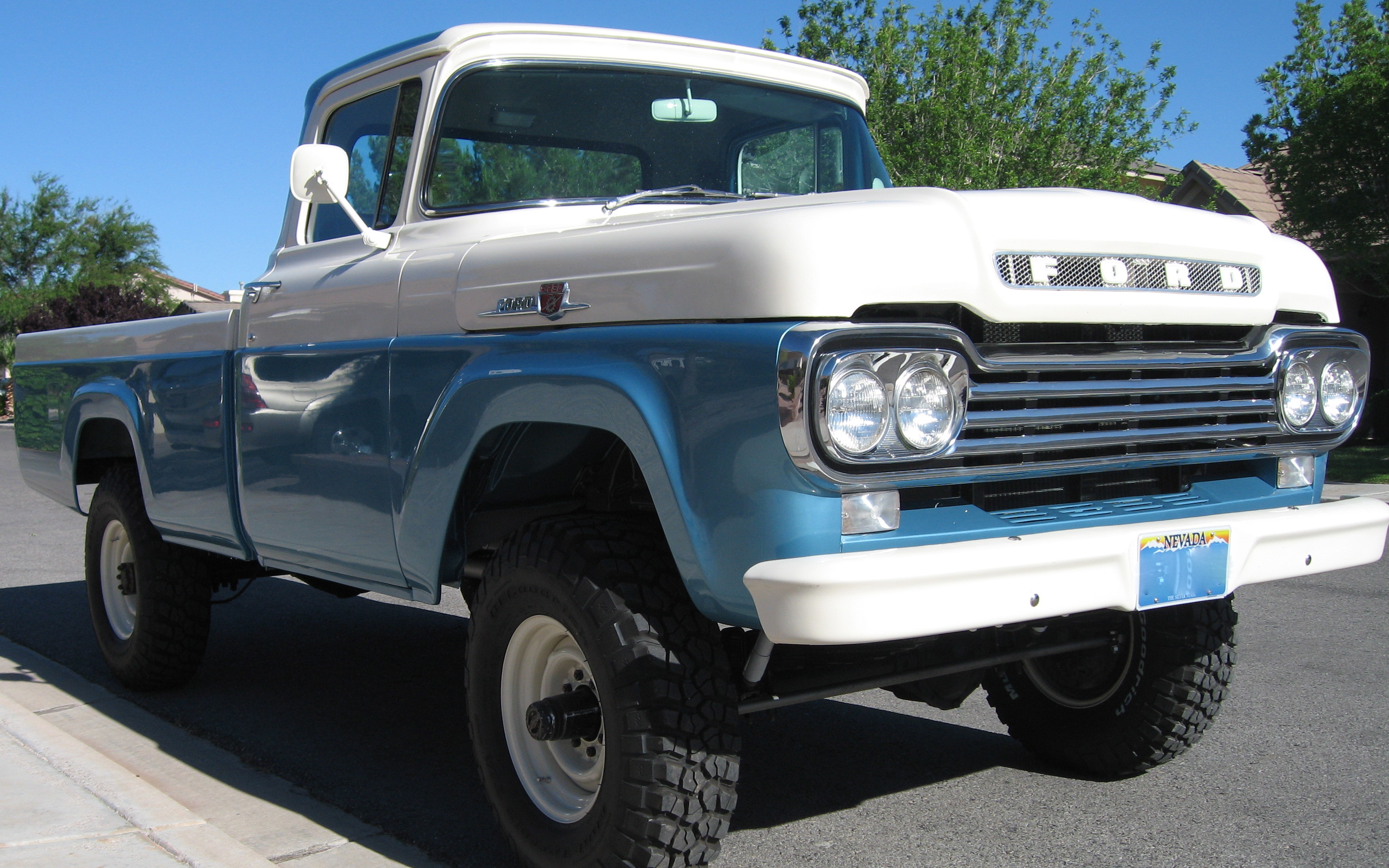

    I painted mine in my garage with BC/CC using an old "Hobby-Air" supplied breathing air pump.
    Looks pretty good for a driver, I think.

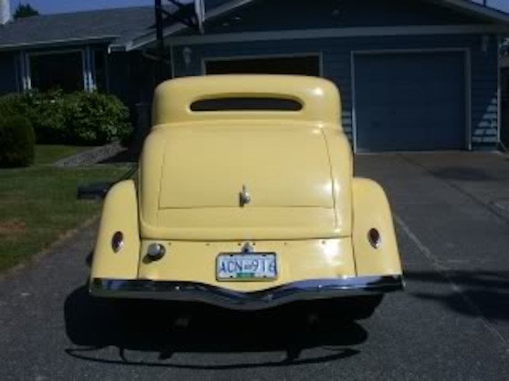

    I painted the 32 in my avatar in my garage at home BC/CC just wore a respirator and wet the floor

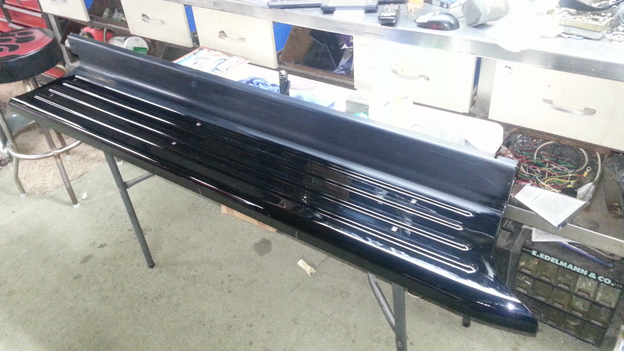

    I have some running boards for a 52 Ford pick up I am working on. 20141116_202623.jpg

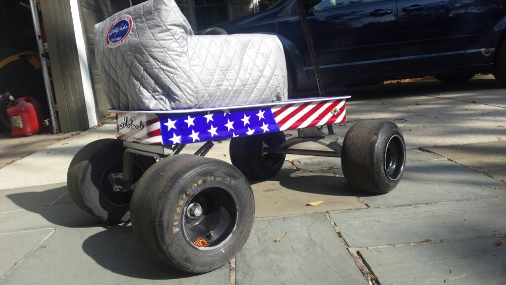

    I painted my son's wagon: HOK abalone flake over white with burple candy and red wine candy. Used a turbine HVLP sprayer I got used off eBay

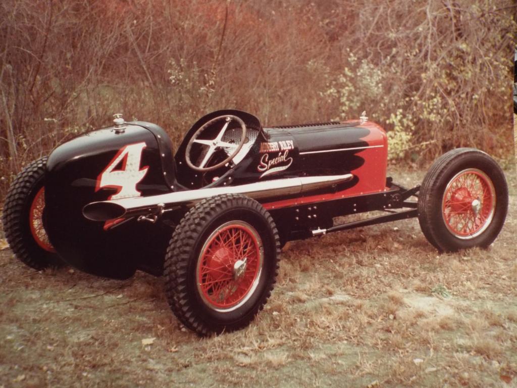

    CSRAFALL2014_zpsa1ba7d96.jpg Did this in Mom and Dad's driveway in 1975, last sighting was in California, if you know who owns it now please send me a PM. Bob

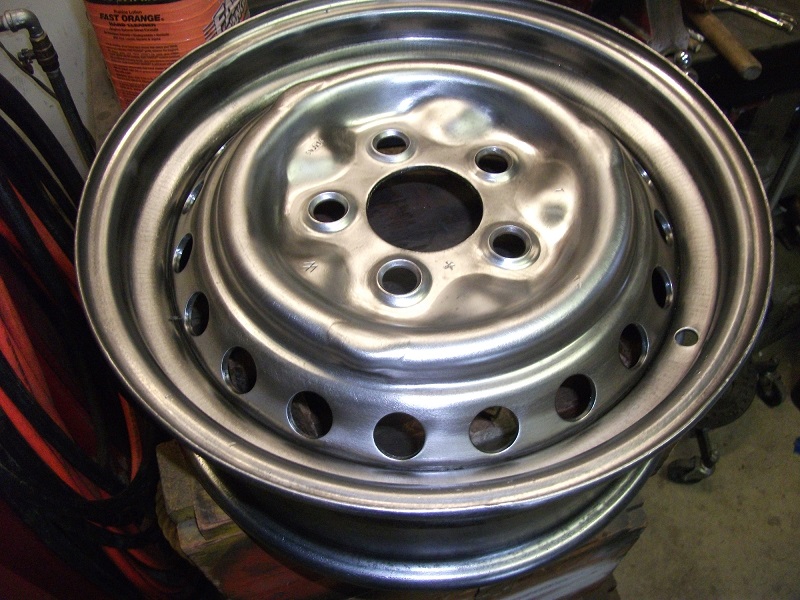

    I'm not really ready to paint anything on Edith, but there's always other things to paint & it was actually warm enough to paint in my garage this AM. :)
    I've been de-rusting some 40+ year old wheels for a trailer I plan to build this winter. They were OK, but a bit rusty with a few serious rust pits. The electrolytic process has its advantages: Electrolysis really cleans out the pits, but it's not a panacea. A lot of cleaning is still required to get good results & there was quite a lot of **** on the wheel that doesn't just rinse off.
    This wheel was rusty and was poorly repainted in the 70's. This is what it looked like after 5 days in the tank, a dose of Zip-Strip, a couple more days in the tank, solvent degreasing, and a good burnishing with wire wheels, cups, sandpaper, scotchbrite & elbow grease.
    Wet Rustoleum primer shot this AM:
    (For some reason the reflections of my florescent lights came out very yellow in this pic, while the camera flash is white.)

    Wow that primer looks glossy wet, but it's dead flat now boy!
    I'm going to let the primer cure a few days before finish paint.
    I'm gonna spray-bomb them with Rustoleum 2x Painter's Touch, in a nice bright glossy green.
    I've used this before and it runs quite easily, so I'll probably have to shoot 10 coats at least.

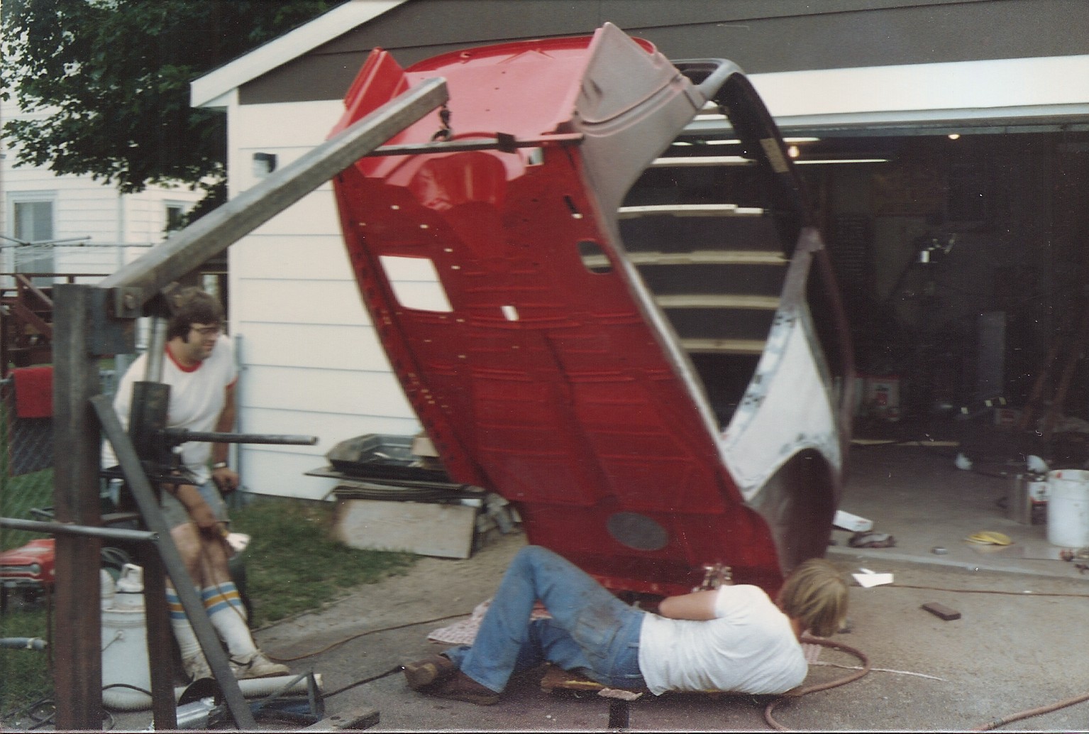

    Way back picture of driveway painting, later painted the body in the same place; but after 11 at night, the *****ers and bugs had gone to sleep and humidity was down so the lacquer wouldn't blush (bottom was Centari).

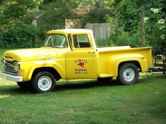

    Carport plus about $65 worth of Walmart Rustoleum. It draws a lot of compliments from wimmen :)
