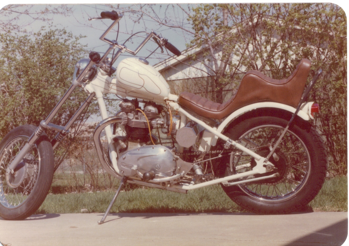

    I painted this with spray cans in the 70's in parents garage, lived in apartment at the time.

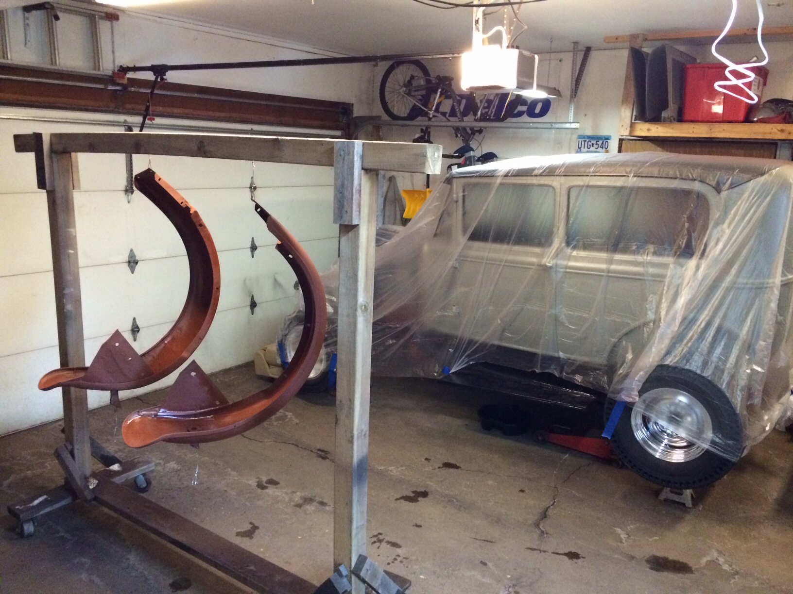

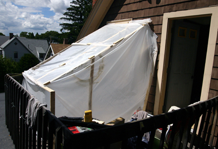

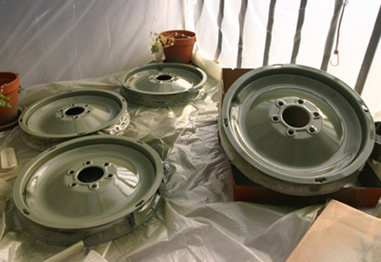

    green-vi.jpg spraybooth-vi.jpg To paint the wheels on my woodie, I constructed this third floor spray booth. I dragged my compressor up to the kitchen and went to work. My neighbors didn't complain, but thought it might not be my best idea.

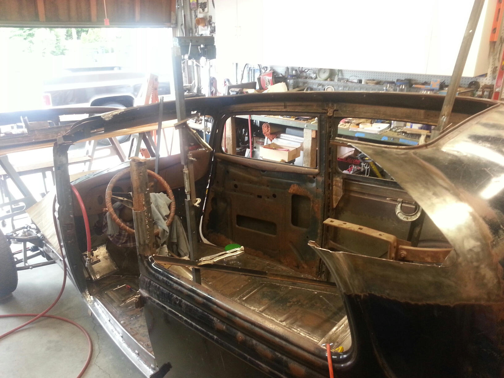

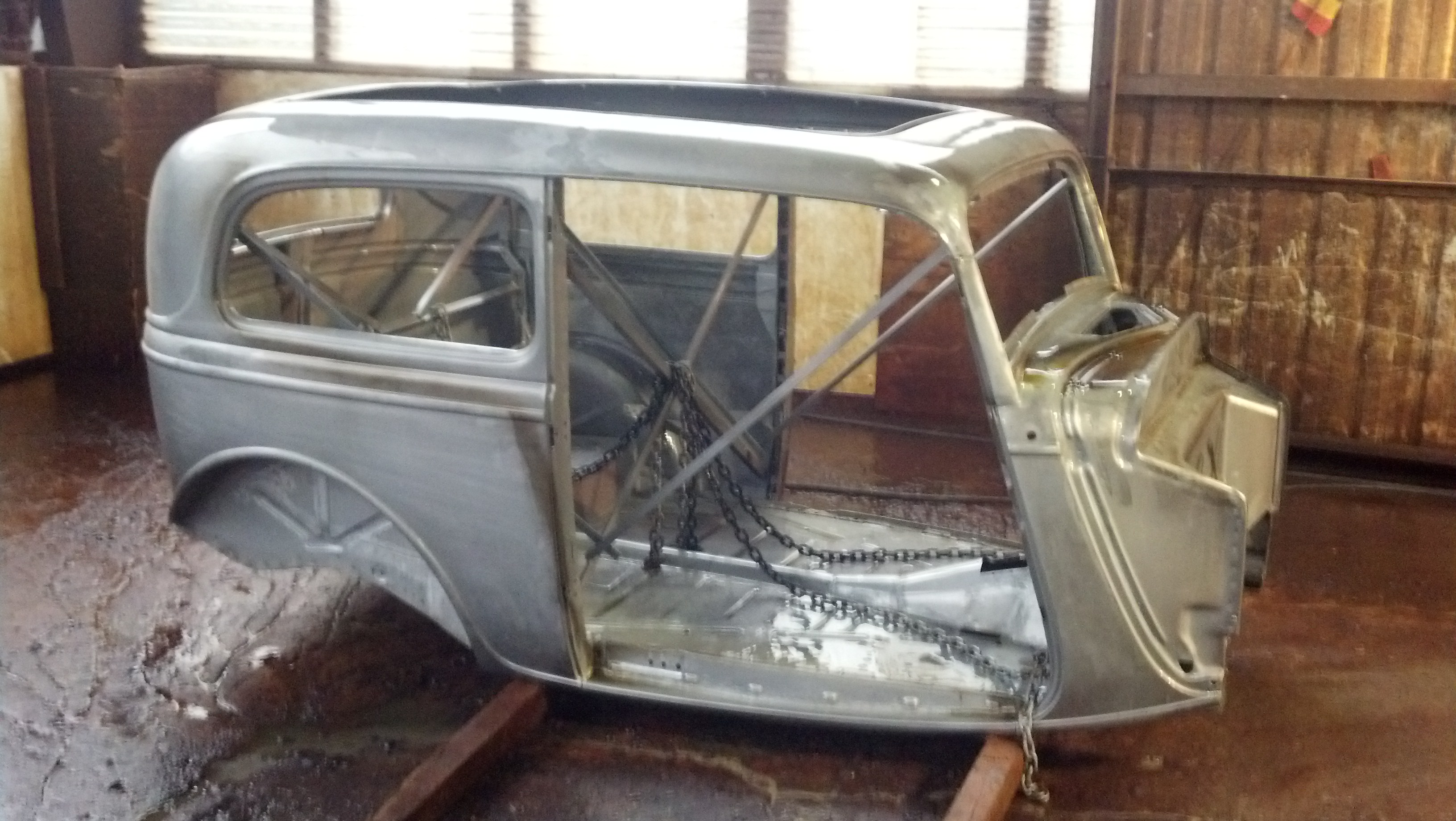

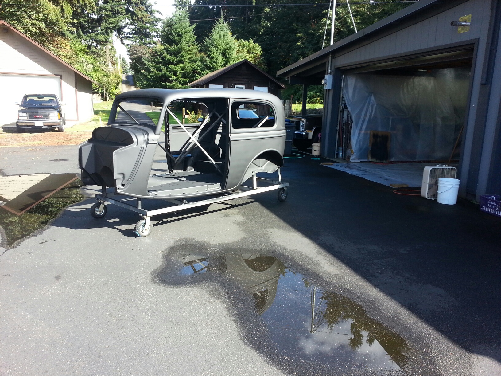

    Some of the bodywork in progress. 20140612_130117.jpeg Next is after dipping at American Metal Cleaning in Portland. 34 before phosphate 2.jpg And where I'm at now, Sealed up with DP90 so I can finish (at home) as time will allow. 20140925_143437.jpeg Mabey I'll start a build thread if there would be interest.

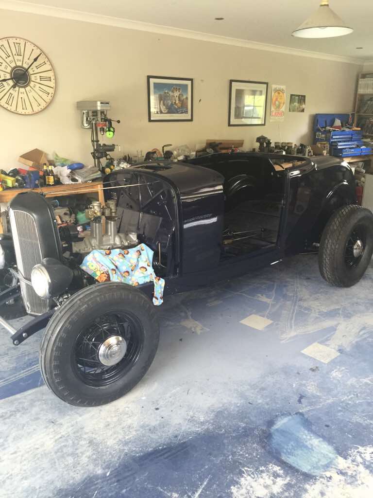

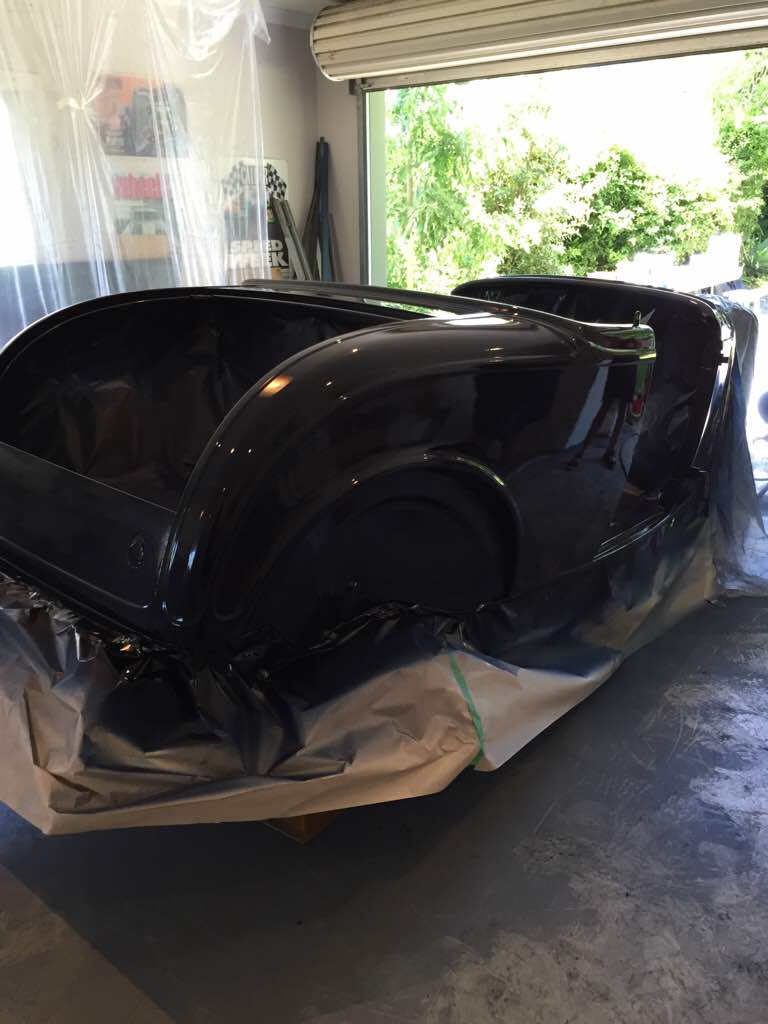

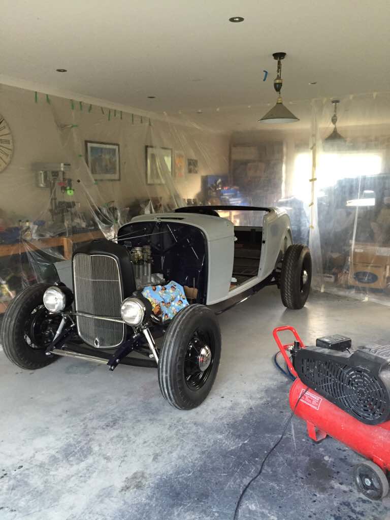

    Yup, in my garage, not really ********, just doing what generations of hot rodders have done in the past.

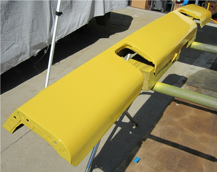

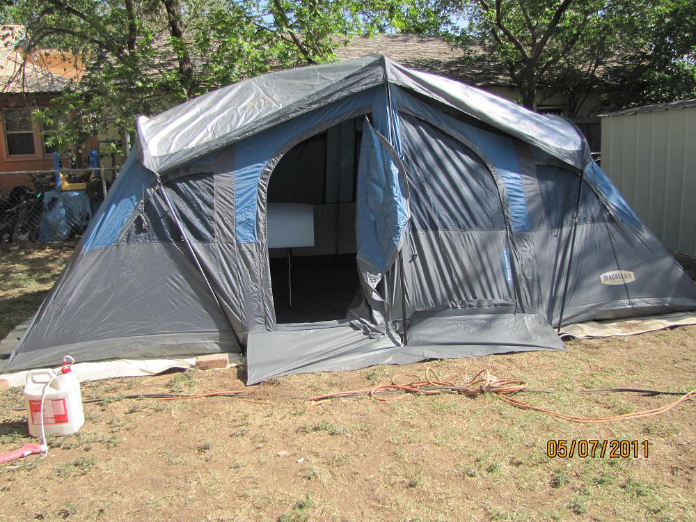

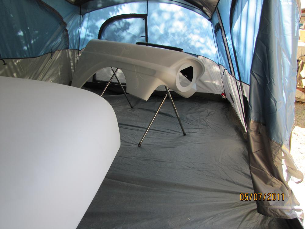

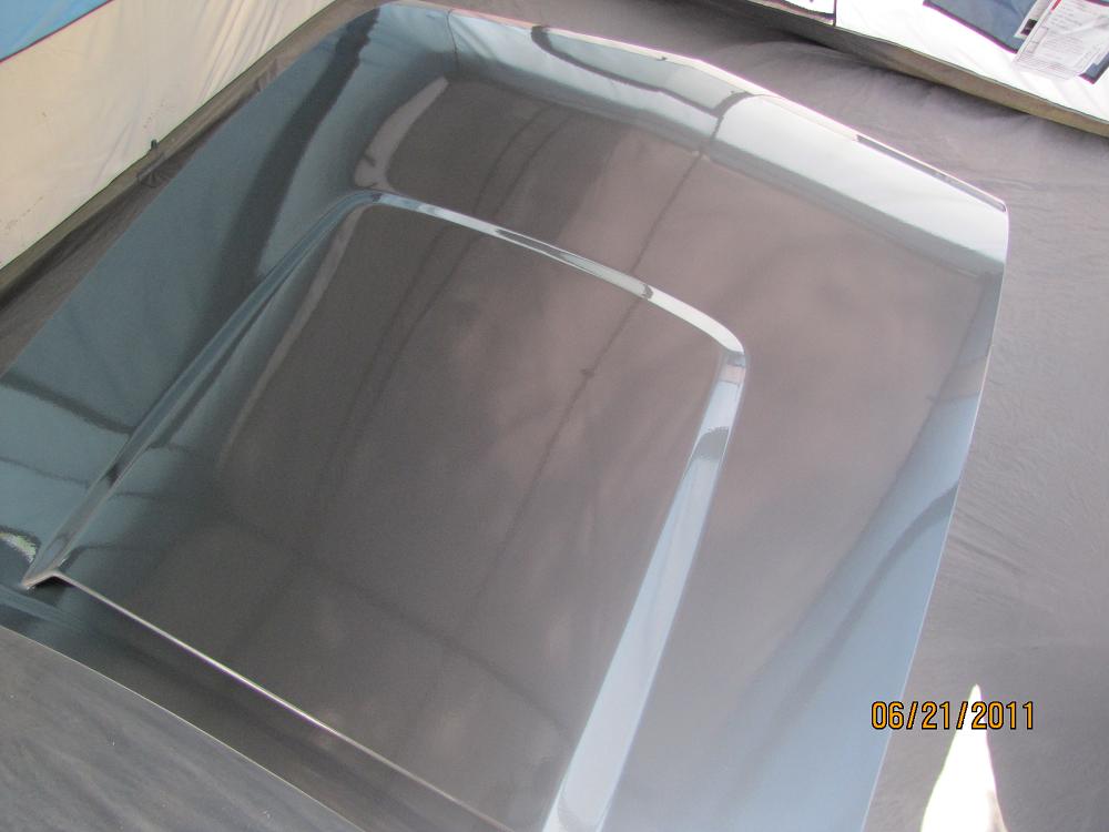

    As most do, I painted my car in pieces (in the avatar) 643.JPG 645.JPG 802.JPG . Matrix 2k, ppg base, Matrix clear. I'm working in an enclosed 1 car carport with a dirt floor. The car takes up all the room. I needed to figure out how I was going to get the rest of the parts painted..hood, doors, fenders, etc.
    It's Texas...windy, dusty, hot. Painting outside unprotected wasn't going to cut it. Did I mention windy and dusty? Plastic for sure wasn't going to cut it. I thought about renting a place, but no spray booths available for rent. I needed something that would hold up to the wind and keep out dirt. One day I was talking to my wife about building something and I mentioned it would be nice if I could build something I could put up and take down like a tent.......I'm old, sometimes it takes a while for the light to go on.
    The tent I bought was a cheapo..less than 150. it was 12 x 22 if I remember. It lasted about 4 months before the Texas wind and sun tore it apart..plenty long enough to get the painting done, then lots of sandblasting afterwards as well. You guys with big barns imposible to clean might find this usefull as well.

    I like the tent idea :) Good thinking.

    Great idea! I'm not in Texas, but I am in farm country with lots of dust and dirt and pesticides and wind. I was wondering how I would paint outside without getting an 'organic' paintjob. This might just do the trick!

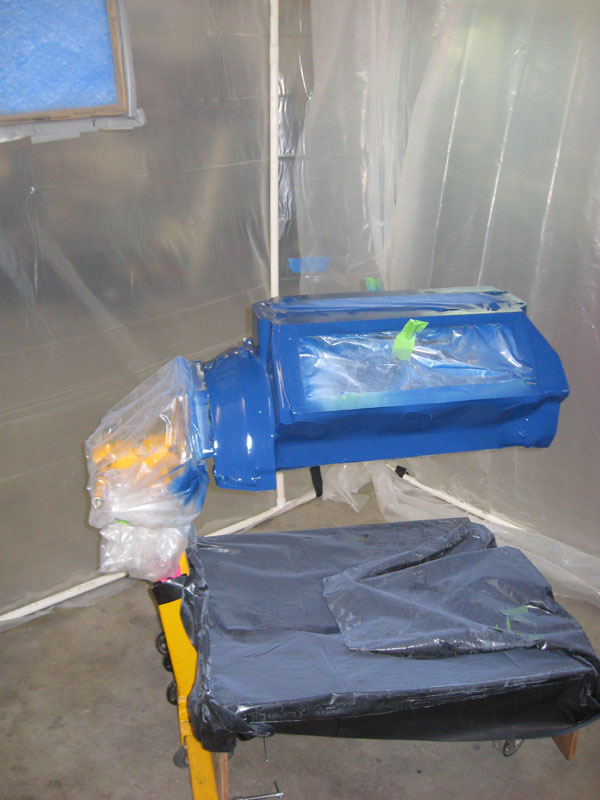

    I made this PVC pipe framed enclosure for painting small parts. Used a fan from an Genair stove t.I
    exhaust the fumes out my no longer used wood stove pipe. I used a simple furnace filter taped to the wall of the enclosure.The white stuff is just paper towel I used to catch the finer dust particles.
    The frame hangs from a screw in bike hook. The upper frame has bottom truss bars that also work well for hanging small pieces. I role up the side walls, remove the vertical supports and move the thing to the dirt floored side of my shop when not in use. It is very light and portable. PJ4.jpg
    This was an experiment to see how well a simple system like this would work. I was painting in the winter months inside the shop. I did only use spray bomb paint for this project. I was able to paint the engine and still do other work in the shop with no fumes noticeable.

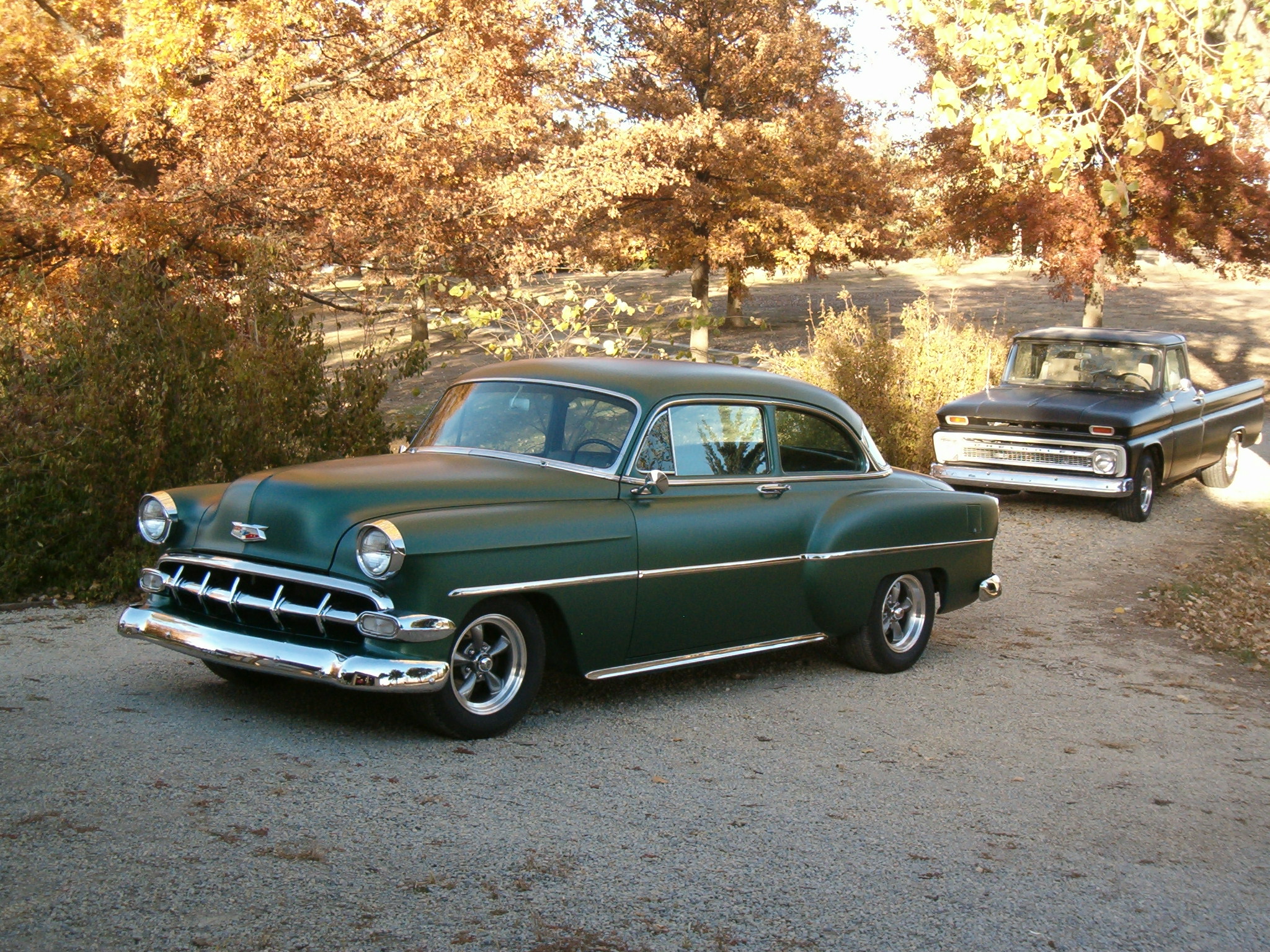

    HPIM3053.JPG 54 chevy 001.JPG Here's mine, 54 Chevy 210. Before & After painted in my garage woodland green BC/CC (flattened clear).

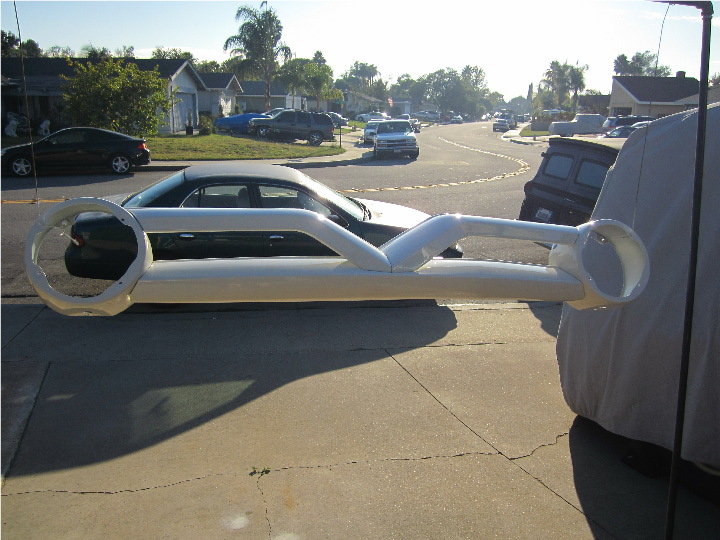

  19. IMG_0047.JPG DSCN7456.JPG 411-vi.jpg Here are a few of mine. Did the orange base in the drive way. But did the clear with the metal flake in the garage.
